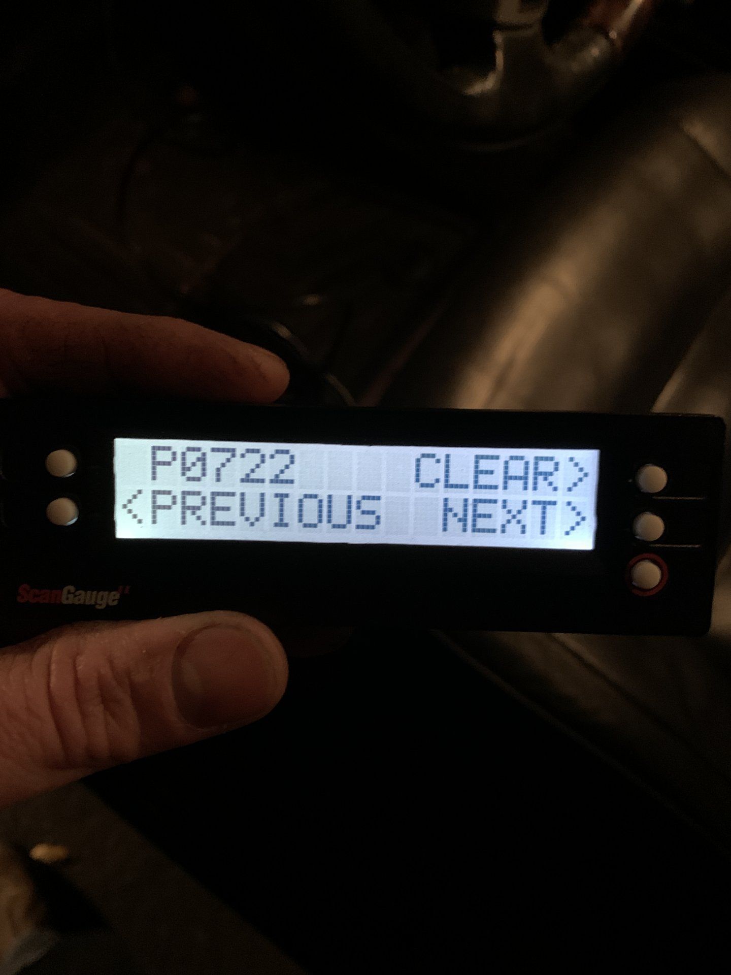

Well as the title says, I’m getting a Intermittent check engine light on my 2013 with 140k. Cleared it with my SacnGauge but it returned a few days later. Since then it’s gone back off but it only gets driven about 10 miles a day.
Quick google search says “Output Speed Sensor No Circuit” but nothing on mud that I’ve found. It’s hard to believe I’m the first but hey, lucky me I guess lol.

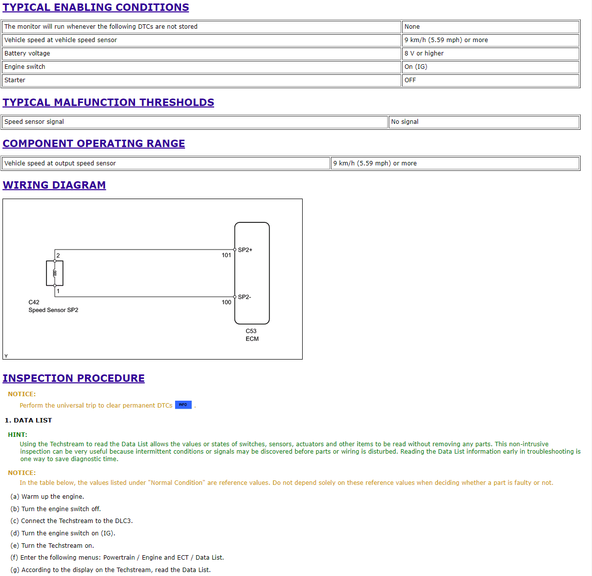

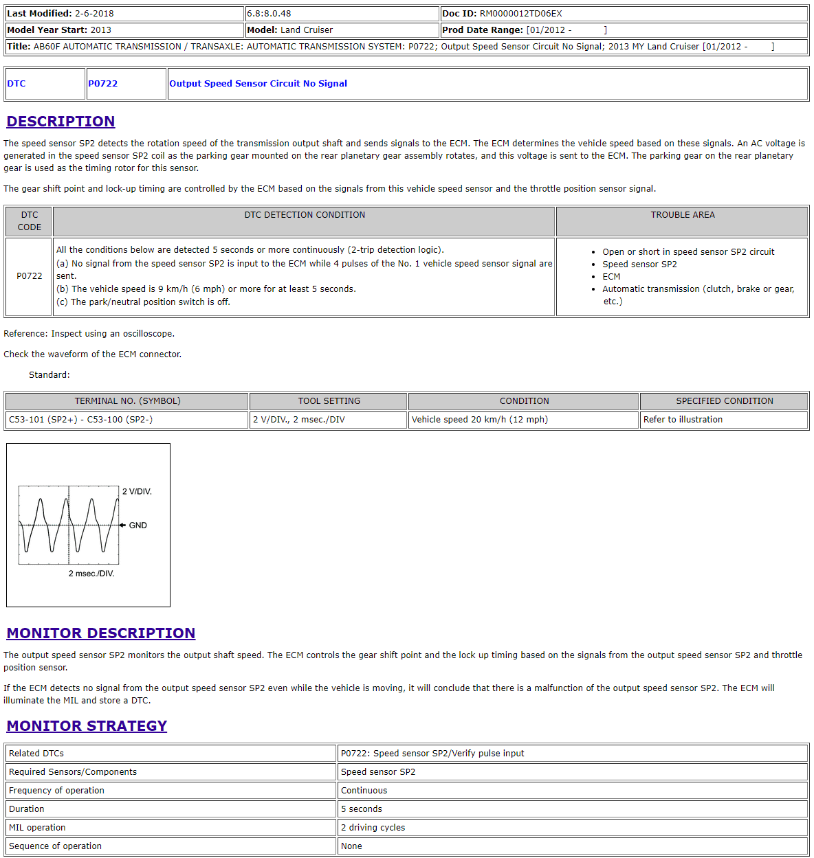

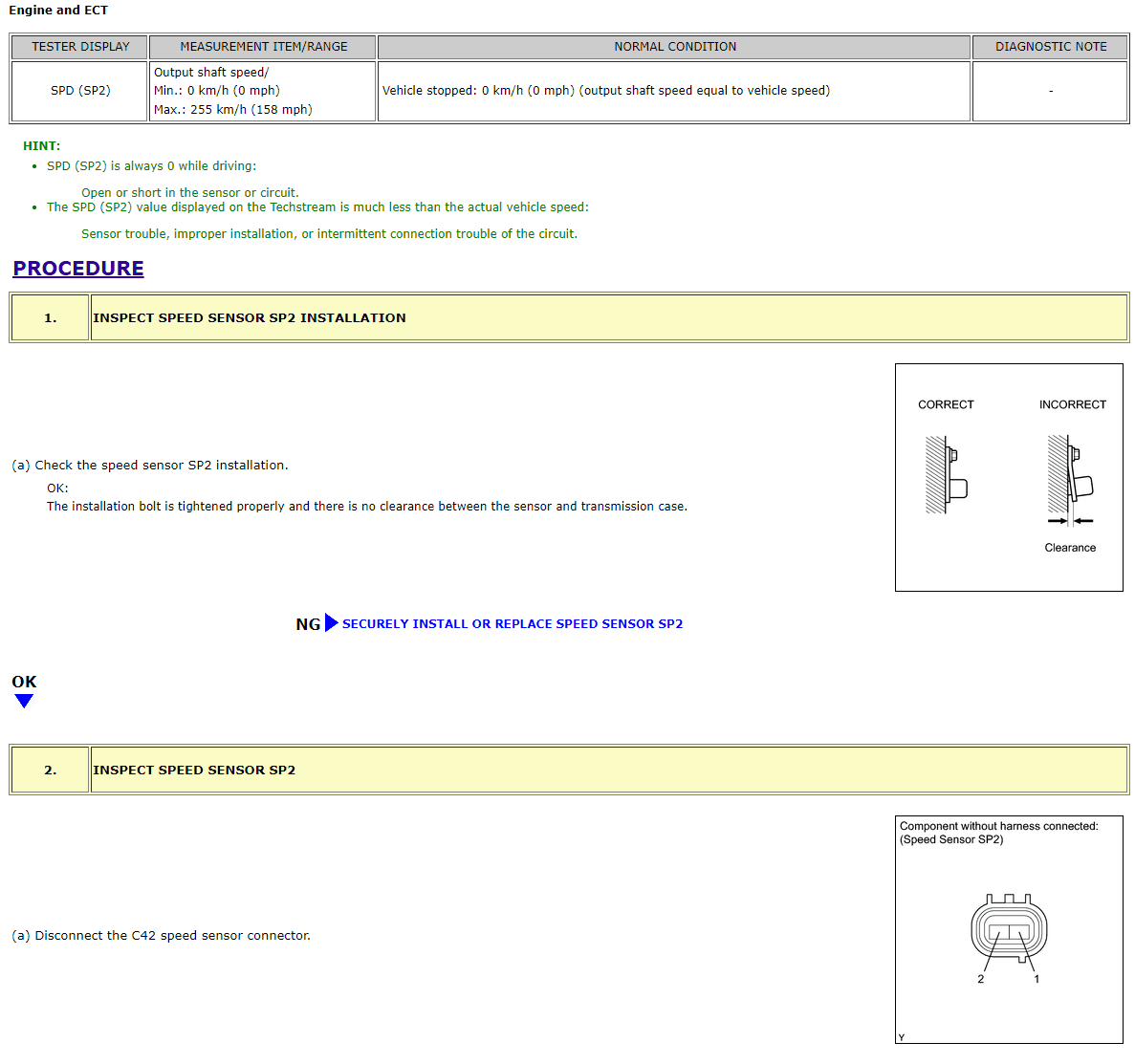

I'm guessing a bad speed sensor, but here's the full diagnostic process for that code:
Thank you, this is very helpful. I do have a scope and could check this if the dealer cannot find a problem. I assume they will follow this same procedure though.

Dealer said the speed sensor resistance was high and needs to be replaced. I asked if they checked the waveform on a scope and he just repeated that they checked the resistance...$400 for parts and labor, I’ll have it back Tuesday.
