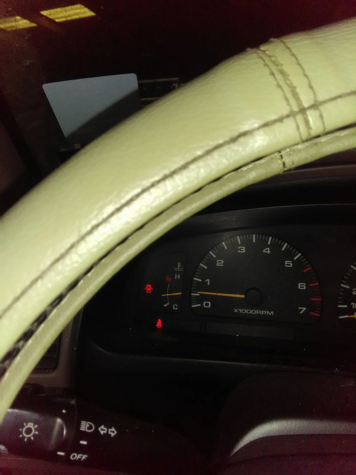

I dont want to day what the coil issue was...lol. It was an aftermarket alarm issue and I hadn't plugged one connection all the way back in. Went through the harness then in the engine bay and interior. I went though all my plugs and sprayed them with cleaner and made sure they were connected fully underneath today. Didnt see any issues when I traced the harness back also. Changed the fluid this morning. Gonna change it again tomorrow and change the filter then. Looked pretty burnt but not milkshake thankfully. So do a little more flushing of it all. Thermostat has been changed, still runs cold. But even after I let it sit for an hour the temp hasn't dropped at all. So gonna get a temp sending unit tomorrow. Attaching a pic of what it runs at and stays at even after sitting for an hour. Really appreciate the help. Damn wires are making me really miss my 22r I just killed. New motor is on its way though.

My temp gauge sits horizontal when it's running.

I was pretty sure it day at horizontal from my 2 1st gen tacos. Been 3 years though, also the last time I had an auto. Got a spare r151 sitting here, but that is for the 2nd gen runner with a cut back. Appreciate the help. It is a very temp dd. Picking up a very low mile 1st gen tundy after this tourney.
