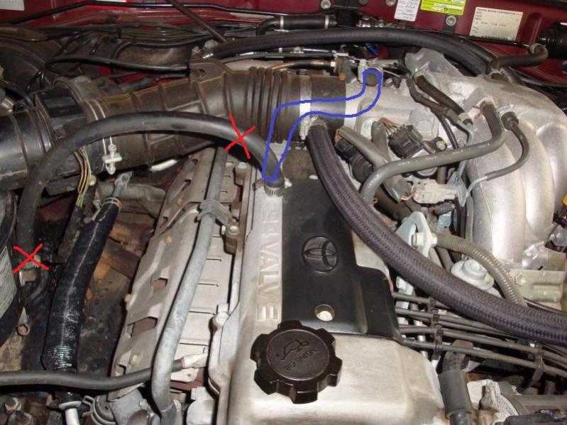

My parts have arrived from Toyota Australia and I saw that the regular 97 hose from the air intake to the inlet manifold is totally different to the one that I have. WTF has someone done to my truck..? Please see hose coming from left hand side air filter canister.
Wonder if you got hoses to fit one like my LX, because your hose setup is definitely NOT like my '97!!
Attempt to put oily crankcase oil elsewhere? Looks like a bad thing I'd restore orig parts
They re-routed your lines due to the LPG conversion. I assume the big hose is part of that system and the breather on the left of the picture has been re-routed so you do not ingest LPG into the valve cover/crankcase. Right PVC remains factory.

Aha, thanks man!
I don't use LPG anymore because it's as expensive to run as petrol, will it be o.k left as is you think?

Or reroute it to the original fitting on the intake, which is downstream of the MAF in the intake tube. Preventing any oily gunk from accumulating there.
tom
I am curious about this hose, which appears to be aftermarket. What is its function?
