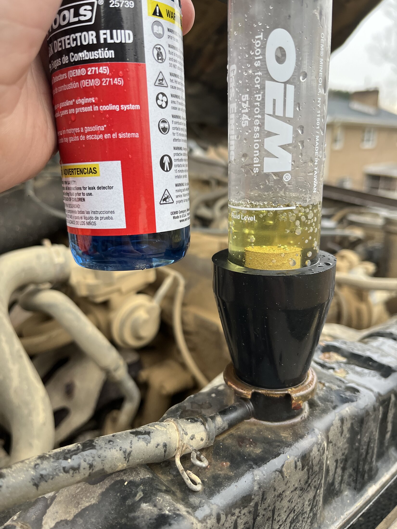

Well follow up to my head gasket posts, finally got around to testing the coolant for exhaust gases with one of the rental testers from the parts store. I have no idea how accurate these are, but she changed color pretty dang quick, so I'm gonna lean towards definitely a blown HG.
In just one Windrock trip, about 3/4 of a tank of gas, she consumed enough coolant that it's down in the fins and can't be seen through the cap. So guess it's time to organize my garage and stick her on roller tires to fit through the door!

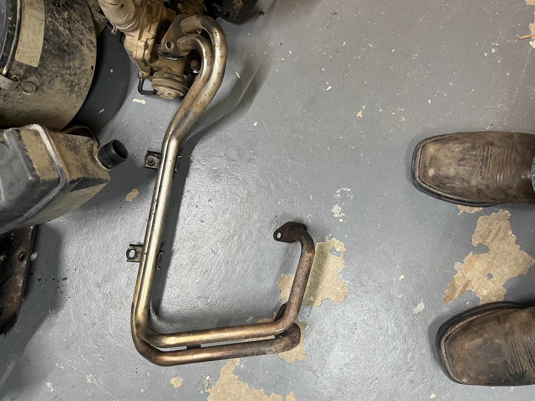

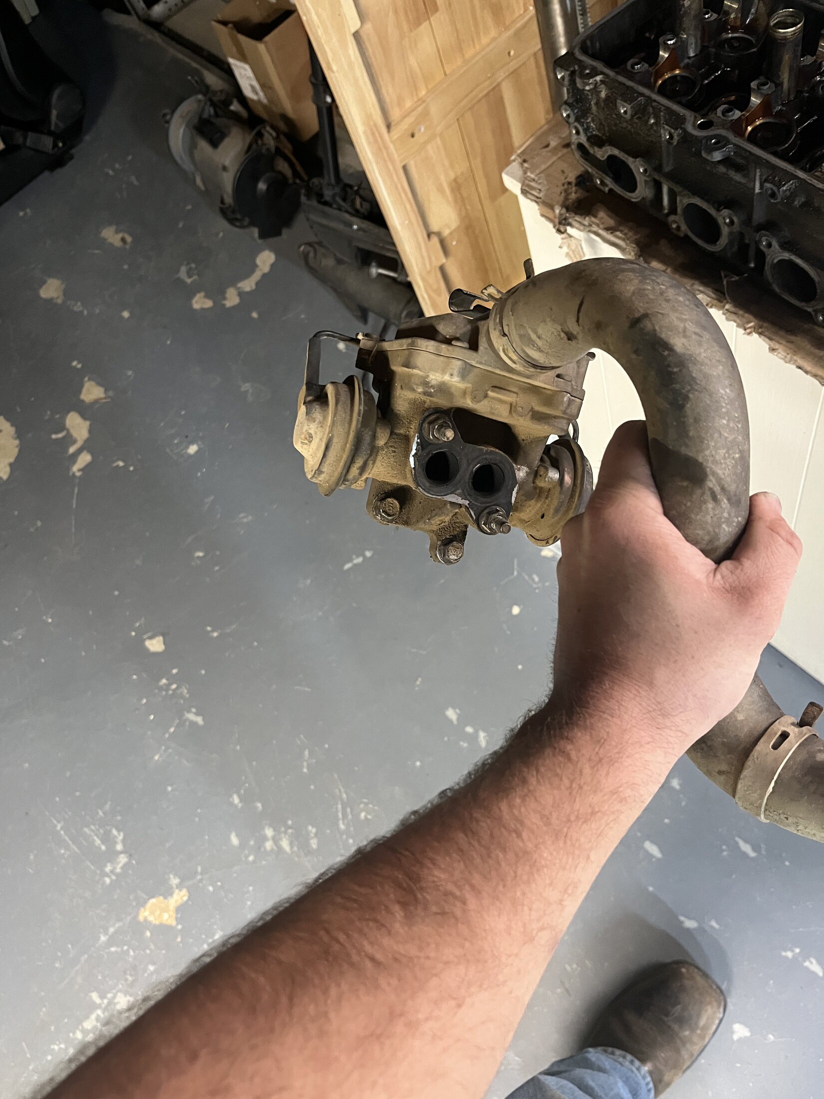

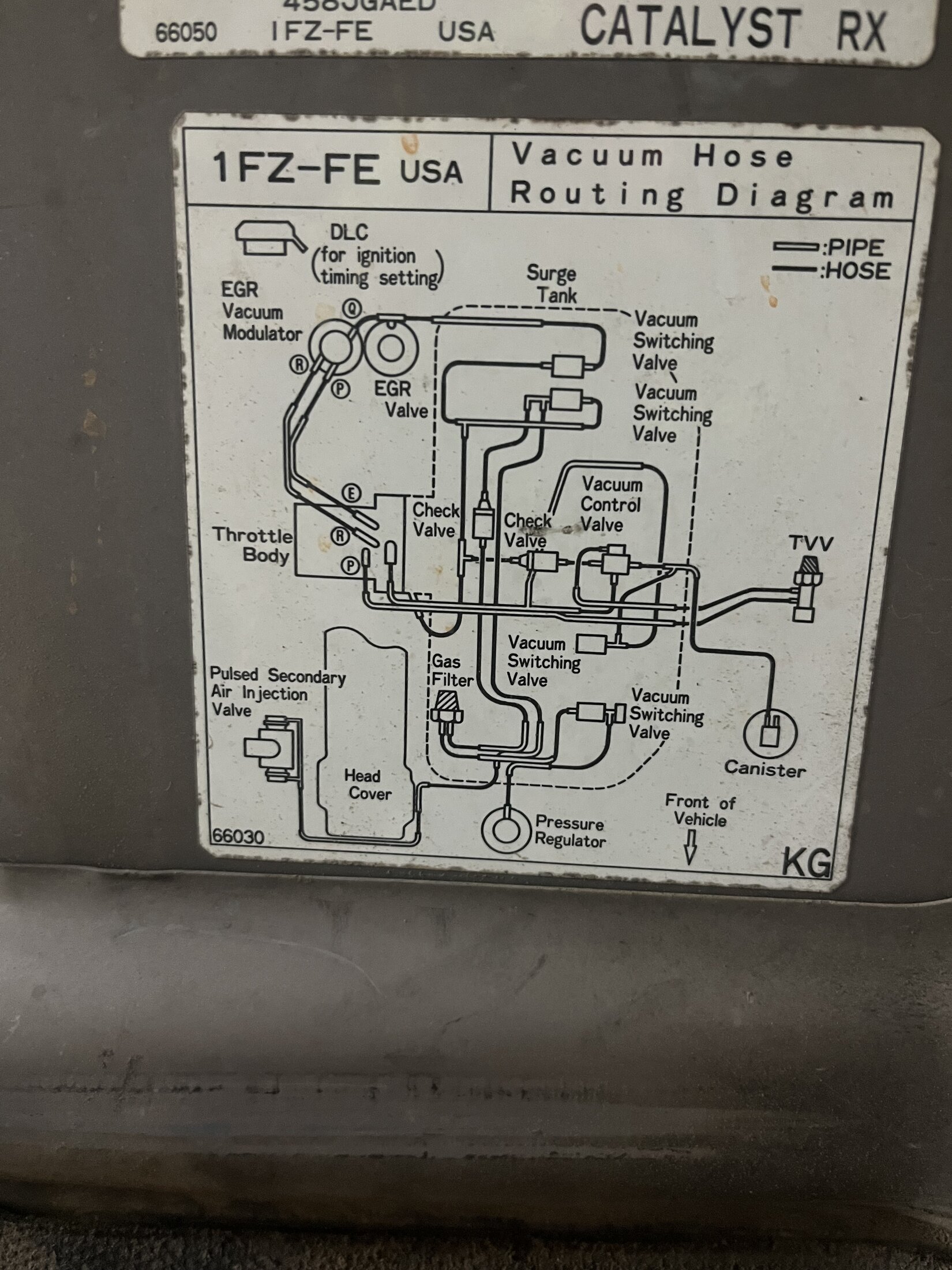

**Edited- I think I was just uninformed and all 93/94 80s had PAIR, oops
This is a post purely because I just figured this out and felt that it was an interesting bit of info.
I'd been trying to figure out what the heck this thing was mounted on the side of my head. My first thought was secondary air injection. But I couldn't find anything out there about that on 80s. So I thought maybe it was like a California emissions spec. But don't think my 80 came from cali.
Well turns out I was right! I looked at the vacuum diagram on the hood and sure enough it is a secondary air injection valve, and it does say this meets Cali emission spec. Maybe other peoples 80s say that same thing. But it seems a lot less common to have this valve. So guess I better get with it and make it go away!

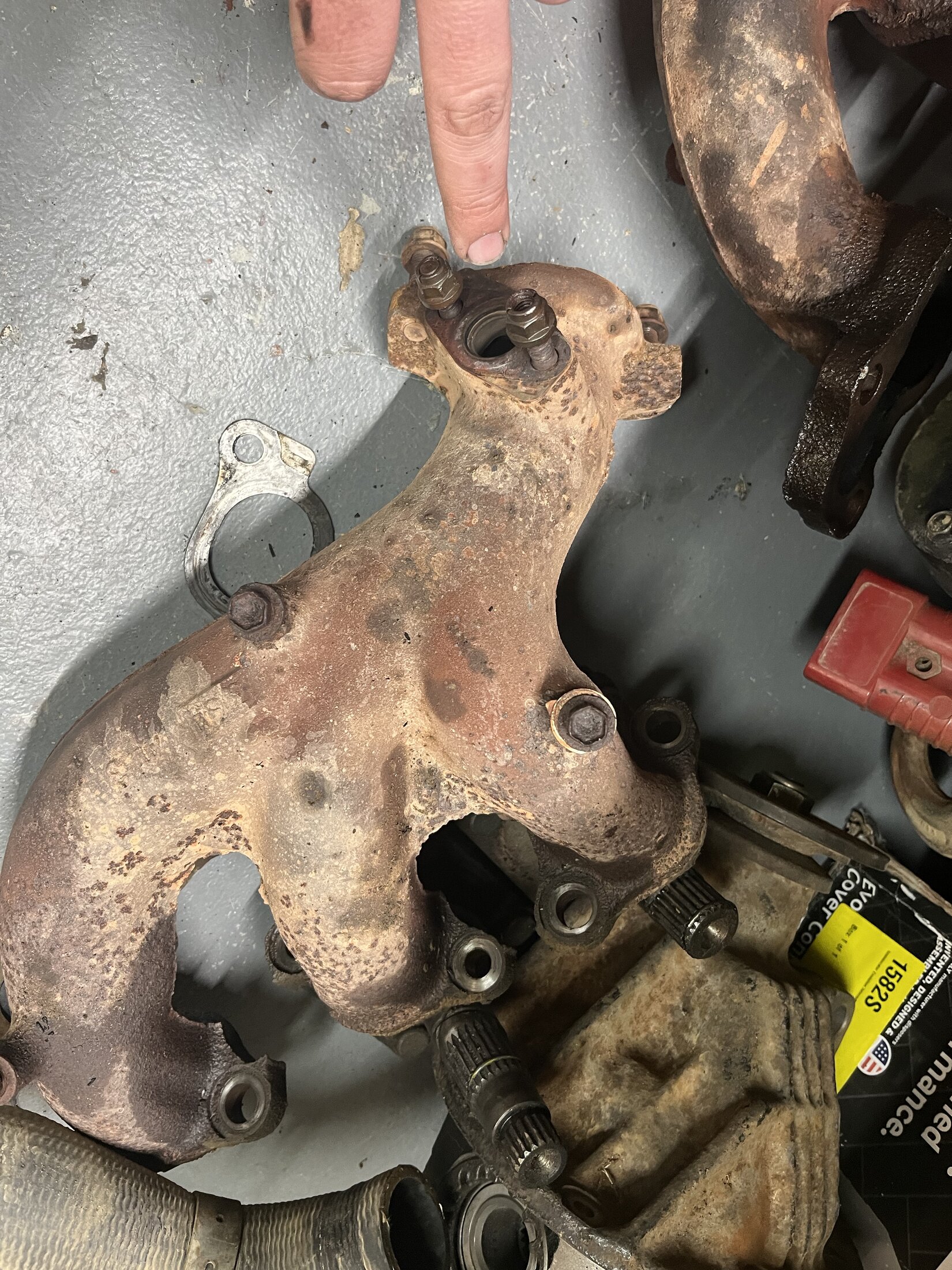

Get two new O2 sensors and put them into the manifold ports where the PAIR used to go. Disconnect the wires from the old O2 sensors (leave the old ones in as plugs) and swing the wiring up to the new O2 sensor locations and clip them in. Done.
This accomplishes two things. It gets rid of the failure-prone PAIR valve that will eventually start making "flubba, flubba" noises AND it gets your O2 sensors up high and living in a much better environment than down by the tire where they were, getting a constant bath of mud and water.

That's what I think I'm gonna do, I haven't had O2 sensors plugged in for a very long time so maybe I can finally ditch the CEL and get slightly better MPG.
I used to consistently get about 11MPG when I owned the 80 before with the O2 sensors u plugged or plugged in, but I'm down to 7-9 now
