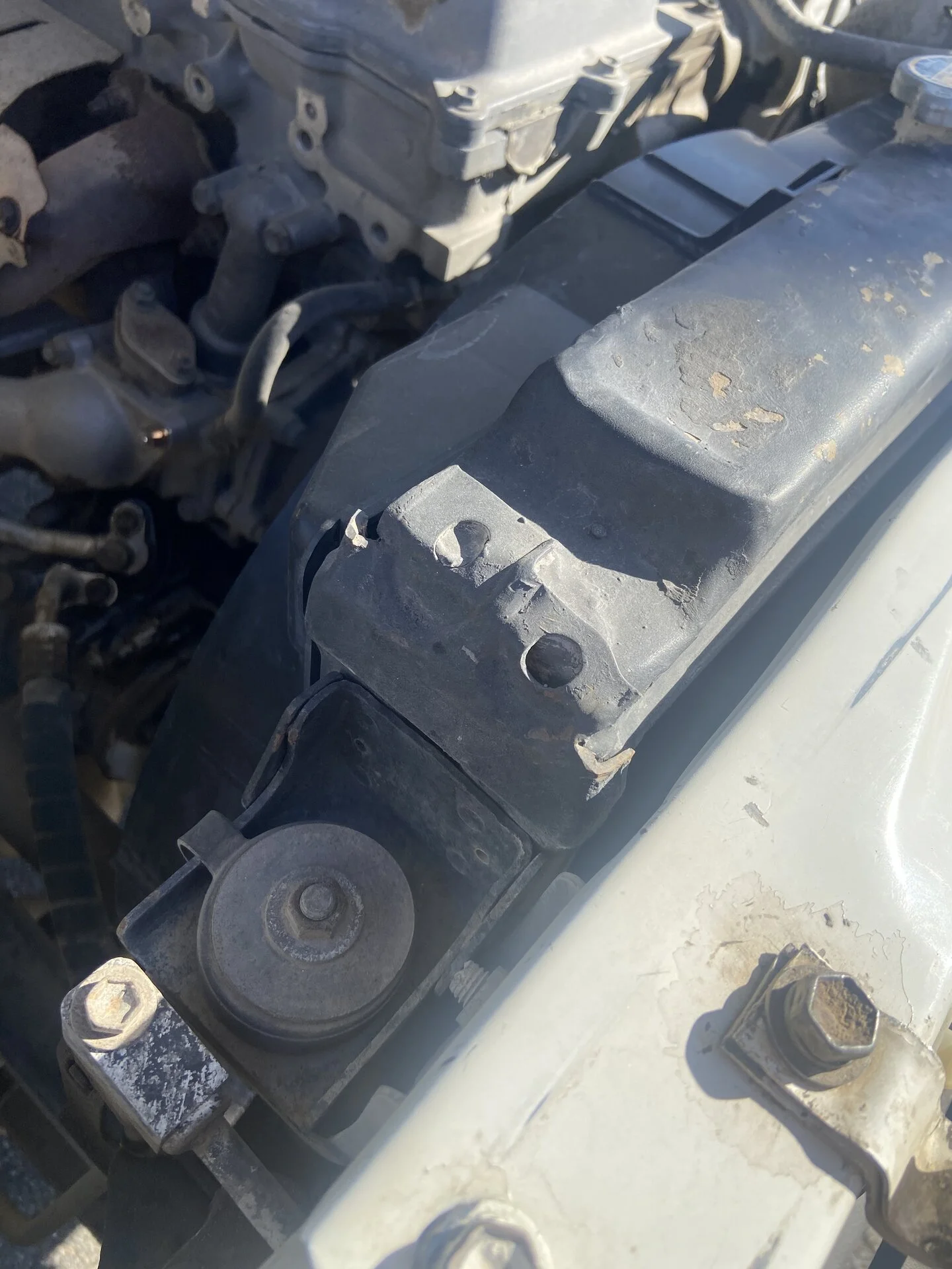

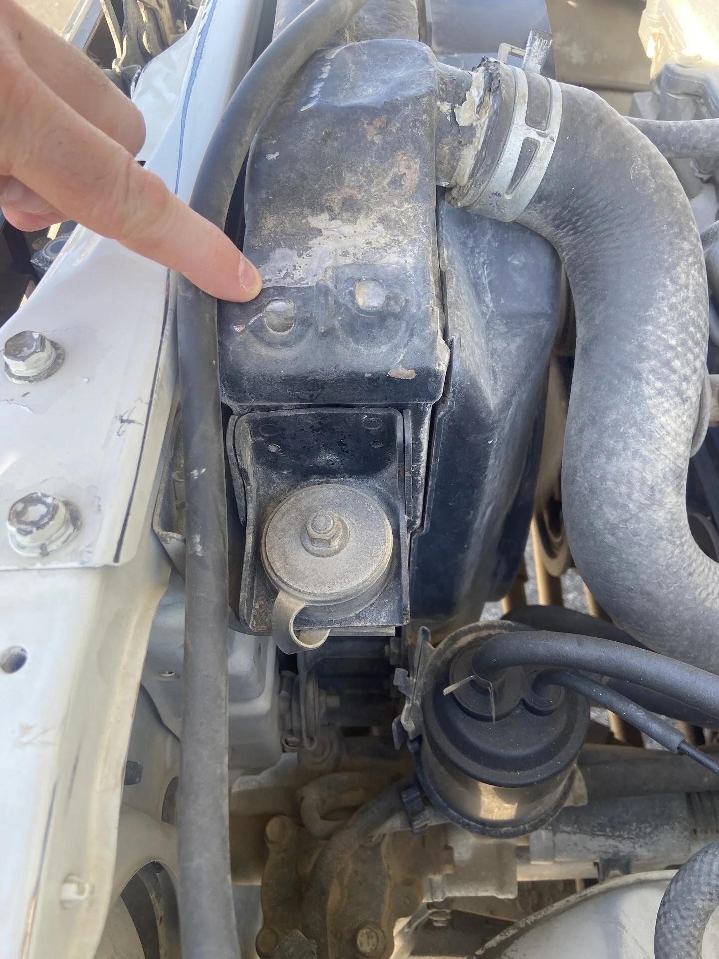

As I continue to search for a radiator, it would seem I need the left and right radiator supports - my troopy currently has an aftermarket radiator that they bent down the sub support assemblies on both sides to hold it in place.
5320260110/1 for the right hand side​
5320360110/1 for the left hand side​
Upon further inspection, it would seem that these are NOT the support brackets but rather something part of the radiator itself. This radiator was obviously rebuilt at some time.

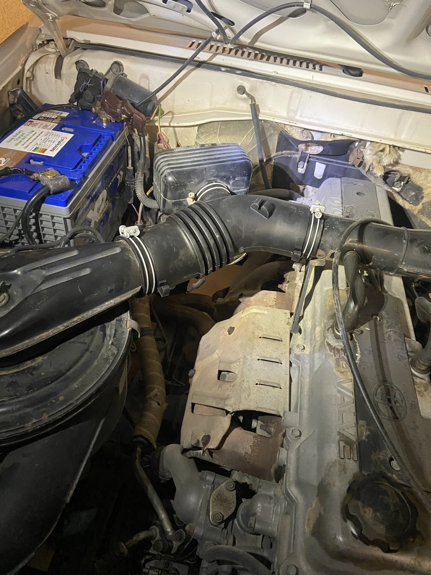

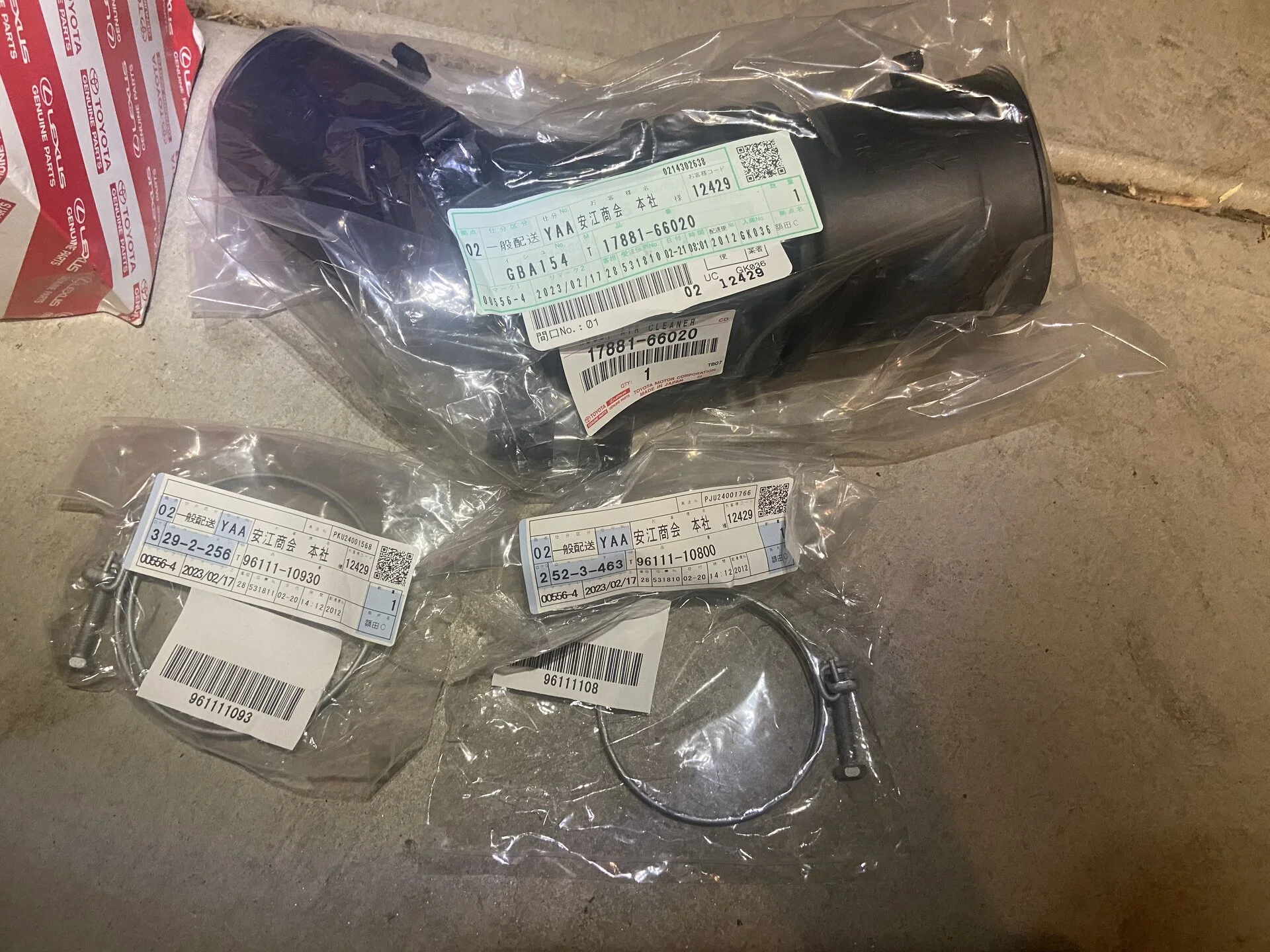

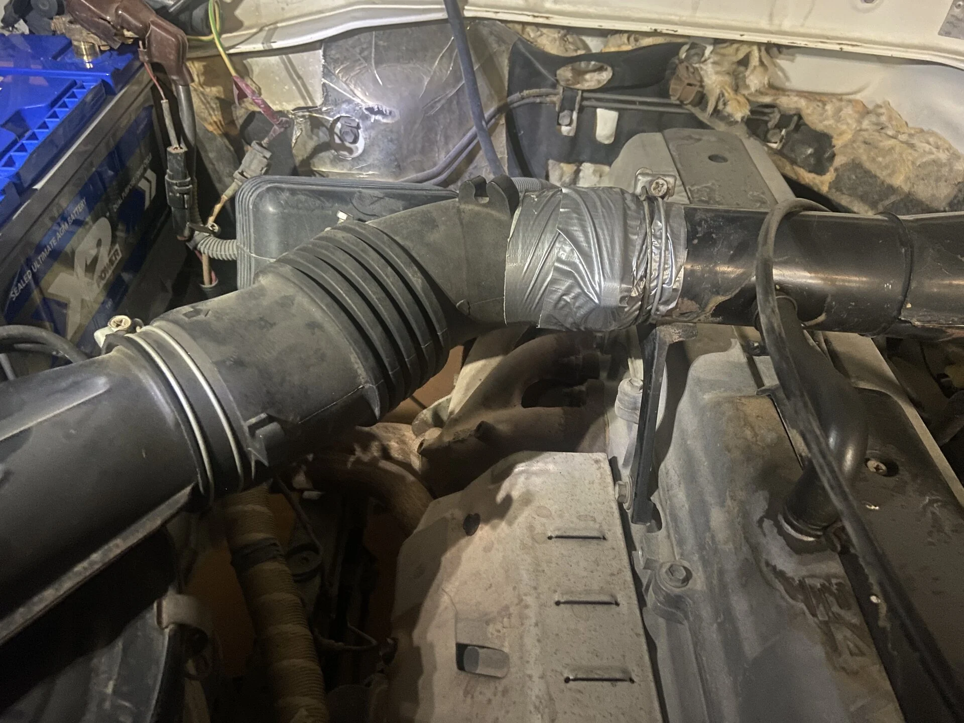

My current engine air intake hose from the cleaner box to my carb was dry rotted. So dry rotted that it was taped together using packing tape.
Installed the new hose with new Toyota clamps yesterday, along with a new OEM air filter.

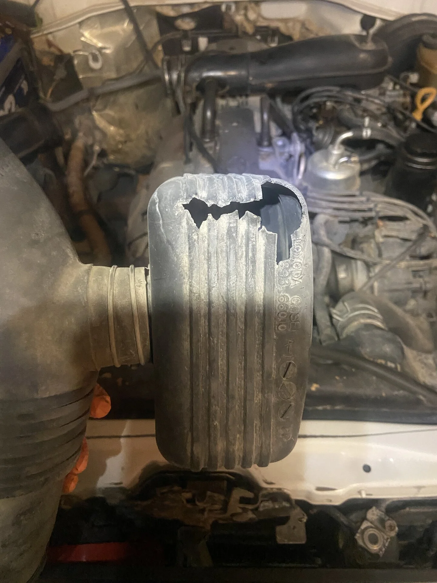

I should have checked the resonator though, the underside of mine was cracked and completely worthless, now a new one is on the way from Dubai.
Parts used:
Hose, Air Cleaner, No.1, Toyota 17881-66020
Clamp, Hose(For Air Cleaner Duct), Toyota 96111-10800
Clamp, Hose(For Precleaner Hose), Toyota 96111-10930

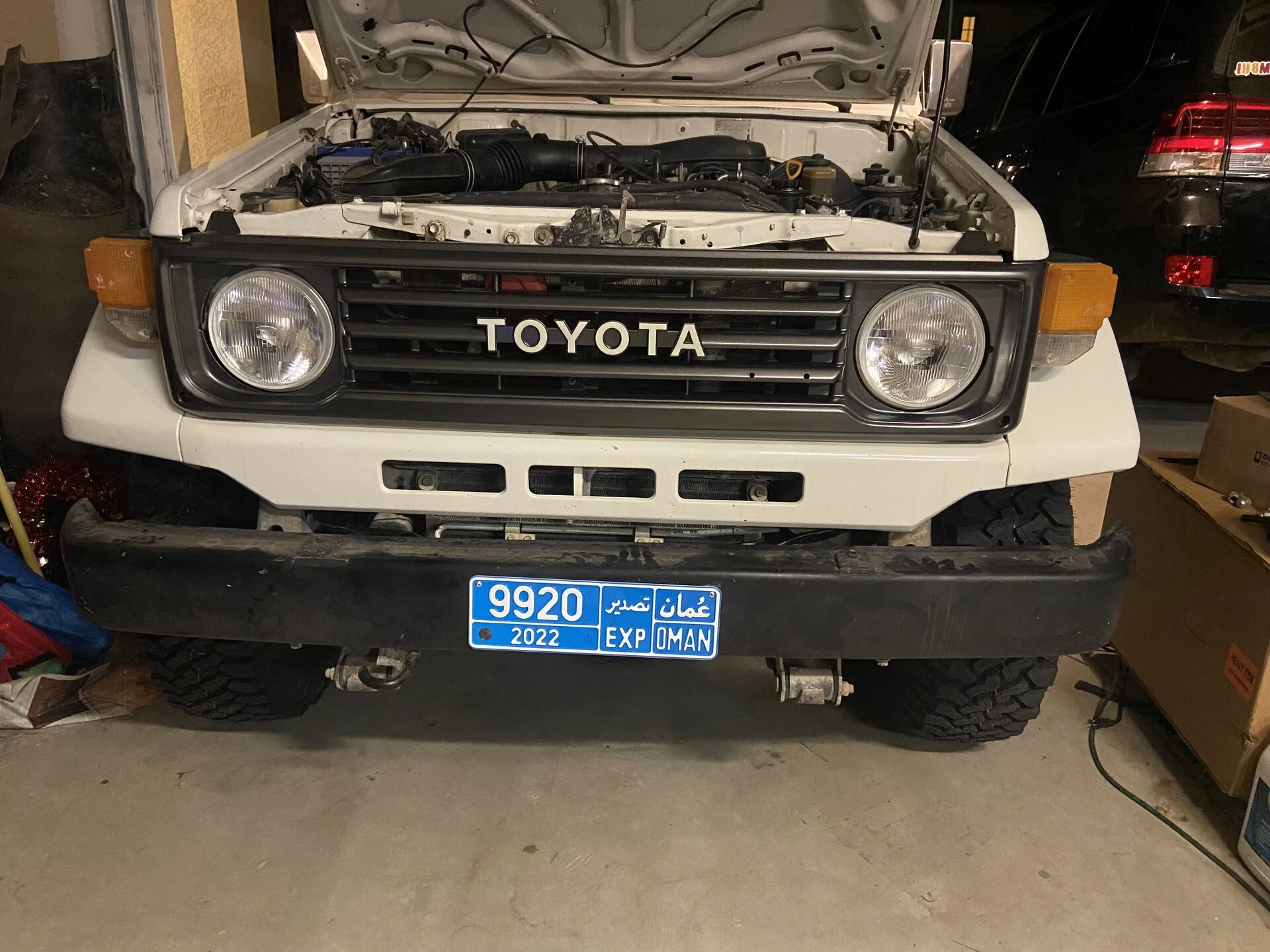

And last but not least, I changed out the sombrero grille to the TOYOTA grille. Purely aesthetics, but I think it looks 1000% better. Plus my old grille was a little faded.
Looks great with the new headlights.
I like that style grill. Kind of want one of those on mine, even though it’s not “period correct”.
I wonder when they changed? My 08-94 FZJ75 pickup has the TOYOTA grill.
Edit: In perusing some part's diagrams, it appears that the change was in 01-95.

Did you repurpose the duct tape from the duct to the resonator?

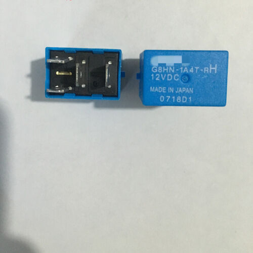

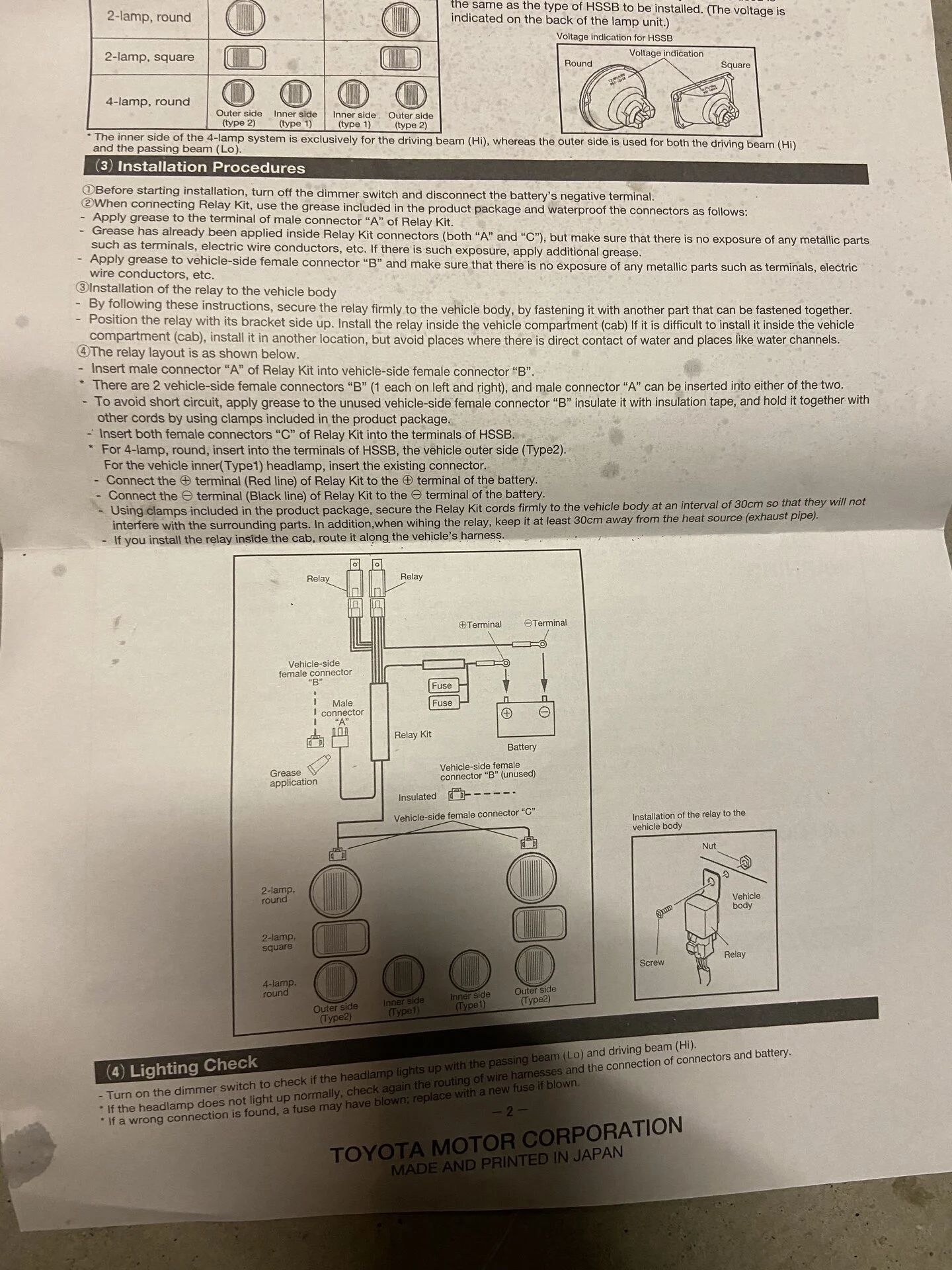

I put one of those light kits in mine a few years ago. I've been through 2 relays since, so carry two spares in the glove box. It's kind of exciting when you're cruising along at 60 mph and everything goes dark...
My truck is 24v though.
I sure did! Not as sticky the second time though.
Got a link for replacement relays?

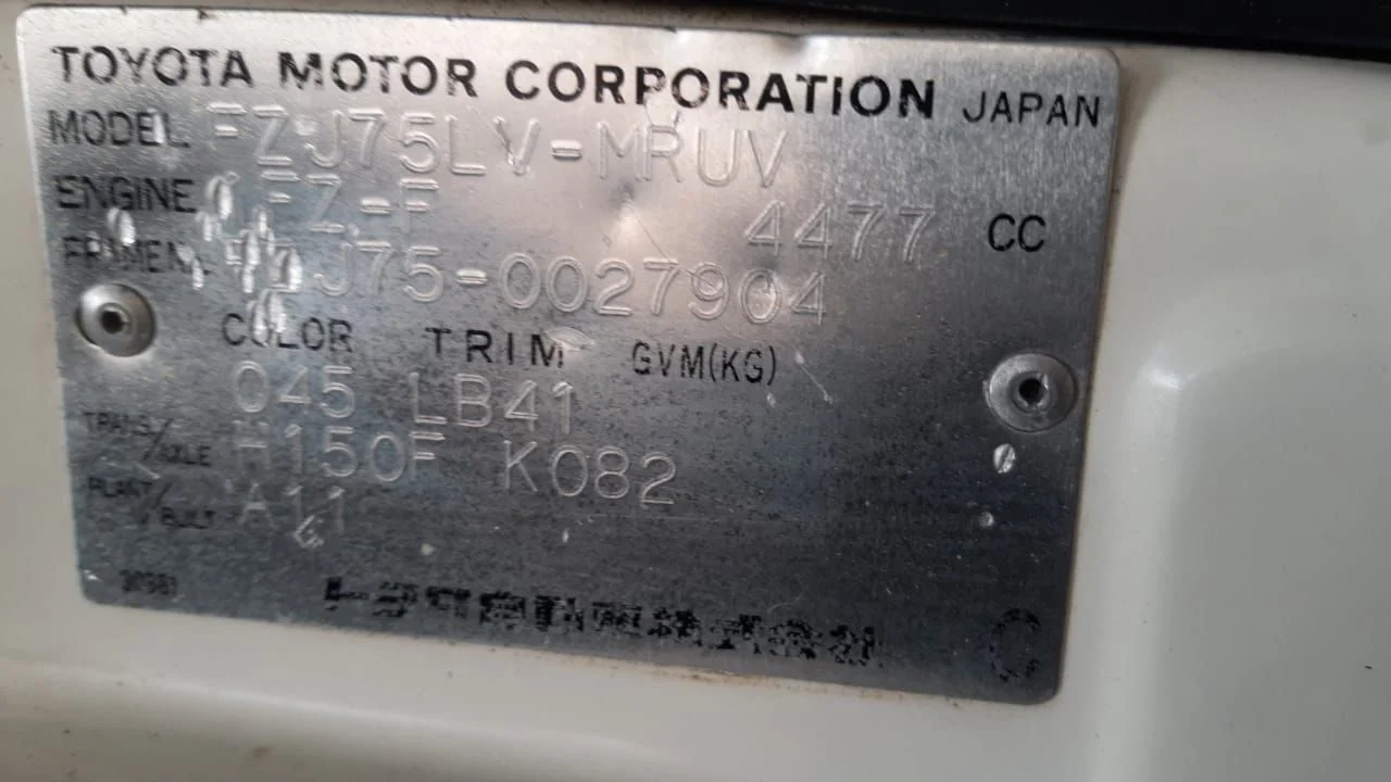

Trying to consolidate my oil capacities with H150F transmission and no diff locks.
Transmission per RM315E: 2.6 US qts, 2.7 liters
Transfer Case per RM315E: 1.9 US qts, 1.8 liters
Front Diff per RM183E: 2.7 US qts, 2.6 liters of SAE 90, API GL-5
Rear Diff (9.5inch full float) per RM183E: 2.6 US qts, 2.5 liters API GL-5
