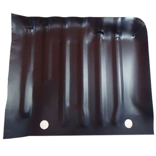

Is it worth it to buy an entire floor pan to replace? One currently available from Japan online.
Replacing the entire floor pan would be a big task and shipping one would cost more than the part. I'd go with something like this, not sure if there's a domestic supplier, these are from Aus but description says that they'll ship to the U.S. I need to do mine too, but have to fix the windshield frame/leak first as that's the source for the water in my floor pans. Take a close look around your windshield too, these are notorious for leaking there.

New floor pan rust panel replacements from Australia arrived. Great fitment and the excess from the good parts of my pans should be able to help extend up the firewall. Thickness is just over 1.0mm so 18 to 20 gauge it would seem.
