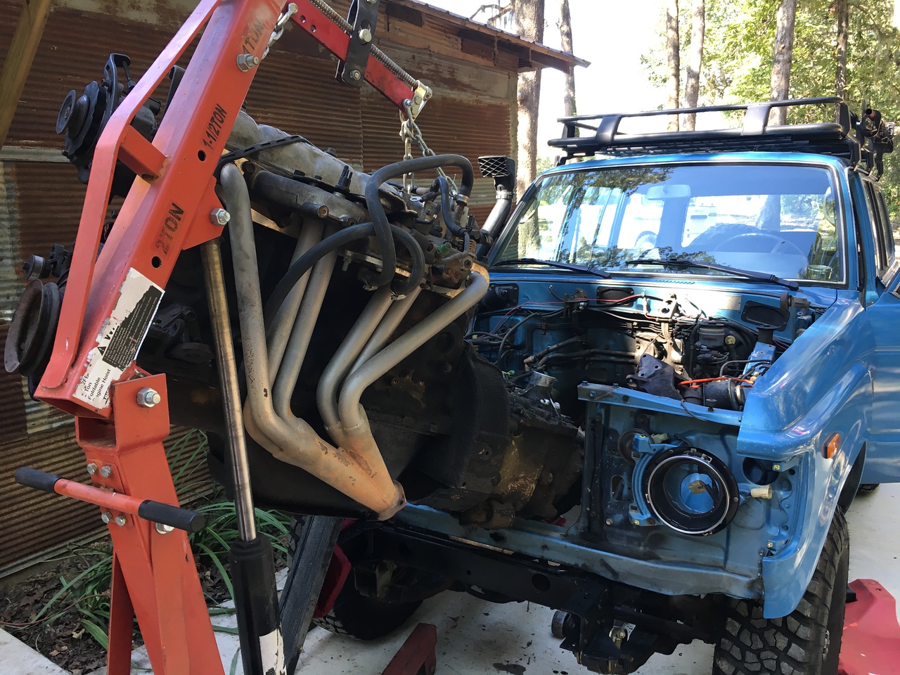

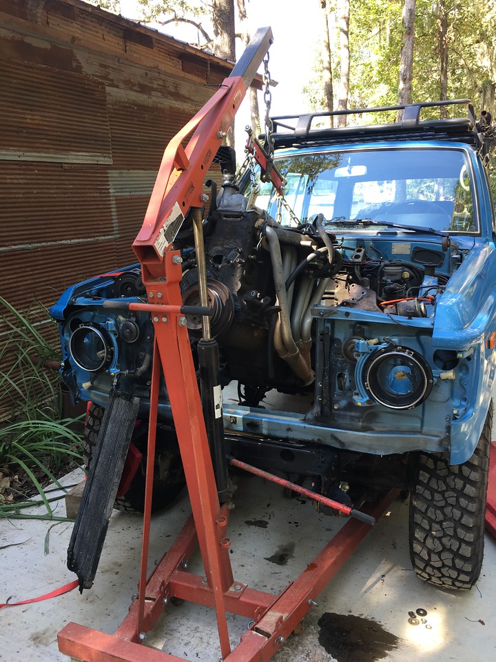

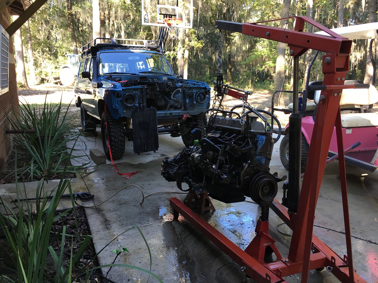

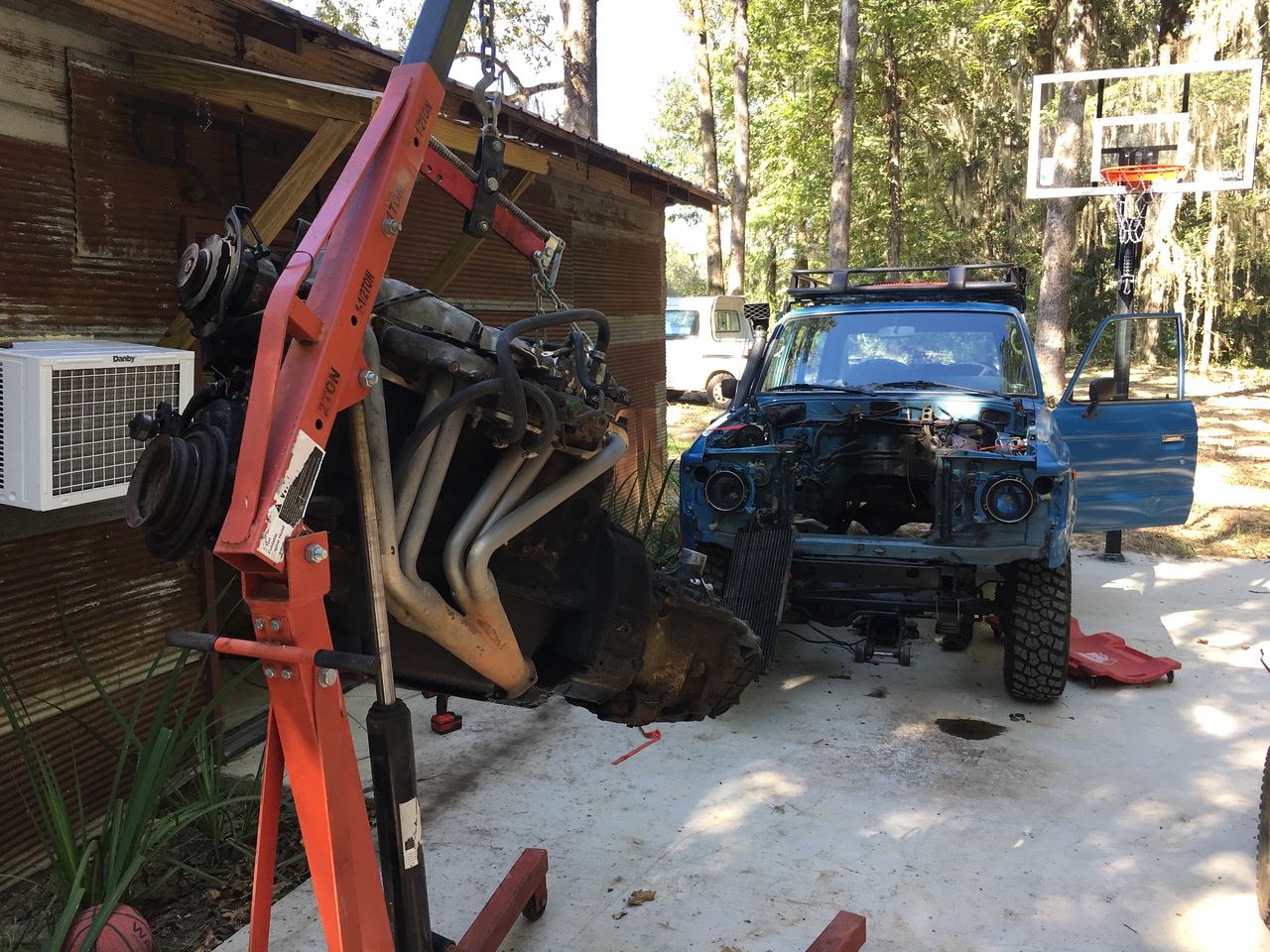

I pulled the truck around to the future lift worthy shop pad to get a nice level surface to pull the motor on Sunday.

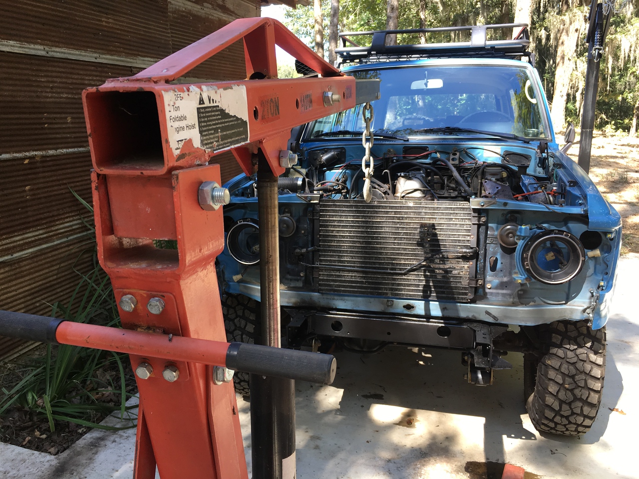

At about 3 I decided to go fetch the engine hoist out of the equipment shed so I could mock it up and get a plan.
We have 2 tractors and 4 trailers but the pink cart was the tool of easiest use
I really wasn't planning on going all the way. I just wanted to stick the tip in.......
But it felt too good.......
Almost there......
OOOOOOFFFFFFFF

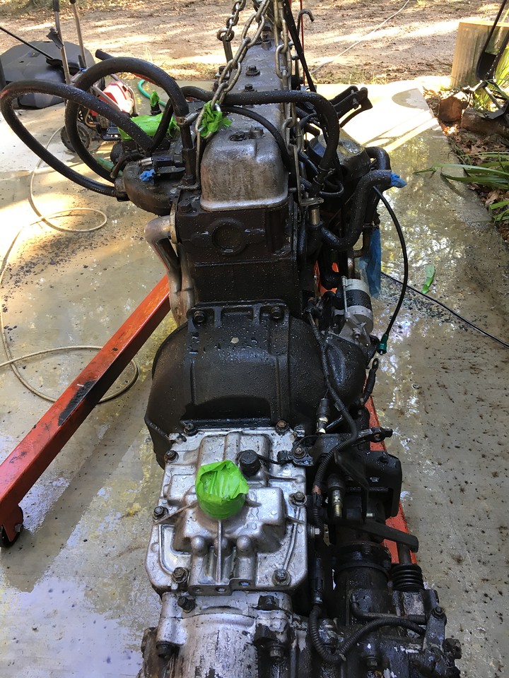

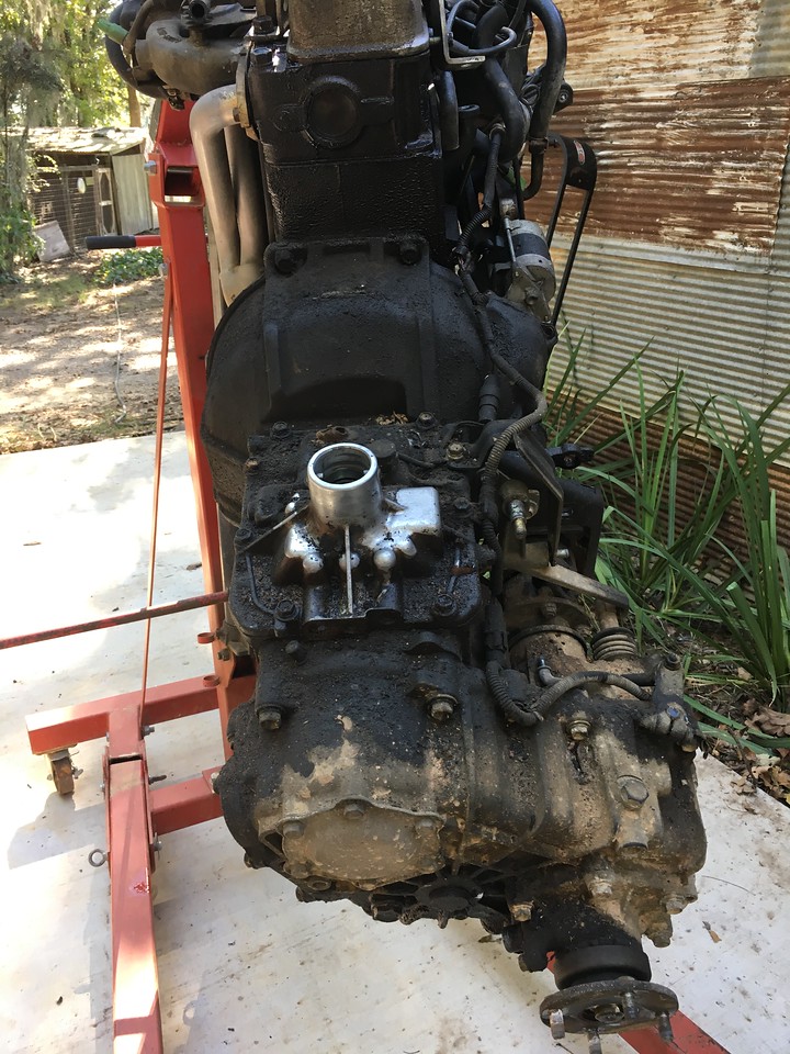

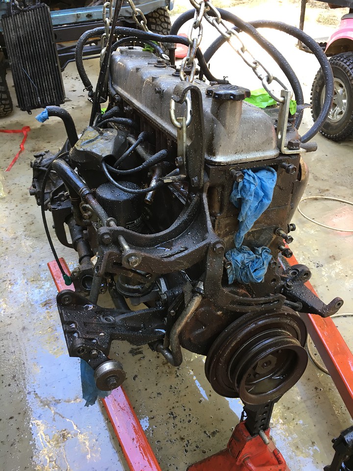

34 years of hell....one documented case of dunking in the Ross Barnett Reservoir and a few gallons of motor oil blowback makes for one seriously nasty product.
There was a foam wrapped around the top of the transmission by the shifter...that is the only reason that part was clean

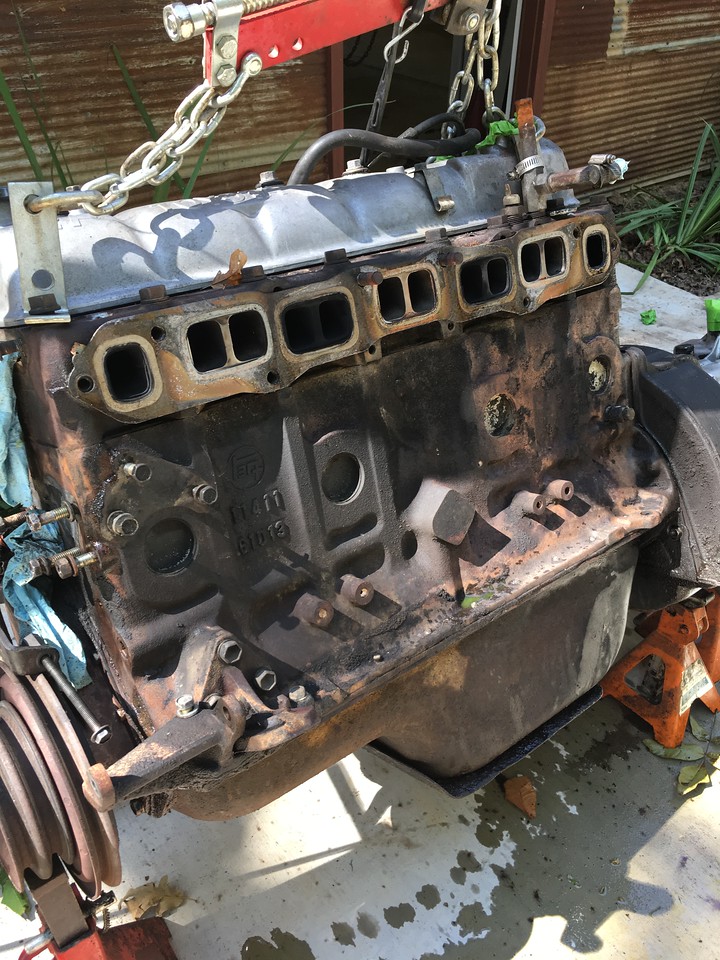

Bare.....I can't wait to get in here with some Simple Green and some elbow grease.....
45 minutes with the pressure washer.....
I'll start unbolting stuff now that there is not 3" of greasy sludge on every bolt.

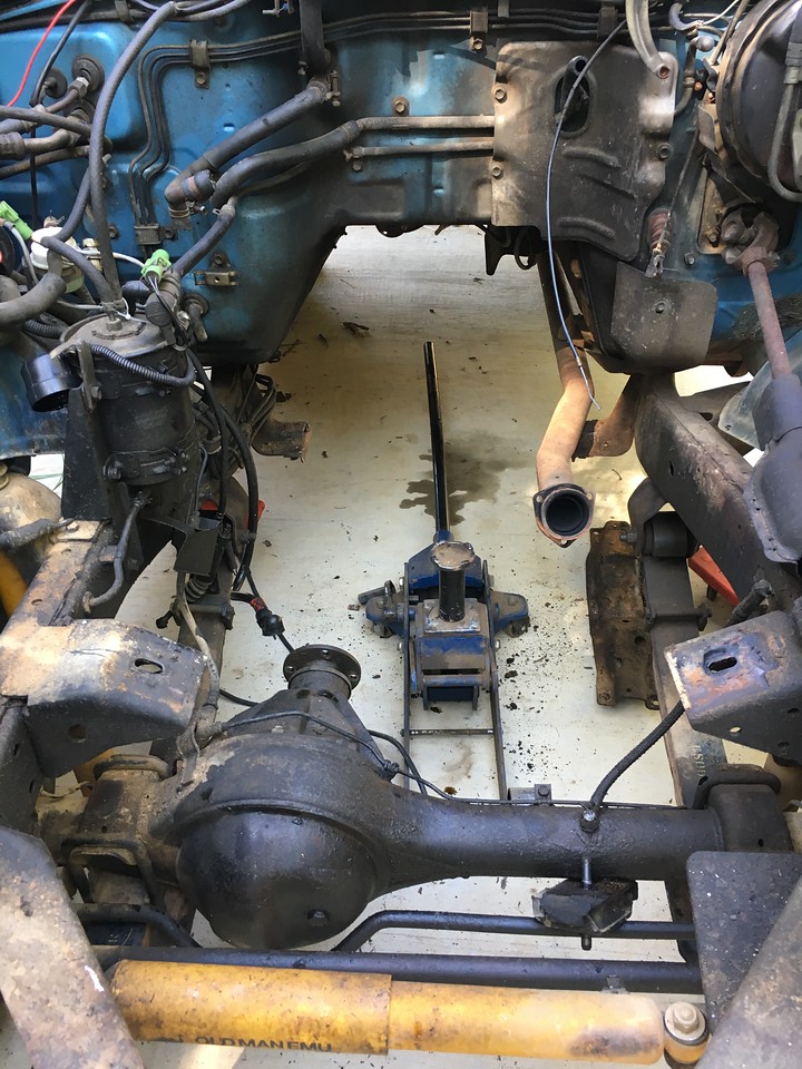

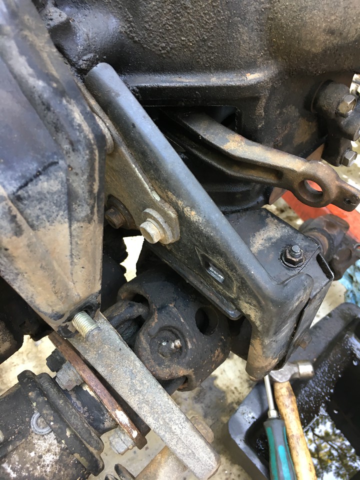

I peeked under the truck to see where the electric fuel pump and filter are gonna go and added this nasty ass part of my truck to the to-do list

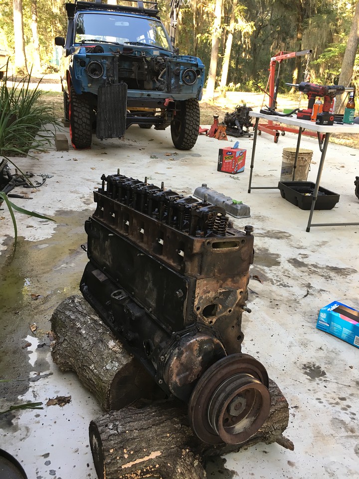

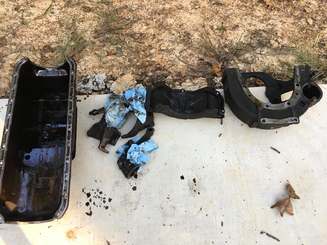

@under_psi came out and helped me separate the tranny and Tcase from the motor and bag and tag all the parts today.

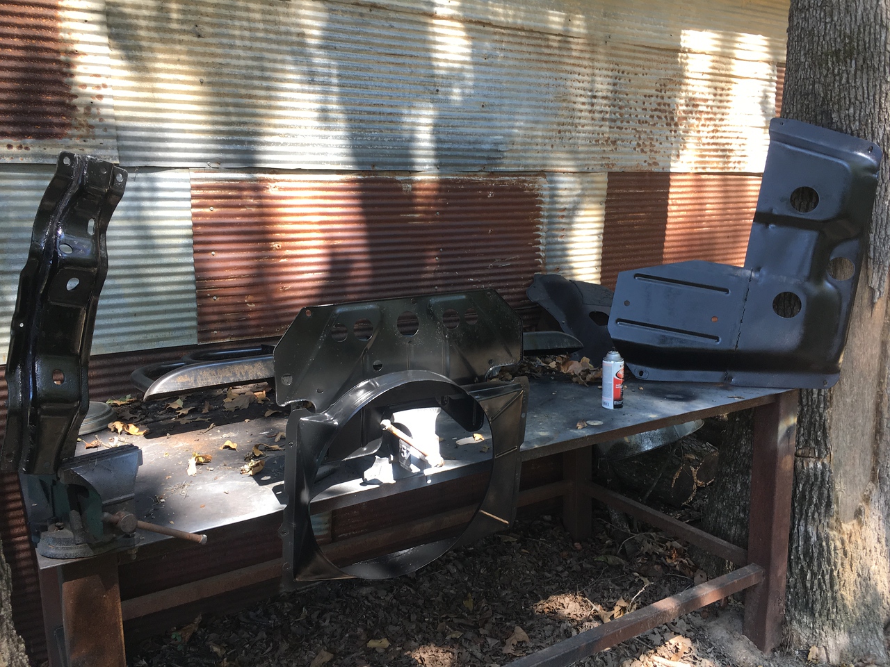

First I painted all the stuff I needed to paint
Then I started yanking the stuff off the motor.....
This front driveshaft cage is maddening. I GEOGeld it and I can toss this s***......
Stripped and bagged.
Im renting so time in the power parts washer at 49Tire tomorrow to clean all this stuff....
