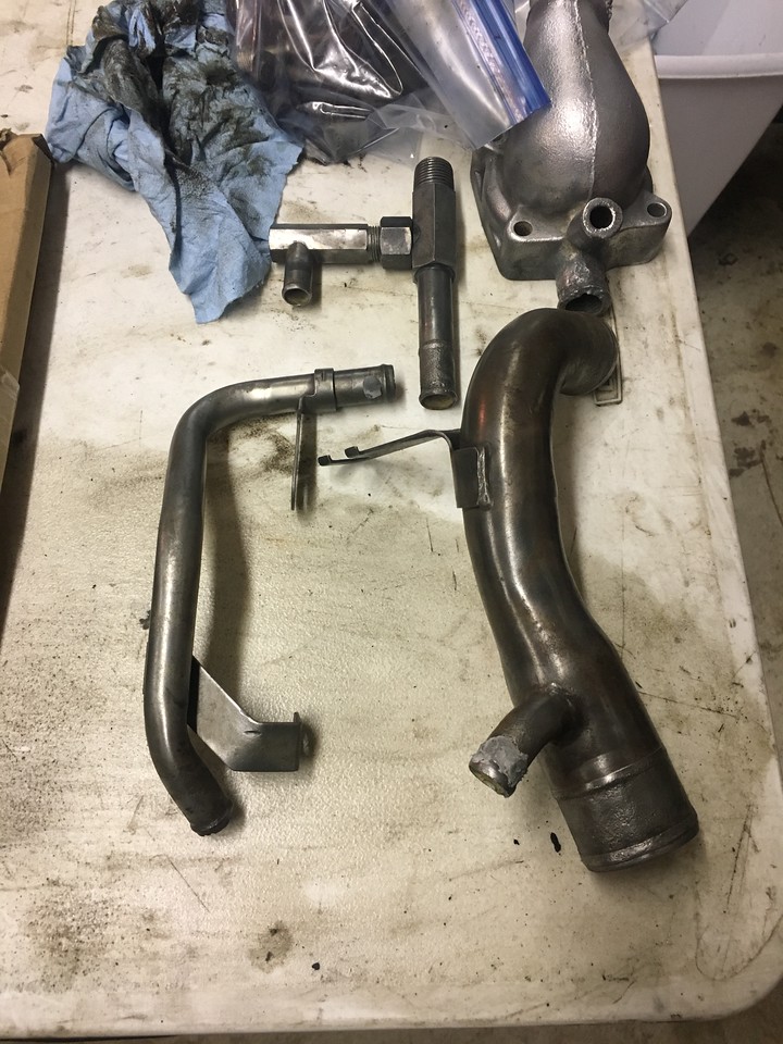

A little aluminum engine paint on the Coolant pipes
Thermo housing polished and sealed with some polish.
Polished to a clean dull aluminum. Not polished. Hate that. Used a nice wheel paste that adds a little wax type seal so it won't tarnish immediately like they donif you just wire brush.
That thermo housing is thrashed. Need a spare? Might have one in the parts stash.
Might be able to get away with putting JBWeld on the pitting and smoothing it out. That thing looks like it's trying to start a coolant leak :lol:

Thanks for the offer. I'm going to smooth it out with some JB Weld. It is fine. Most all of mine have been this way.

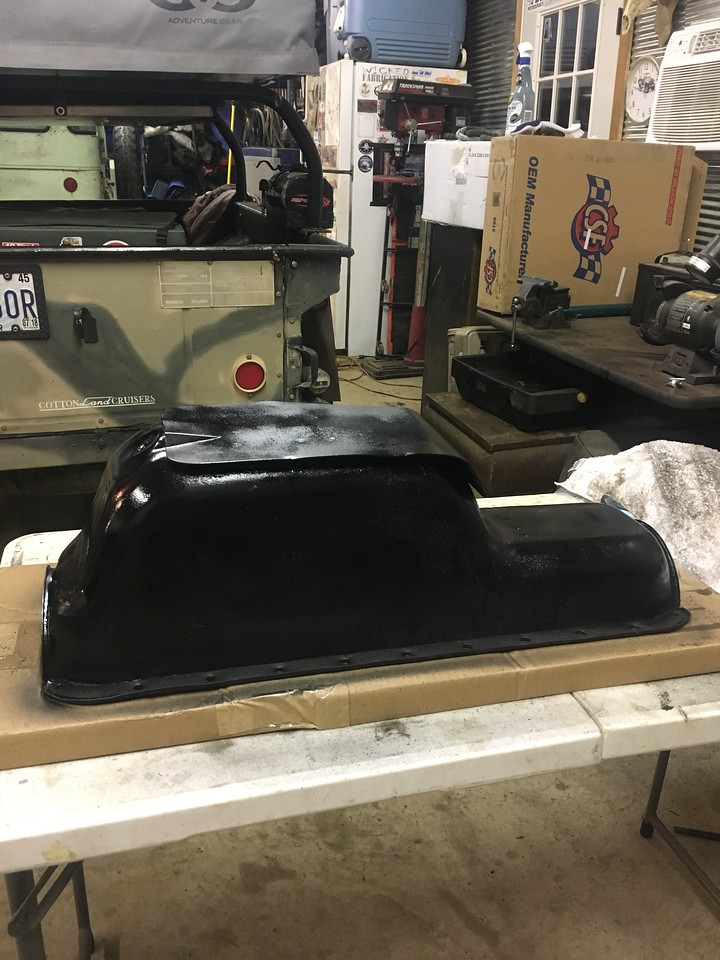

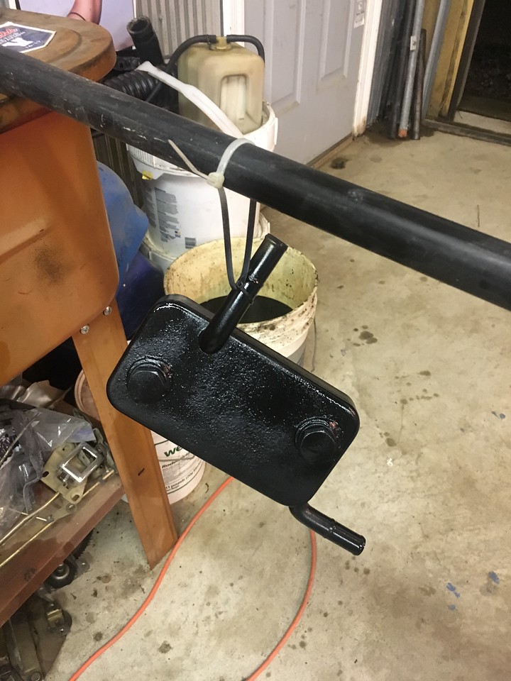

Knocking crap off all the parts going on my pretty motor.....I had so much oil and grime, its crazy.
I added liquid steel on the thermo housing and all the pinholes I could find in the tubes. I'll let it dry and polish it all smooth(ish)
