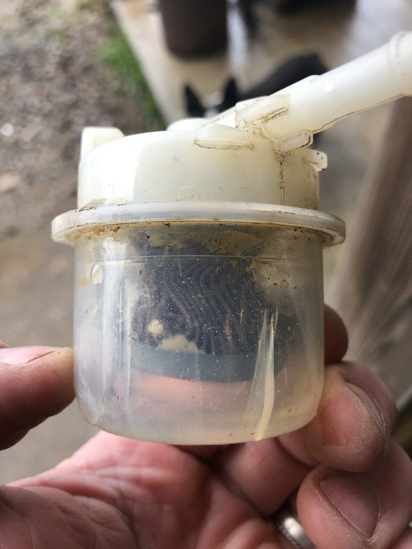

I stopped and gassed up wherever I could and it looks like I got a load of trash during one of the fill ups.
On the first trail after a good bit of bouncing around (1100 miles into the trip) Ole Blue started bucking and starving for fuel.
I suspected I killed another pump and climbed under the truck and found that both the Pre filter to pump and the post filter under the hood were brown and clogged.
What’s really odd is how the inner paper twisted like this.
Have y’all ever seen this?
Looks like the filter collapsed under vacuum from being clogged. If the EFI pump is upsream from this, feeding this filter, then it collapsed under pressure, but I'd bet your EFI pump is fed by this filter.

x2. You want a filter intended for EFI.

The AFI EFI is low pressure so wouldn’t it be fine with any filter?
I’ve certainly got no problems adding a high pressure rated just trying to learn here.

How many PSI is "low pressure"?
Remember that the filter in question operates under slight vacuum in the OEM application, not under any pressure at all.
I have run the glass/chrome cheap fuel filters with the replaceable/cleanable element for 25 years. I think they are kind of hack now but 25 years ago it was the only thing I could find at the western auto store to put between my fuel tank and efi frame mounted pump. The filter after the pump should metal bodied in my mind. I have used these from Holley, but my favorite way to do it is take the factory fuel lines from Chevrolet with a tbi and just use the factory style filter inline. They are not as common at pick and pull these days but I almost guarantee there is still a set of fuel lines with filter at every pick in pull in the county. The tbi and computer get taken first. Holley EFI 562-1 Fuel Filter
I would run a metal filter from a mid 80’s tbi truck. Something that matches the barb size.
No element to collapse on those.
I’ve got some Wix that @FJ60Cam gave me for my high pressure Holley Sniper. It’s metal. I’d like to get a universal filter setup going between the two trucks. I’ll check the part number on it tomorrow.

Yeah that pre filter was the one that twisted up.
That said, I had 2000 or so miles on this setup before the trip with no issues.
I’ve been using the same filter on all of my Cruisers. It’s the OEM FJ60 filter that goes in the engine bay.
Pre and post pump. One on the frame before the low pressure Walbro. One in the stock location. AFI only calls for a pre-filter. The one they sent was a Chinese piece of crap metal filter.
I could not monitor the “redneck aquarium” with that filter (superb description) , so I ditched it.
