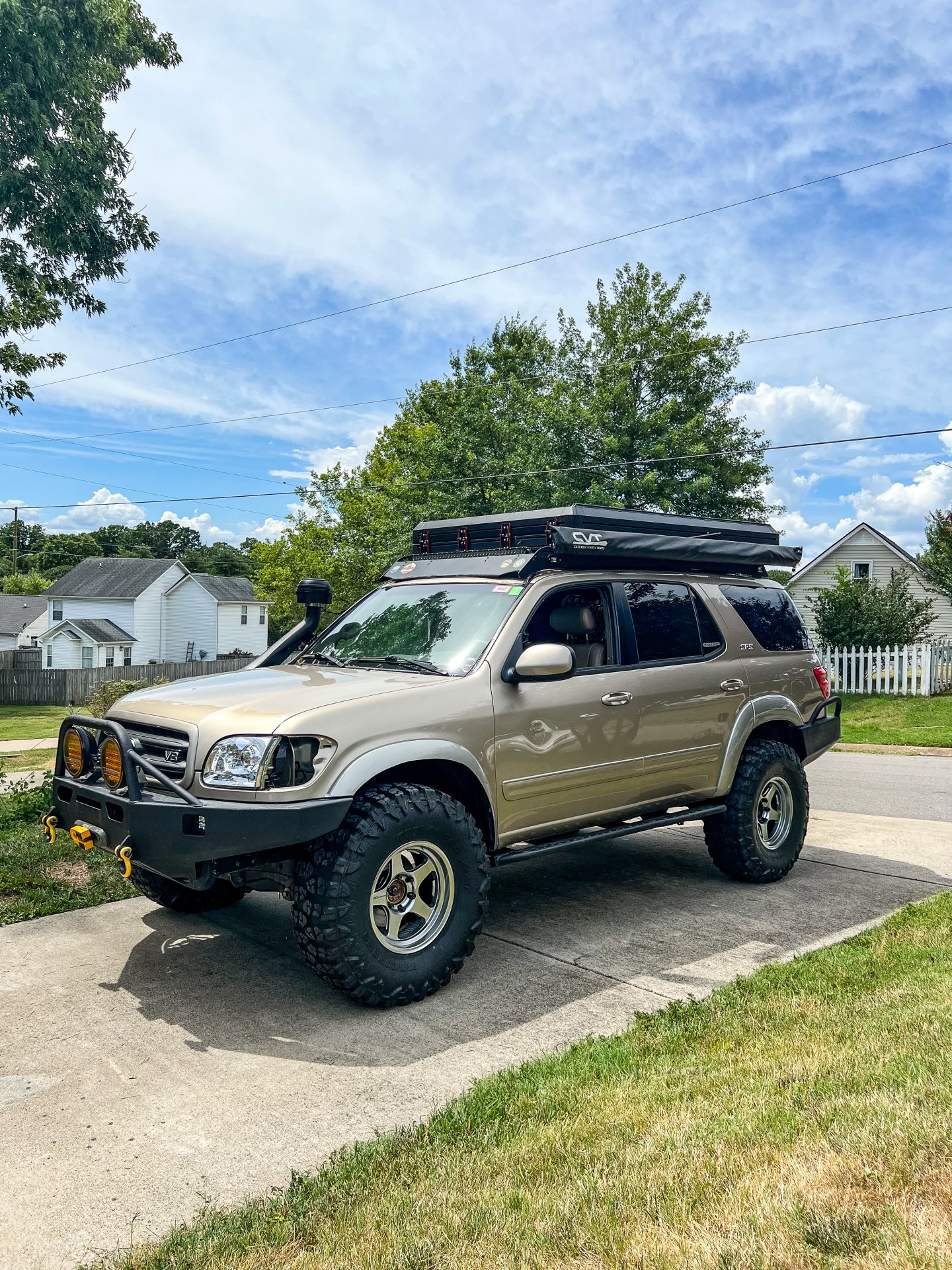

After spending multiple years in the drifting and import racing world I decided to finally hang up the hat and get back outdoors to nature. At the time all that I knew I wanted was a Toyota, preferably a V8, and definitely 4WD. At the time I was looking at a GX470, 100 Series LC, and a Sequoia. A few days before I was about to head down to Georgia to look at a few of those vehicles and make my choice a 2002 Toyota Sequoia SR5 4WD showed up down the street from my then work with only 134K miles on it. It was listed at $7,400. So on lunch I decided to head down and take a look. Leather interior, body in decent shape, and with no major mechanical issues seen I offered $6,000 and my Offroad/overland adventures began.
The goals (at the time) for this build were simple; a RTT (my wife wouldn't go camping with me otherwise) and some decent all-terrains as I had planned on this to be my daily driver. Plans changed quickly as I fell in love with the vehicle and spending time outdoors with the truck. Each trip we would come back with new problems to solve and would set out to fix them immediately. I then was fortunate enough to be noticed by a local-ish group of Land Cruiser guys who welcomed me into their chat and things kind of took off from there to the point we're at now.
So I'll begin with the current modification list (or at least as much as I'm able to remember):

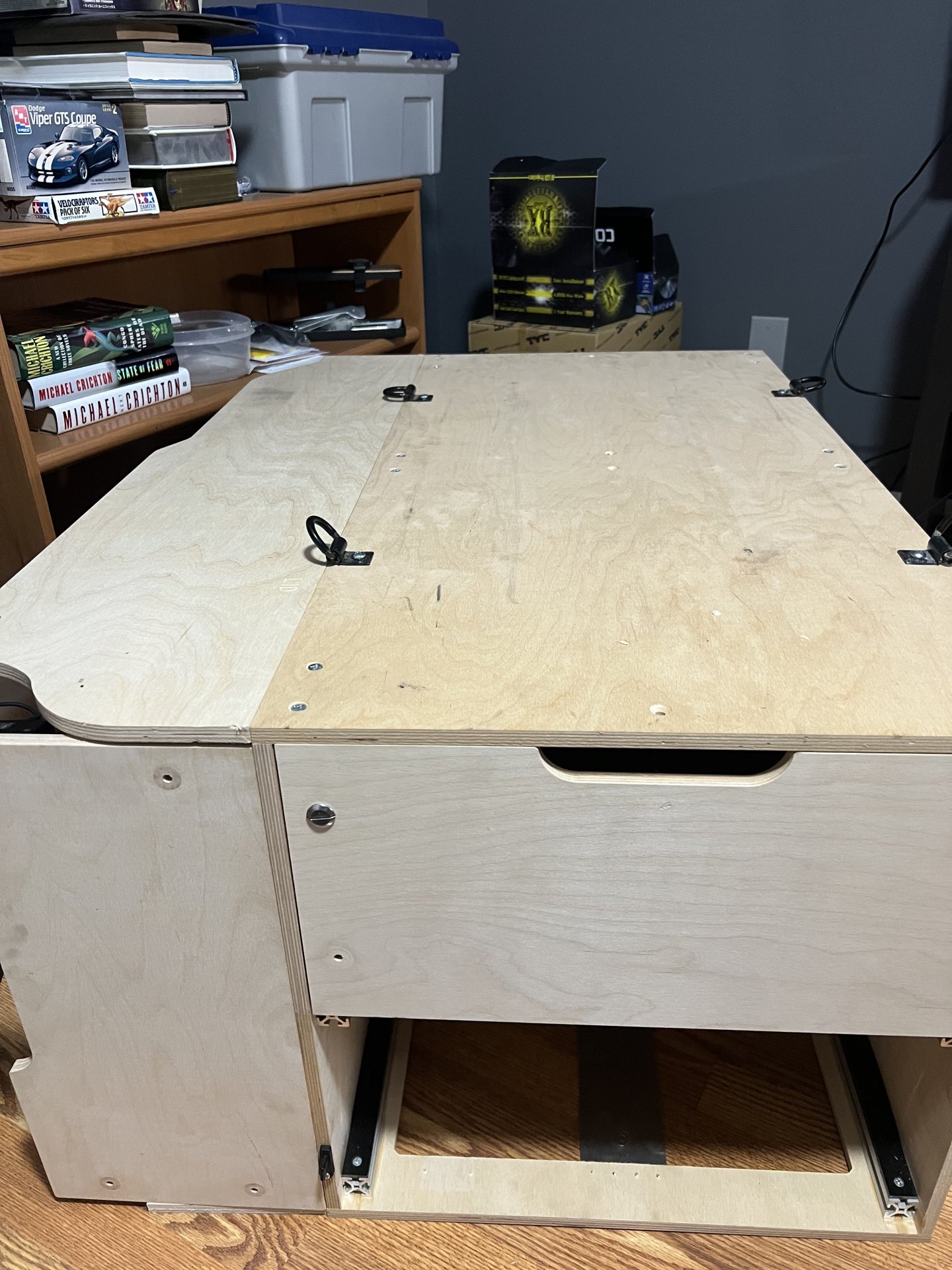

Can you go more into detail with your drawer setup.
I can.

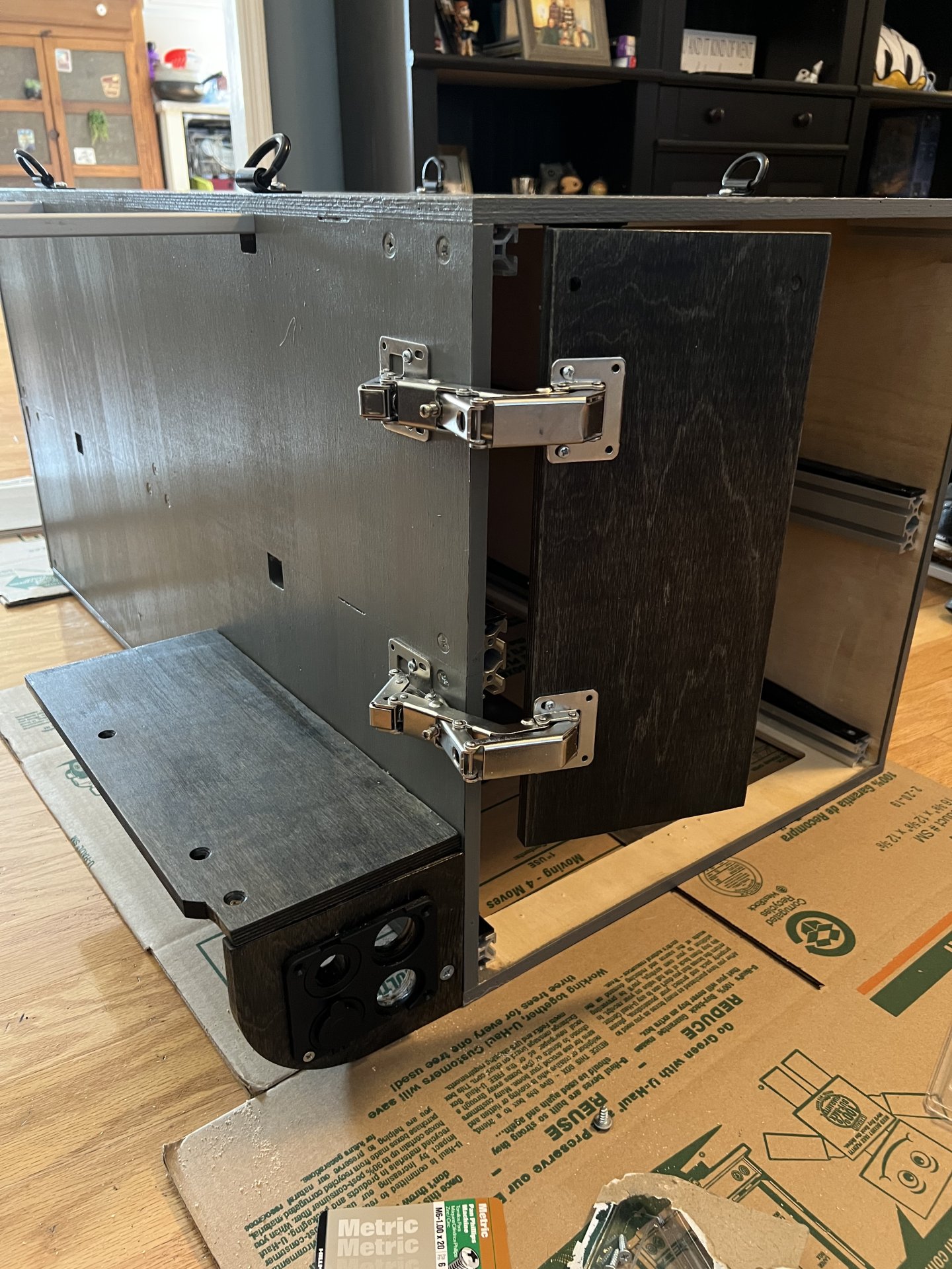

A friend introduced me to LandShark Outfitters about a year ago. I liked the price and lack of slides (no noise) so I grabbed a single.
As time went on I added the reef bar and the cutting board options for more space. End of last year I got tired of not having enough storage for dry foods for longer trips (1-2+ weeks) and not having a fully integrated charging system for gear. This lees to me deciding to do a double reef (2 Reef 40s and an adapter to stack them) along with a custom wing kit that has a lower control panel, and a hinged door above it for additional storage. Took a bit of time and a lot of measuring but I managed to get it about perfect. Then I stained the wood Espresso and Gray, gave it a satin laquer and had a few beers.
Lined the drawers with acoustic carpet and got it mounted down. Loved the new setup and how quiet it is. Zero maintenance.

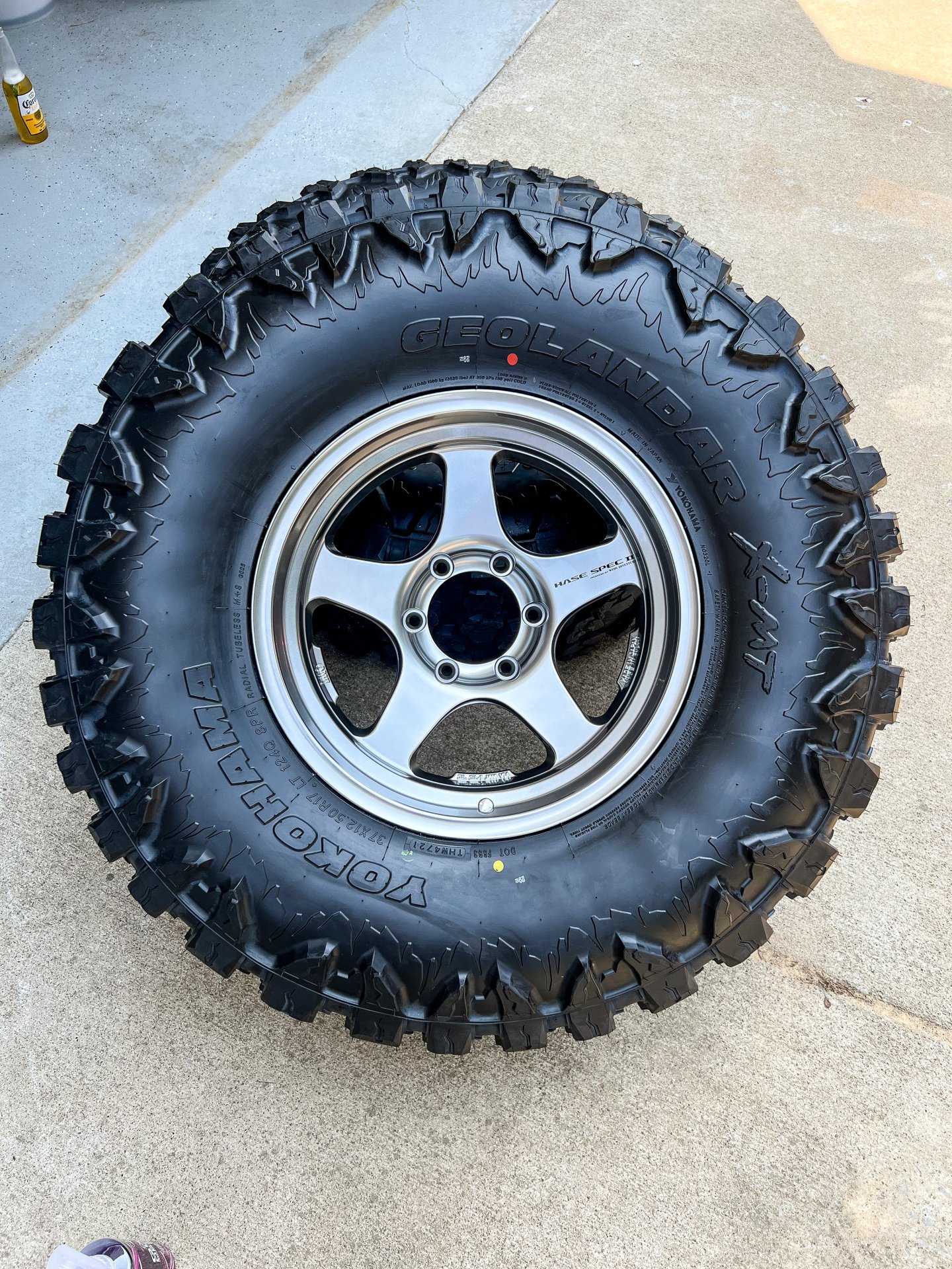

So it’s taken some time but finally making some headway. New wheels came in; Weds Hase II 17x8.5 -6 (will space out as needed) and the 37x12.5 17 Yokohama X-MT. This setup is going to be super beefy and I can’t wait to get it rolling.

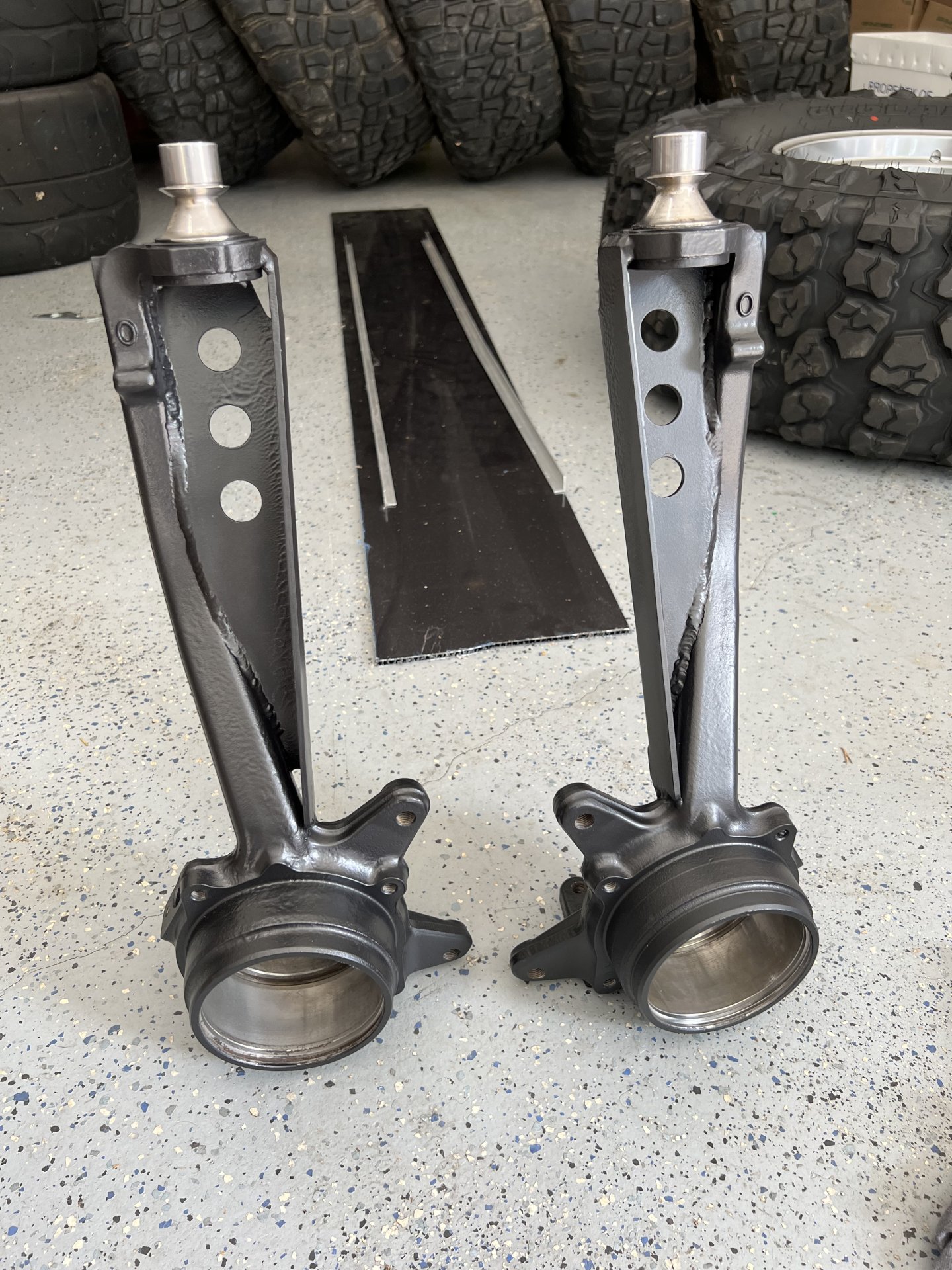

Spindles came back from my fabricator, but someone burred both of the heim joint mounts so we’re sorting that out. In the meantime I’ll be getting all new Toyota bits put back in the hopes they’ll last me longer than the last set.

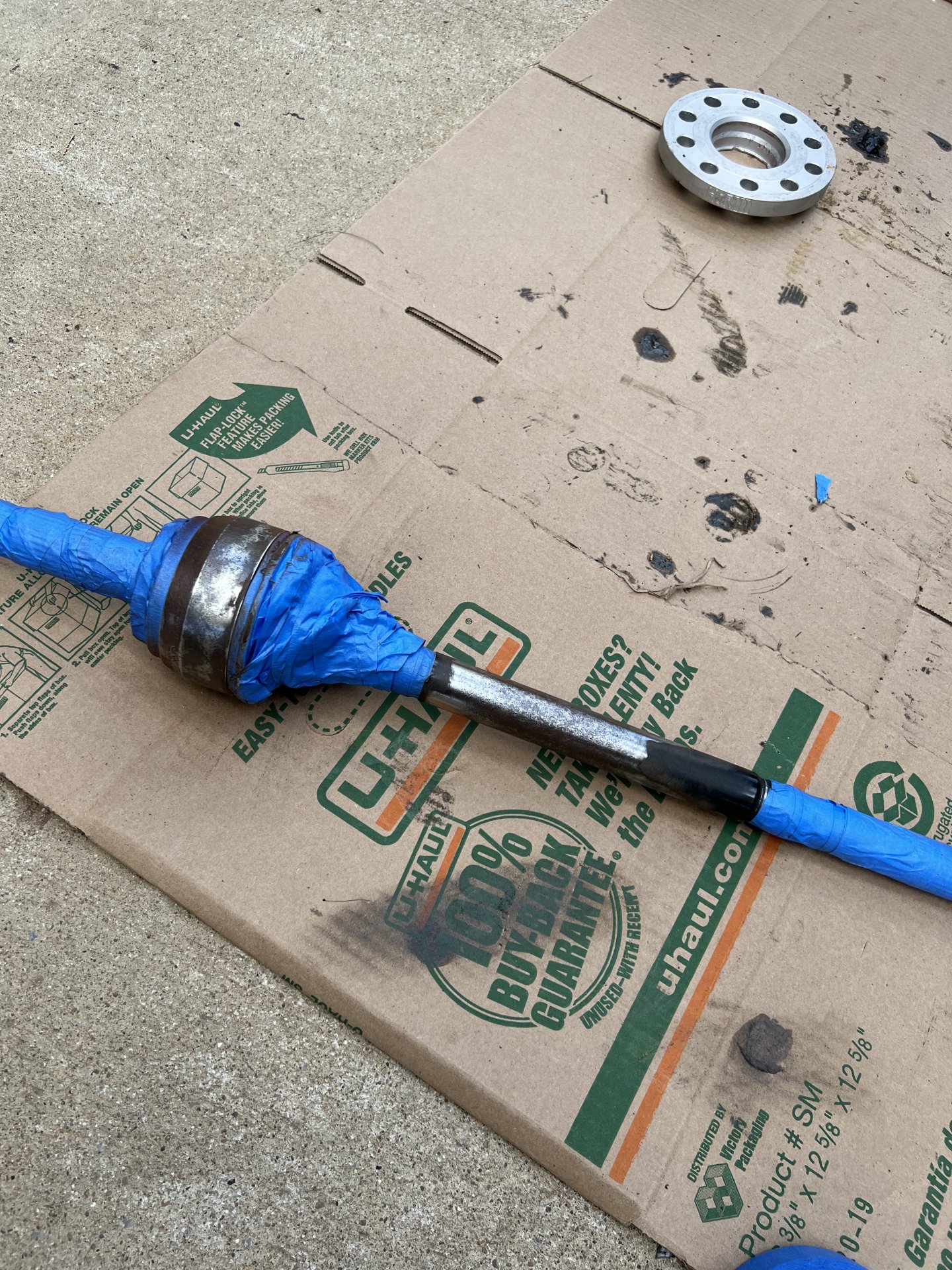

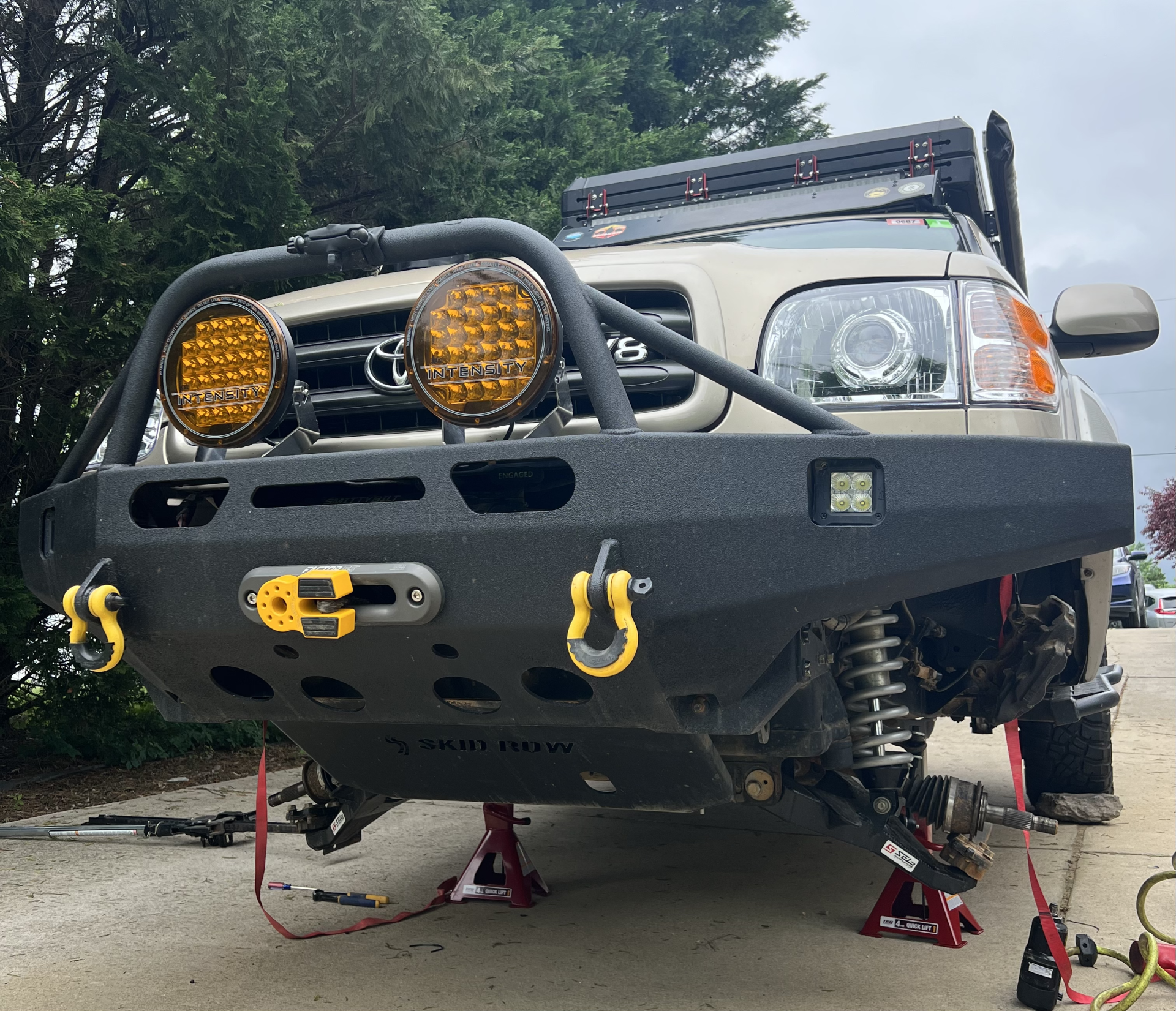

my mechanic buddy (the only one I trust) was out on vacation so the bearings will happen this week. So this weekend decided to go ahead and rebuild, boot, and renew both front CV Axles. Stripped off all the old rust and sprayed the shafts and tulips in Steel-It. Also replaced the dust seals (outer shaft) and debris shield (inner shaft) as well as both diff seals with OE ones (Yukon seal had started to leak).
Considering new CVs cost around $426 this rebuild cost about $80 per axle. Money well spent.

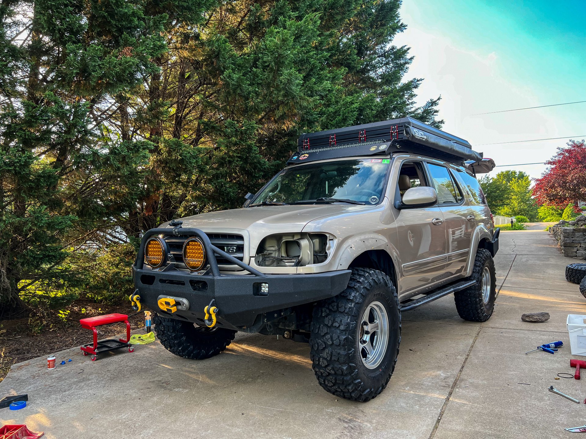

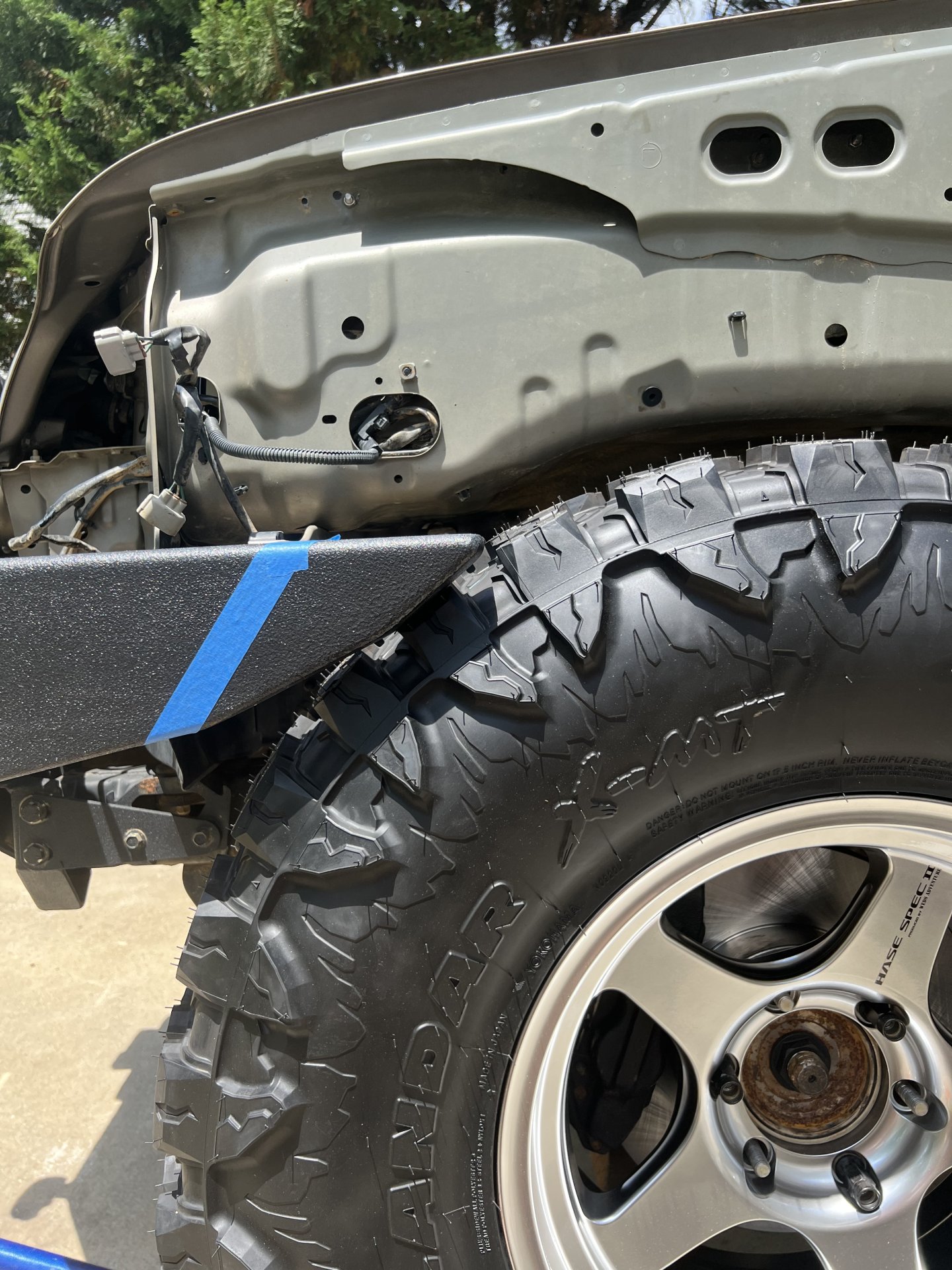

Fitting 37s has definitely been interesting. Have a lot more clearance than I thought I would with these Solo Motorsports LCAs.

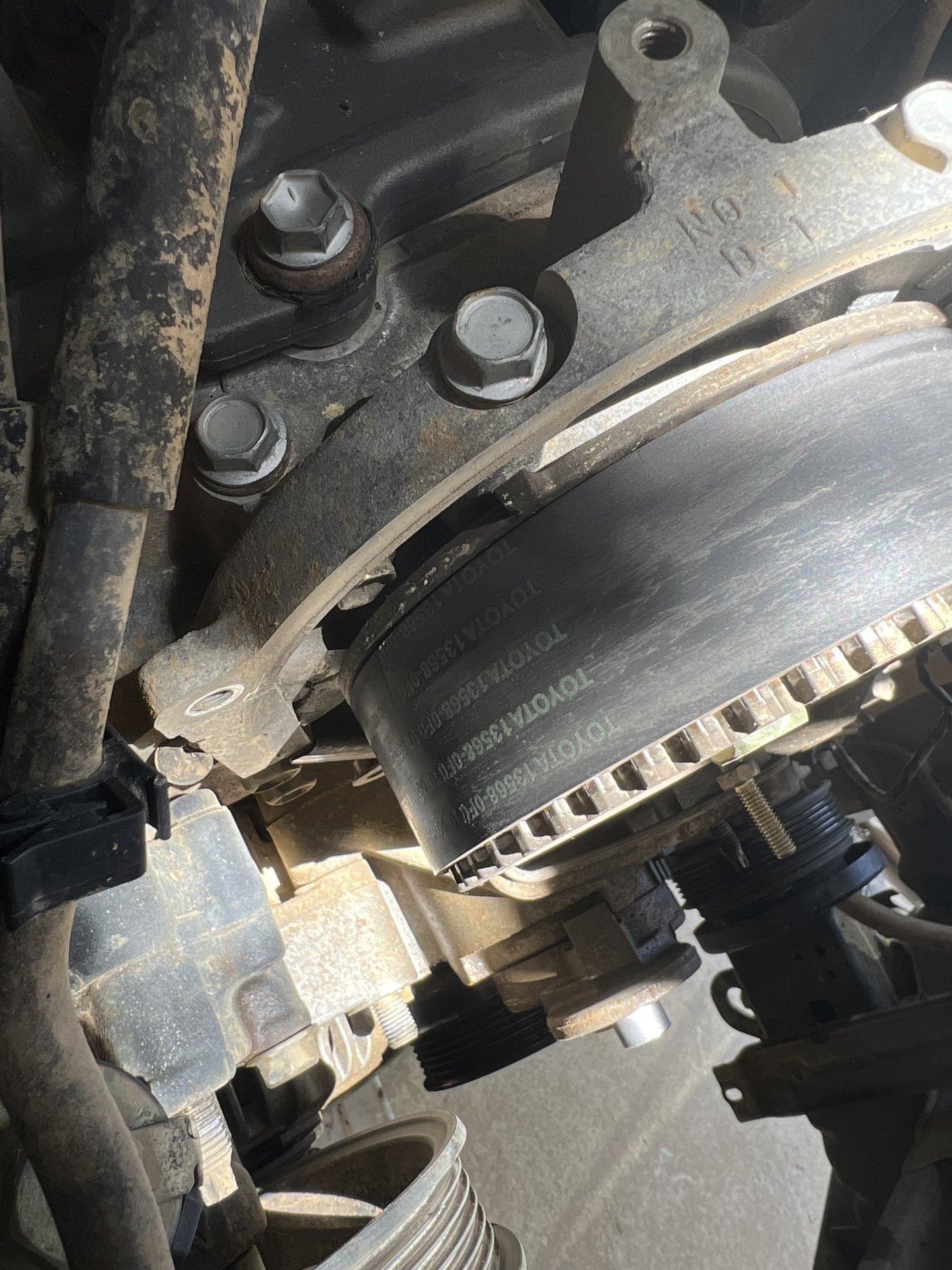

Started on my timing belt this weekend as well as cleaning mud out of the radiator from last years shenanigans. Had decided to change the timing belt and accessories because I knew they had been done, but didn’t know the quality of parts or what all was changed. Let’s say I’m fortunate, as it appears this vehicle was dealer maintained from day 1 (it came with no records). Toyota timing belt, tensioner, water pump and accessories were found with 35k miles on them. With that discovery I decided to keep that as it was and focus on the issues I found along the way, namely the tensioner, idler pulley, fan bracket, bypass hoses and fan clutch. All new OEM pieces have been ordered for next weekends work to finish things up.
With Sunday left open I decided to trim the factory fender flare and apply the new hardware and welting. Came out pretty well with the new body line I decided on.

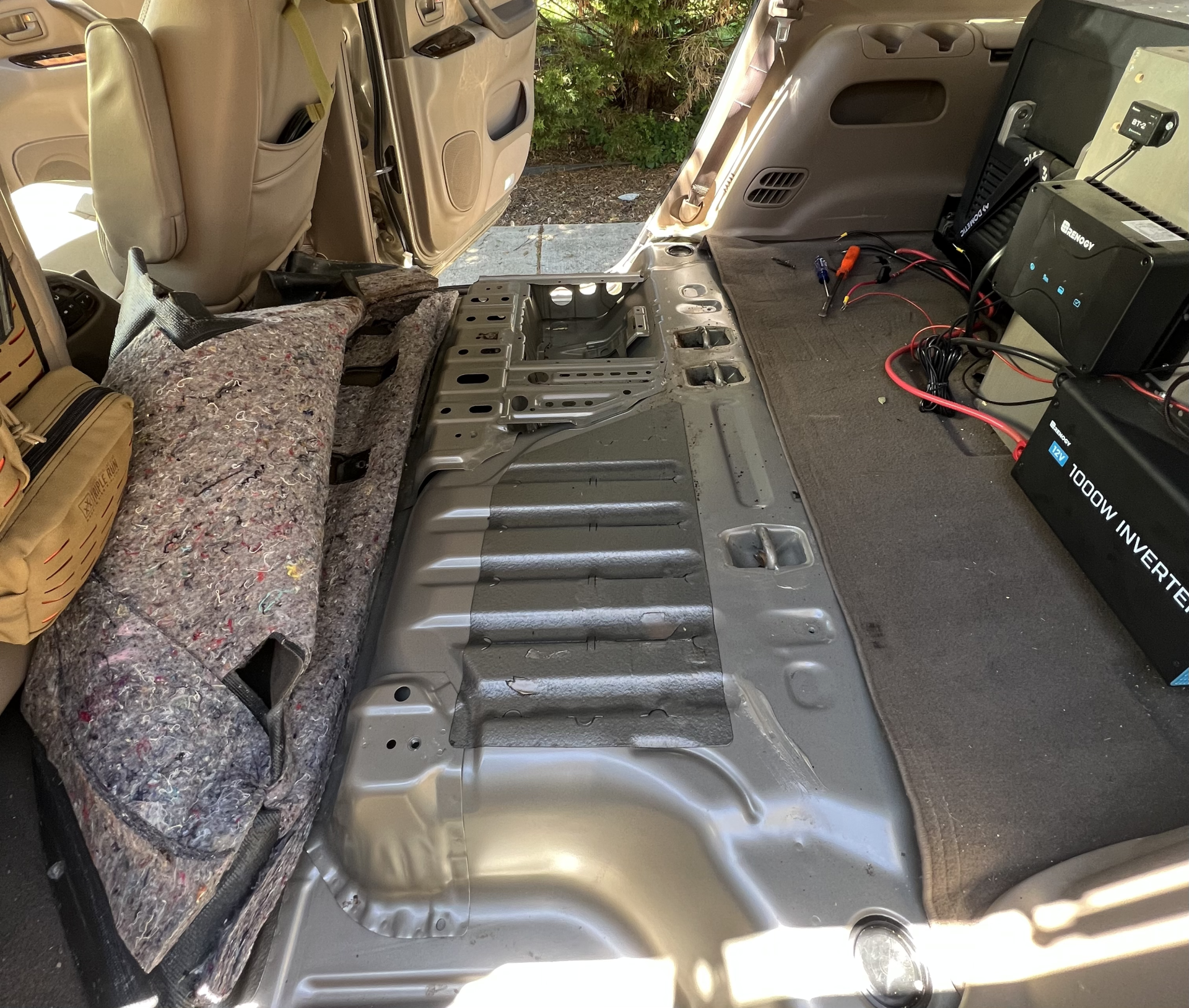

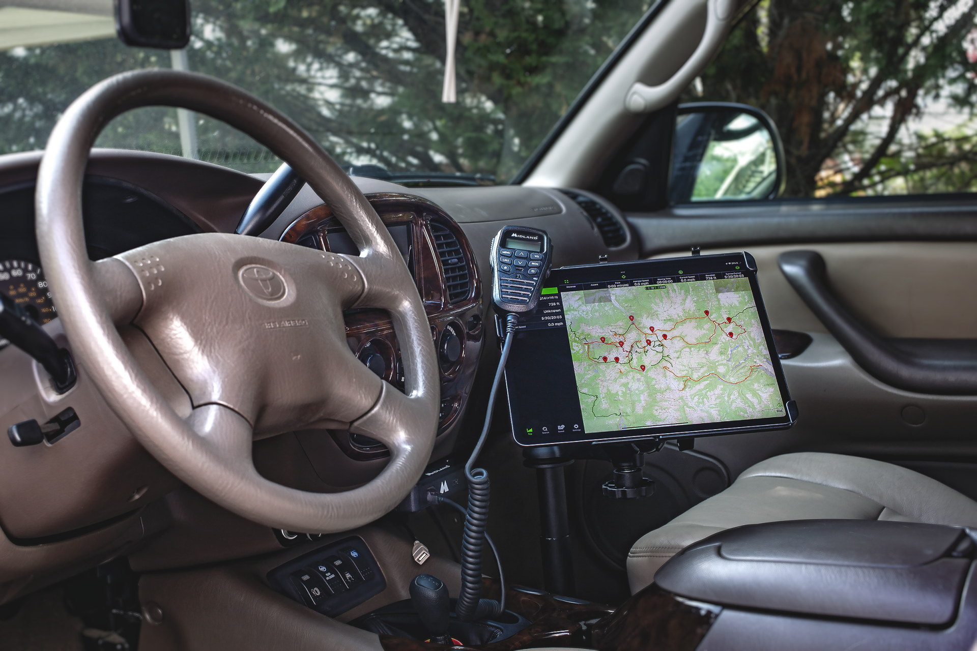

Also decided to install my new Midlands MXT575 in as OEM a location as I could. With my new RAM mounts tablet assembly the factory console cup holders were no longer usable, and the spot fit the 575 perfect. After removing the lower dash, center console (both got a well deserved deep scrub) and making a custom bracket everything fits perfect and with a nice factory finish.
Truck is back up and running on the 150a alternator and working on finishing things up for our 18 day trip out West.
Finishing up the six power system and only need a 60a fuse to get everything up and running. Swing arm is regreased, resealed, straightened and recoated. With the 37” spare mounted along with my 5lb propane tank I’ll be able to squeeze in 2x 2gal rotopax fuel carriers to replace my much heavier 5gal Wavians and steel carrier. Besides this the truck needs an alignment and I’ll need to do some small tweaking as the fox spring is rubbing the CV axle on tight turns enough to take some coating off. Either way, the 37s fit and will be working perfectly soon enough.
