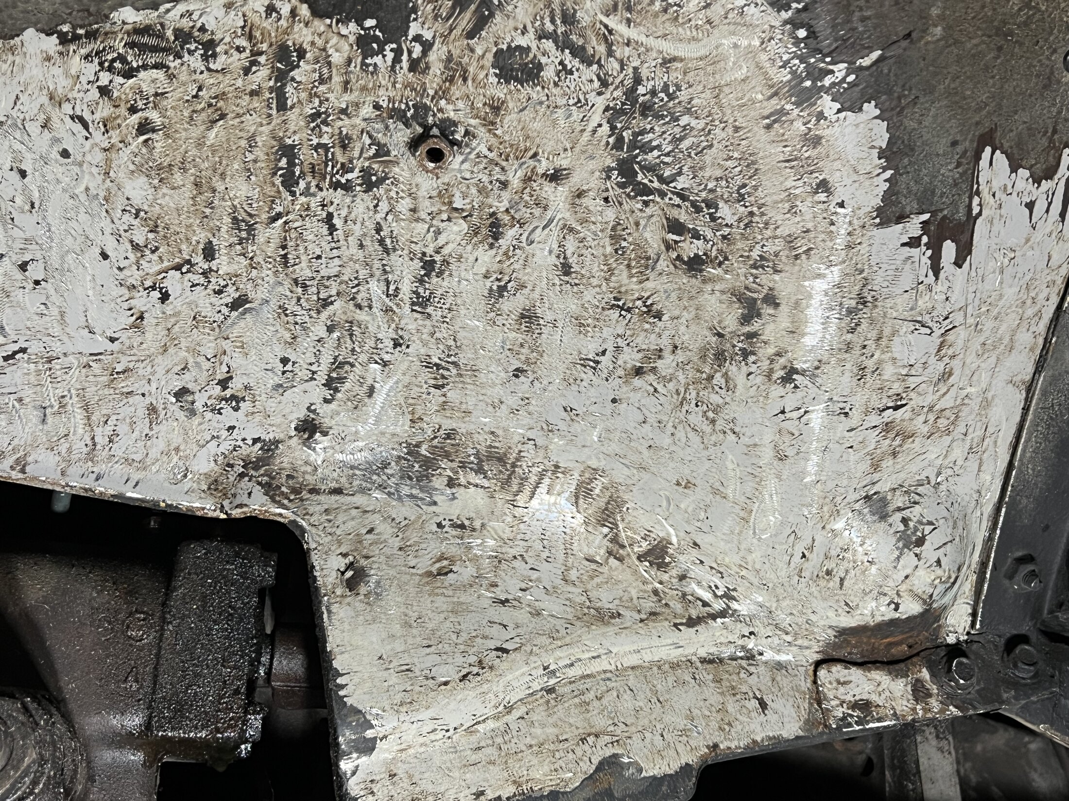

I haven’t cleaned these up much. A little goo gone will do the trick.
If you look close you can see a little nick on one of the scrapers. Drexel slipped :).
Oh well, it’s the passenger side rear. ;)

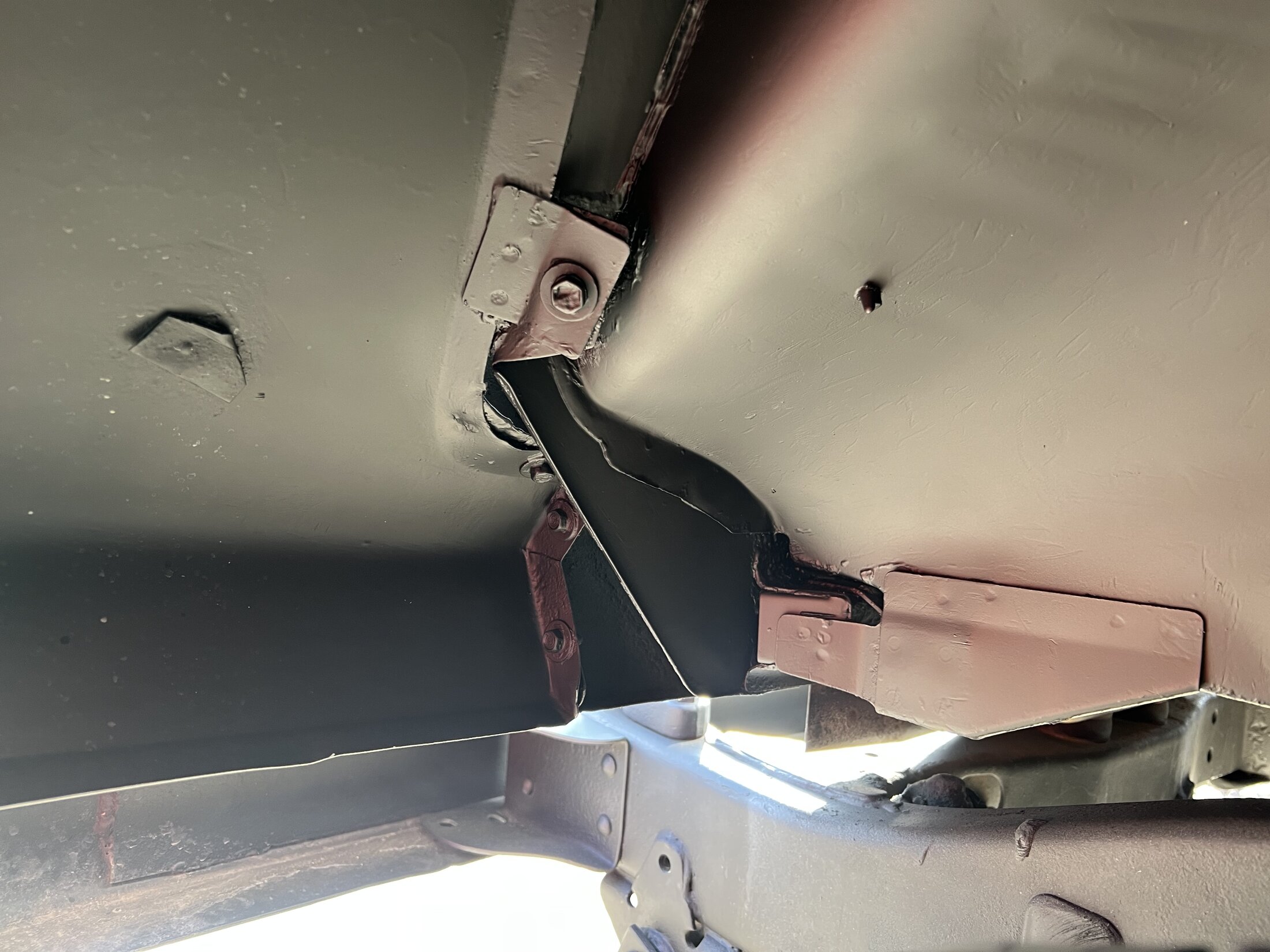

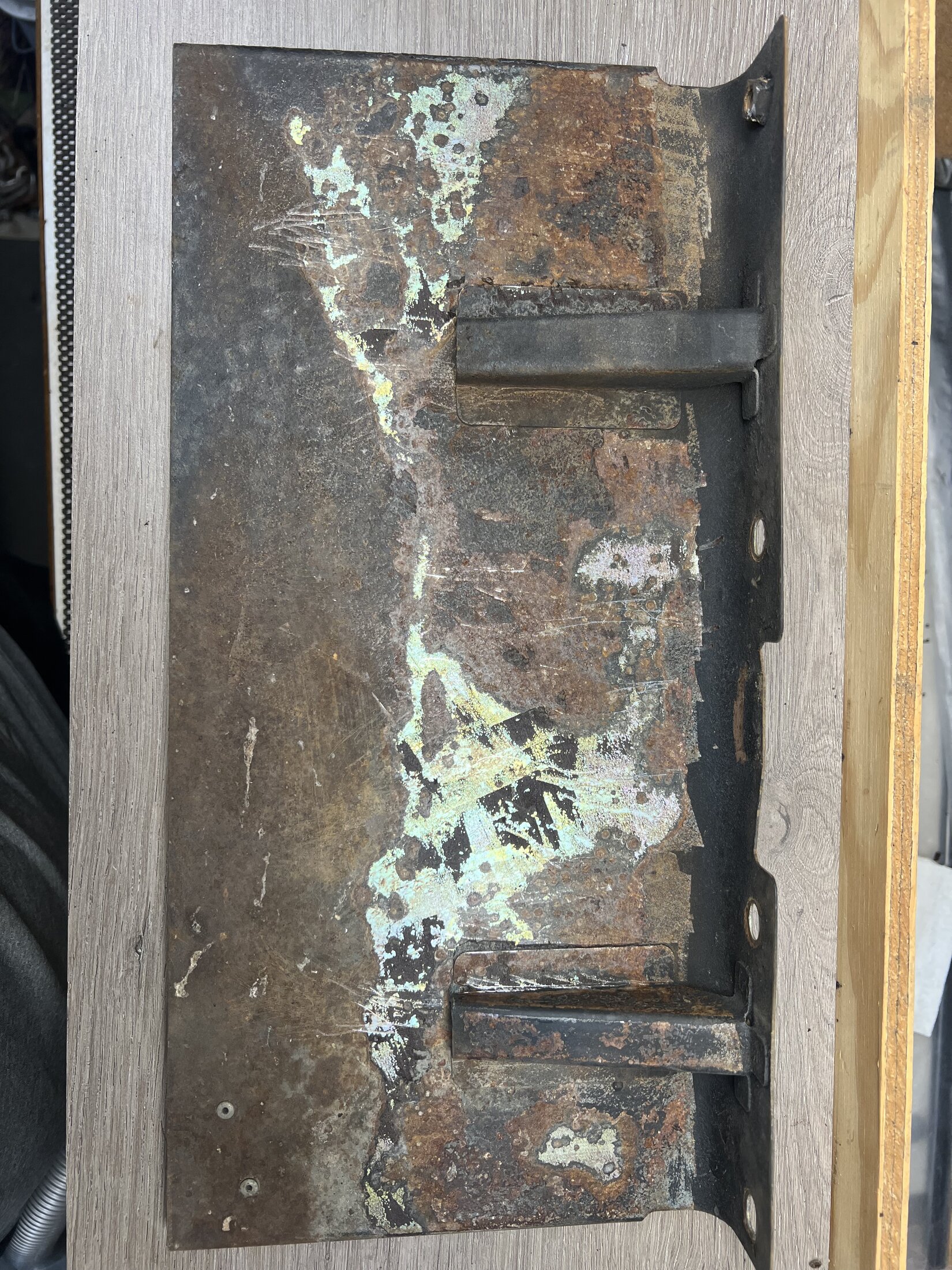

Circling back to a previous unknown part.
This is under the gas fill neck and bolted to the frame…in a couple different ways.
3 bolts with smooth heads and 2 bolts that attached to welded square nuts, one of those bolts through tailpipe bracket.
I’d have to say definitely stock.
Came off very nicely, but with a bunch of dirt. For sure a rust magnet.
Overall in good shape and sure makes it easier to get to the gas neck gasket.
Also has a piece of Velcro attached to a piece of Velcro riveted to the base.
Seeing how the pig pen hasn’t seen before, I will declare it unobtanium and will trade for built and installed LS with 5 speed 😉
Any takers?
Didn’t think so.
Happy to share dimensions with anyone interested in making one.

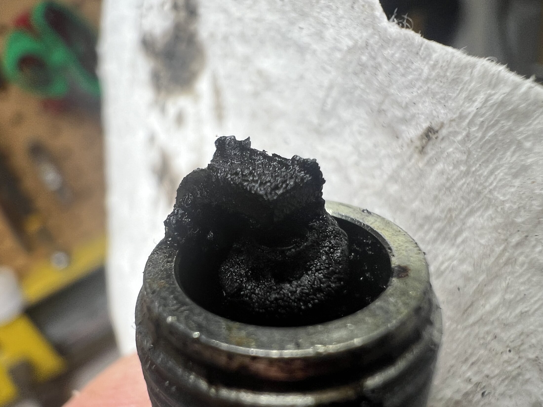

Went for a drive and truck was missing.
Under advice from neighbor. Pull 7 and 8 plugs to inspect (my 55 has GMC 350)
Sure enough plug 8 was completely fouled. 7 wasn’t good either.
Replaced both of them. Set timing. Adjusted carb.
Runs better than it ever has.
