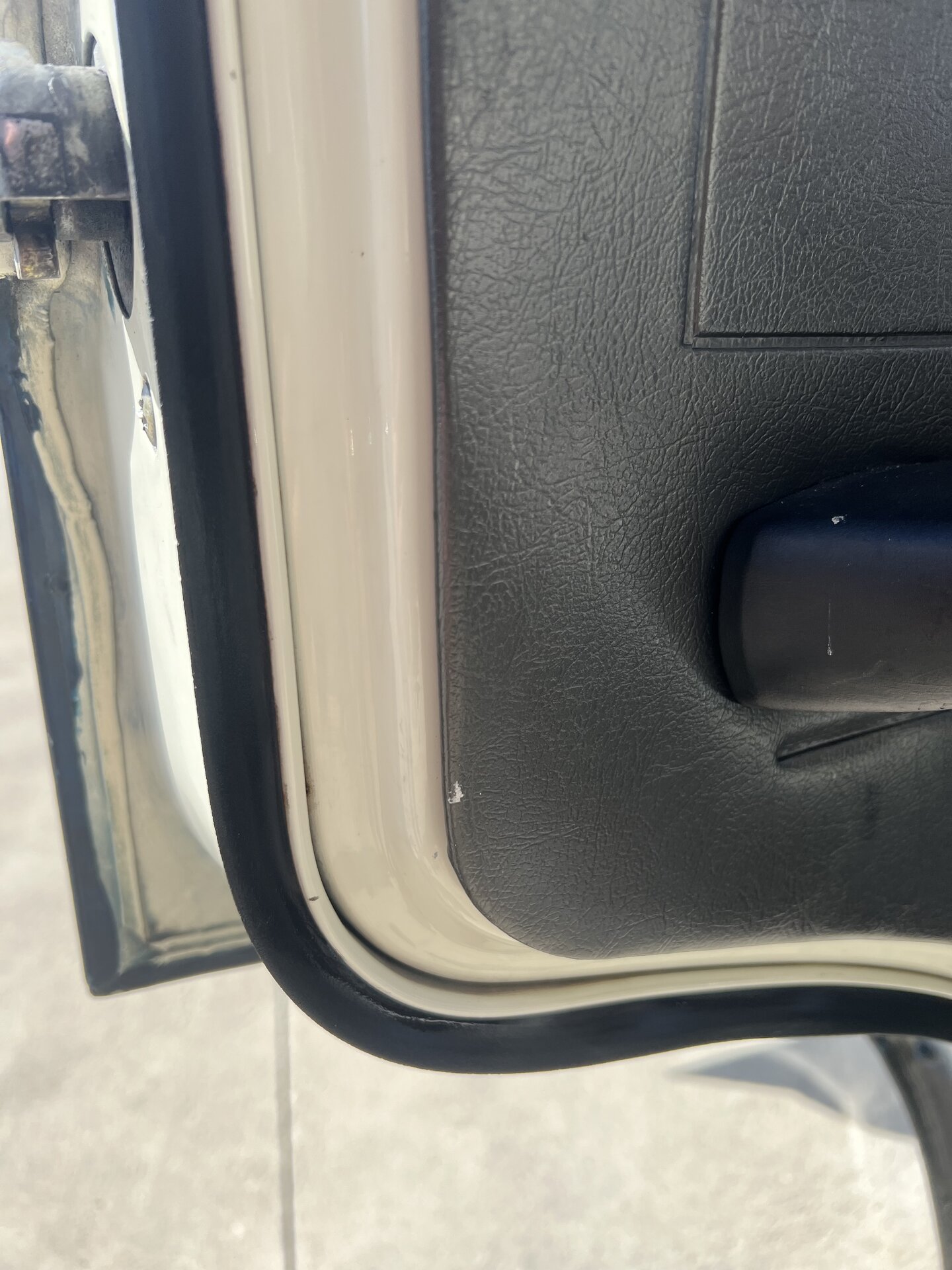

Then was able to add new door seals the PO had purchased.
They went on great and fit exactly as they should.
Used 3M 8001 adhesive and had no issues. well except maybe one part got a little sloppy.
But for all the issues I’ve read about, fortunately I didn’t have any.
Did all doors except the driver.
The new seals are not quite as thick as the originals, but they appear to seal up good.
Have the typical door striker interference when closing. I’m just being gentle for now.

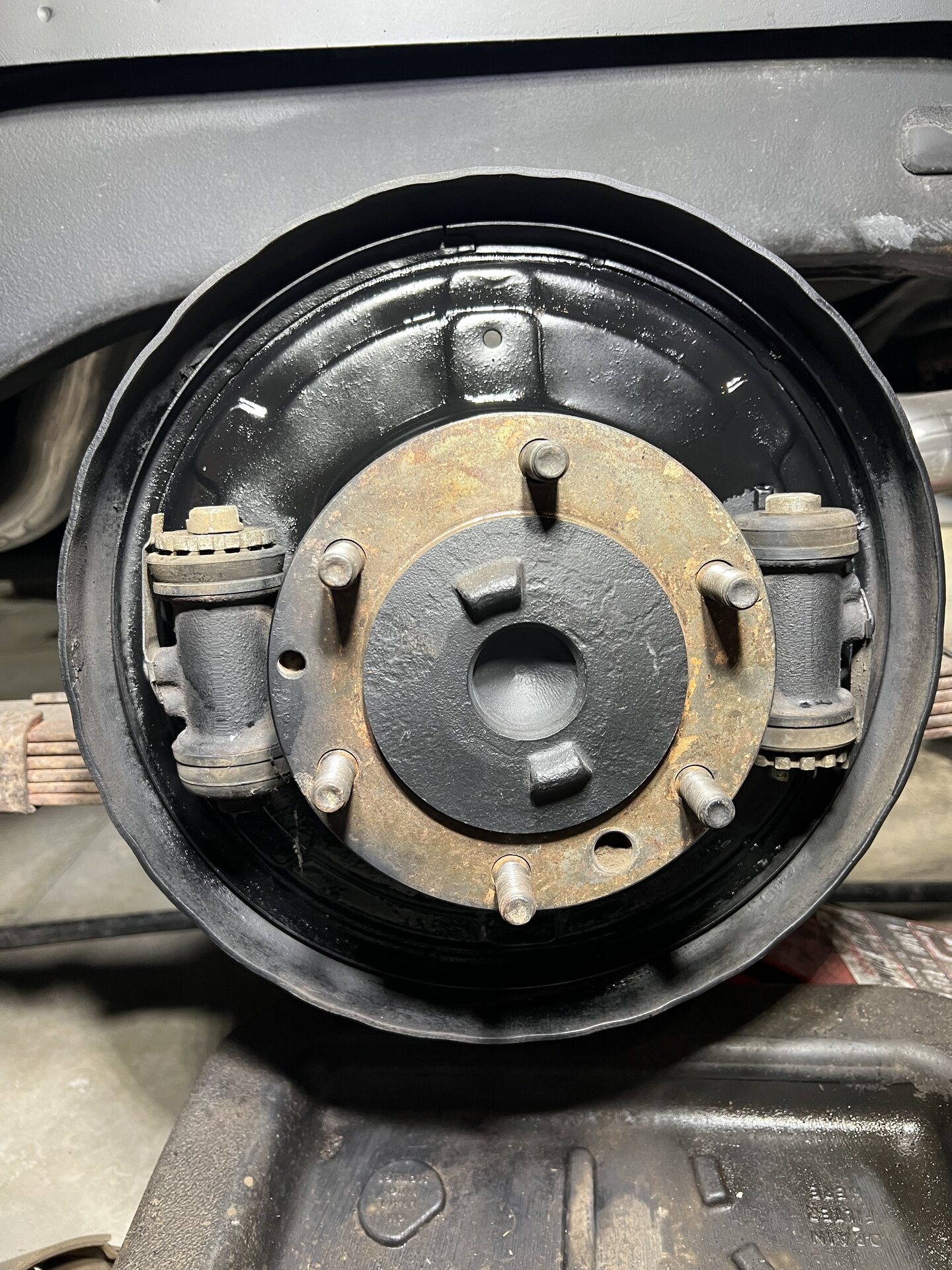

Have some opportunities with passenger side rear cylinders.
Rusted and had to adjust with a hammer. Eventually got moving, but not great.
Lots of gunk, rust and dark brown fluid came out when bleeding.
Ordering new. Should arrive Wednesday.
Drivers rear looked about perfect. Nice and dry and clear fluid when bleed.

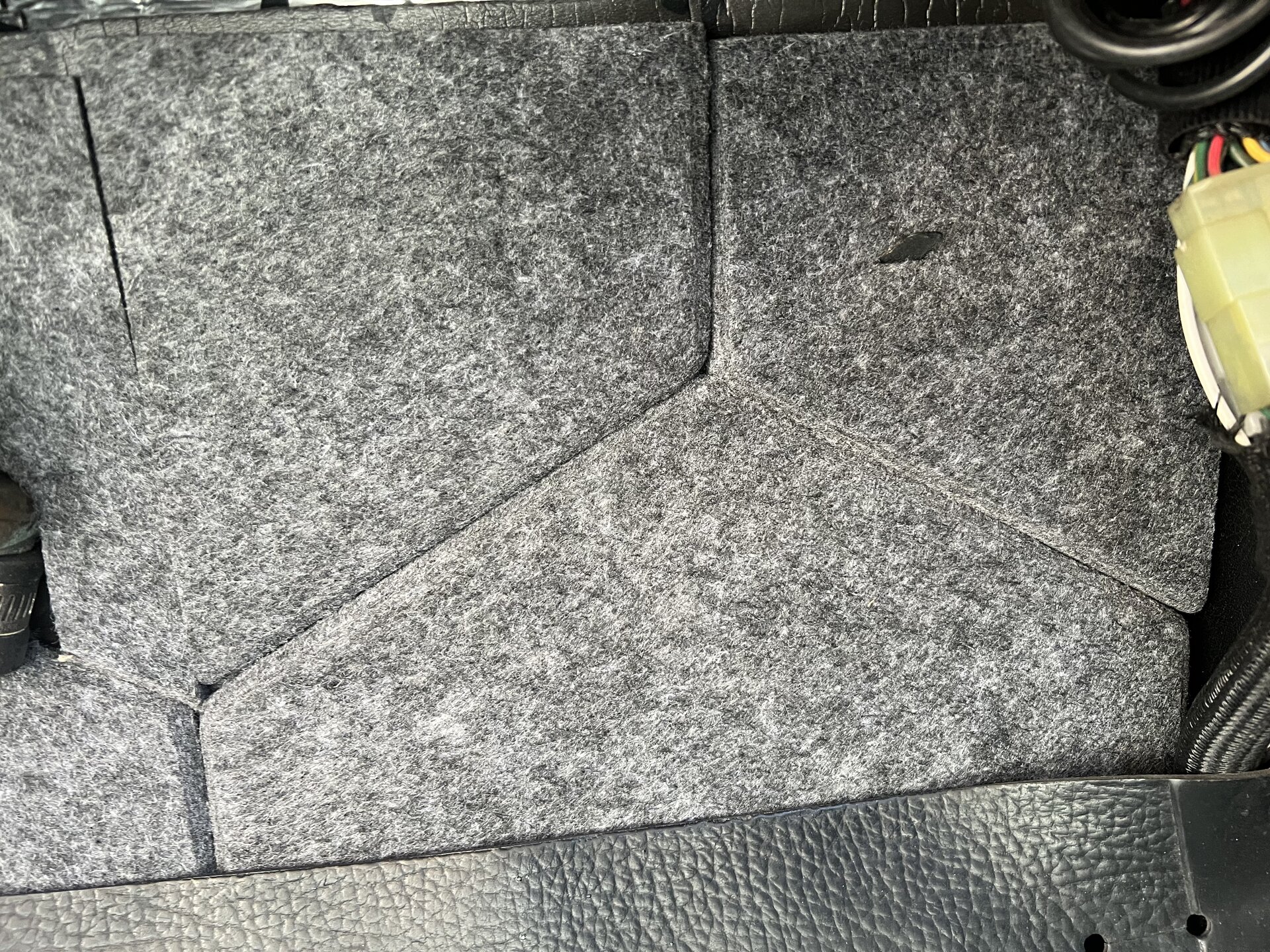

Added a few more touches to the FJ over the last couple weekends.
Hexagon sound deadener for the firewall.
Thought is would look a bit more interesting than it actually turned out to be.
Also the glue on the back of them wasn’t as strong as it needs to be.
3M super 90 helped out.
I’m indifferent on it for the time being.
I bet it will make a difference!

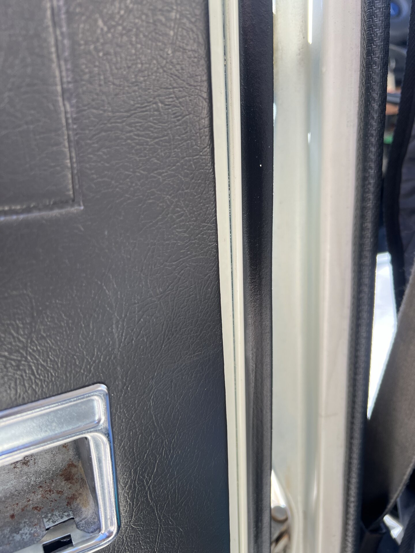

3/4” Keep on keeping on with the rear tailgate.

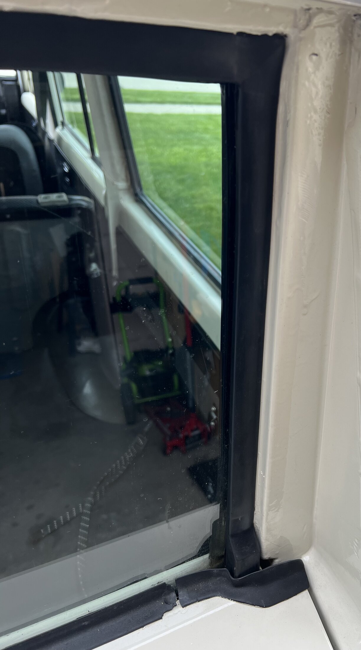

Added side and bottom seals
Caused a bit of an issue, but also a surprise.

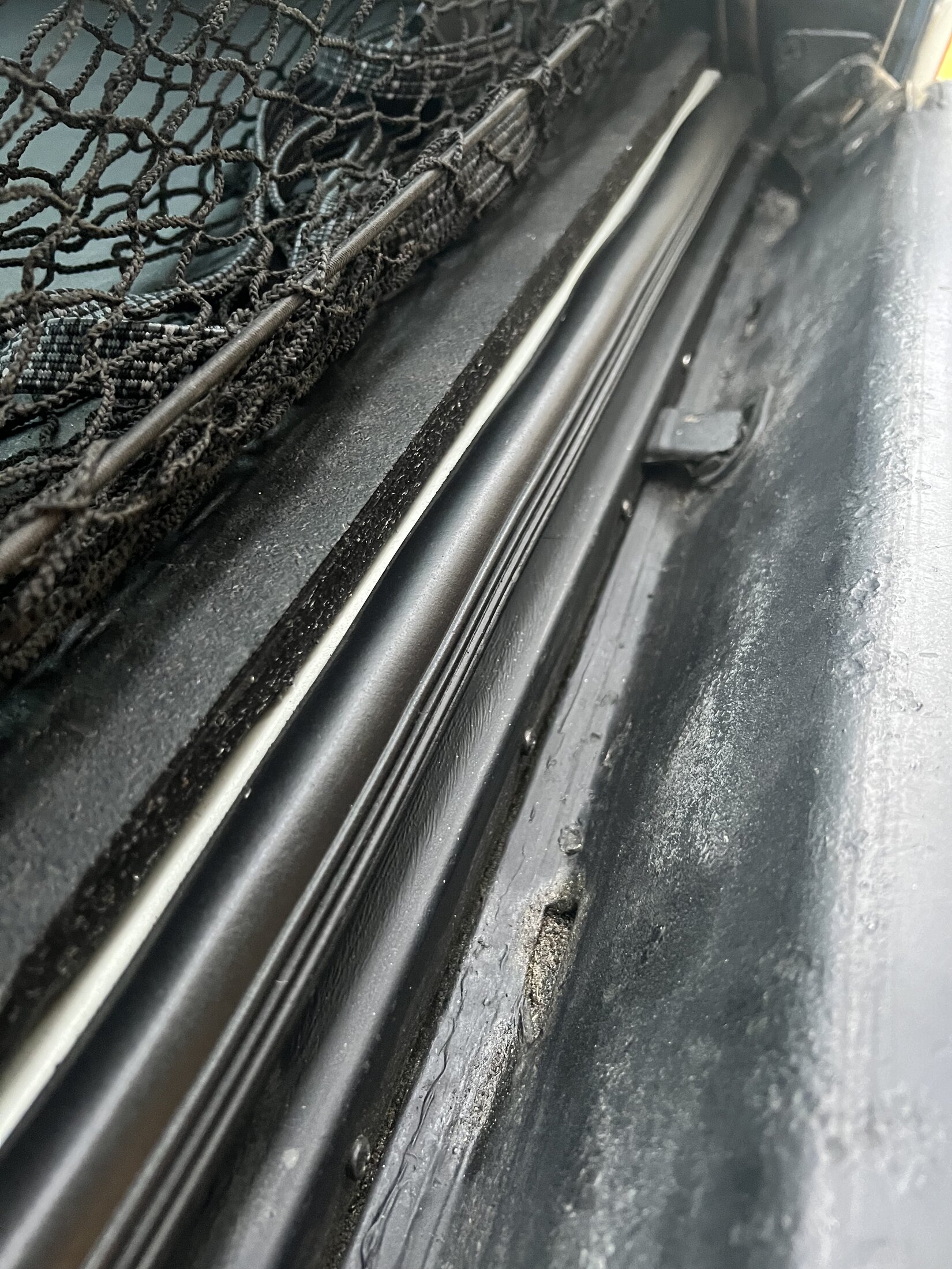

Side seals are 3/4”
Tailgate bottom seal is 1”, 3M taped on.
There is a little bit of a gap between the new rear window seal and side 3/4” seals.
Trimmed a bit of the crimp side of the seal to mate it to the new window seal.
Worked well….the second time.
Super happy with the outcome and can’t believe the difference it makes in quieting down the interior.

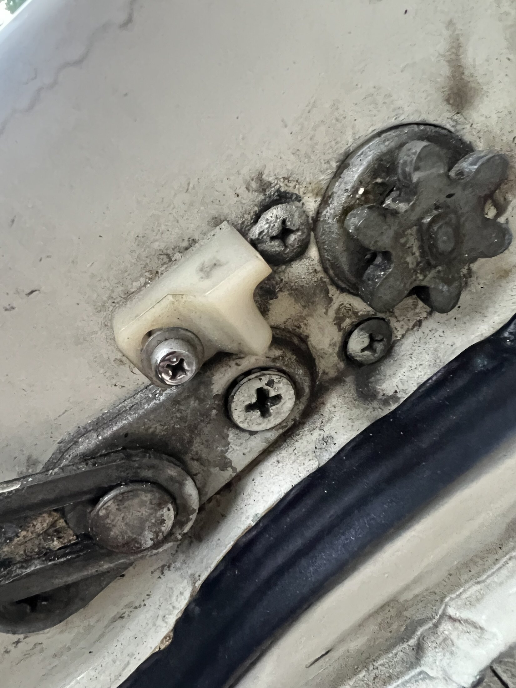

On first test drive, happy with the quiet, I accidentally hit the rear window down switch…and it worked!!??
Had no idea. I tried and tried before, but what I came to realize is the ignition had to be “on” to work. Not sure I ever tried it before that way.
Unfortunately up does not work.
So, got home from work and tried the key. Nothing. No up or down.
Super.
Figured it was the seals being too large and maybe crimped the wires to the motor.
Or the kill switch couldn’t be pushed in when the tailgate is closed? Or who knows.
I figured is was the switch, so pushed in hard at that point on the tailgate and money! Window down.
Open tailgate, to take some pics for you all, closed the tailgate and the window wouldn’t go up.
Under further inspection the plastic striker that pushes that switch in was loose.
Tightened it up and back in action. Whew.

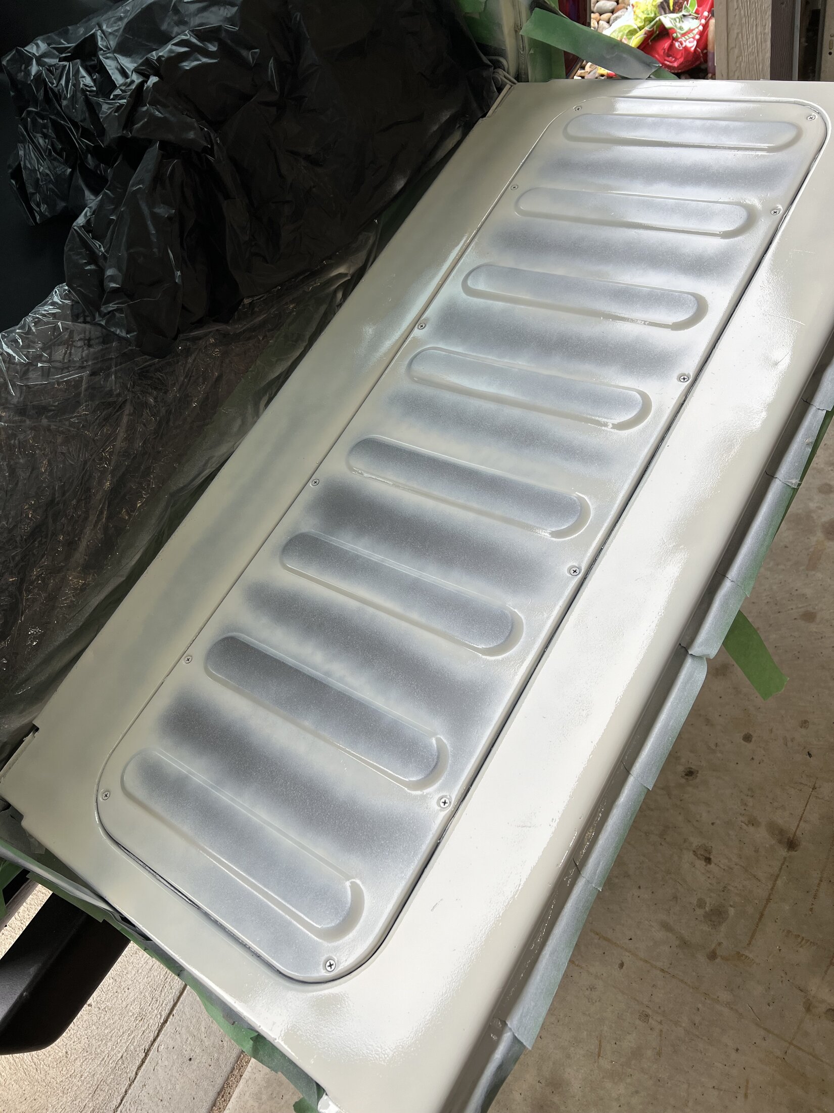

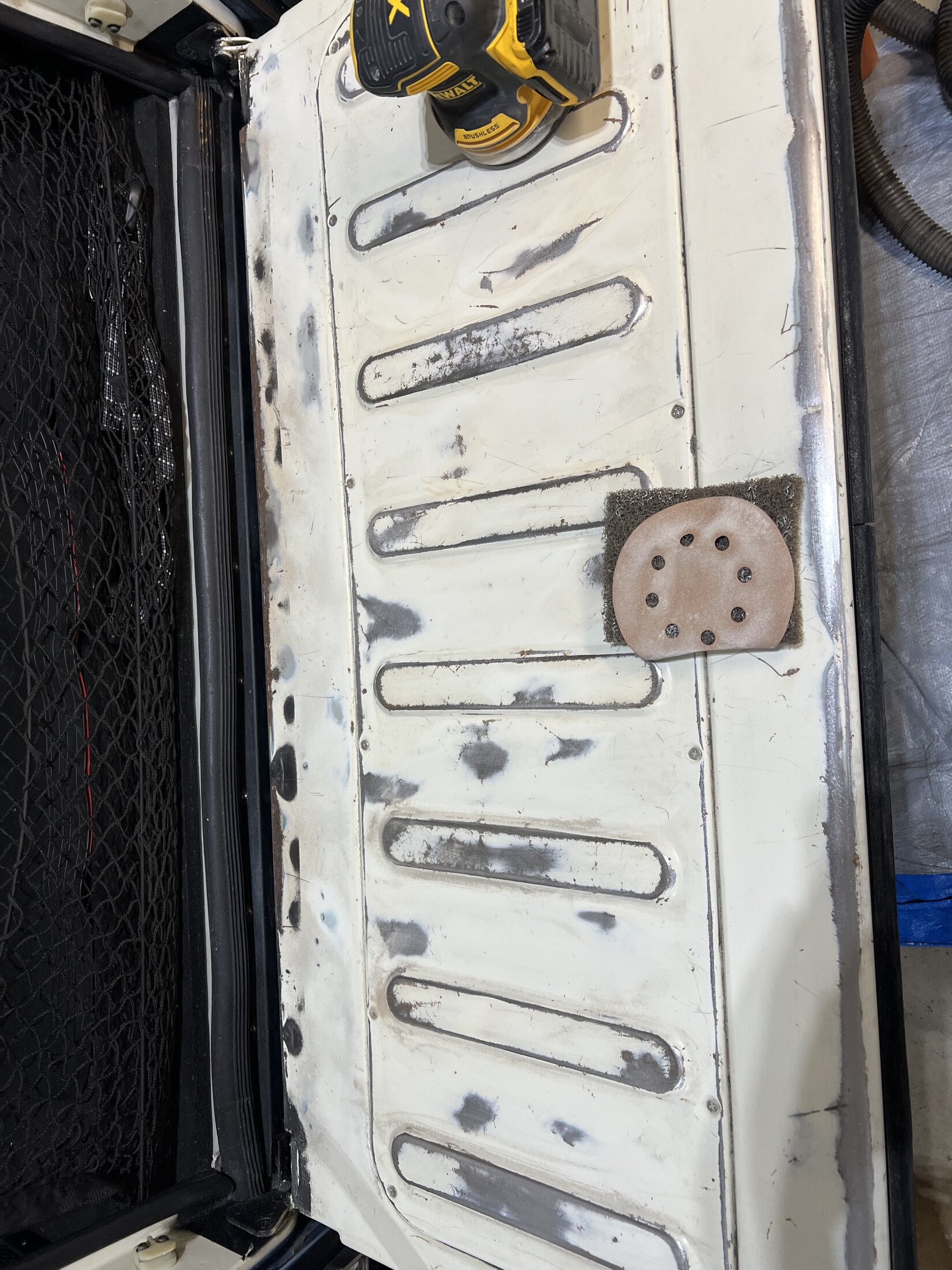

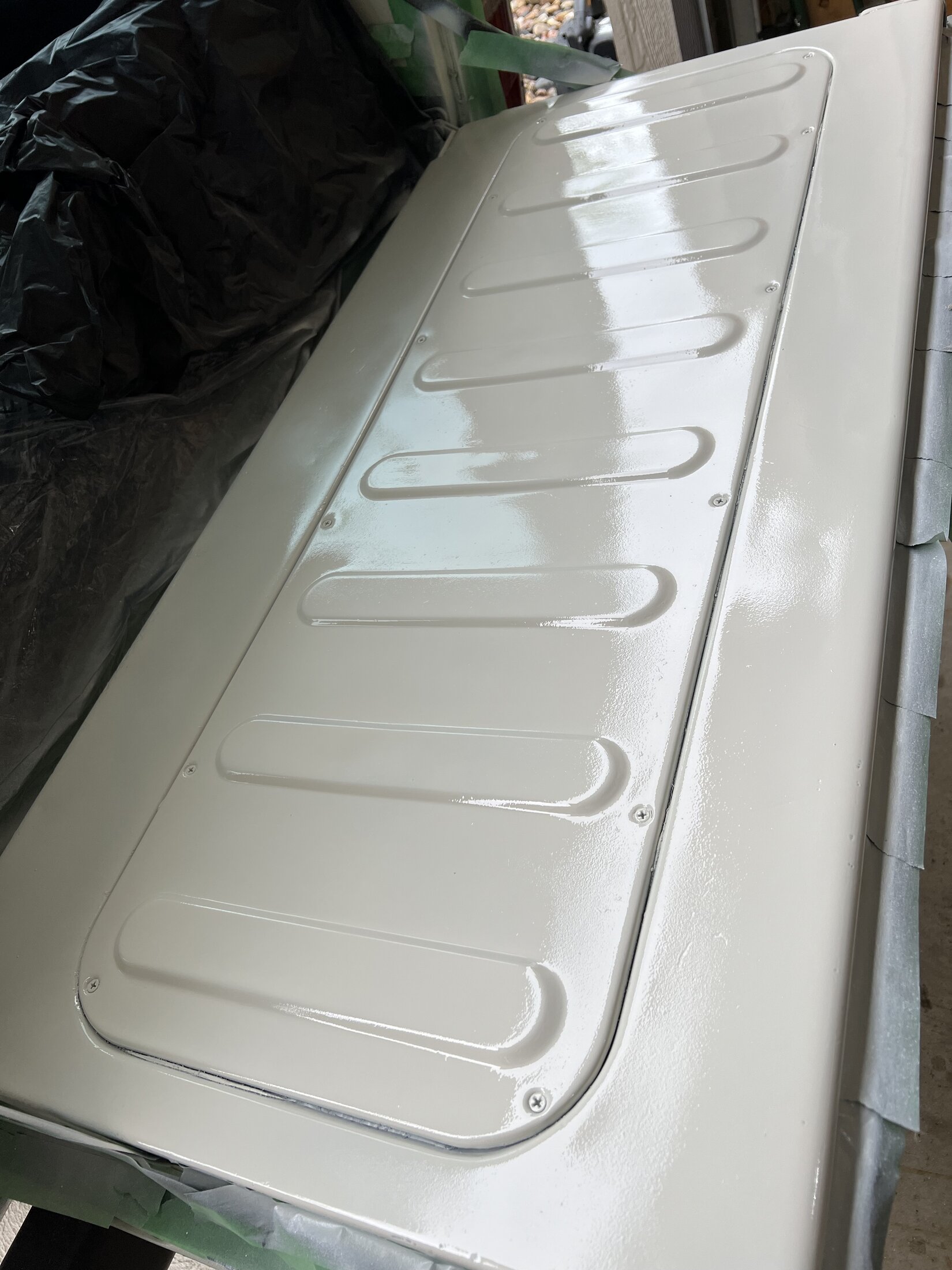

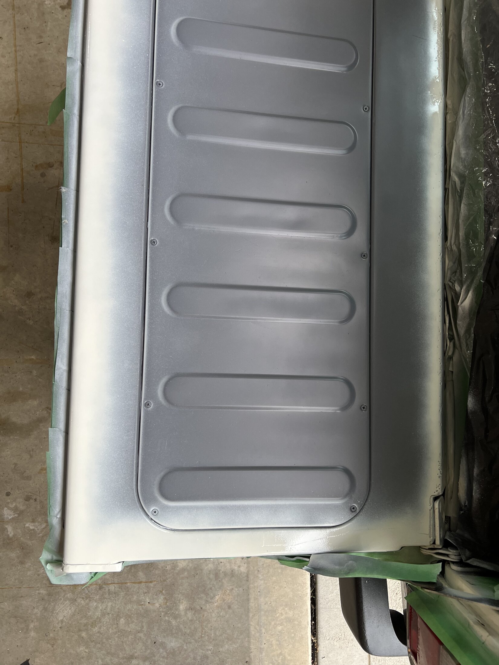

After the additional of the weather seals, took the opportunity to throw some fires rattle can on th tailgate.
