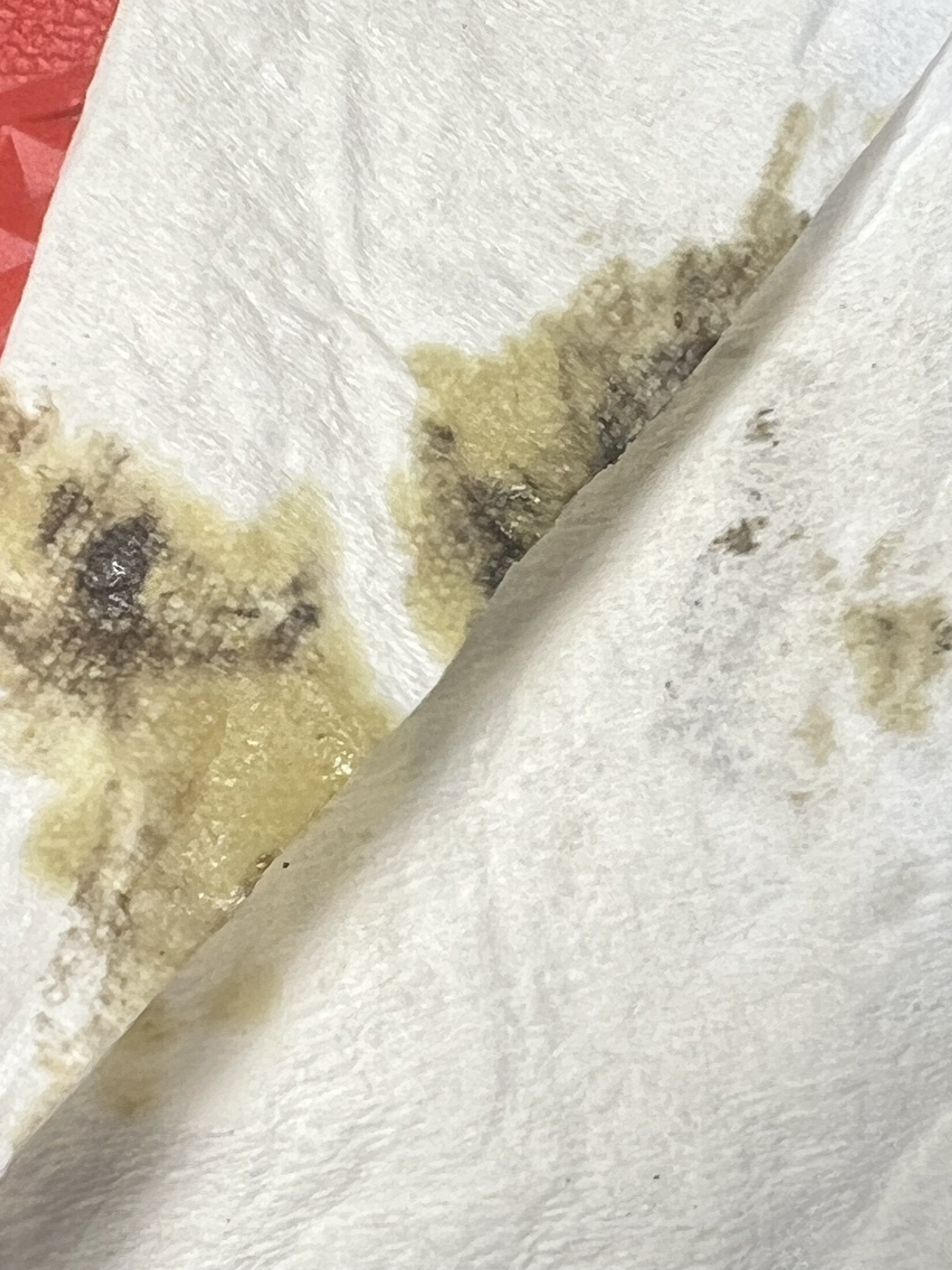

Pulled the drain plug quick to check for metal filings.
Was not much on the bolt. Cleaned magnet with white towel and drained onto white bag to see if I could see anything. Not much on bolt and a cloudy spot in the oil.
