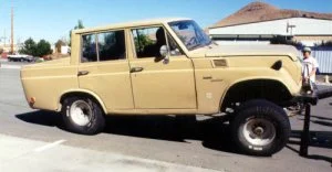

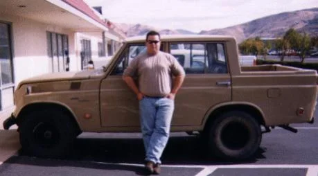

Found some pix of my old 55. This might give you an idea of what I have in mind for a 60. The 55 was a rust bucket, most of the body exterior was heavily covered in bondo. The left fender was mostly bondo LOL. The cut top conversion could have been done better by a teenager with a welder. It used a full size chevy truck back window and plywood and roofing tin, and lots and lots and lots of BONDO. Did I mention BONDO? The floor had holes in it, the brakes had to be double pumped to stop and the damned wheels leaked at the bead if you aired down at all.
I had some plans for that 55, but I don't plan on getting another one. I'd never allow myself to do the mods I want, they're too classy in stock form! :D
So now you have an idea of what my demented mind thinks of.
The pictures were taken around 1999 or 2000 . I was 25 instead of 35 LOL.

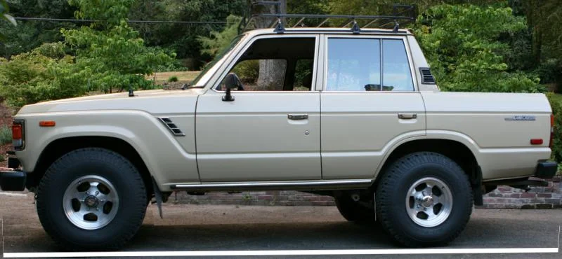

Something like this. This 60, before I played with it, had a 2" shackle reversal on the front. I removed the lift and did the obvious. Apologies to whoever owns that 60, I shamelessly stole that pic and chopped the hell out of it :flipoff2:
