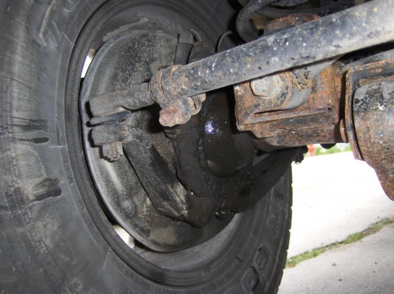

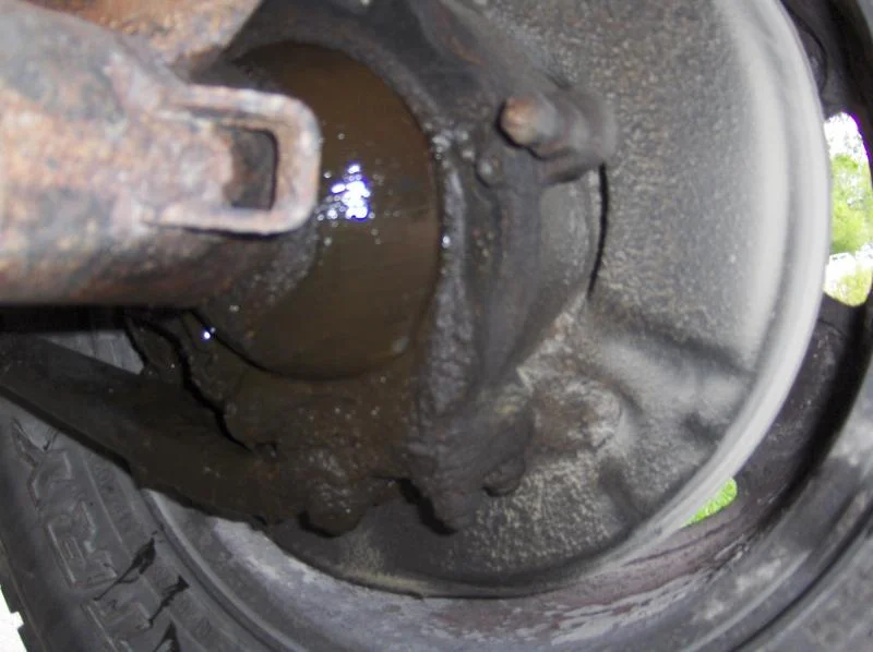

Nearly 2500 miles and not one problem. 'Cruiser is a wicked travel vehicle. Was comfortable on the highway, (got nearly 15 mpg!), and handled going up and down the rocky Mesa roads like a champ. Thanks to all you that offered up help on what to do to prep. Below I've attached a couple of pics to get some help to make sure that I don't have a leak inside the knuckle. Thanks again for all the help.
Looks like a leak. Glad you had a good trip.
Thanks for the heads up. Rebuild looks pretty straightforward, though if anyone is in Northwest Montana and wants to help, let me know! I'll need to get a few things before getting started. I've hit my limit on attachment sizes so I can't upload a picture of it out in the wild. It doesn't look like I can delete them, but if I hit ten posts I get more space? If that's the case, I'll get chatting and get some up ASAP.
yep...gotta replace them seals, I got my kit from marlin, and did the wheel bearings while I was in there...a big greasy mess... but not very difficult....plan on 5 hrs each side , took me closer to 4 my first time...
It's eventual but hey, at least you caught it early!
