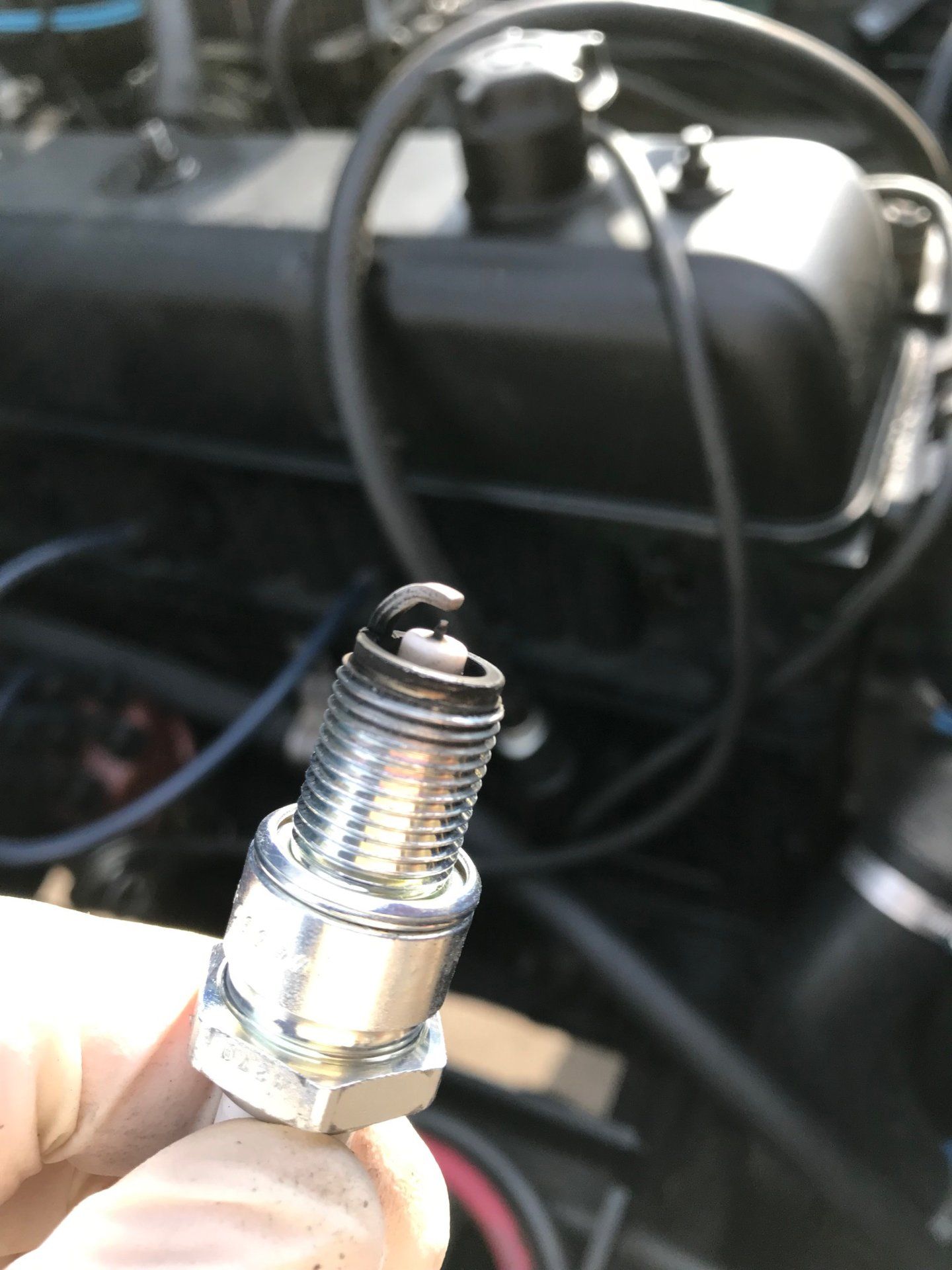

@lazylfarm, I pulled the front plug this weekend, it looks pretty normal. Maybe shows signs of running a little rich? These plugs have less than 200 miles on them.
I am starting to think I need to rebuild the carb, then work backwards.
