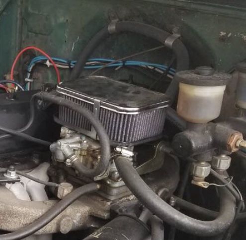

Weber Carb. Sorry for the poor quality!
I thought that was a weber. I'm not sure if either of them rebuild Webers or not. I believe pretty much everyone here will say OEM Carb is the way to go.
Sorry, I don’t do Webers...except to bbq on.
End goal is to do fuel injection. I definitely think (know) that she will need a carb rebuild before then (NOW!). :)

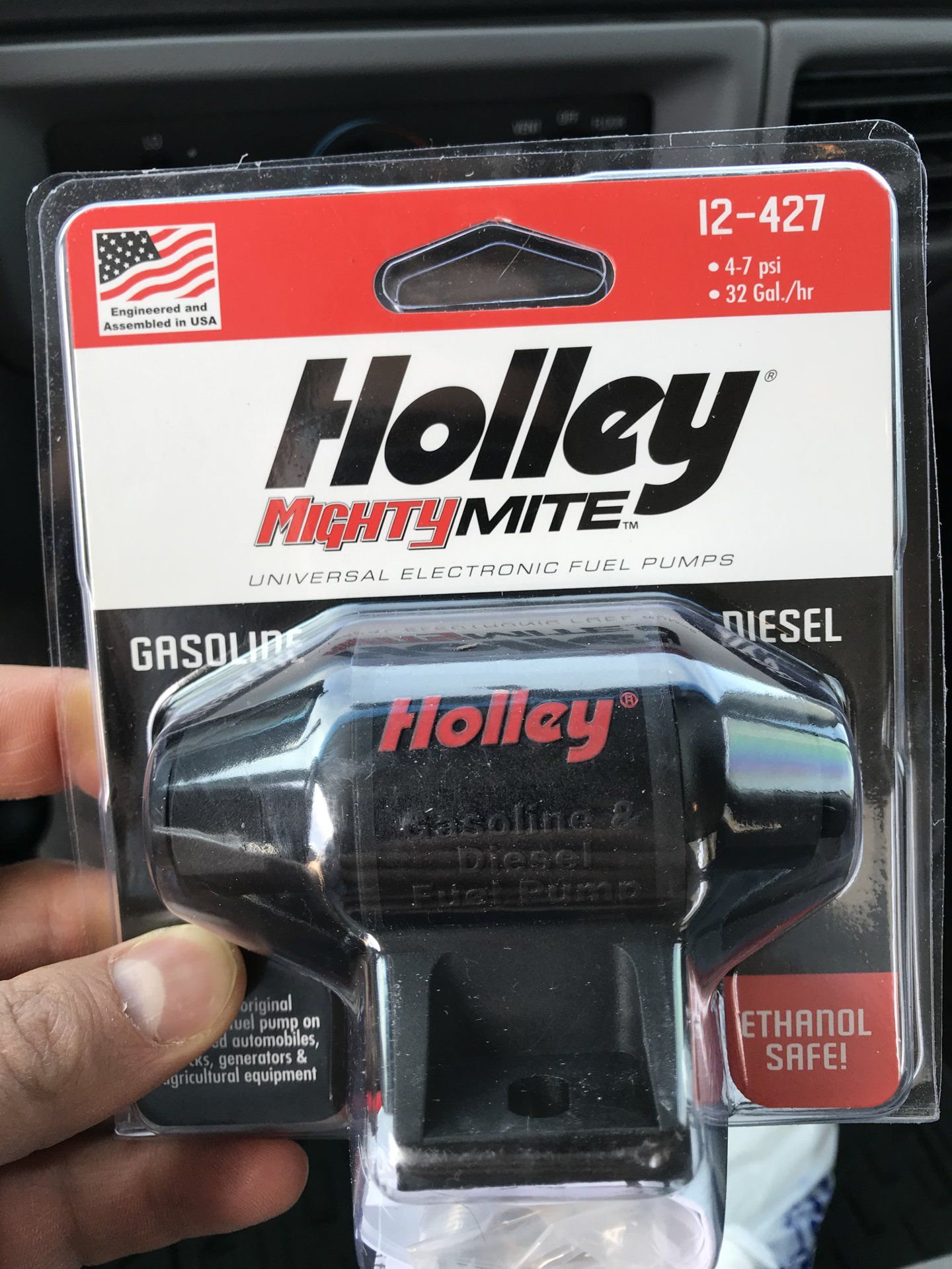

Ok, got a new fuel pump. Thoughts on PSI? There is another one that is a bit less.
It looks like you need to get the lower PSI rating for the weber pump. 2.5-4psi is what Weber recommends.

I replaced the electric fuel pump last night. Unfortunately, the problems persist. She still sputters under harder acceleration loads.
I ABSOLUTELY aim to go fuel injected, however are there any interim fixes? I am thinking a carb rebuild is due. Should I also put in a regulator? If so, what pressure should I set it to?
