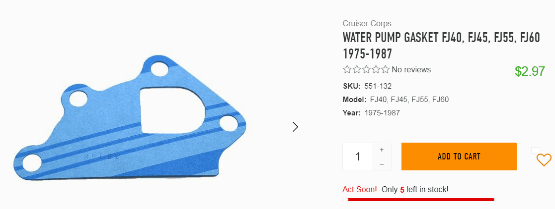

Would this be a water pump seal? I'll check SOR for a kit. Any other potential leaky spots?
EDIT: Does this look like the part?
Thats is a water pump to block seal. While it's possible this is leaking, it's different than leaking from the "weep hole" on the bottom of a water pump. A leak from the weep hole means that seal on the inside of the water pump is going out and will most likely continue to get worse and fail at worst possible time. I would just replace the water pump, in which case you will need that gasket that you posted as well.

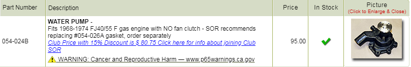

To be safe, I should replace the water pump and the gasket above? Should I look at the thermostat while I am at it or is that overkill?
Thank you!
Be sure to shop around, you can find water pumps from vendors that are very active on here as well. I like to support those that give TONS of free advice here.
I would also do a thermostat/thermogasket and thermogasket to block gasket while I had that all apart getting dirty with coolant.

Yep, I would try clean the engine off up front, then get it warm then just sit and watch while it idles and chase drips. It's slightly more exciting than watching paint dry. On the other hand, for less than $150 you can replace water pump, gaskets and thermostat rule those out.

I may go the replacement route. Getting her ready for Solid Axle Summit this Summer and do not want any issues on the trail.
