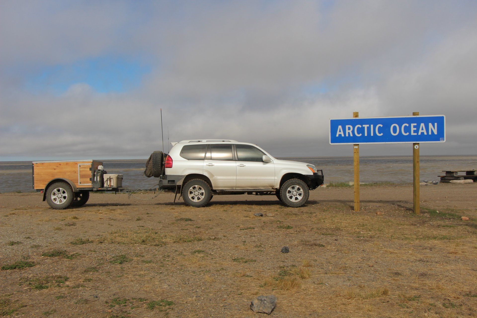

The trailer can roll on 31 or 29 or 35, that up to you. For years I have match my truck and trailer wheels and tires. For one I think it looks better and two if I ever need it, I have spares for both. On my trip to the Arctic my GX470 had 2 spares on it.

Also, what you don’t see, is that trailer is set up to be a flat bed, a stake bed or my camping trailer. It has a 5000lb axle and air bags to adjust for the weight I am carrying. I have had it loaded with rock, bricks, a cord of Oak, once it weight in around 4000lbs. Pictures shows the same trailer.
