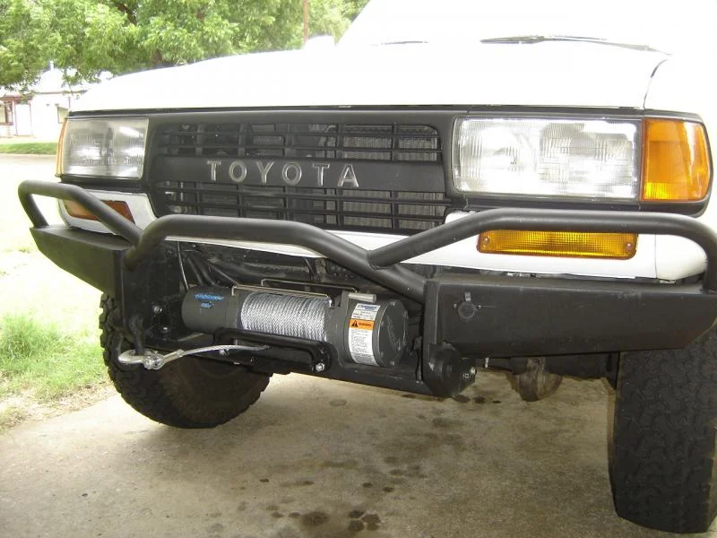

Thanks again to GCC and all the raffle participants.
I mounted the solenoid box on the ps firewall. The receptacle for the remote is in the ds bumper.
I'm pretty happy with the way it turned out.
Home made bumper, Slee "Short Bus" copy. Local fab shop did the tube bending,
I cut all the pieces, coped the joints, and had them weld it.
There is a minor fitment issue. I need to elongate the winch mounting holes
in the mounting plate about 1/4" forward. The 12v studs on the winch are
too close to the cross member.
