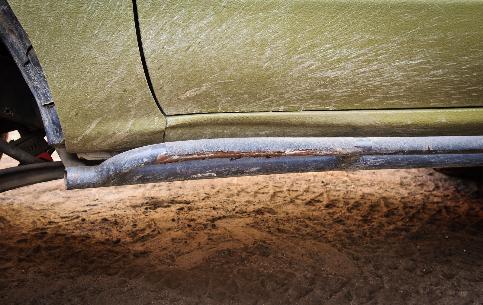

Here's a shot of the front leg on my passenger side. This shot is after I changed my exhaust and replaced the cats, but this worked with the stock cats and the tube passed underneath the coupler between the two cats. 0.25" wall tube. wasn't fun to bend. :)

Here's what I did with my last 80 for dealing with the early style cats. The bottom plate could be thicker but I never had an issue with these flexing.
On my current 80
