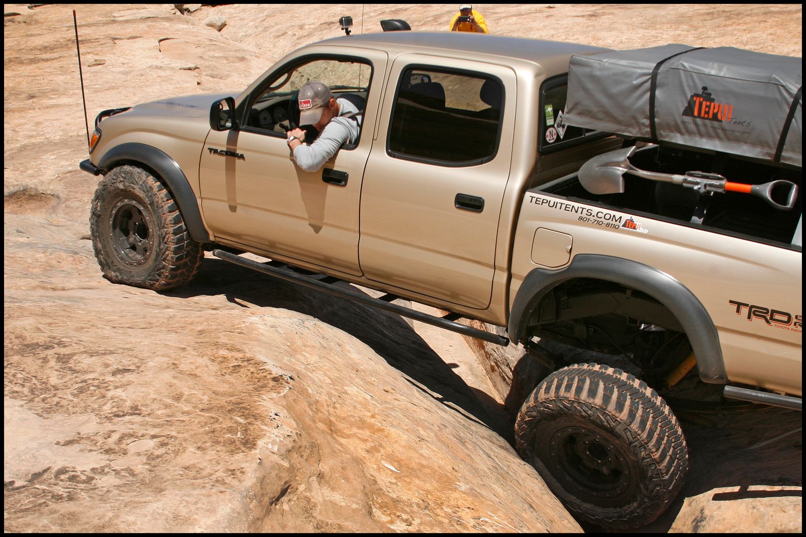

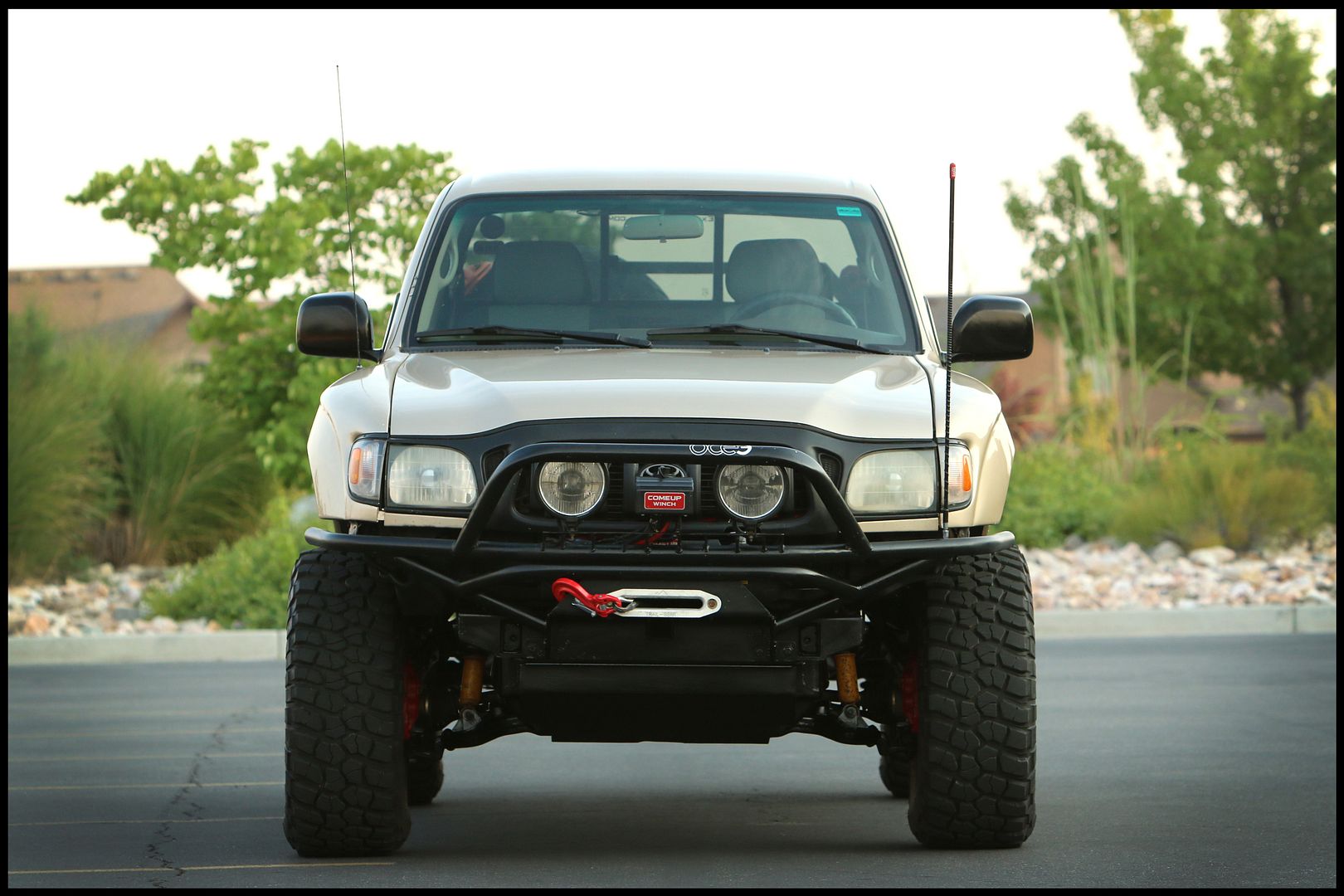

Hate the rear, but love the front. I for one have always had excellent luck with Trail Gear. There might be certain products that have issues, but I've had great experience with their tube bumper and sliders. My first product of theirs was a set of sliders that I won on a Pirate giveaway. They were the 67" ones that fit an 80. I had them on my old '93 for probably 8 years and beat the snot out of them with no visible damage other than some scratching on the underside.
I was impressed with them enough that I got a set for my Tacoma. Along with their tube front bumper with a similar design to this one for the 80s.
Again, very impressed with both so when I got my current 80 it was a no-brainer to get another set of their sliders. For the price I could hardly build my own for what these cost and they work really well.
Tube bumpers aren't for everyone, I get that. But as far as tube bumpers go, this design has the nicest lines IMO, handles a winch fine, offers outstanding clearance with adequate protection if clearance is your priority.
So I'm actually excited to see them offer these. Not sure if I'll ever replace my current ARB bumper but if I do, I'll definitely consider this one.

Yes those are the correct sliders. NOTE: Trail Gear doesn't currently sell them specifically for the 80 so the 67" extra cab ones are the ones that are the correct length. One thing that you should know is that the legs provided with the sliders (3 per side) work fine except for the front leg on each side. It isn't long enough because of how the 80 frame tapers. So you'll need to make your own front leg. Driver side is simple, passenger side takes a bit more work since you need to bend around the cats.
Also since these are weld on sliders, I highly recommend scab plates on the frame and large gussets on top of the legs.
Here's a shot of the front leg on my passenger side. This shot is after I changed my exhaust and replaced the cats, but this worked with the stock cats and the tube passed underneath the coupler between the two cats. 0.25" wall tube. wasn't fun to bend. :)

I had the 8274 on my 40 and it was a great winch to be sure. The thing liked most was the speed. I knew it would be more effort to fit one in my 80 so I went with the COMEUP I have now. It's not an upright (highmount as you call it) but I've liked it just as much and it has slightly better power and faster line speed. Was also a simple fit in this TG bumper.
