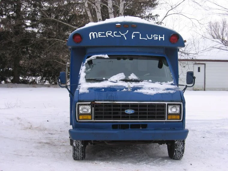

I think I found a name for it too.
What do you think.

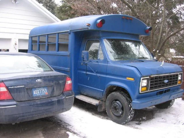

So anyway for 1900 bucks 1200 in the trans. I got a tow rig. Probably have most of that back in scrap should I need it. Full one ton running gear. D 70 dually rear. Good Rubber. Brakes questionable. Inside pimp.

Well it made it home. Ran out of gas before it left the trans shop. put a gallon in then filled it up.
Lost the muffler another mile down the road. Stopped put it in and then 59 miles without incident.

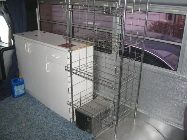

The aluminum interior is sweet! A couple of bunks along one wall, and a propane camp stove & cooler along the other wall. You'll be ready to camp in no time.
A glitter ball is required to compliment the multi-hued shag carpet. :grinpimp:
Yeah and Yeah, The aluminum is pretty nice, the bus has not been beat on on the inside. I replaced the starter Solinoid, so I dont need to start it with a screwdriver anymore.. Got plates and registration today. So it is legal.
I didnt get a good photo of it, but there is a fold out seat in the one side with two belts. its from a camper and folds flat into a bed. Pretty swanky.
