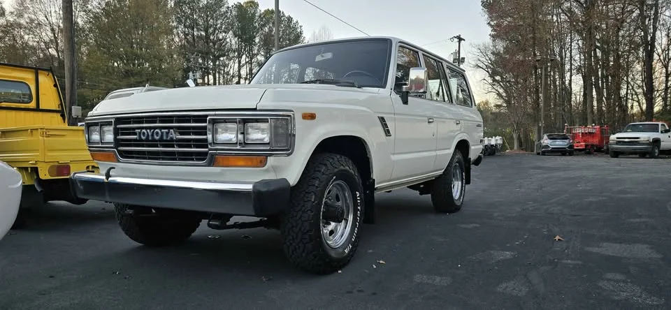

New here - just picked up 89 FJ62
Dec 11, 2024
5
53
North Carolina
Two owner car that lived its whole life in Chapel Hill, NC. 157k miles. Seems to be in really great shape. Bone stock minus the ~1999 alpine radio.
Plan, at least for now, is to keep it as original as possible.

Nice! Hope to see it around town!
Was it advertised locally?
That looks like one that was on FB for a while.
Welcome! Come out to one of the ONSC monthly meetings.
not sure if PO had listed it earlier - i found it on marketplace posted by Brendon @ Top Secret RTP who was consigning it for PO - it was only up for a couple of days before i snagged it.
Since i mentioned him, Brendon / Top Secret mostly deal in Kei trucks and random JDM stuff and not many LC, but he and his team were GREAT to work with - super easy process and we negotiated a number we both liked quickly.
definitely plan to come out to some ONSC events!

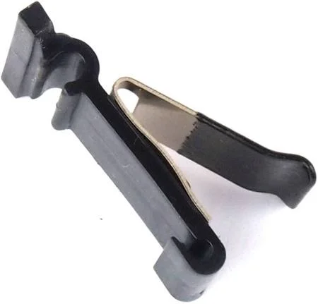

Turns out the interior handle for the fuel door DOES work - but the spring is missing from the fuel door, which is why it doesn't open - will order that at some point.

Fuel door spring is easy to get from your local parts store. 3 minute fix, tops.

Regarding the gas door release, mine was missing the V shaped spring at the door. Cheap part and easy fix.

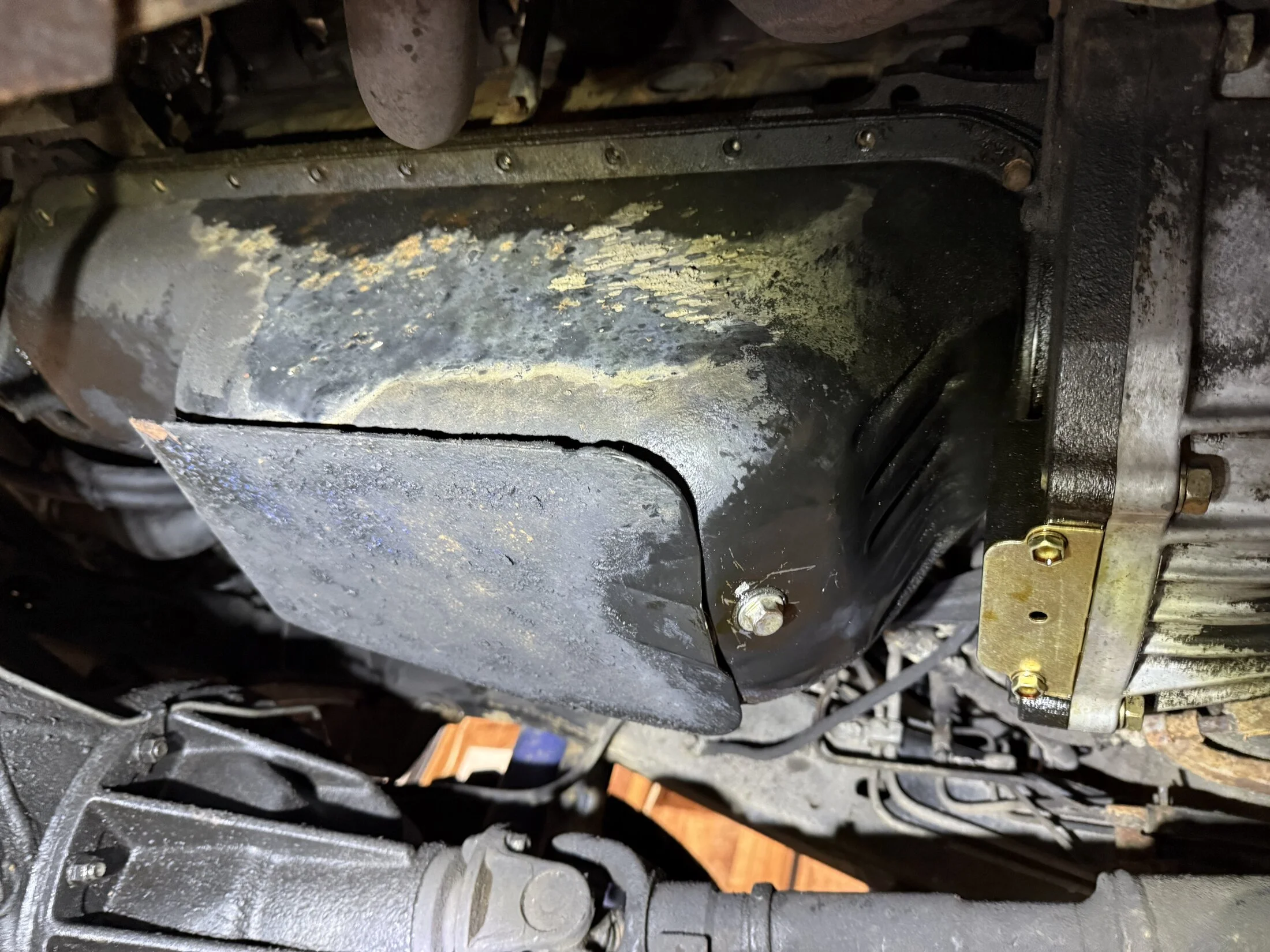

started on the oil pan gasket job tonight. pretty sure it’s the original one and the pan is cemented in.
set a bottle jack between the frame on the driver side and some wood on the side of the pan. hopefully there’s a pan on the ground in the morning.
(also i snapped this picture before zipping out the last bolts - i triple counted the 22 bolts to make sure i didn’t leave any in before i started trying to knock the pan loose :) )
