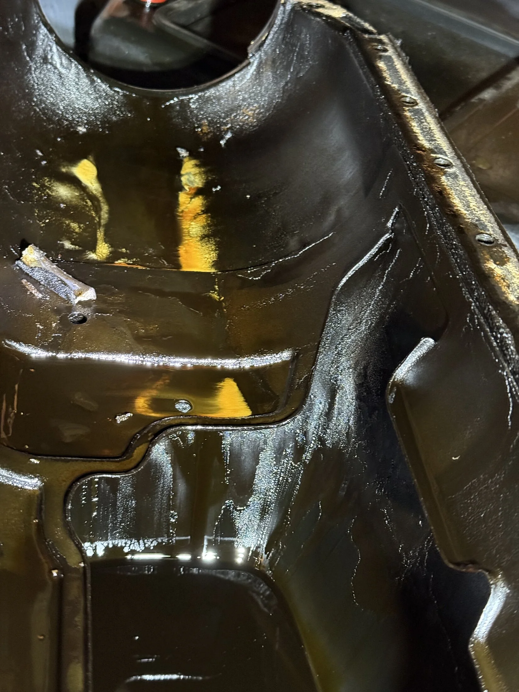

so that’s the good news. the not so good news… this yellow sludge in the oil seems … not good? (ignore the gasket chunks i tossed them in there) it also looks like there are some metal shavings in the bottom of the pan. oh boy.

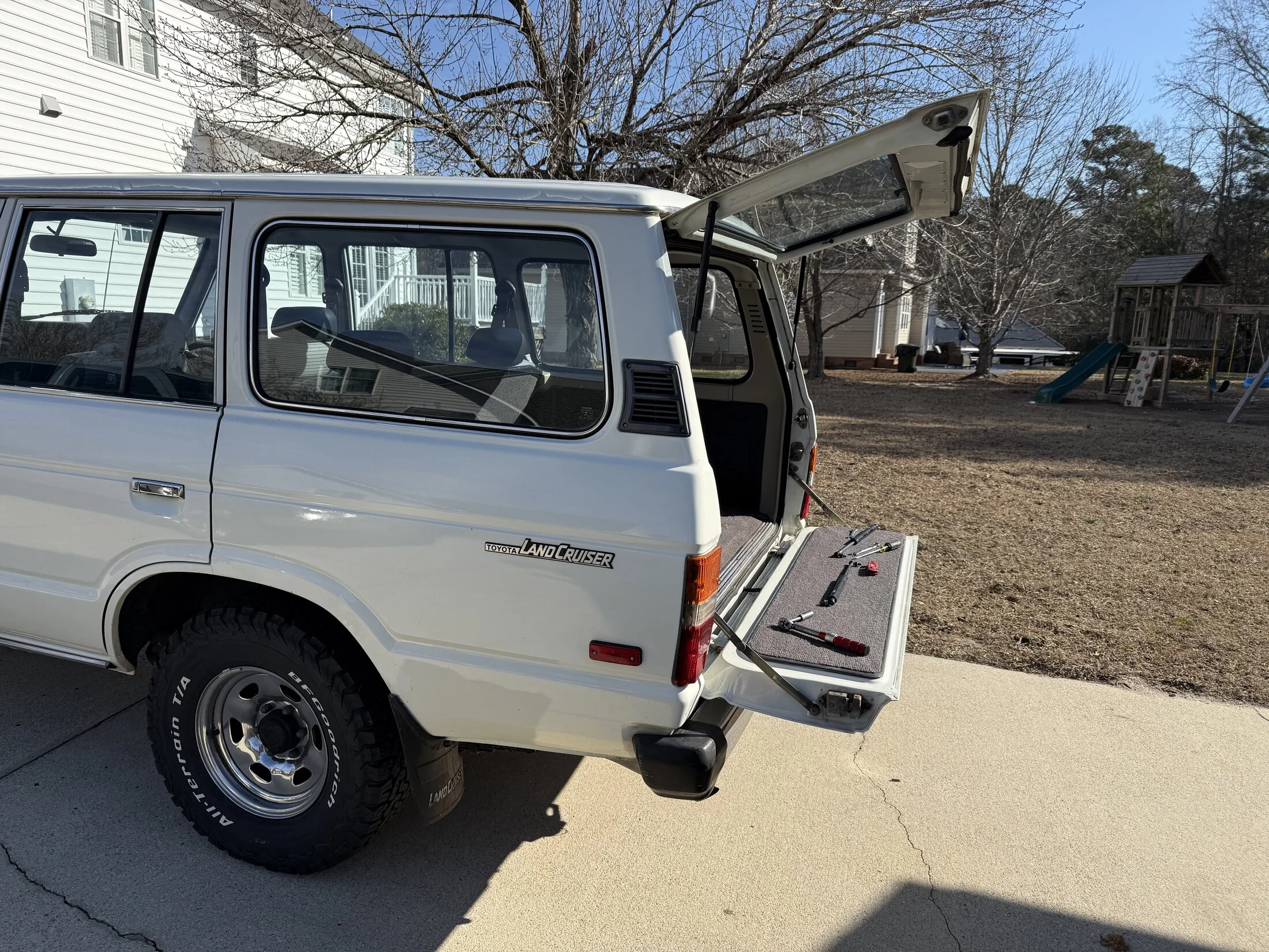

well after loading a 40lb pail while holding the hatch up with my head this morning, i went ahead and installed the replacement struts.
amazing!
… unfortunately the joy only lasted about 5 minutes - looks like the hatch latch / striker geometry is messed up and it just barely latches correctly with the old sagged out struts, but not with the new ones.
removed the new struts while i have a think on getting it to stay open AND latch closed.
starting to think i should have called this rig the “never easy” :)
Blackstone analysis came back - almost everything looked great - no water or coolant or anything like that.
Copper and lead were off the charts - to the point their analyst said "this would usually point to rod/bearings, but at this level the engine probably wouldn't be running" and their assessment is that PO had dumped in an additive like "Restore" which would have caused those readings.
Will send another sample at next oil change to confirm, but this was all good to hear!
