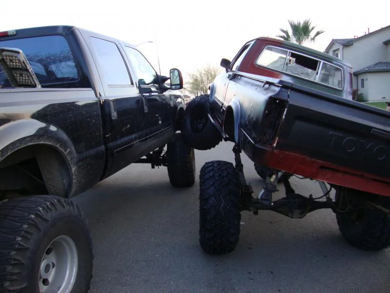

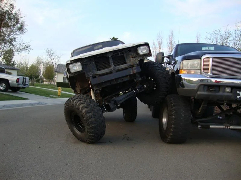

Just thought I would share the transformation that has taken place since the snow run. Stripped it down after the snow run and started the build. Tore the front end out and did the gussets and upper truss, filled it with 30 spline Longs (axles and birfs), detroit w/ 5.29s, new crawler rims with ballistic fab weld on beadlocks and 37' iroks, new 22r w/ 20r head (motor built from the pan up), Marlin duals (2.28 front and 4.7 rear twin sticked), welded on some front and rear diff armour and some other cool little things. Starting the front exo next weekend. Trying to get ready for the Jambo. Dusty mentioned Calico but I dont know if I will have the cage done. Hope to ride with you guys again soon. Enjoy..... Mike
