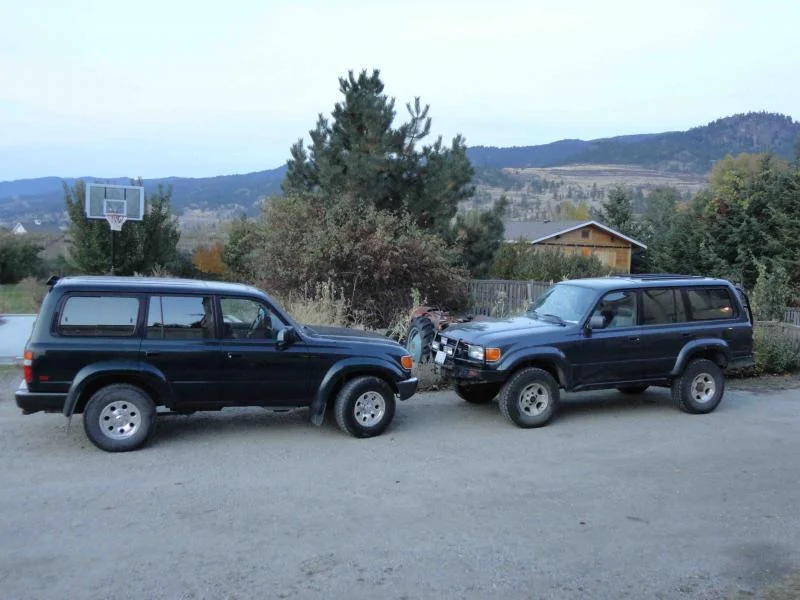

so i picked up another fzj80 that was for sale out of vernon. turns out it came from here before then. locked, 243,000 miles and in much cleaner condition than mine. turns out the original owner wasn't a soccer mom but she was a hockey wife. the fellow i bought it from drove it 8k in three years, baselined the daylights out of it and lavished it with oem parts. i can't find anything it needs other than a cdl button, a tcase speedo sensor o-ring and a factory hitch.
it is our official winter ski race truck to give the old girl a rest from the rust.
