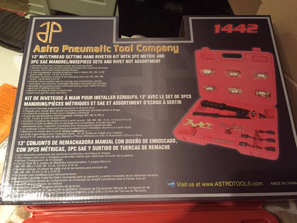

On a side note anyone looking for a Nut/Thread Hand Riveter .. I picked this up on Amazon for $65.91 normally $183.95., Needed something this heavy duty to install the stainless Nutserts for the fender flares
Crazy thing is a paid $6.00 to get it next day..we'll Amazon contracts with this second class delivery company that uses contract drivers in their personal cars... The package should have arrived yesterday and you guessed it .. It never arrived ... It took the delivery company until 2:30 today to contact the driver only to find out he took the package home and decided on his own that he wouldn't be doing deliveries today. They told him to bring the package to the warehouse and I have to drive out to the nameless company and pick it up..
This was such a joke I called Amazon and lit into them for even using a company like this and ended up getting a full refund. Checking out the delivery company on line..98 reviews and 90 were related to Amazon deliveries .. rating was 1.5 stars... It's an east cost company.

I have the same tool. I thought it was a great buy as well, but I basically wore it out installing the Slee sliders on my 200. Be forewarned that for heavy usage, it will not hold up.

Just going through sheet metal.... You installed sliders with nutserts? that had to be a PITA ...mine are welded on
