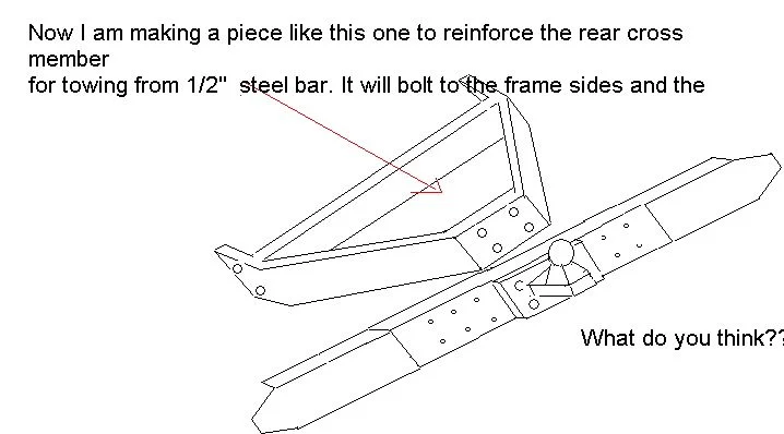

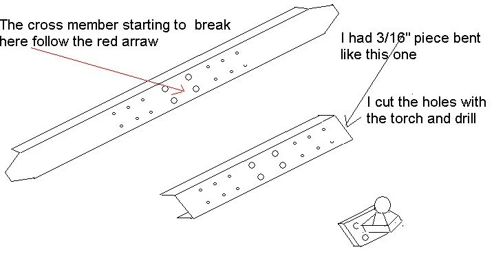

Currently I've got a ball hitch bolted to the back and want to switch that to a pintle hook and also add some shackle recovery points. I'd like to be able to pull a military trailer eventually. I also noticed that there is a crack/rip forming in/on the bottom of the member.
The crack/rip is maybe a 1/32nd to 1/16th of an inch and on the underside of where the ball hitch is mounted.

I don't think its too bad, but I'm not sure that its good enough for a tow point and recovery point for an energetic snatch. I'm no engineer though. Prob could just pound the bent spots back in place, weld up the difference, then brace them w/ plate. Then run that for a while until a new problem develops.
You might be able to add a plate to the bottom of the crossmember. The sketch you have looks like a good idea but it looks like it takes away your option for an auxillary tank if you were to want one.
that dent is not a big deal. it should be in tension anyway. You do want to make sure that the rivets (if they are still there) are in good shape and that there is no rust expansion going on. If rust has started pulling apart the rivet, it will weaken it. Could not tell from your pics.

ok, so i bought myself a 15ton pintle hook and am in the process of installing the beast.
Is there any reason why i shouldn't add a backing plate on the inside of the rear cross member channel? I plan on cutting up the old drop down ball hitch mounting plate and putting that on the inside of the channel.
I also intend to replace the nuts with grade 8 as soon as i can find some 1/2"nuts. Until then i'm just gonna double up with a jam nut.
plate is about 1/2"thick

Had to do some more grinding to fit it
and a crappy pic of it installed
