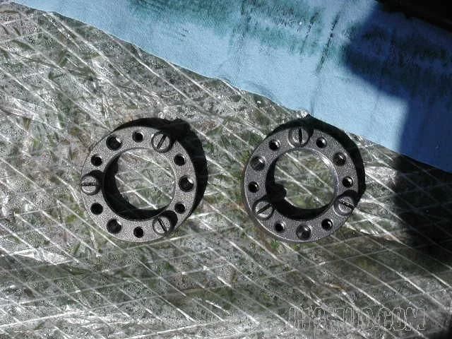

Does anyone know where I can borrow (or maybe rent) the Special Service Tool for the lock nuts on rear axle for an FZJ80?
I'm rebuilding mine this weekend (hopefully) and need this tool.
Here are the nuts, just incase that may help someone.
Andrew,
Bob G. heled me with my rebuild and he quickly fabbed a tool that worked pretty good. You may check with him.
Scott
I believe your looking for a "spanner".. Easily made.. I've often toyed with building one out of an old Cresent wrench or actually going and buying one someday!
Can this nut be replaced with the same dual nut set up found on front as well as most all other toy front ends? anyone done this? is there a reason this one need to be different?
