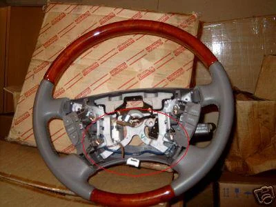

I picked up this wheel, was supposed to be for 1998 - 2000 LS400 and is supposed be the same as the 1999 LX470.
THe metal frame does looks identical to my LX470s ?.
Take a look at the part of the wheel that I circled in red, I notice this part is different on the 2002-2005 LS430, its has a different shape.
What does yours look like ?
The part number on the left hand side of wheel says 45103 30240 B1
like yours does but when I compare the circled part to a 02-05 LS430 wheel on EBAY,
the metal frame looks different.
I think the wheel with serial 45103 30240 B1 is actually for 1998 - 2000 LS400 sedan like this one:
http://cgi.ebay.ca/ws/eBayISAPI.dll...3&sspagename=ADME:L:RTQ:CA:1#ebayphotohosting

OK, after reading all of this again, I'm really pretty confused. Bottom line is: the new-to-me wheel I have is like the one in this picture and the one on the eBay auction. Accordingly, am I understanding correctly that this is for a 1998-2000 LS400? I think that's what I'm understanding you to say.....it definitely doesn't look like the wheel in your second post.......that begs the question: what was it that FJ55-100 found in his inventory? And which one is correct?
