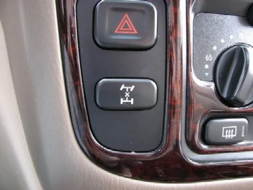

I'm looking to buy a 100 series and have (potentially) found one.
It has this switch. What is this? According to Slee's newbie guide, lockers are not an option. Is this that vtrac, or whatever?
Is this worth having?
Thanks,
DTaylor
Center diff lock. They all have one, even the newer (01+) with electronic traction control.
What year is it? Front and rear lockers were only an option in earlier 100's.
CDL can only be engaged in 4wd low in earlier 100's (unless you cut the appropriate wires), while it can be engaged in any mode (hi or low) in the stock configuration in later models. Not sure where the break is other than for '03, the CDL can be engaged in high w/ no mods.
Sorry, this is a 2000 model I'm looking at.
If in good shape, low miles, service history (would be nice) and you like it. Then go for it. I did piut in another $1.5k in pm after purchase. Just love it now.
Good luck.
Jim, FWIW, the CDL in my early '98 (no mod) also engages in 4H......
I just mentioned it since it seems some guys on the board have to do the infamous "pin 7" mod to enable locking the CDL in high.
