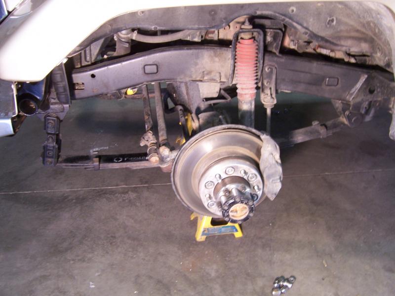

I have a 1988 BJ71 JDM as seen in my Avatar. The stock leaf springs have been swapped out at some point by a PO. The leafs are marked as follows:
#F60480 Front
#R60720 Rear drivers side
#R60730 Rear Passenger side
Can anybody tell me what company makes this suspension
Thought I would add a couple of pics of the suspension. I know I have seen these extended shackles somewhere else on mud before
Looks like I over looked the obvious. The Leaf springs are Toyota factory replacement parts as listed in the Toyo-DIY.com catalogue.
Front ToyoDIY.com
Back ToyoDIY.com

Yup, those are "Dune" forged shackles... I cut mine shorter and used the bolt holes that allow for them to be shorter. They're a pretty good shackle, but way too long.
~John
Did the same with mine except mine did not have the second hole so I had to drill out new holes.
As shown in the picture mine is running in the longest hole position. It has 2 1/2 degree shims added front and back and the stock leafs. It seems to work fine and gives enough clearance to run 33x12.5x15's
