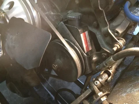

I need a picture of the front of a SBC that shows the location of the power steering
pump and brackets.
Thanks
Lane its a 3 peice bracket mine has the ac bracket as well but you need it in order to attach the adjustable slide arm
Hth
Thanks, I have the AC bracket and I guess I can fab up the rest.
Where did you get the water pump pulley?
I got the dual groove water pump pulley at summit racing, with all things v8 they are your best friend
my pulley and bracket set up is off a 73 K30 pu. you should be able to get all the right parts at a local junk yard without too much trouble

i am not into the bling of the aluminum but it doesn't warp link the stock one I had did which caused alot of fun with belts. but you can see whats in a kit and be able to make a list for a junk yard.
