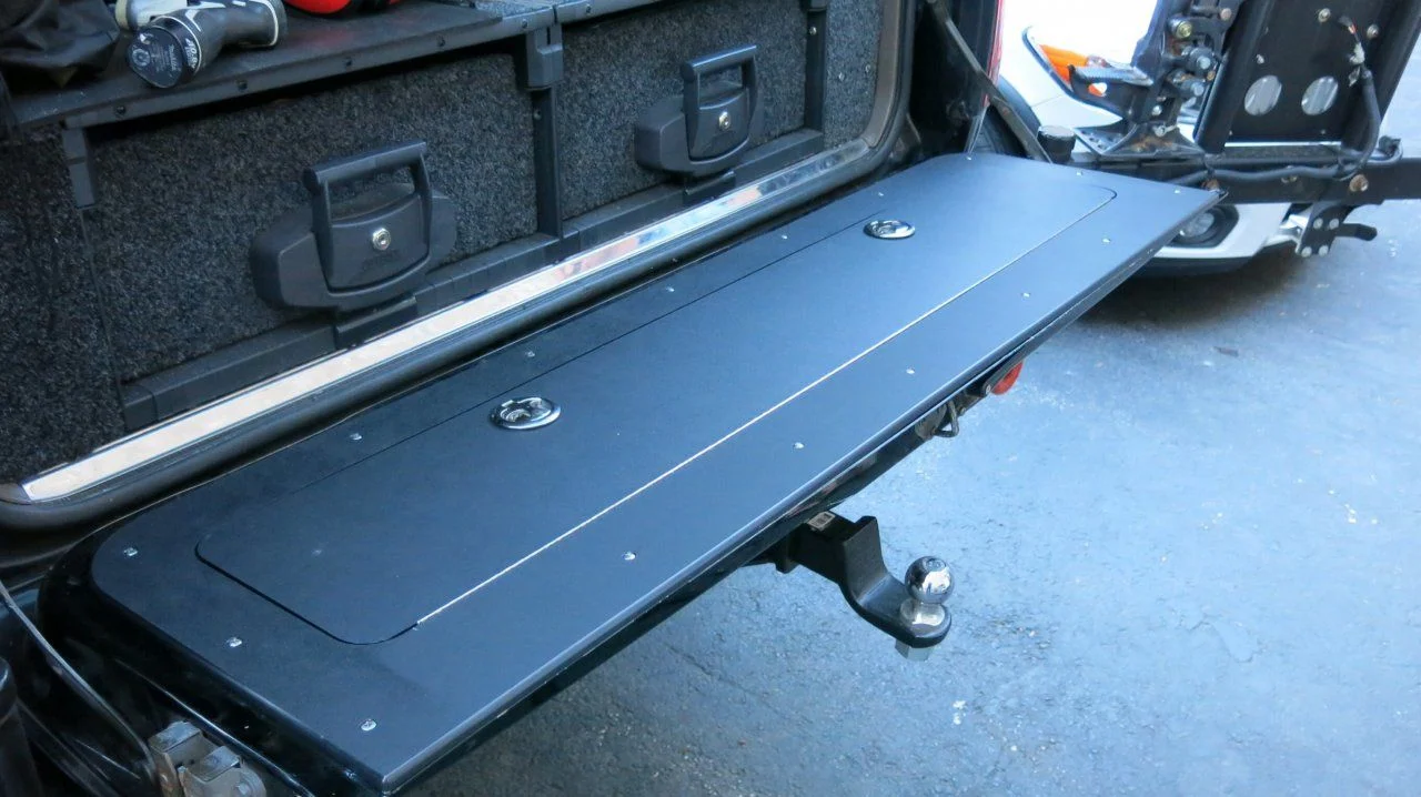

Is 15 3/4" x 13 9/16" too big? The Bomar hatch on the left here looks fairly awesome, but doesn't seem to lock. Does look nearly flush. I've got a drawer that scrapes the carpet, so I need to go flush or raise the box. Hmm, price a pair of these and WagonGear looks like a bargain, even before the powder coat...
Bomar - Commercial - Cast Aluminum Inspection Hatches and Deckplates

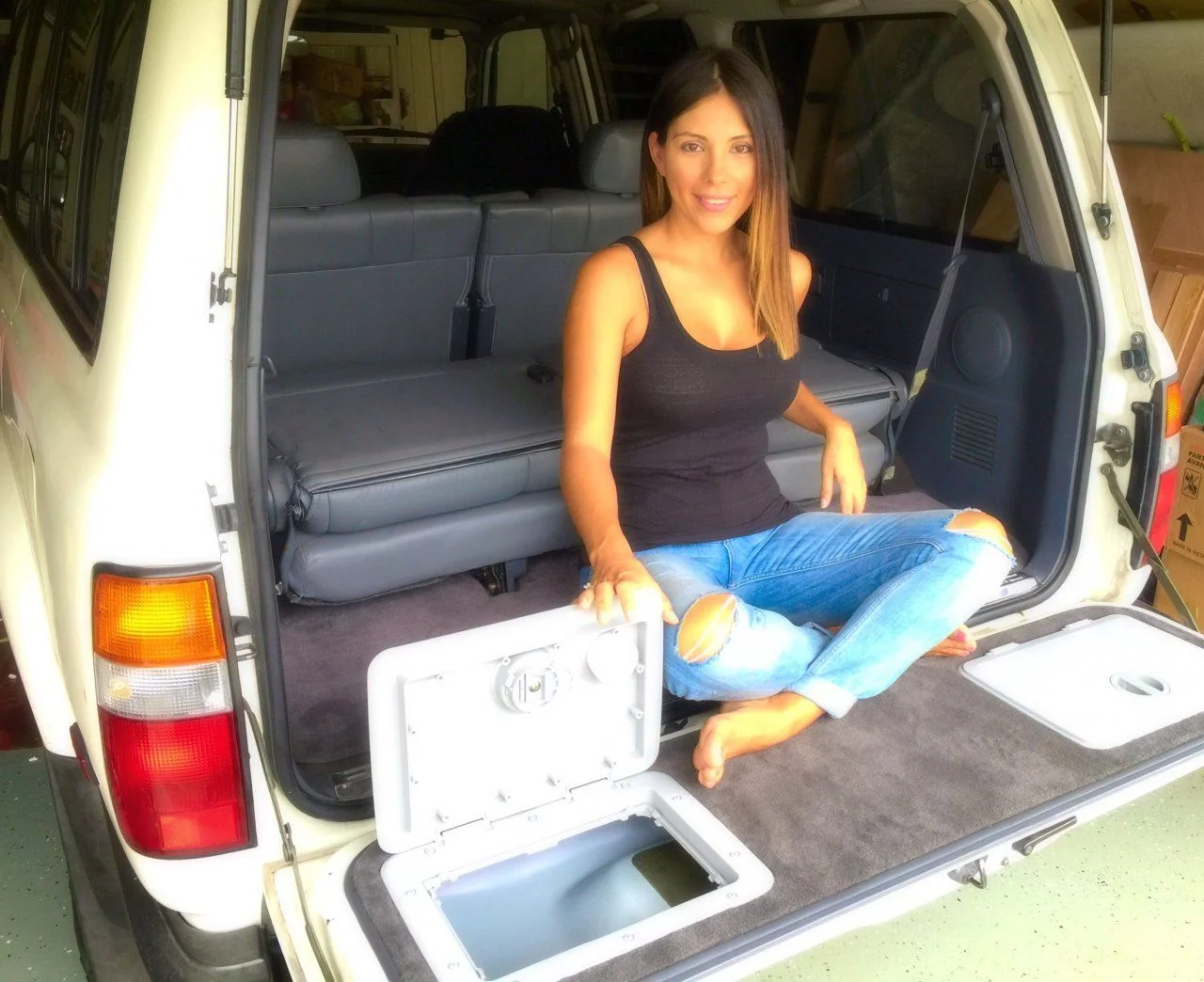

Great results @Aloha Jen! I love that you were able to retain the carpet, I've got mine removed right now and kneeling on the tailgate is a killer!
I've got the OEM rear spare swingarm style lower tailgate, so less interior space, and more reinforcements/brackets inside, so the uber expensive wagongear setup just doesn't make sense for me. But something like this that would allow me to make 2 smaller storage areas could work out really nicely! Or even one if there turns out to be little useable space on one side (I'll have to look closer and see what I'm working with).
I'd love to find something in a darker grey though, keeping my eyes peeled for options.

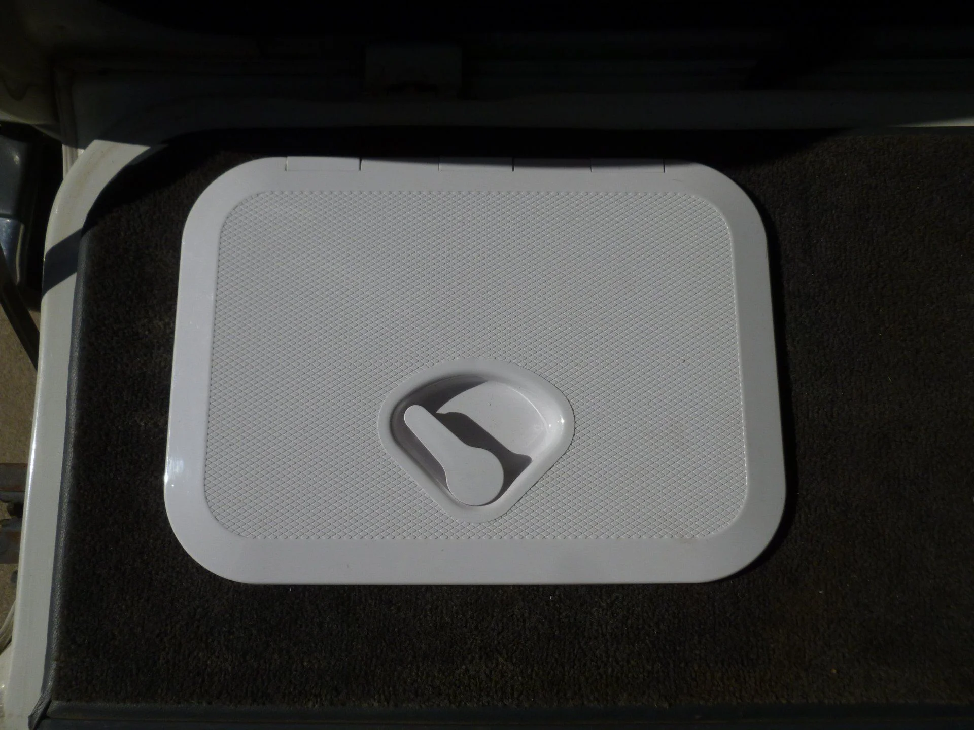

While looking for some taupe hatches that I could get shipped to canada, I found this. It might be a good option for those wanting a full length hatch.
Jet Technologies 6403-59 Taupe 47 3/4 x 13 5/8 Inch Starboard Boat Ski Locker Door / Hatch 201315 | Great Lakes Skipper

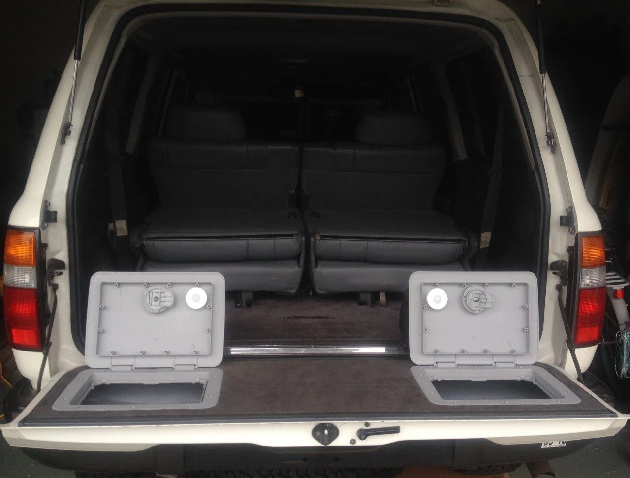

That's a great price for a hatch that big, for someone who is willing to cut both braces in the back deck. Since very little of the available storage in the center of the back hatch, I'm inclined to go with the two smaller hatches.
I bought one of the Jim Black Hatches in Taupe but ended up having a marine company make one similar to Wagongear
The link has about 30 Jim Black Hatches
Deck Hatches , Jim Black Hatches & Accessories | Great Lakes Skipper

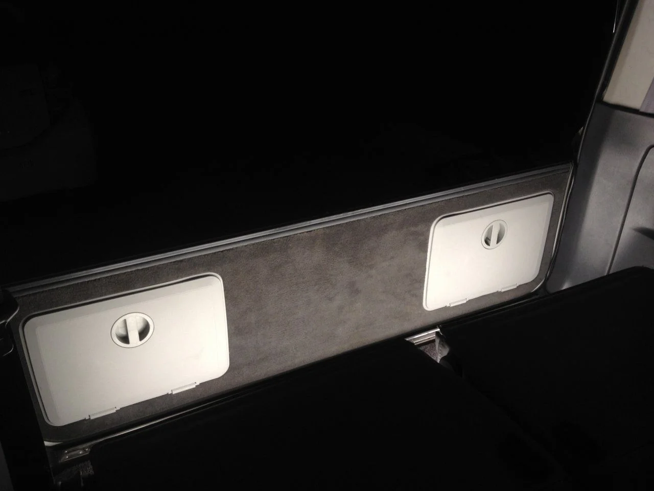

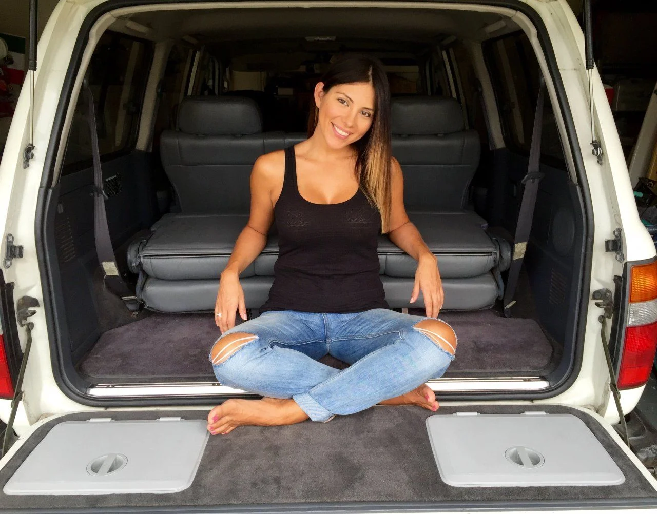

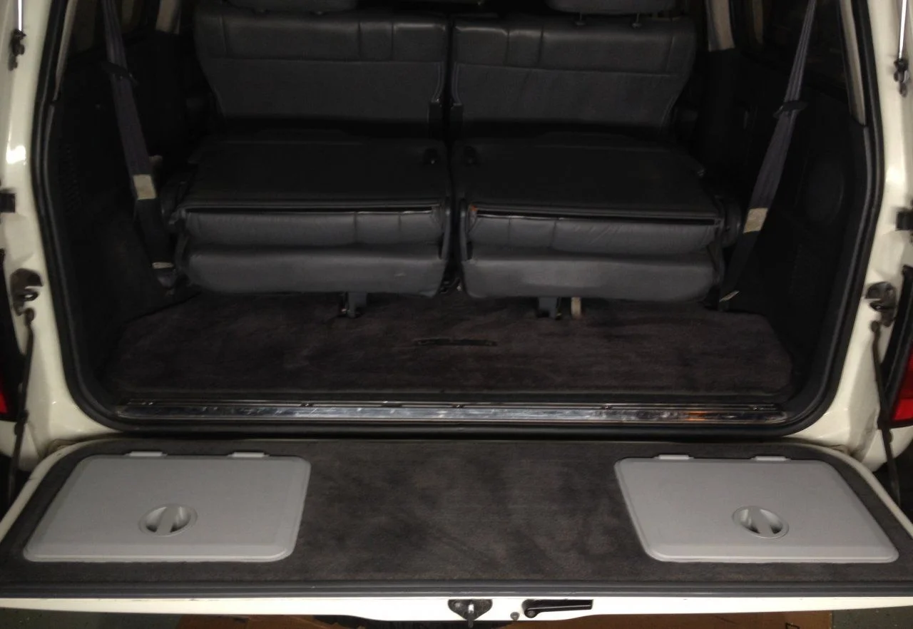

And the finished product.
With the tailgate closed up. You can kind of see how well they match the upper trim of the grey toned interior.
Now time to relax and enjoy.....

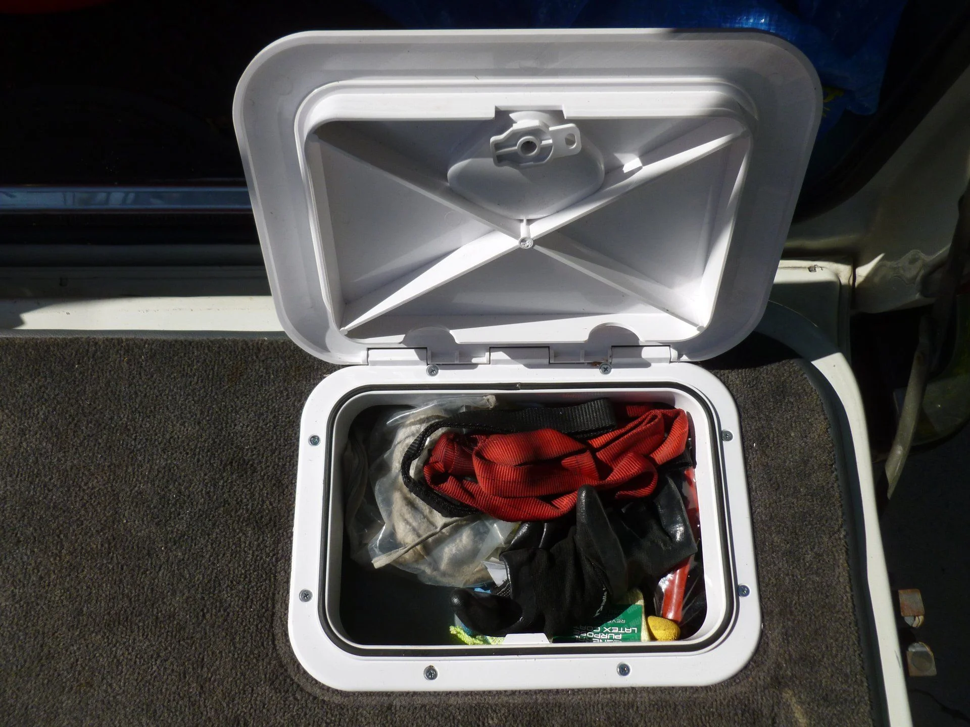

....and decide what to store in them. I was thinking spare tools, jumper cables, rack tiedowns, etc... What, too boring?? Ok, how bout a plethora of extra bikinis and lots of suntan oil! Should have plenty of space for that.
I really liked how it turned out. Hope this helps if anyone is considering doing this extra storage project. Aloha!
