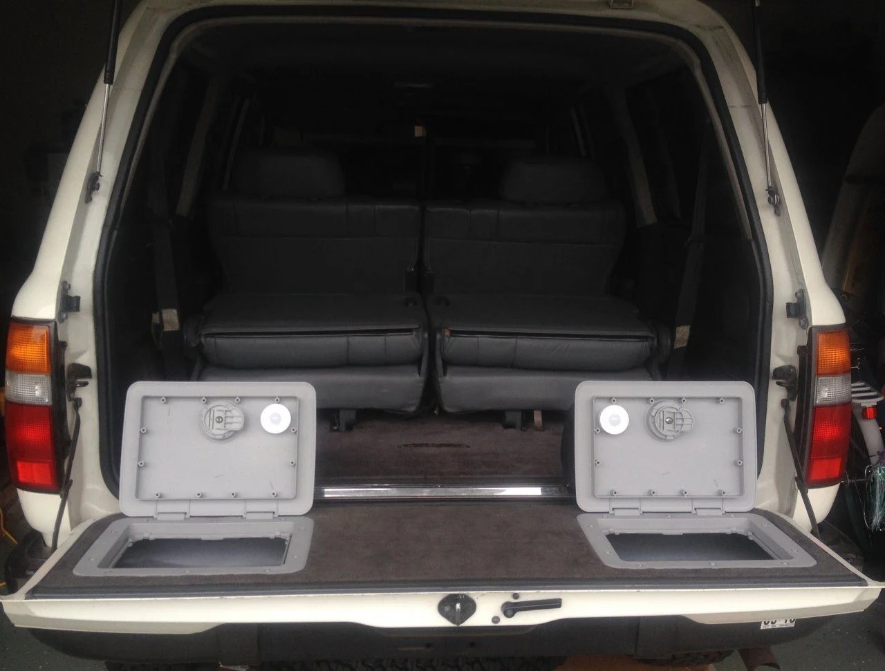

With storage hatches in, I wanted to add some easy lighting.
Went with some small LED puck lights that were battery powered. Got them at Costco, don't remember what I paid, but pretty sure it was under $30. I liked the idea of battery powered because if they were ever left on, you'd only be out a couple batteries to replace.
They secure with provided 3M tape, and chose the upper corner since that is where the most unusable space is in that area.....so less likely to turn on by something bumping and turning on.
Easy push button on and off.
And slim enough to fit under the hatches lip without hitting anything.
Also, they can be unscrewed from the base and work as a small handheld light if needed.

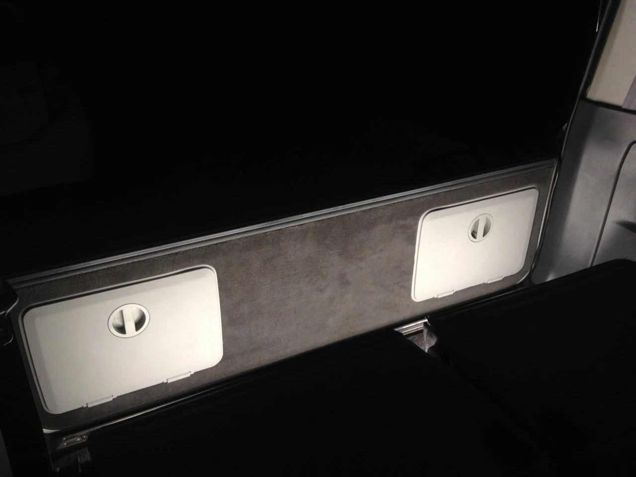

A few night time action shots. Not the best pictures, but the lights are very bright and put out a lot of light.
Plenty of light to see inside the hatches at night.
Hatches can be propped up easily to illuminate the area behind.

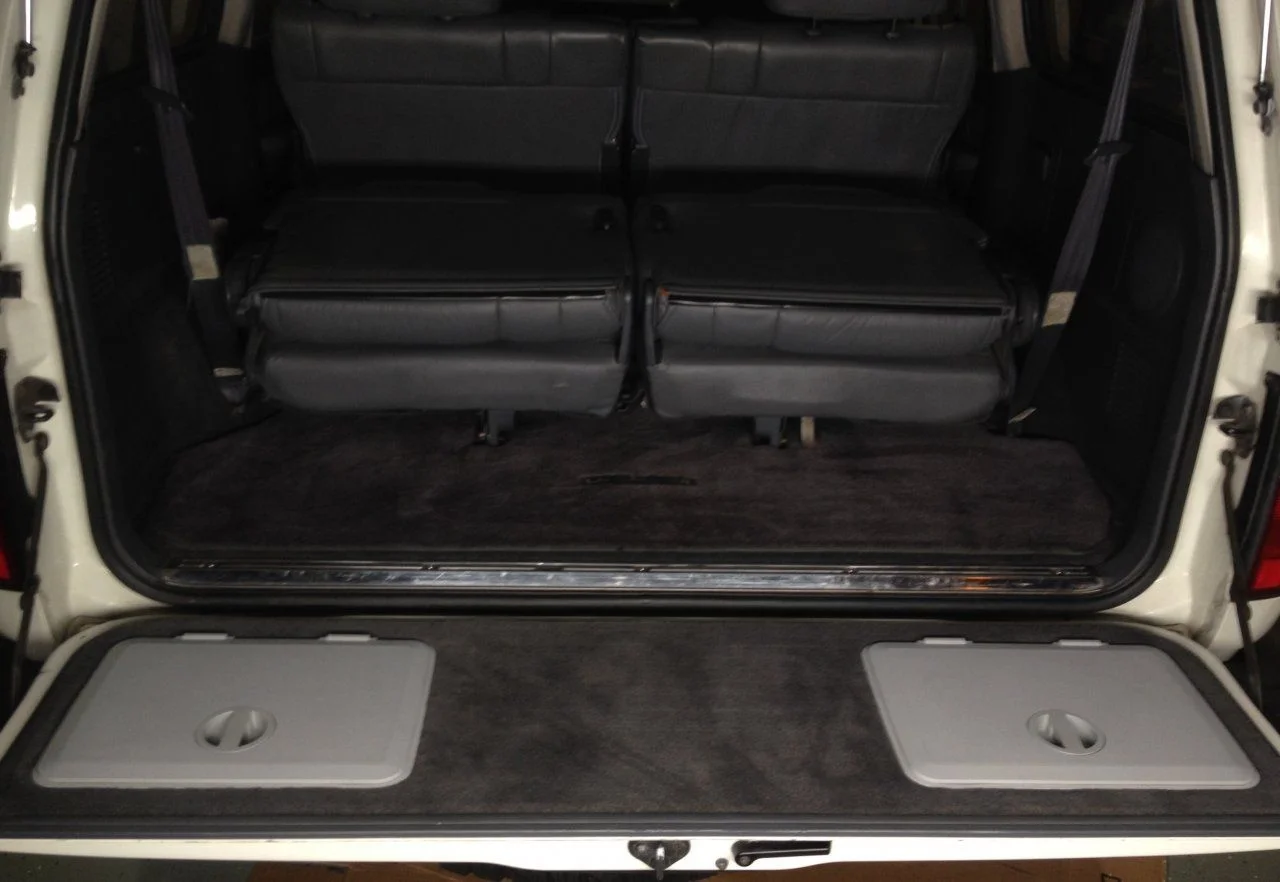

And the finished product.
With the tailgate closed up. You can kind of see how well they match the upper trim of the grey toned interior.
