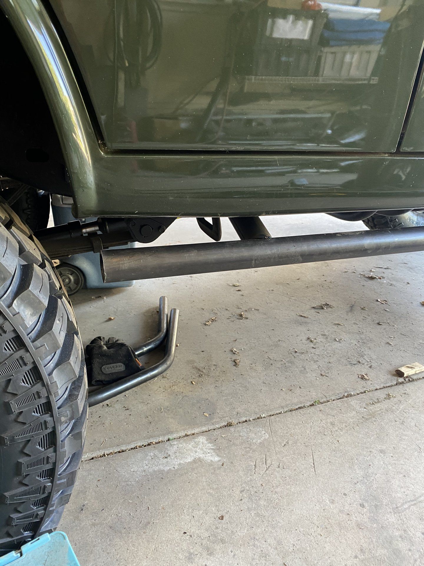

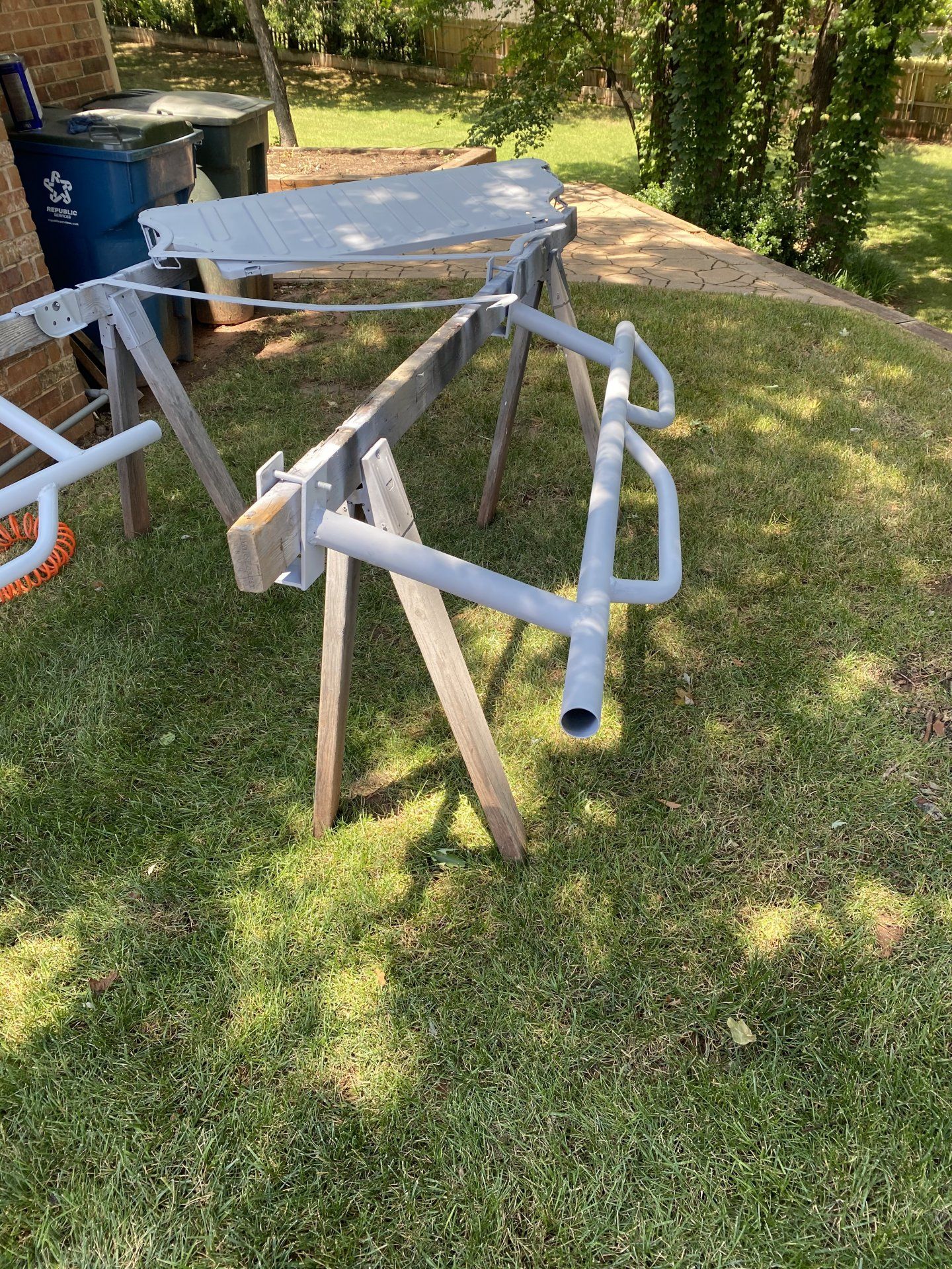

Started to address the issue of getting in the pig without a stepladder. I intended to bend the main tube at the front and realized I sold my 2 inch bending die. Sucks to get old and forget things.

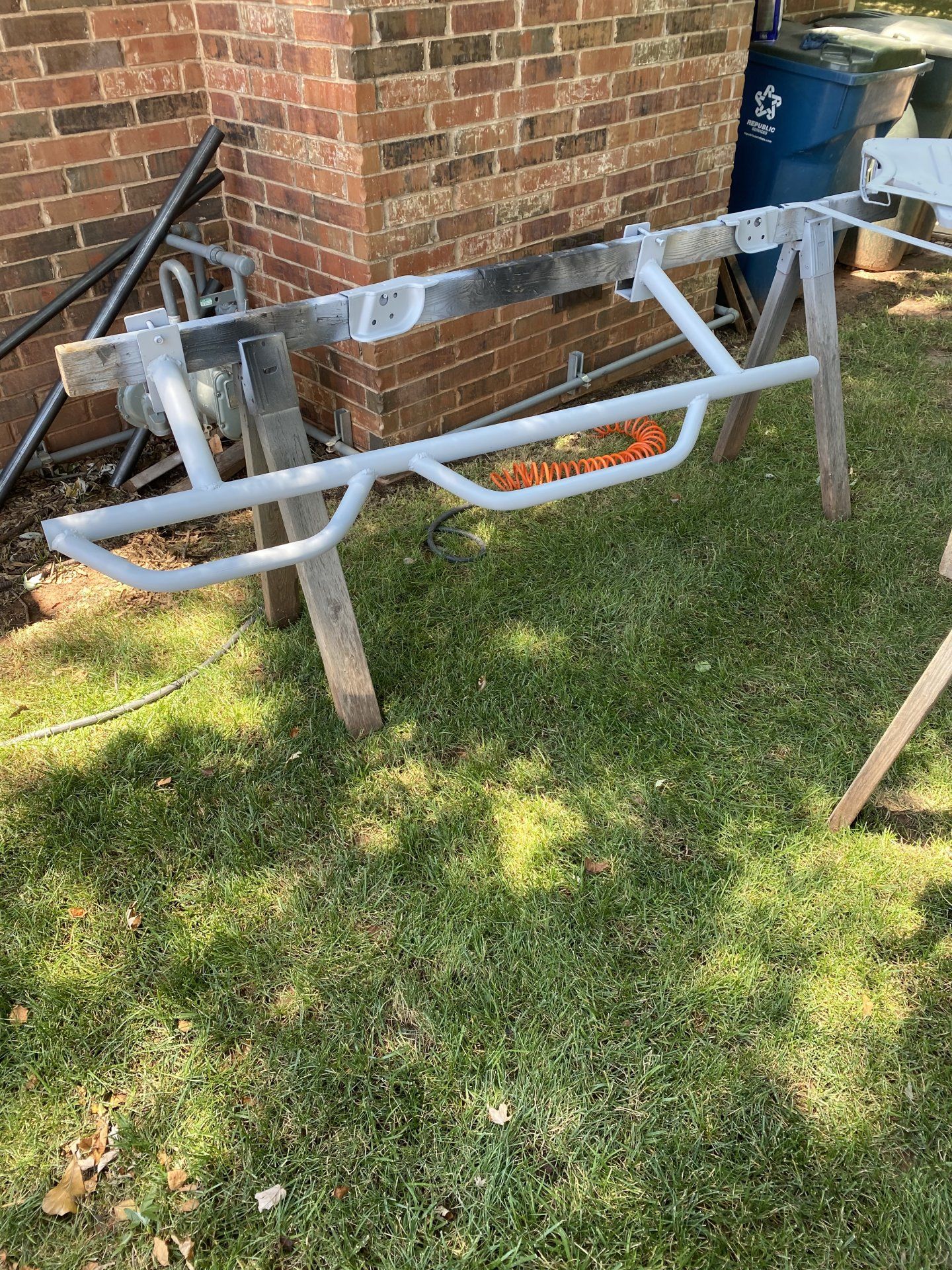

Completed yesterday. Bolted them on this morning to take a Father's Day drive and the battery was dead. No drive today. Charger still working 6-7 hours later. I'm guessing it's time for a new battery.
Yeah

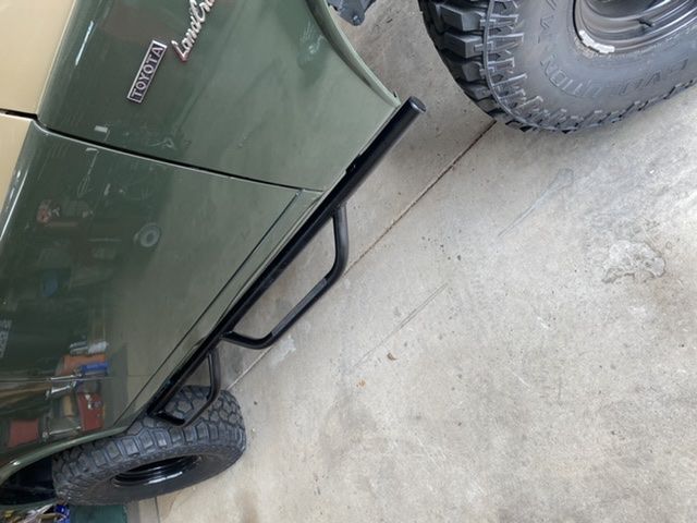

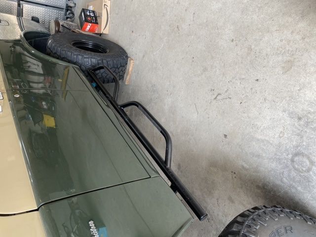

Wanna see how you attached them. Btw like that color combo!
I fabbed a U-shaped bracket to slide up the frame from the bottom and a bolt goes in across the top of the frame to clamp it tight. Depending where you weld to the frame bracket the tube angle is either 15 in front and 20 degrees in the rear.
