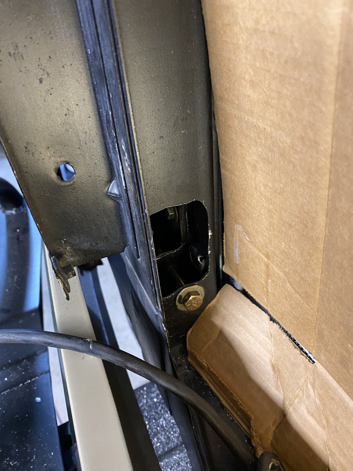

Have I said nothing is ever easy before? I contemplated AC line routing for a week before I decided the best routing was through the tubular side of the dog house. I wish I had done this way earlier in the build because trying to cut holes with a die grinder when you have little access room wasn't much fun. I'm happy with the result but it was painstakingly slow going, especially on the inner wall where you can't see.
I also had to cut out part of the inner fender to allow access to the AC charge ports. Little room for a cutoff wheel or saws all with shock tower welded in place and a big V8 on the other side.
Oh well, it was quality garage time on a cool Sunday afternoon. Next up, evac the system and charge.
Evacuated the system and charged the AC. I'm officially done installing it.

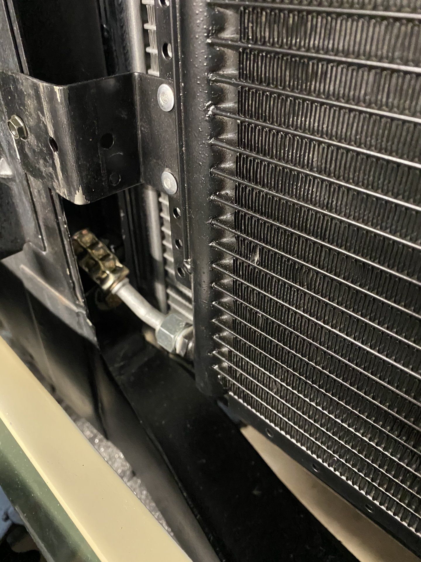

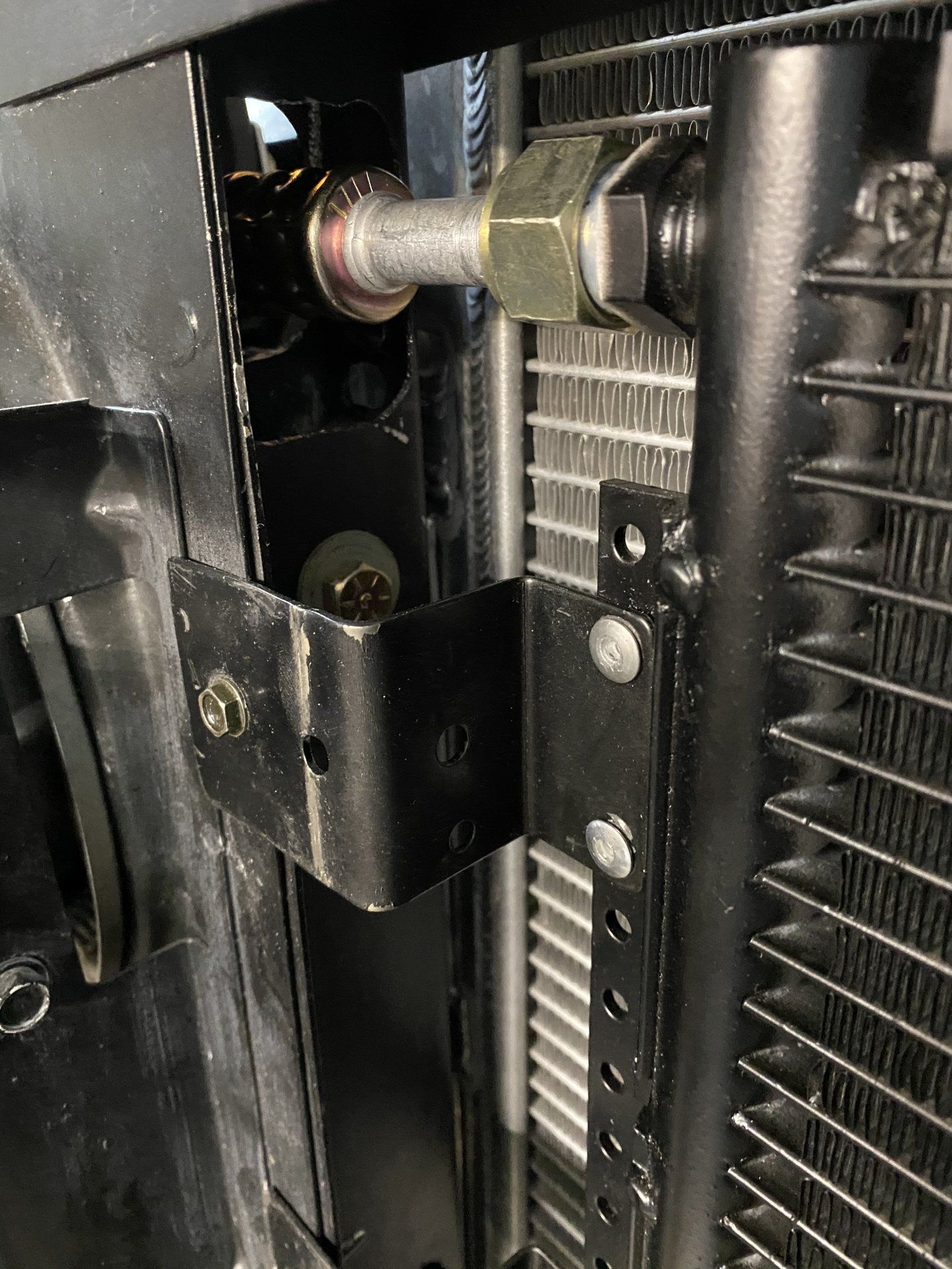

What condensor did you go with?
Looks like a good fit, eh?
Yeah it was a great fit. I could have mounted it a bit more to the driver's side and run hoses under it and between the condenser and the radiator but I would be worried about hose rubbing and eventual short life. I really didn't want to go through the side of the dog house but in the end it's the best routing. It was work but it really fit well. I'm really happy with the unit so far.
