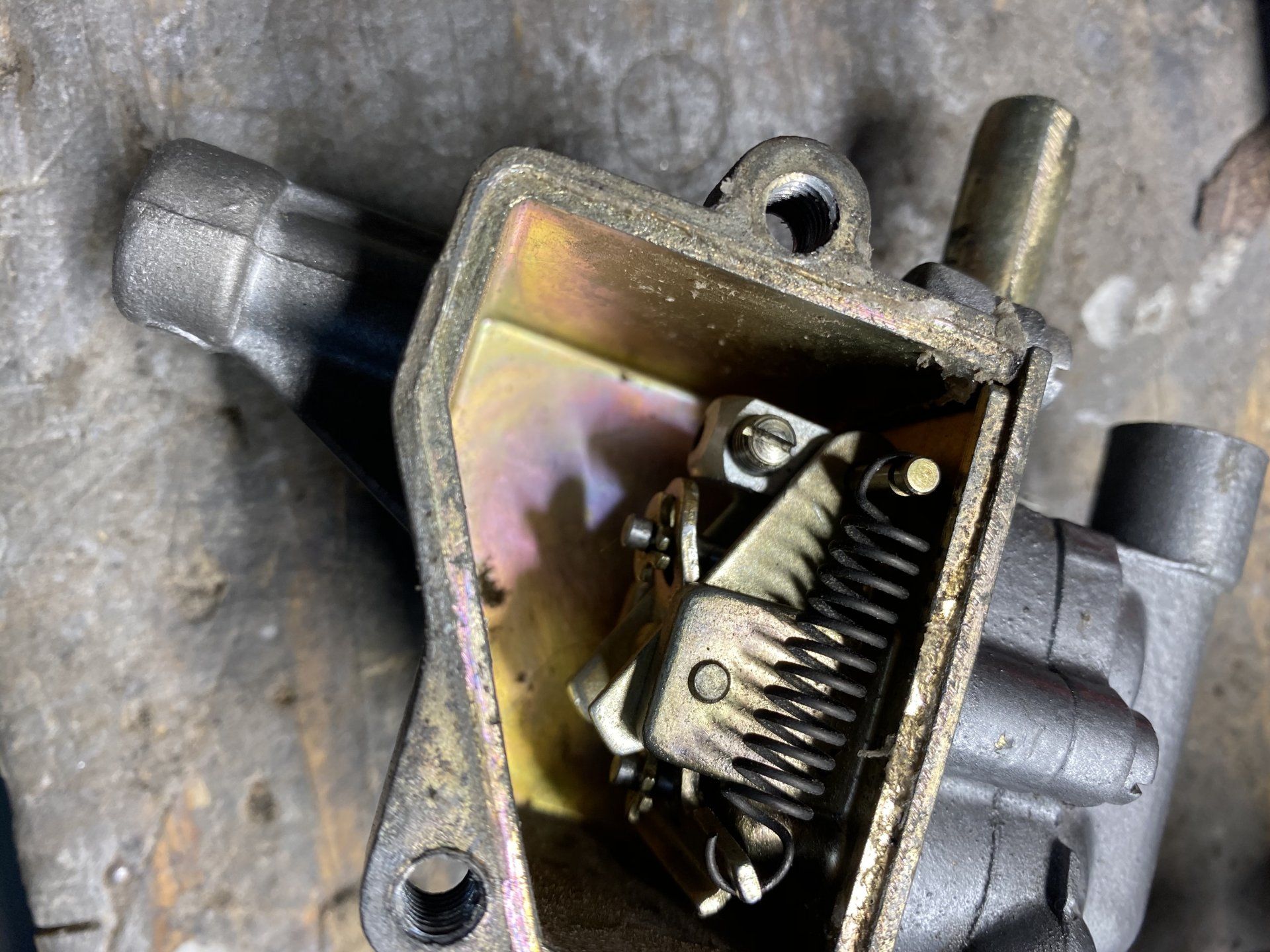

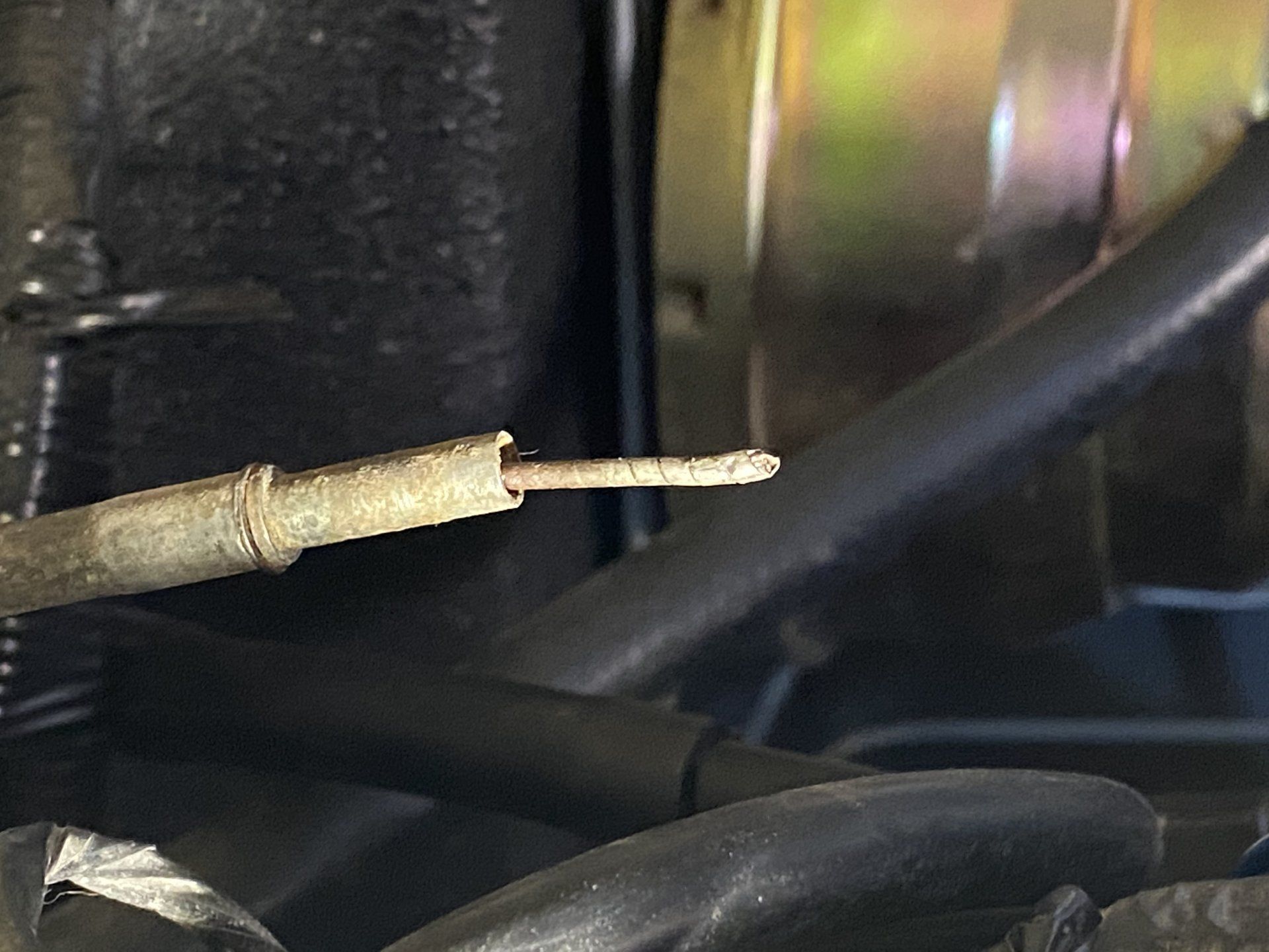

Tore into the FD actuator. Everything looks decent. My FD cable looks to be too short to fully activate the diverter valve At open and close positions.

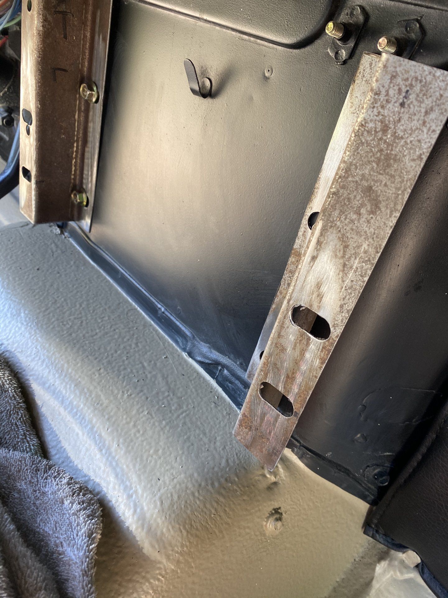

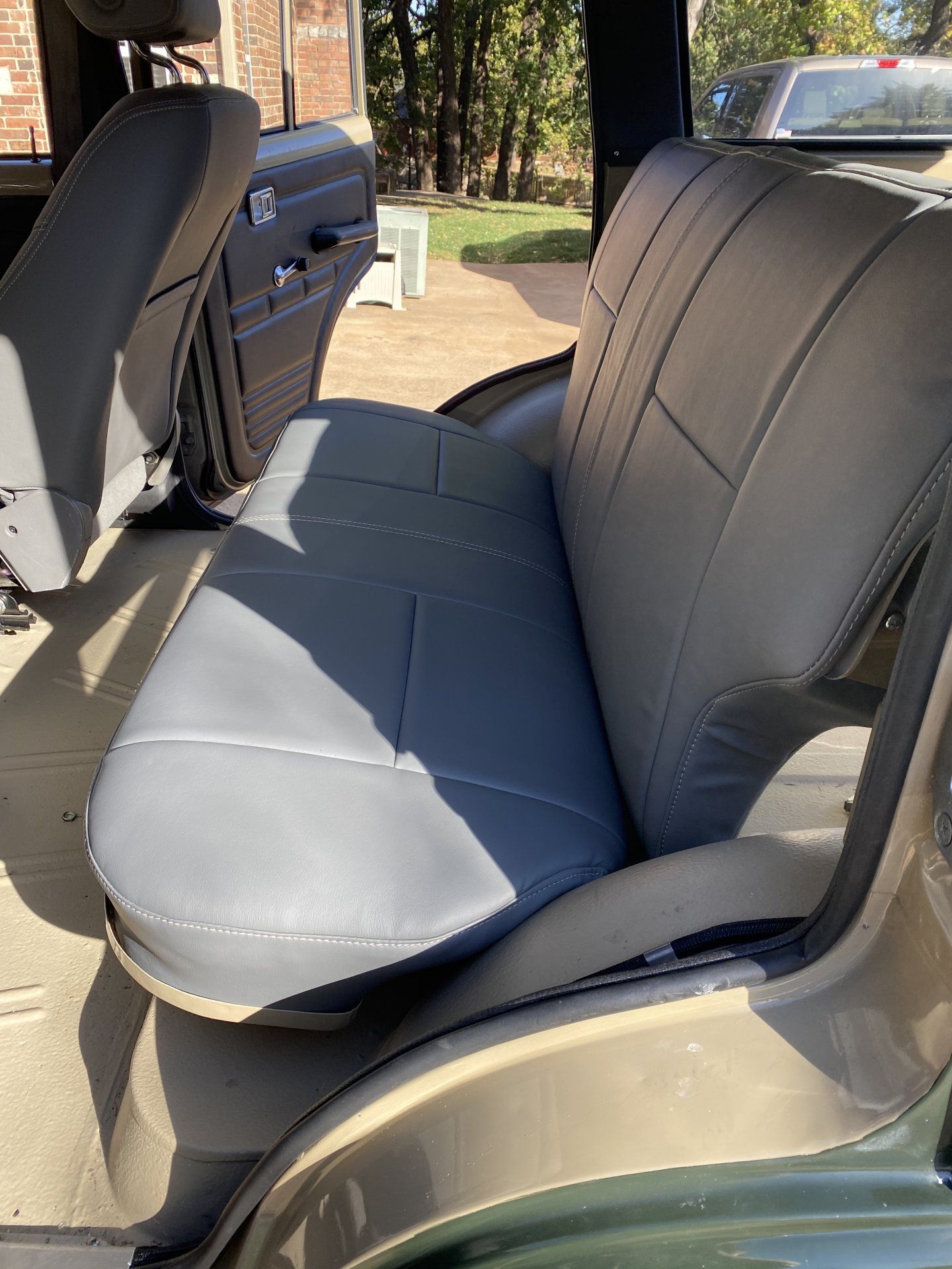

Busy time today. I received my seats back from the upholsterer so the morning chore was to install them.

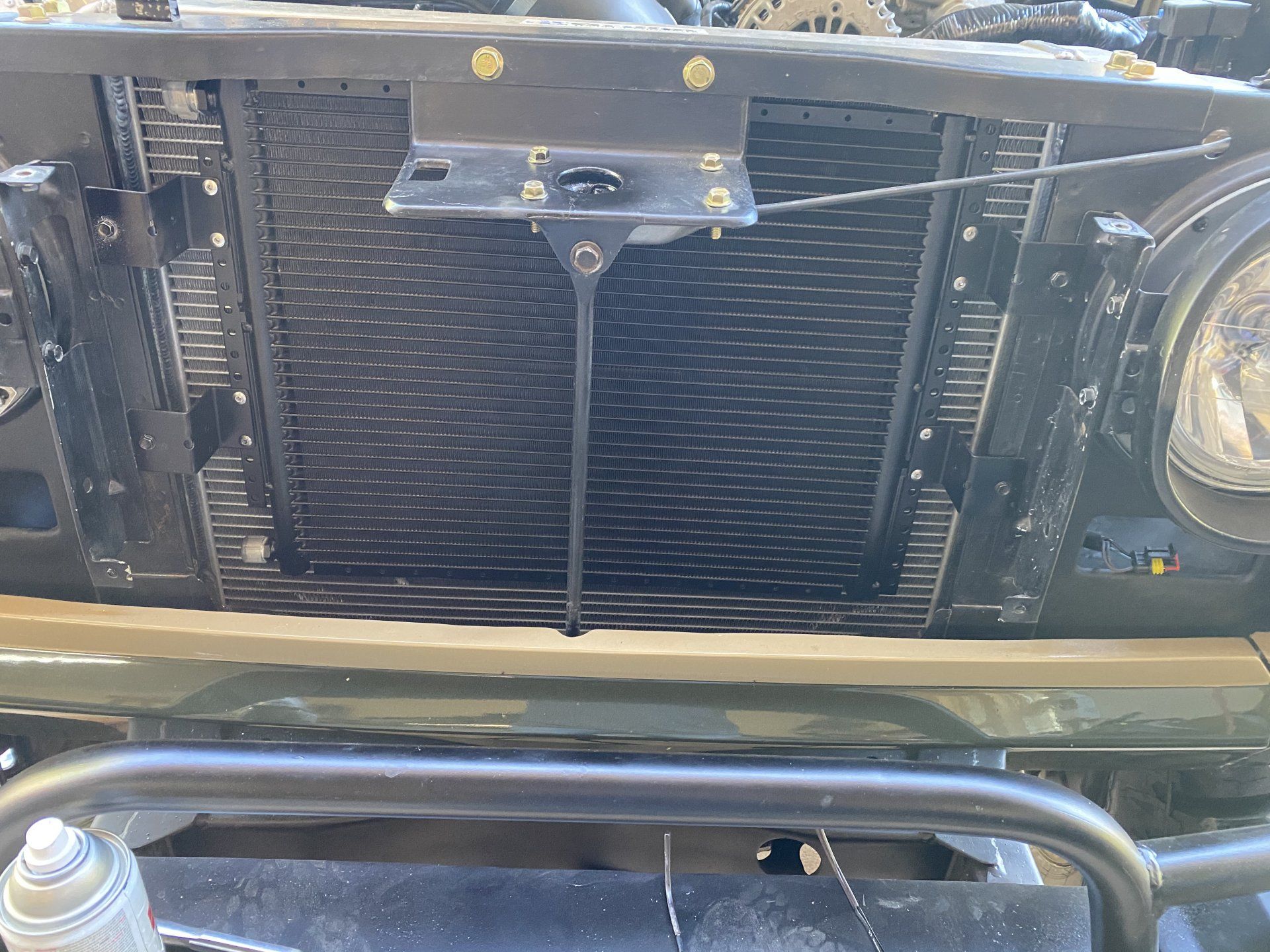

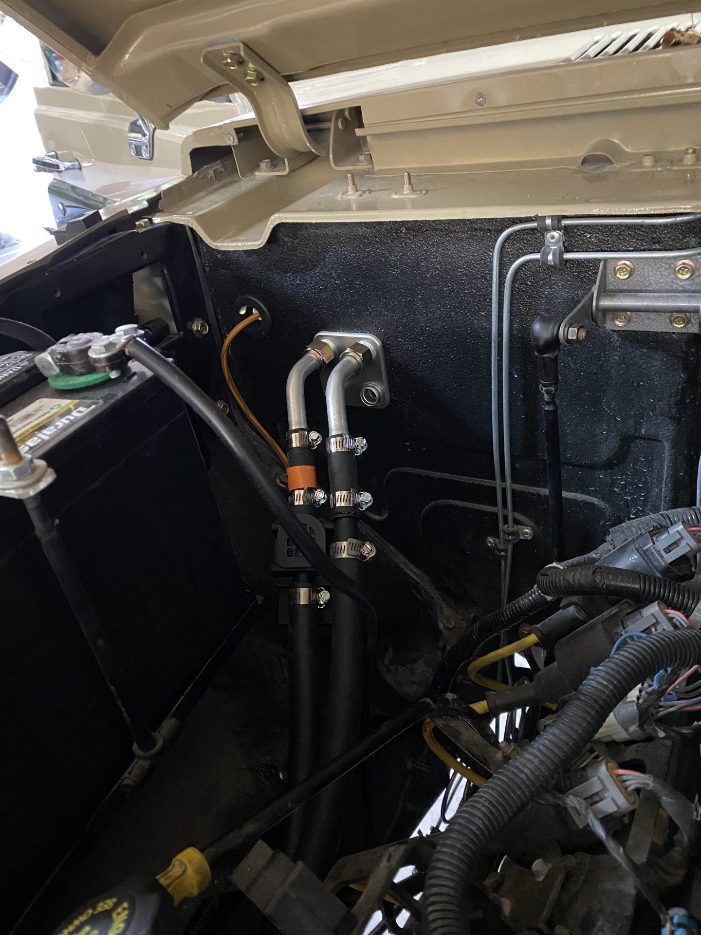

Then installed the condensor.

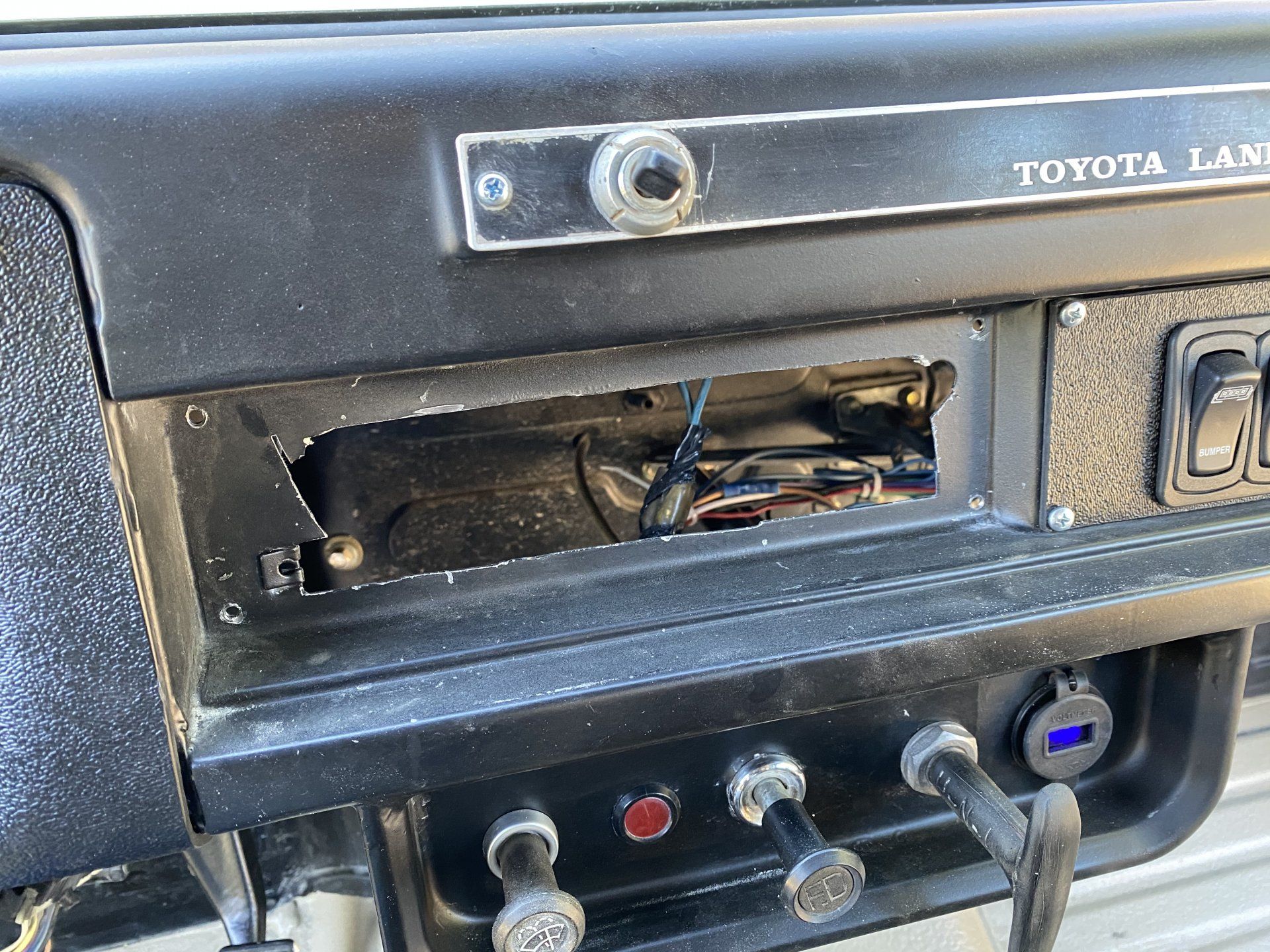

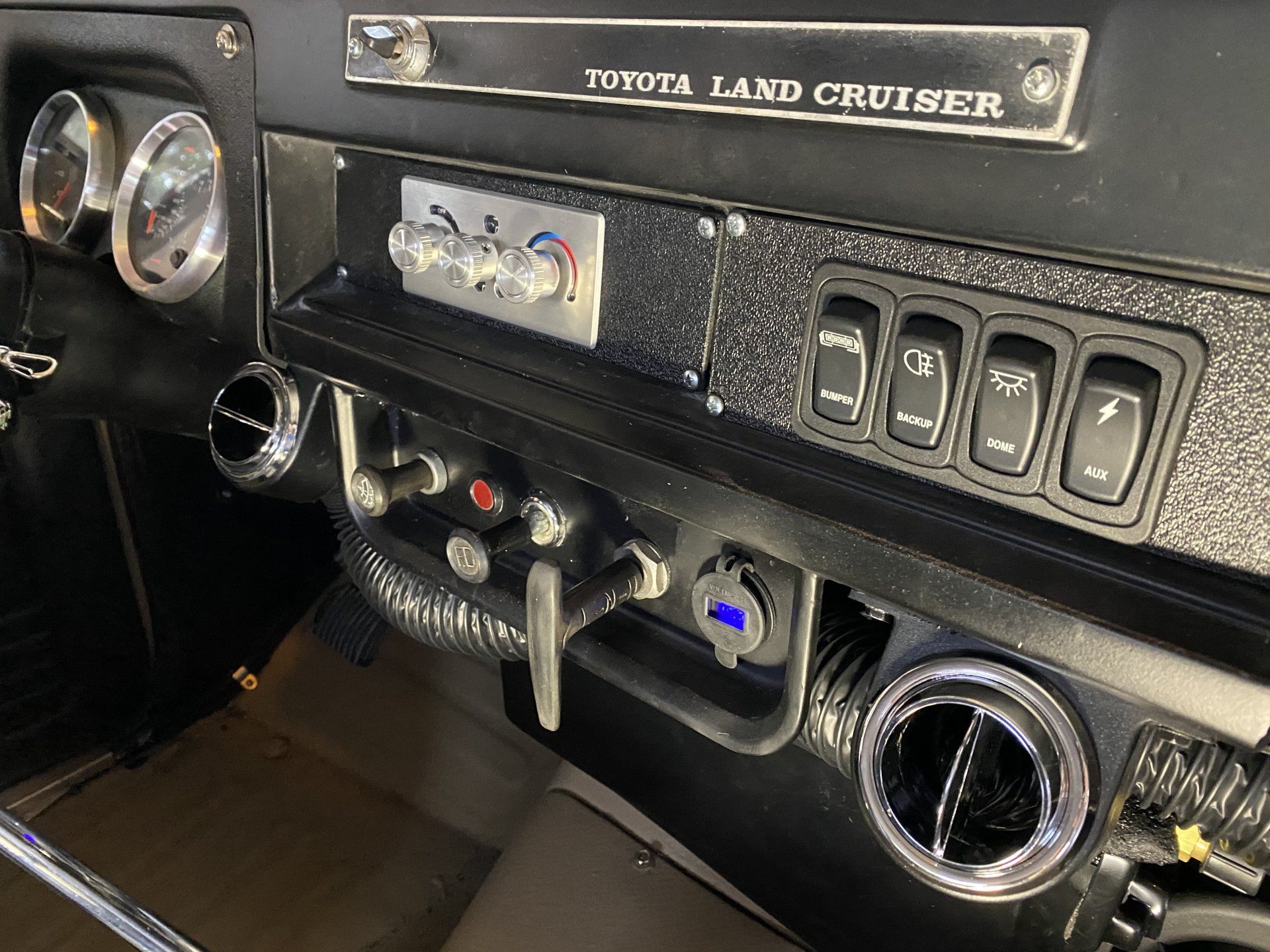

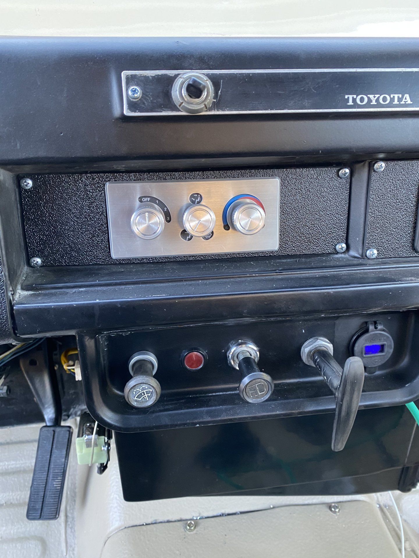

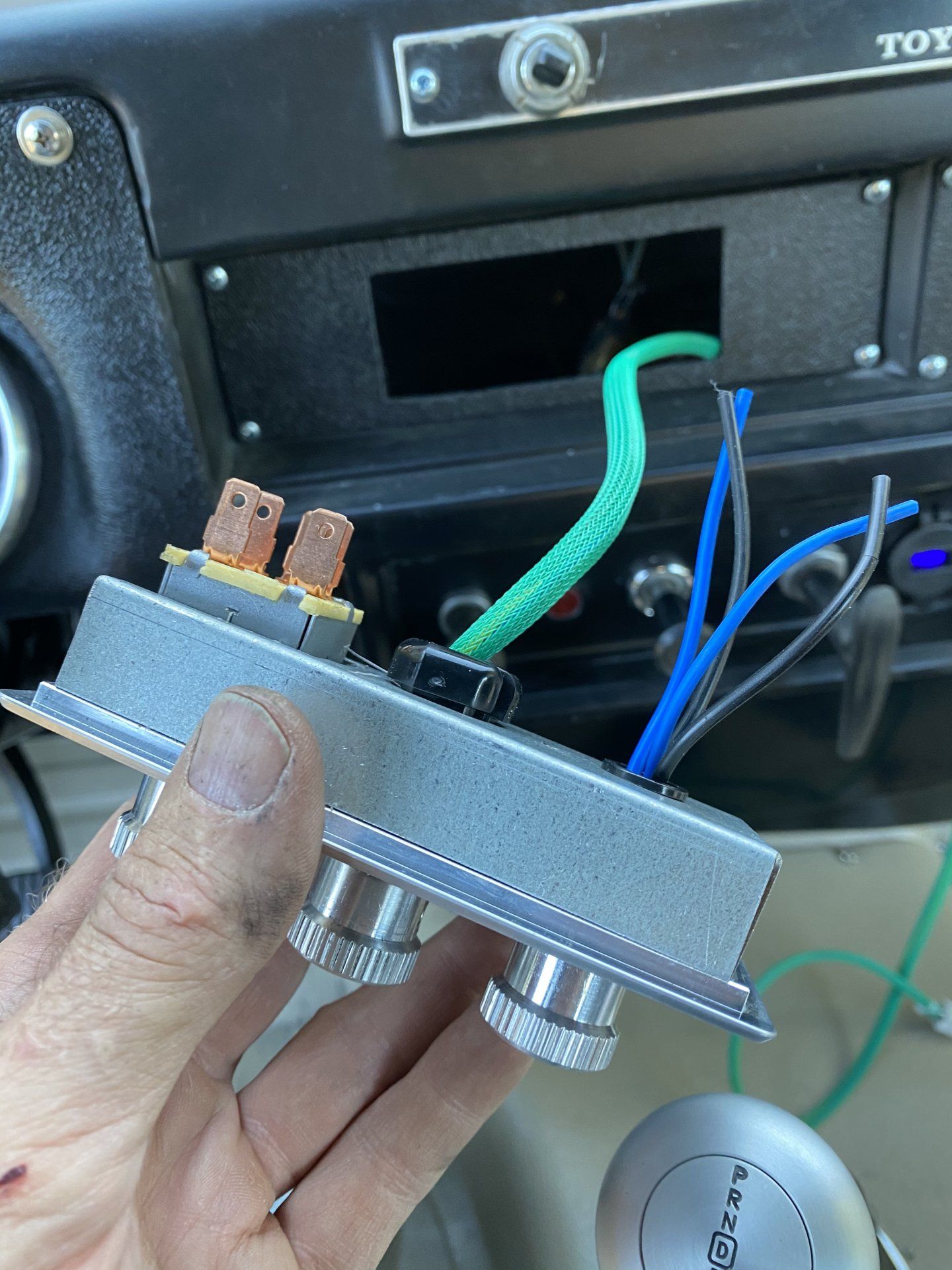

And cut a hole in the dash for the control. Not sure what to do with theses wires though. Everything else seems finished out and labeled so must be an anomal. I'll have to contact them Monday.

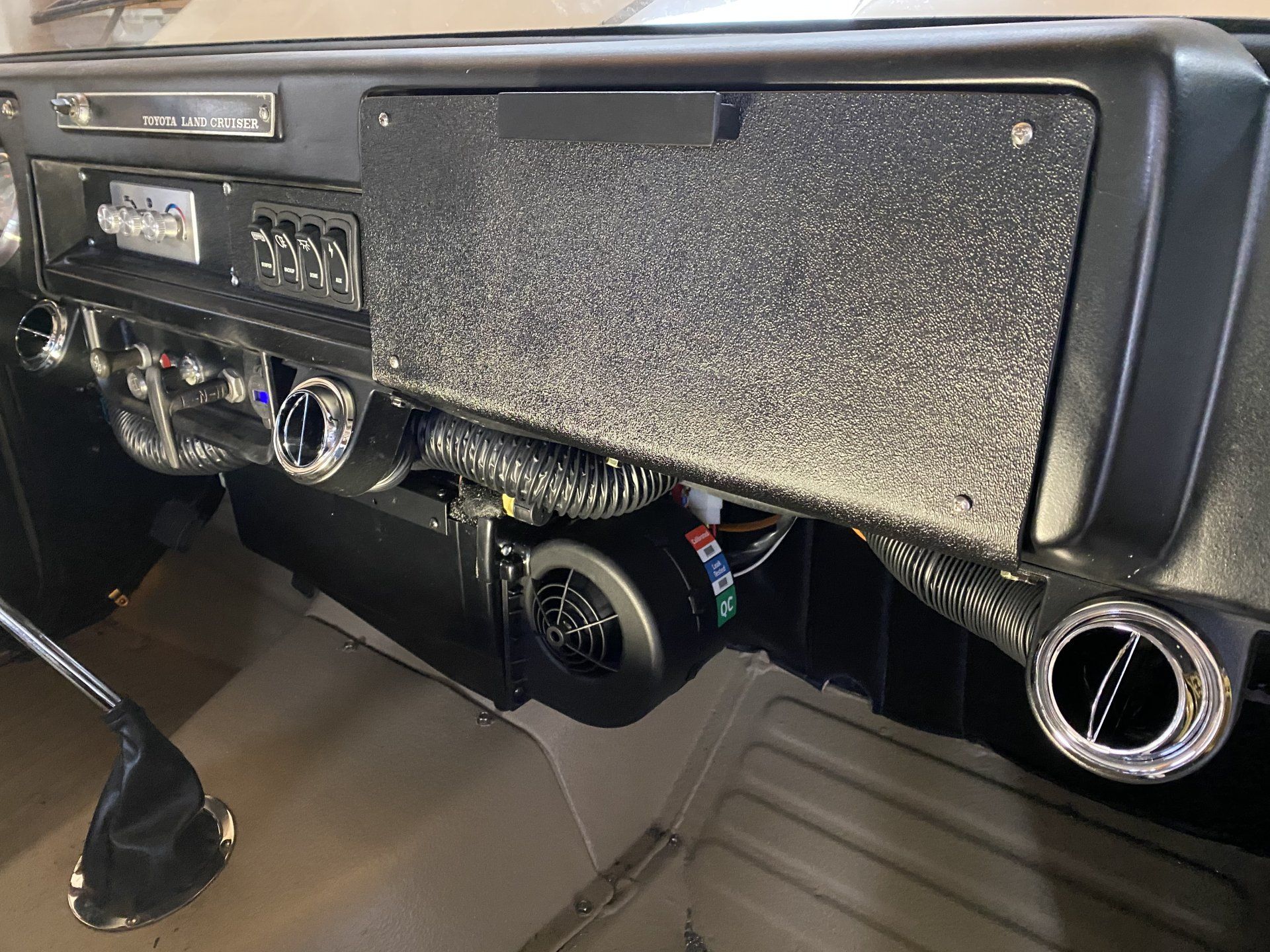

Today I was able to get the heater side of the unit all together, install vents and run duct work.
Refrigerant lines will have to wait for another time. I ordered a Crimp tool and I'll need to source a compressor adapter block.
