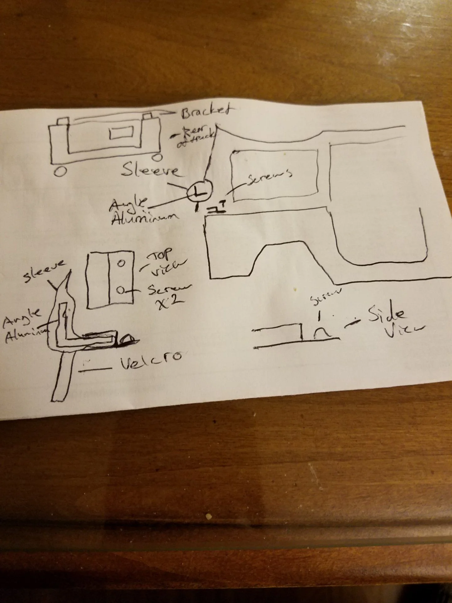

Thanks Jim. Looks like I'm missing the tailgate bits. :(
It's not hard to duplicate. Basically a piece of 1/2" angle aluminum that is .120 thick slides into the rear window sleeve and sticks out about 1" on each side of the sleeve. On each side of the tub on top of the fast track rail a bracket bolts on. The bracket has like a "c" channel that is a little over . 120 wide nd is fairly deep. The c is layed on its side facing rearward. The angle aluminum in the sleeve is pressed into the c. The velcro then is a final seal which you put along the top of the tailgate, and about 2" of velcro on the tub on each side.

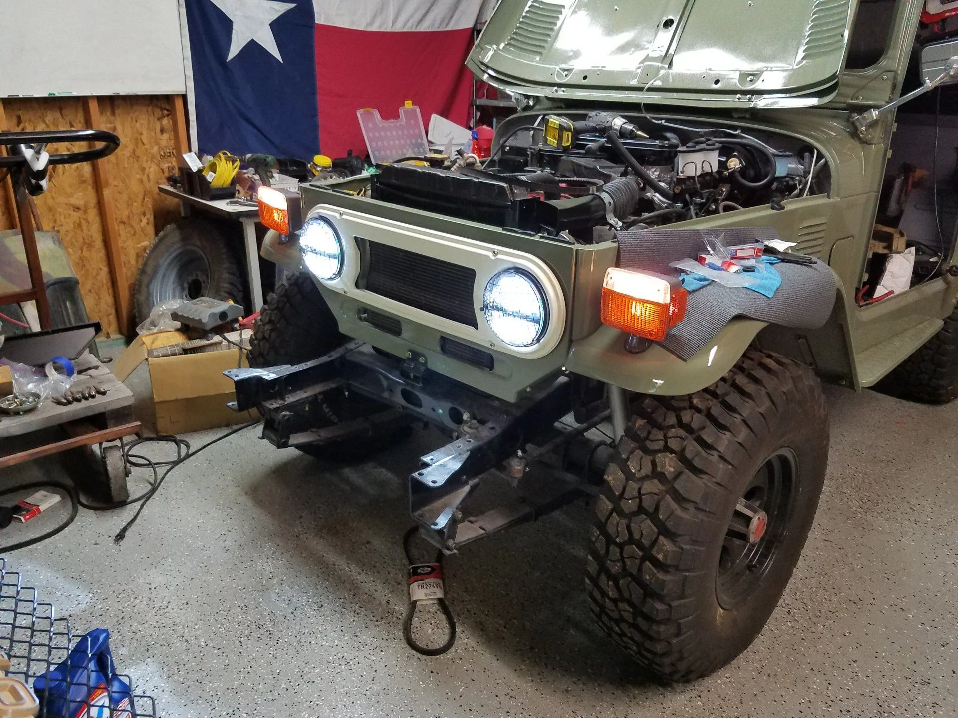

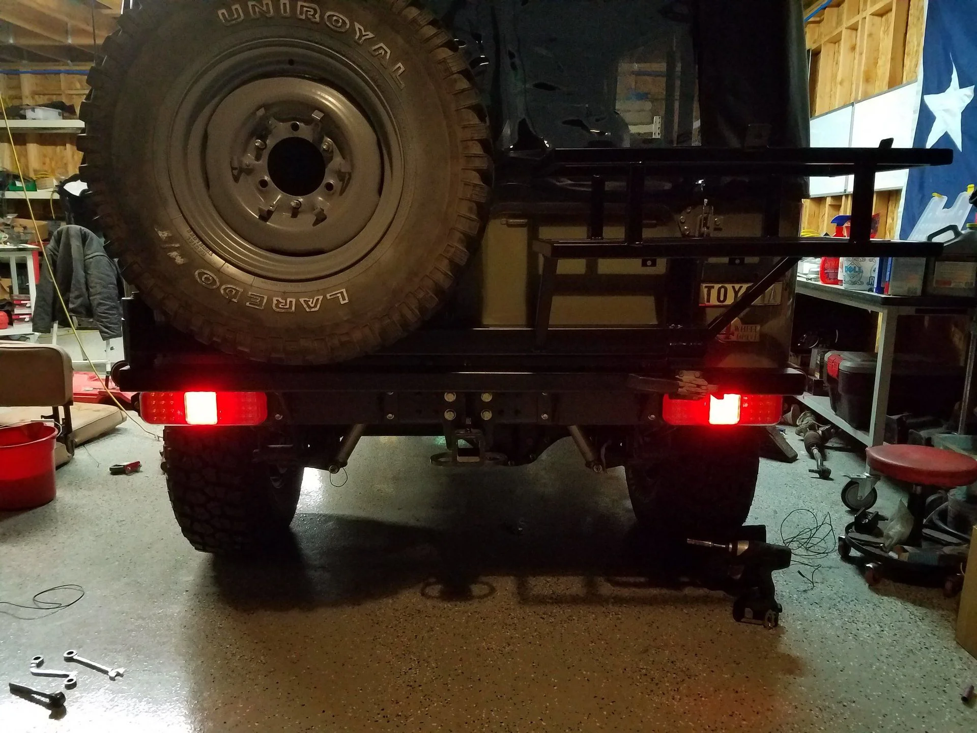

Continued to work on the electrics. Today I installed Narva LED rear lamps from Australia ( bought from @reevesci ). Pretty cool lights!

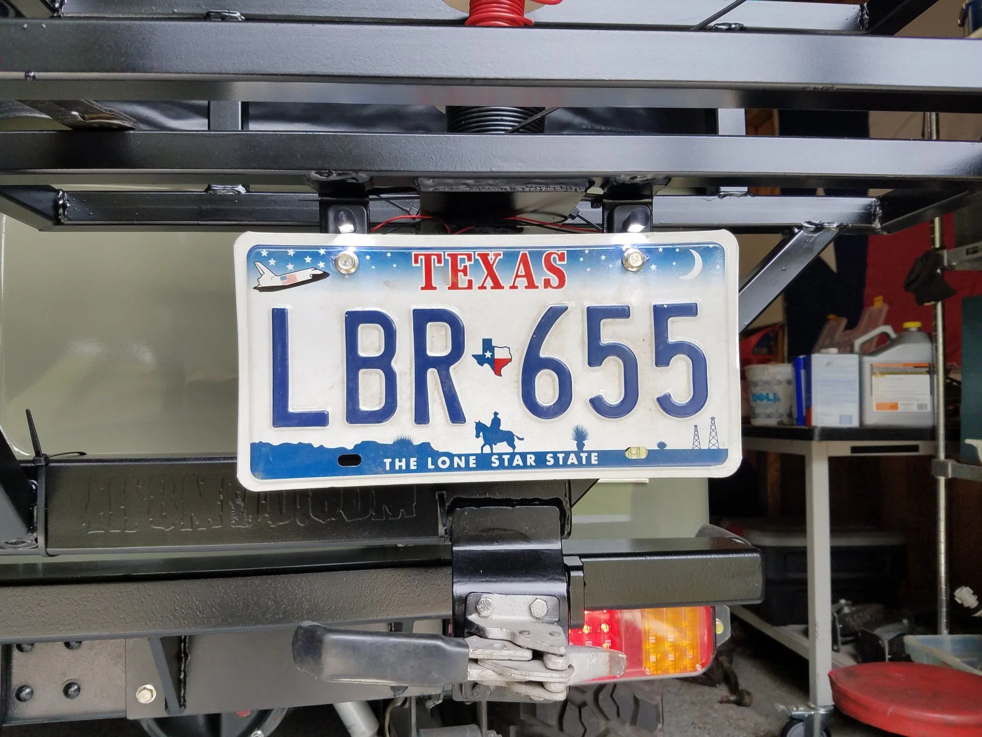

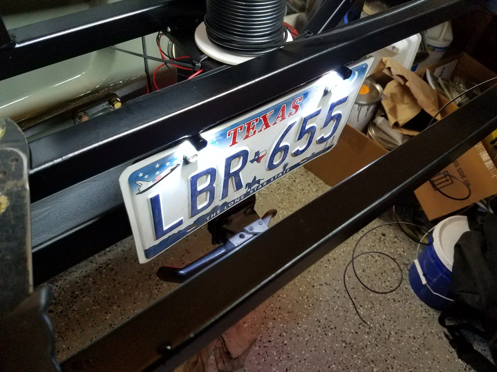

Started wiring up the license plate light. The LED bolts are pretty bright.

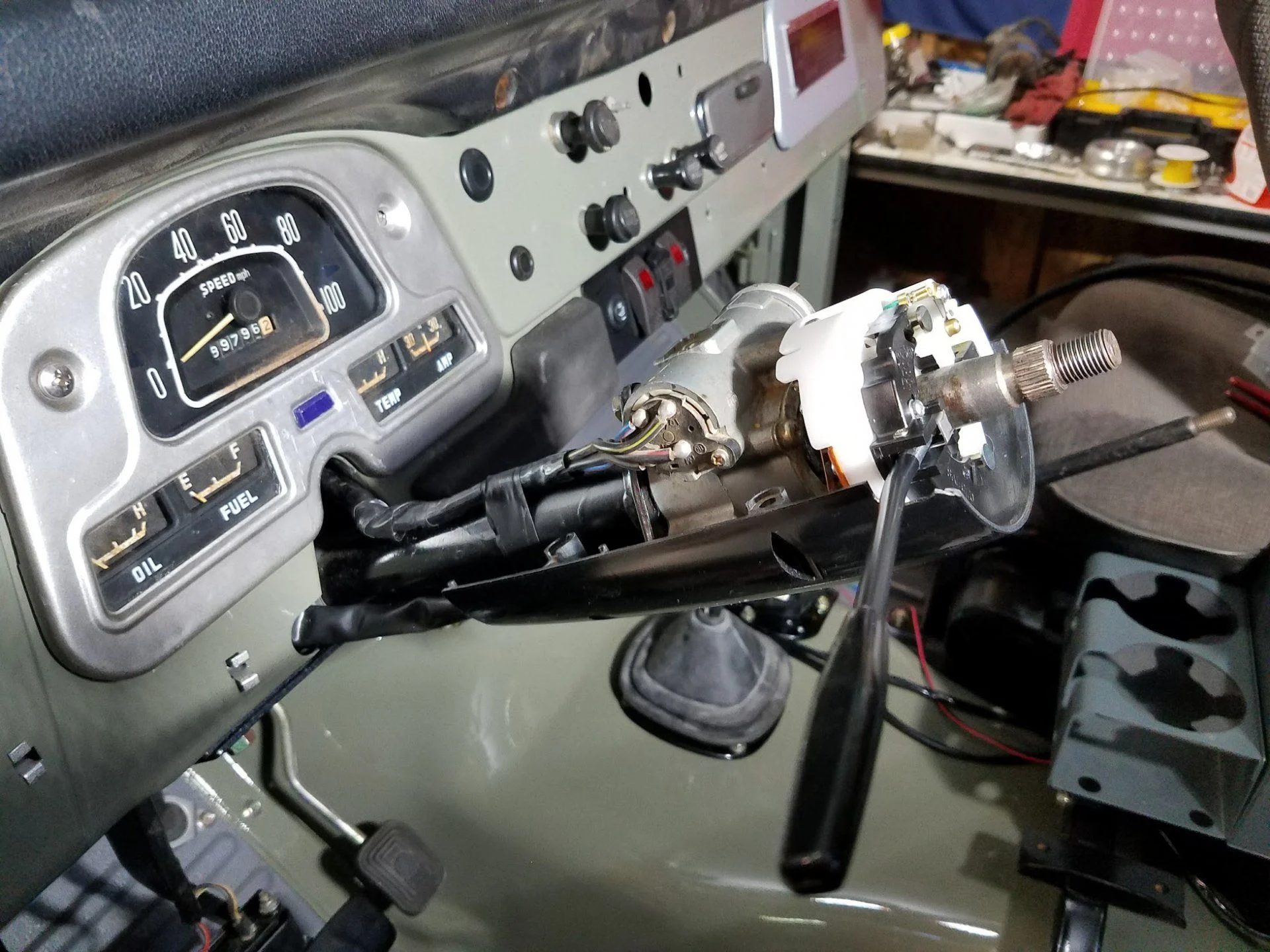

Got some more stuff installed/upgraded the last week or so. I was having some electrical issues with the turn signal switch and upgraded it with a new OEM Toyota assembly from Cruiser Corps. I can't believe how solid the turn signal switch feels.

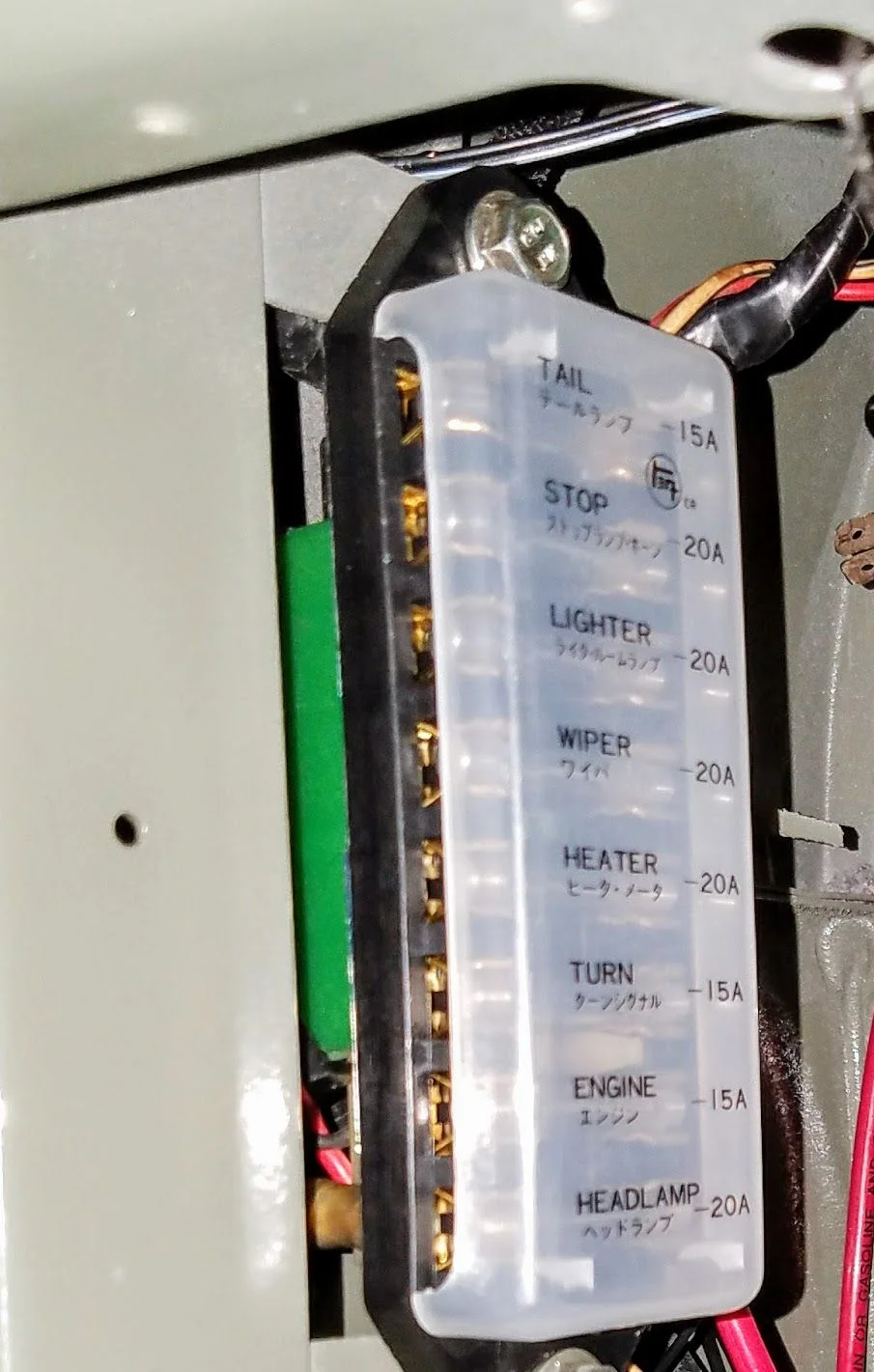

I also had a bunch of intermittent fuse issues where power would go out if I wiggled the fuse. I ended up buying a new fuse block and cover from @Racer65 . Really nice stuff!
