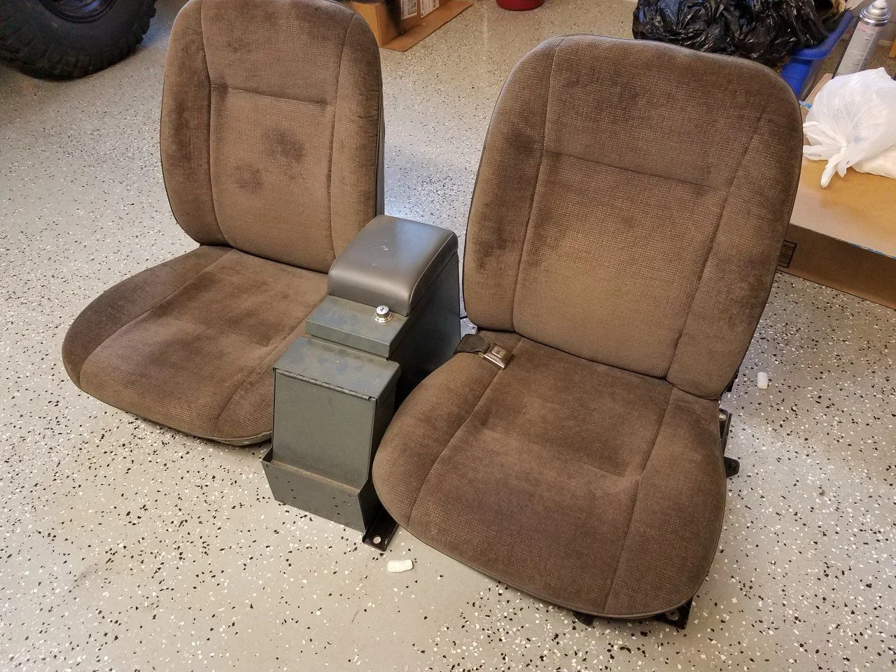

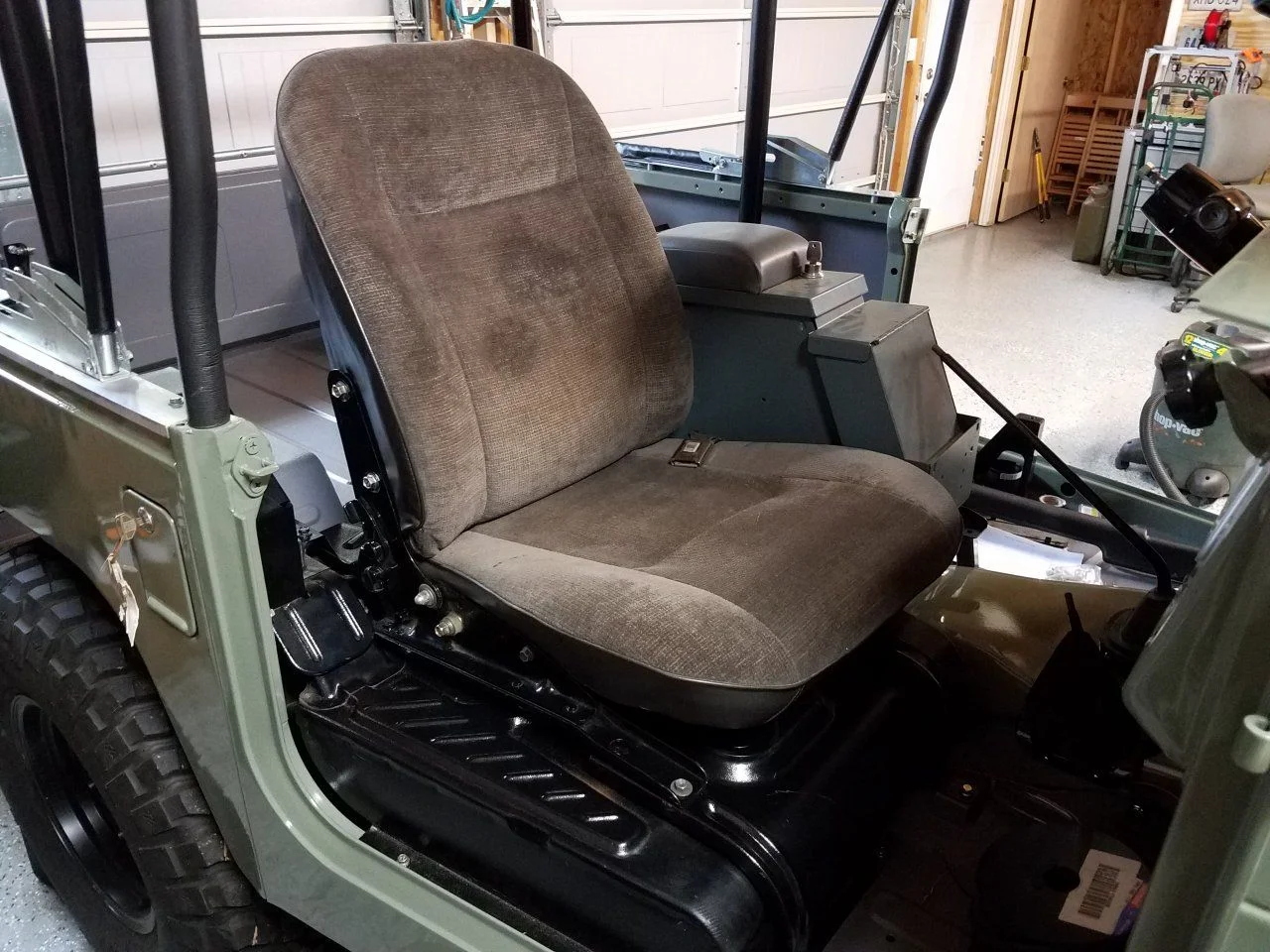

Finally got all of the damn fuel lines sorted out and installed. This allowed me to get the rest of the seat mounts installed as well as the Tuffy.

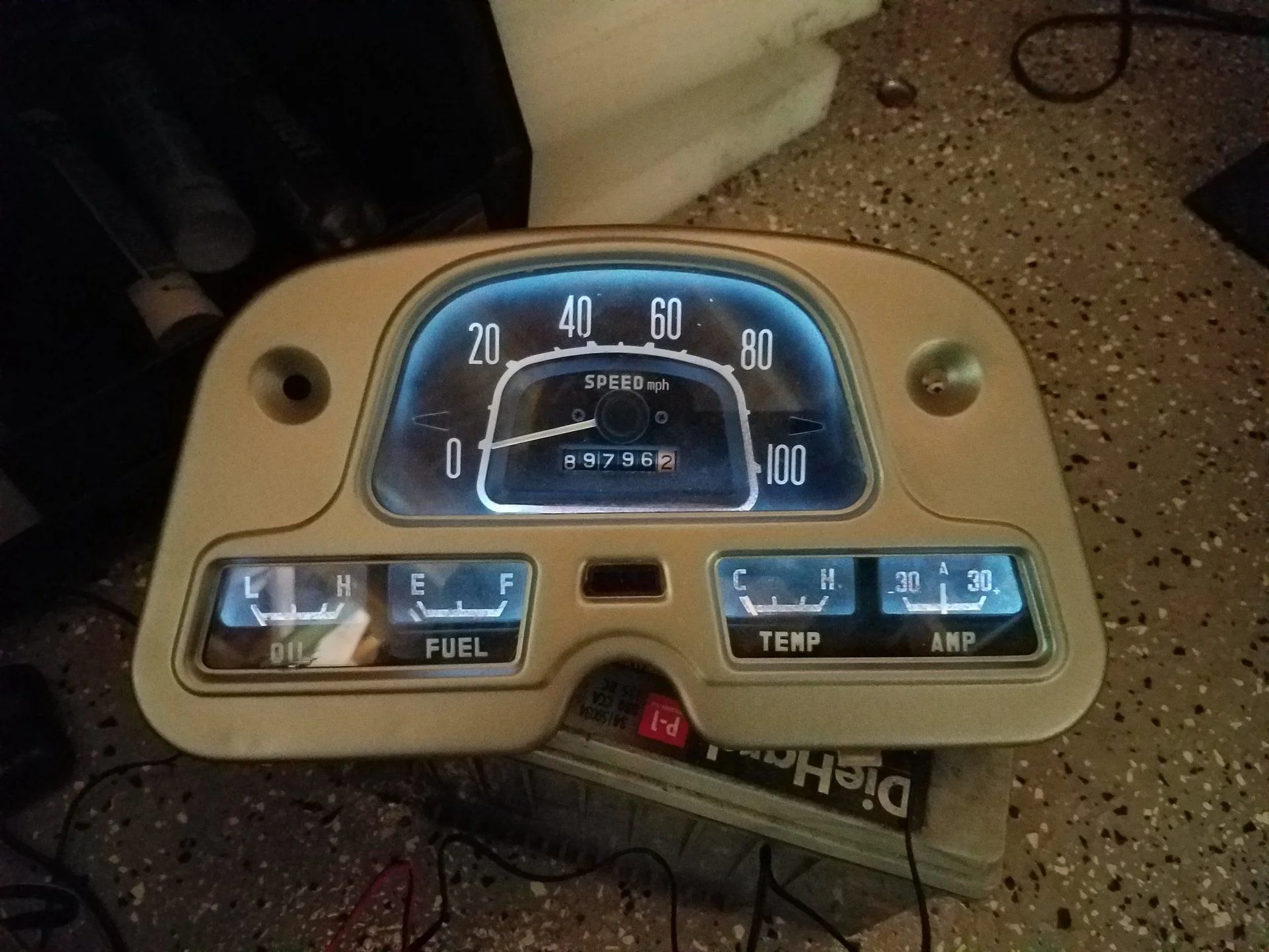

Just a quick update. I installed the EL light strip in the gauges. I got it cheap on eBay and the lighting is nice and even now.

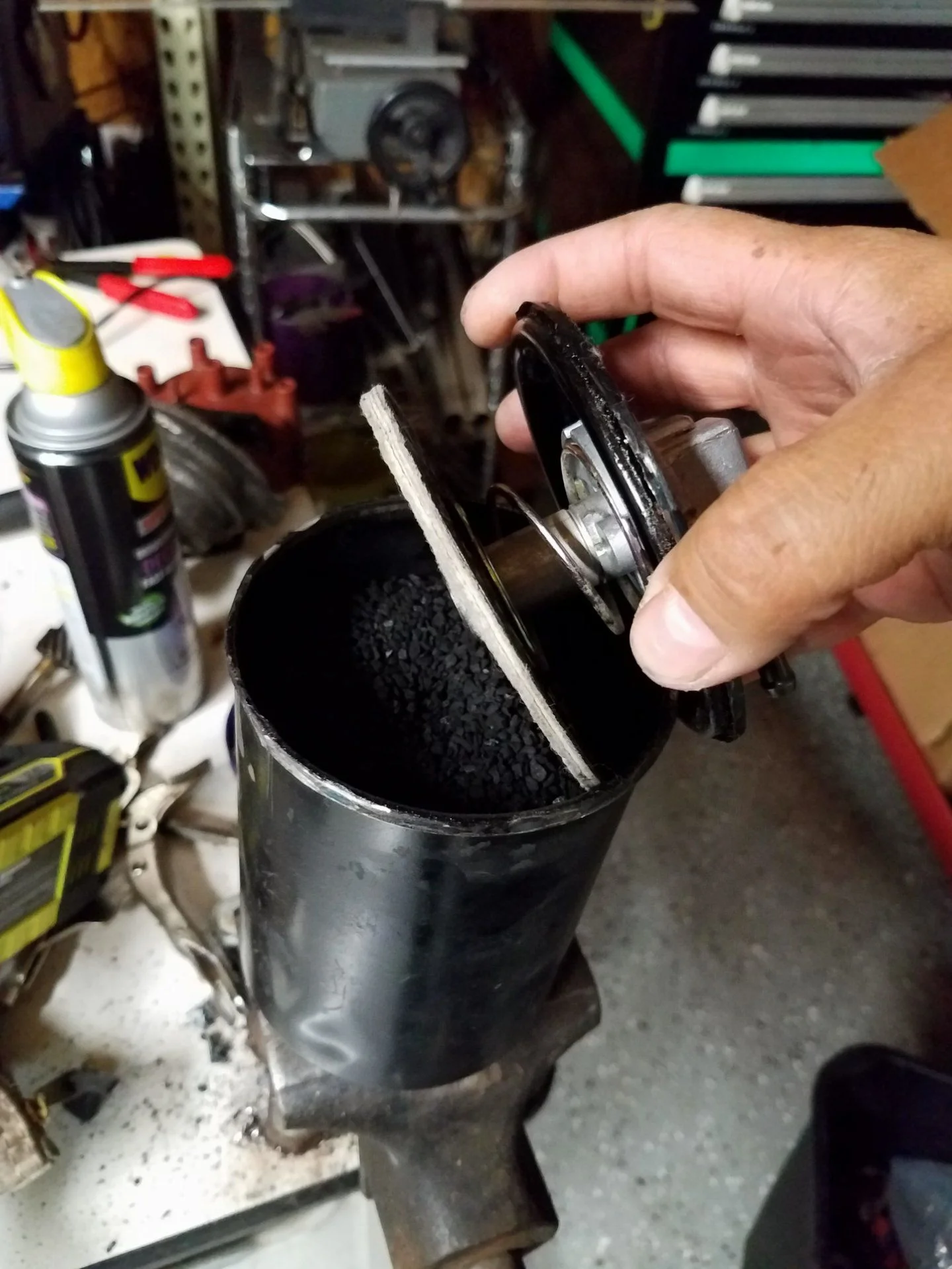

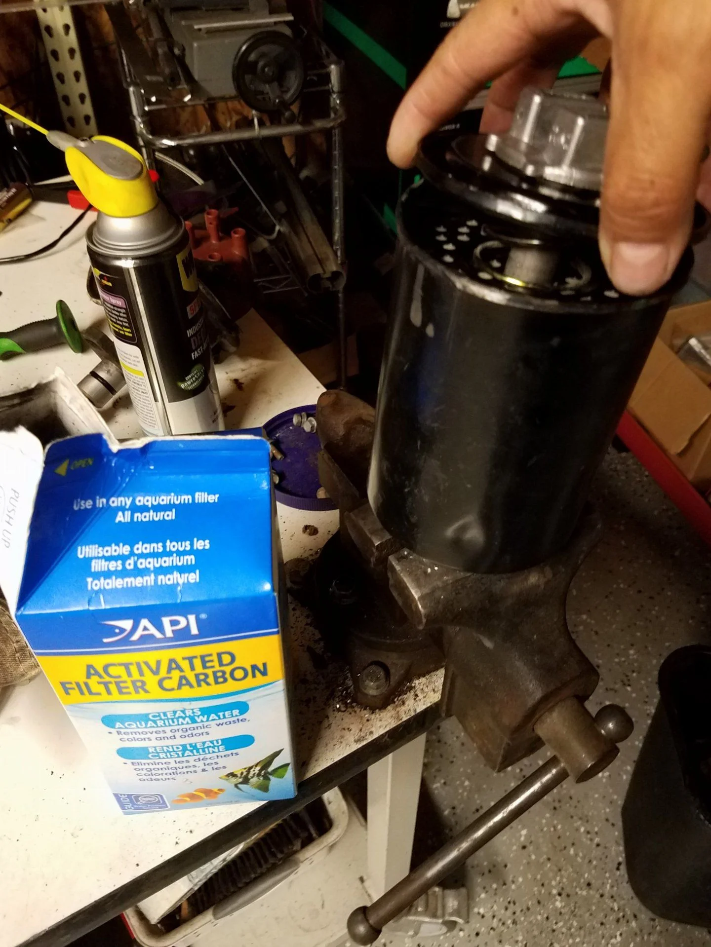

I also unclogged and refilled the charcoal canister with fresh activated charcoal from the pet store. All I need now is to figure out if I need an additional mounting bracket for it on my after market fenders. Anyone have a pic of the charcoal canister mount?
I hunted down a charcoal canister mount last month when swapping out fenders a previous owner had used sheet metal screws to mount it to the fender rather crudely. This is one from google i used to look for what I needed
I ended up getting one from wadster on here. He has a few more on his page I believe. I soaked the one I got in evaporust over night and it looked like new with a fresh coat of paint
