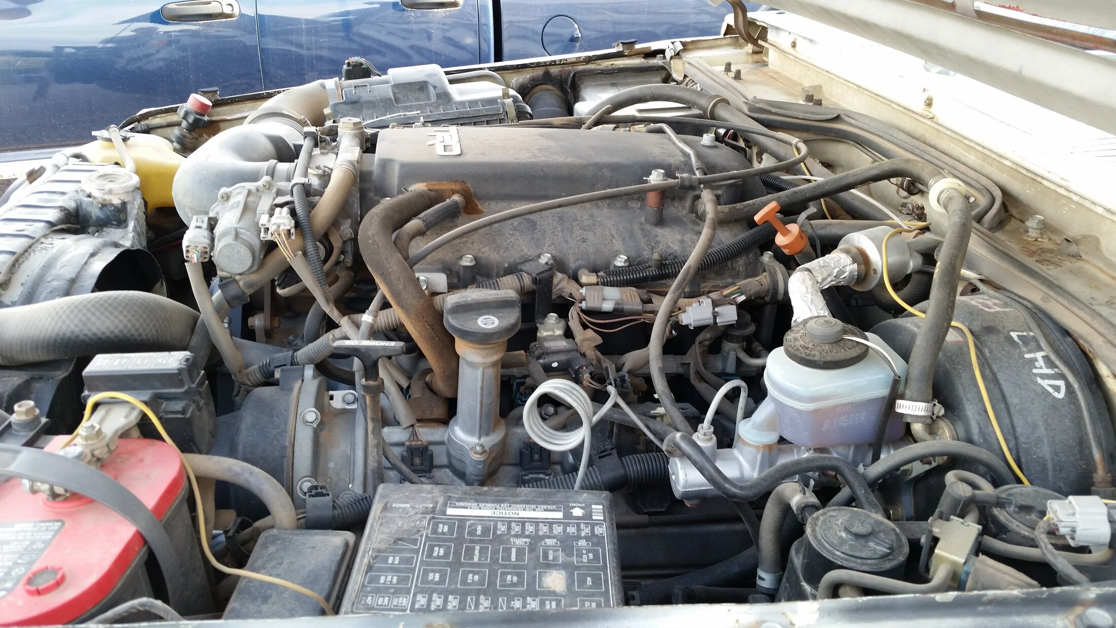

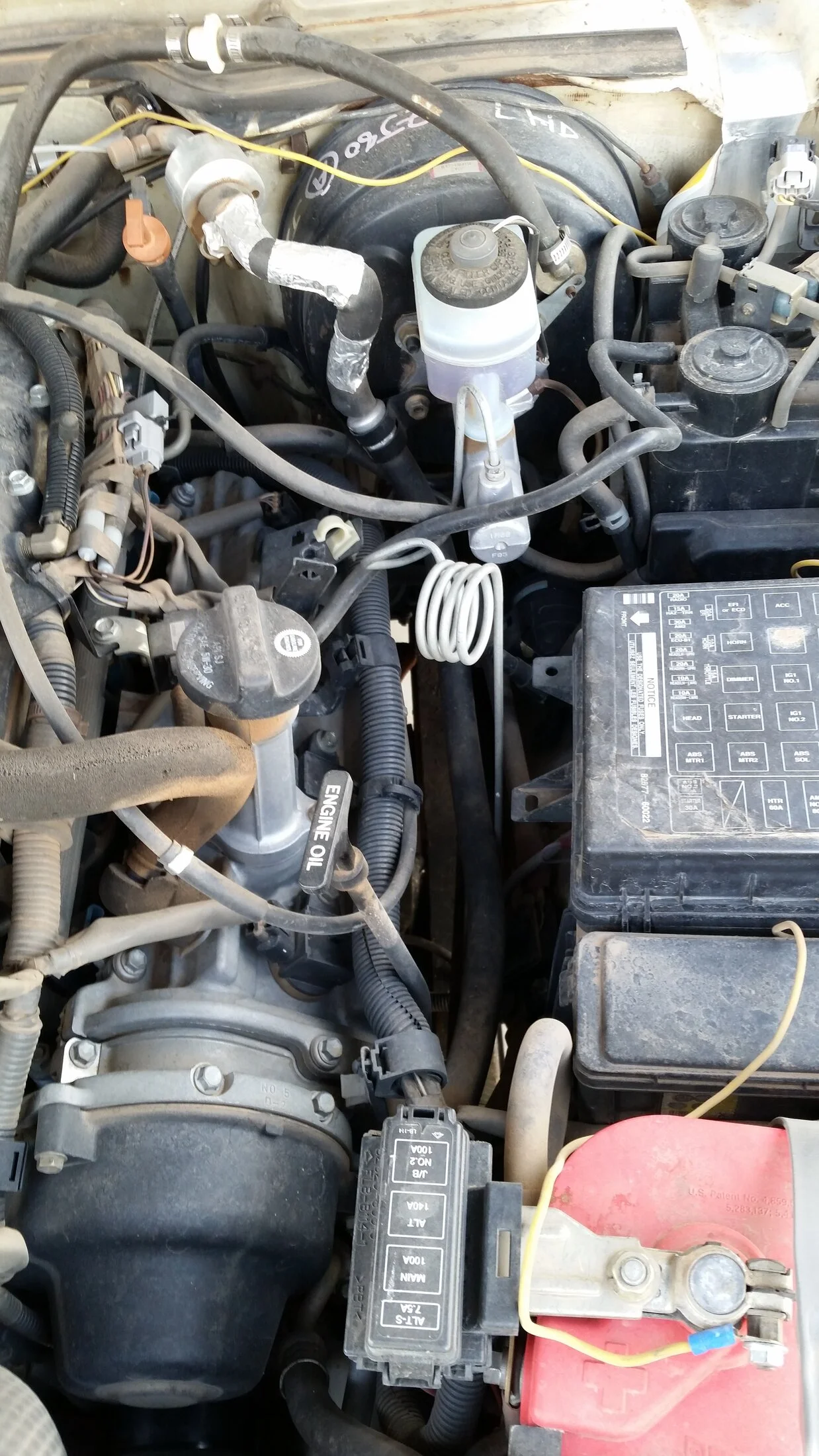

Thanks folks, 80 booster and master it is, plus spacer :)
Let us know how that works out. I will have to do this on my 60 when I go to 4wheel discs.
@PabloCruise i haven't, but I will likely just go ahead and replace both while I am in there. I haven't ordered it yet though, we had a postal strike here that screwed up shipping on a bunch of things, so I will get back on this after Christmas.
I have the non-abs 80 master waiting to go in, pretty sure I read it will fit stock booster?

We are just above freezing during the days here and I did manage get the 80 series (non-ABS) brake booster and master in, even on the property you can feel the difference, so, on a roll i thought, I got after the lights - I suspect a bad ground somewhere, because isn't it always?

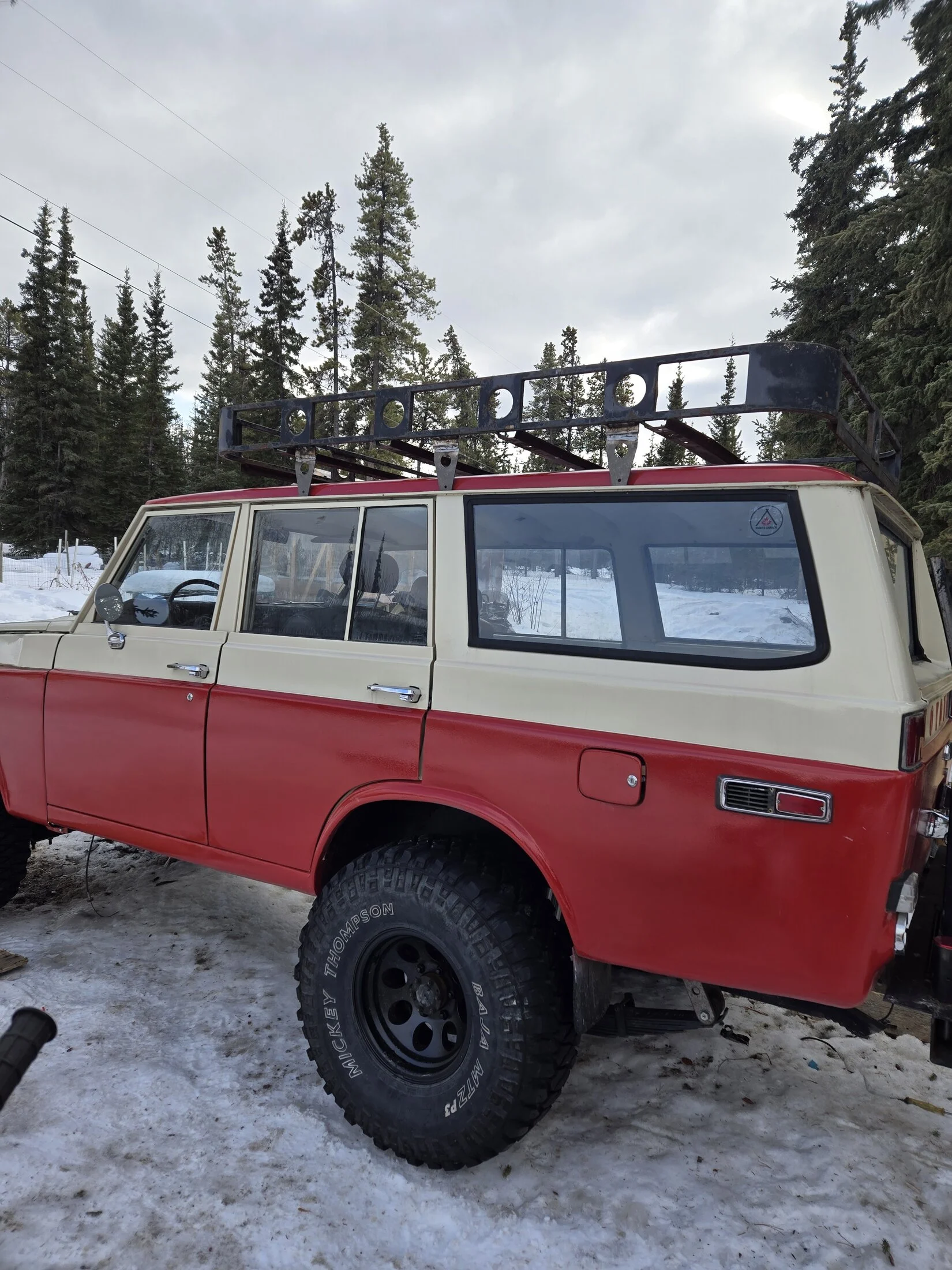

Sorted the electrical mostly, above the rear tire the blue/red for the reverse had fused with the green for the parking lights; seperately, when i put the new booster and master in, I hadn't sdjusted the swtich throw for the brake light switch - 4 hours of wasted time, but fixed. Just have the blinkers and dash switches for winch and eventual aux systems (light bar likely) left to sort and then the speedo connection. Also added some mounts to the con-fer rack, will get that cleaned up and then off to powder coat - think I will clean up the welds on the rear rack and sent that in at the same time.

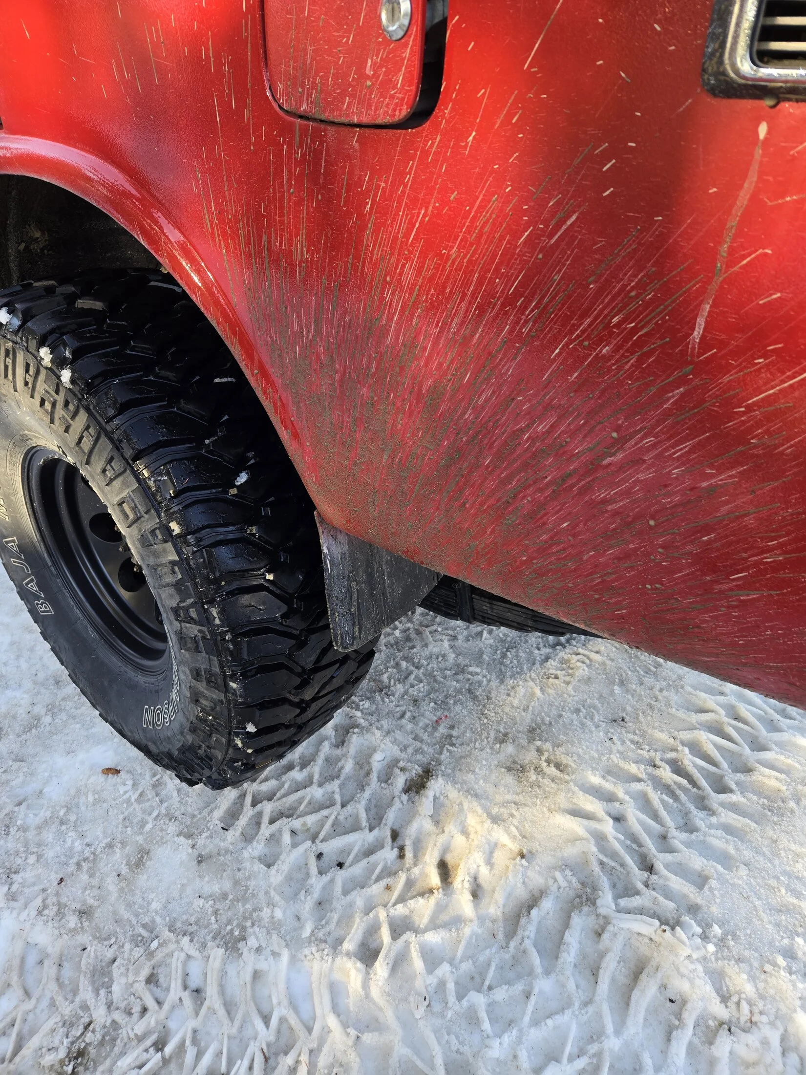

First Mud, first dent...

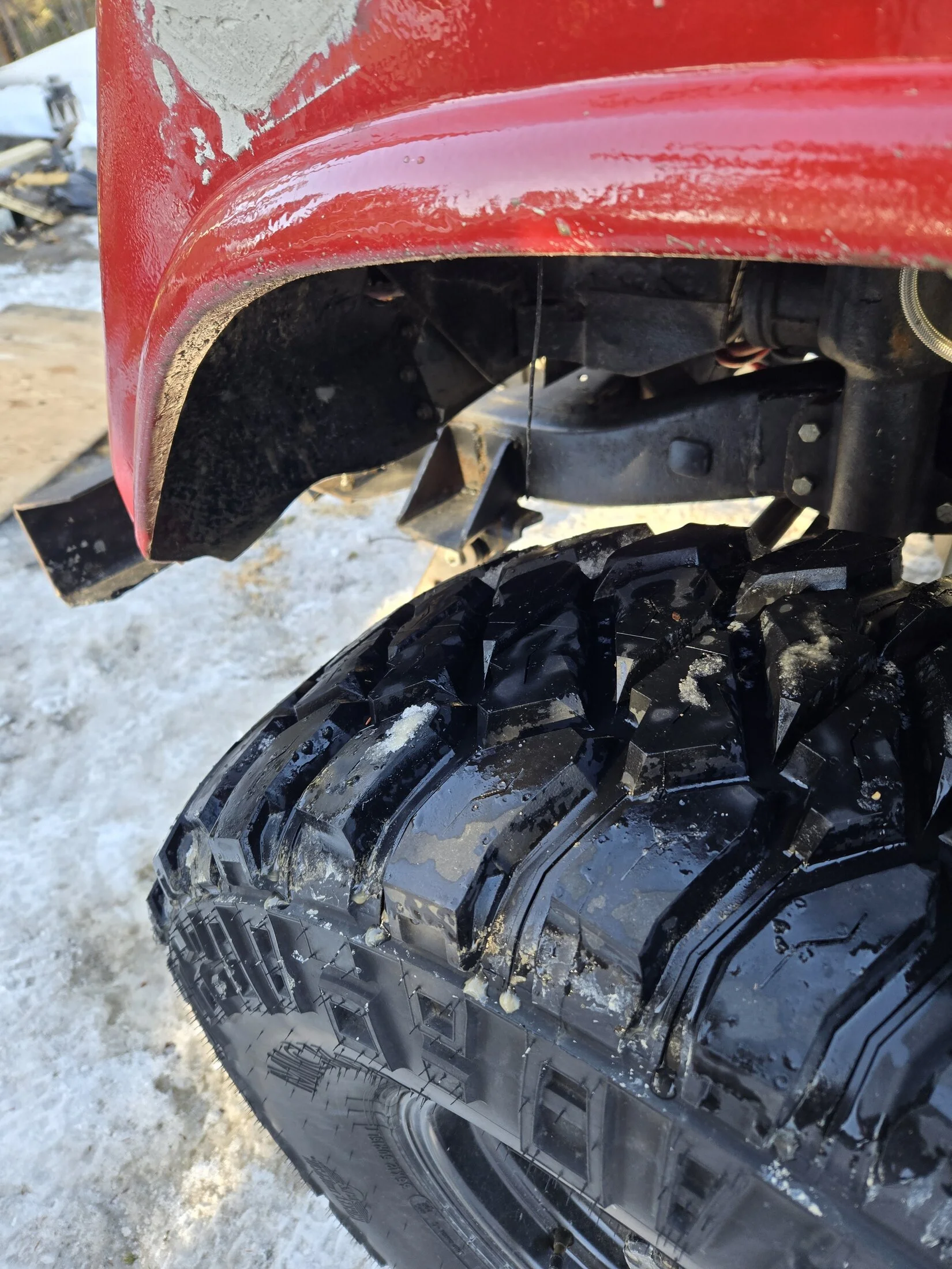

So, just drove it basically around the block here.. bunch of little things to now address, good news is she drives straight with hands off, engine sounds awesome, but some other noises to solve - bad news is the 35s on a flat dont clear the fenders at full turn, will be worse in anything technical... althougj the tires are moving the fenders out of the way, i should probably cut, change to smaller tires or do a shackle reversal... hmmm, i really like the 35s...
