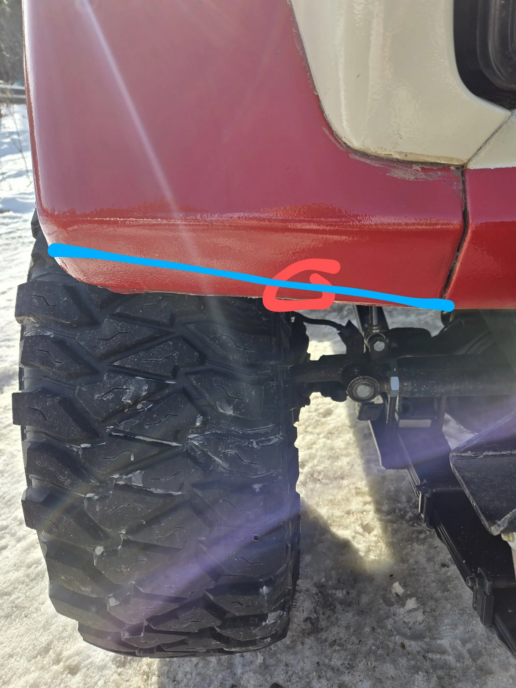

@RUSH55 unfortunately, that rub was only on a slight angle, I will need something other than bump stops to wheel it. I really don't want to limit my turning or range radius either. I have to do some body work anyway, so I will look at what I can do there - I think a straight cut will be prone to rust as will a roll as you say, ideally I raise the edge and then re-flap it like the original, just an inch higher.
Here is a question for you all though, what happens when the springs are mounted backwards? putting the mil wrap forward will buy me almost an inch I think (they are J70 springs and the pin is forward of centre) - not taking this option too seriously, but maybe...
Hmm, I think @J Mack or somebody else has trimmed fenders there, can’t recall how he did it?
Yes trimmed that little flap out and rolled the edge back, 35"-12.5"-15" tire on a 15"-8"-3.5" back space rim. I wheeled that combo reasonably hard without issue.

So the contact point is the red area

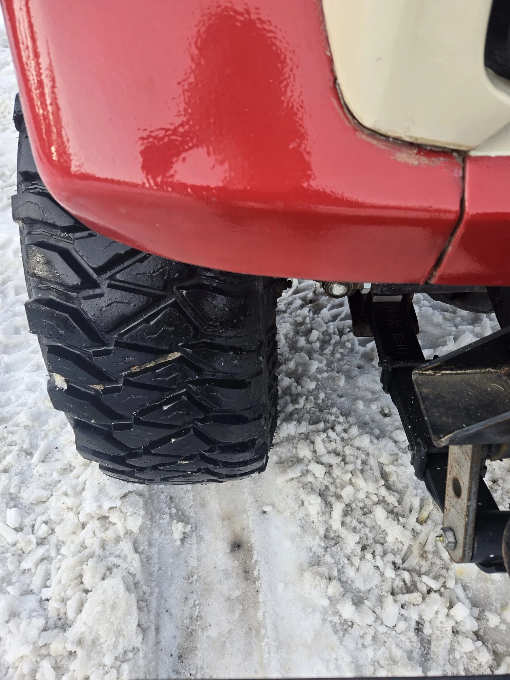

I only cut the inner flap-lip-chunk of sheet metal whatever you want to call it then folded it up. Once that's done just grab the outer edge of the fender with a gloved had and pull it outward, it will move a surprising amount.
Well, i trimmed the flap, It moved a surprising amount.and now clears. I will roll the edge a bit and paint to seal when I get back from this trip.
