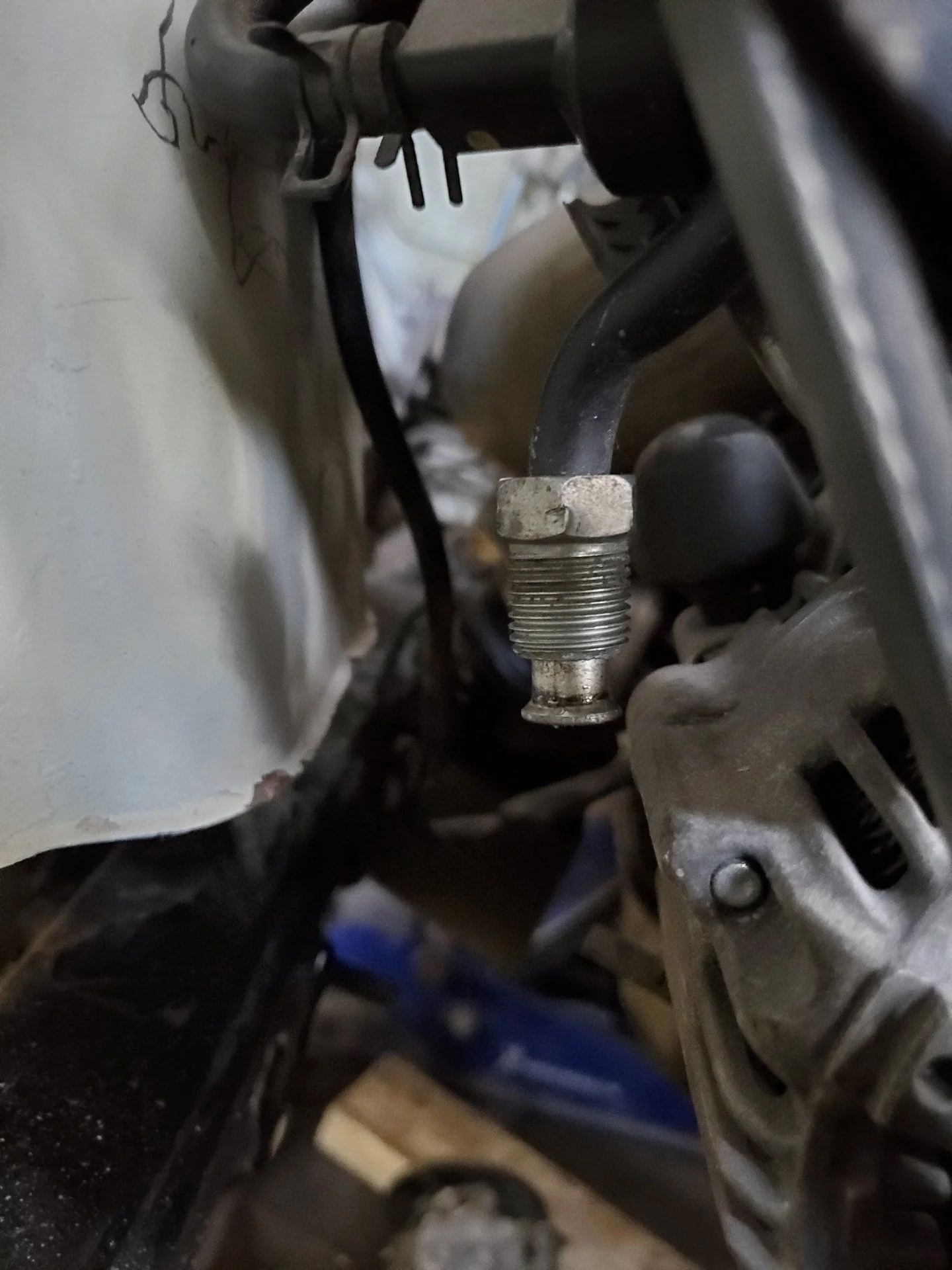

Now, a question, in the last pic I have the PS pump end of the pressure line. My local hydraulic shop says that they don't have anything that will match the flare fitting, maybe I can replace the bajo fitting? @TachedOutOffRoad, did you have any problems here? I am thinking maybe a speed shop might be able to help.
They didn't seem to have a problem at the scout end, it was the metric end they stalled on..
One of the racing shops seems to think that if they can match the thread, we can remove the banjo at the pump and replace with an adapter to AN-6 and then run a teflon hose to an adapter on the other side... we'll see
He didn't volunteer that as an option
He's an idiot let’s just do this ourselves.
I’m guessing that’s about a 16mm fitting. JEGS 110544: AN to Metric Adapter Fitting [-6 AN Male to 16 mm x 1.50 Male] | JEGS - https://www.jegs.com/i/JEGS/555/110544/10002/-1
But you’ll need to measure the OD of your old nut to confirm.
The box is easy. JEGS 100701: Power Steering Adapter Fitting -6 AN x 5/8 in.-18 Inverted Flare | JEGS - https://www.jegs.com/i/JEGS/555/100701/10002/-1
You’ll need a couple hose ends. JEGS 104022: PTFE-Lined Hose End Fitting [90 degree, -6 AN] | JEGS - https://www.jegs.com/i/JEGS/555/104022/10002/-1
And a chunk of hose and you’re done.

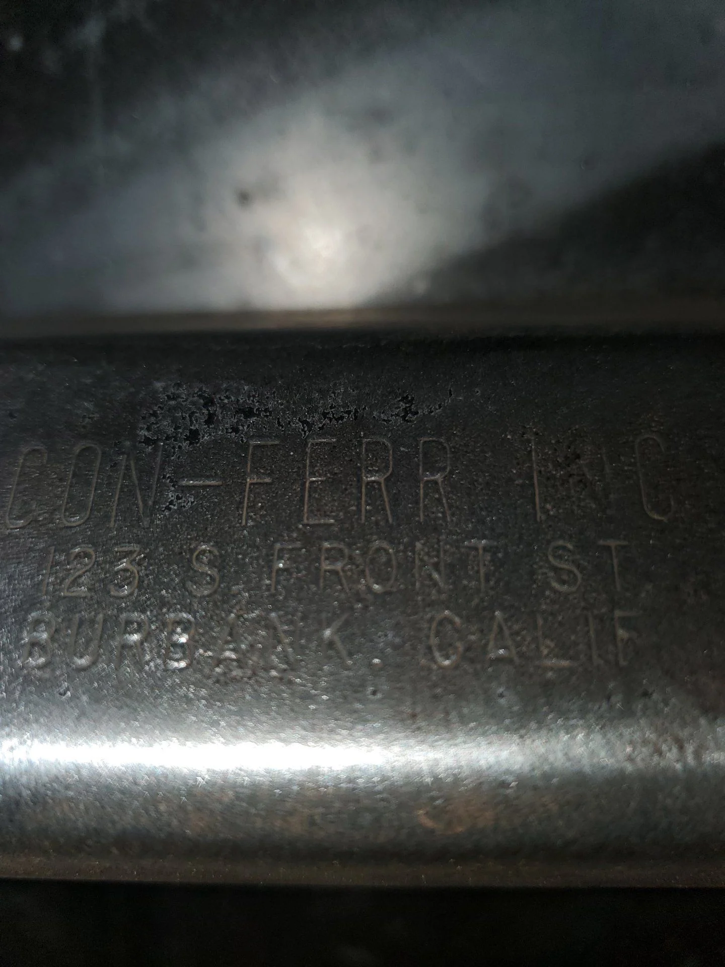

This past summer someone was selling fj55 front clip and bumper and such - In the end it was worse than mine was so resold it, but kept the grill and bumper...I think after the resale I am in to it for $100. I straightened the bumper this past summer and was just wire wheeling it at lunch and it turns out it's an old Con-Ferr, cool eh?View attachment 2573358View attachment 2573359
Score! Send it out for media blast then powder coat!
@PabloCruise I am more of a wire wheel and rustoleum guy - that way I can touch up or change things with no fuss

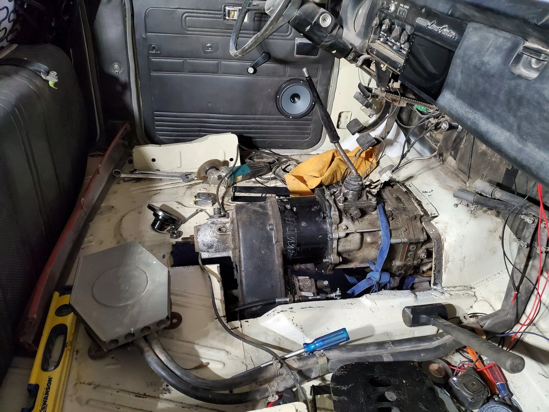

Been frigging around with the transmission tunnel this weekend, what a PITA to fit. Doesn't help that because the dana is high, I have to cut further back for the DS, more on the "mod" side than I had hoped, but in it now - kinda looking like a limpet.
Much more to do though, have to move the sticks back a bit so they don't hit the vents, behind them will go levers for the cable lockers and then a whole bunch of banging to get the floor seam to line up - and probably a bump under the seat to accommodate the DS flange. Bench seat still clears though.
Oh, and my ever supportive wife walked by and said: "you're going to cover that with something right???" clearly she was impressed :)
