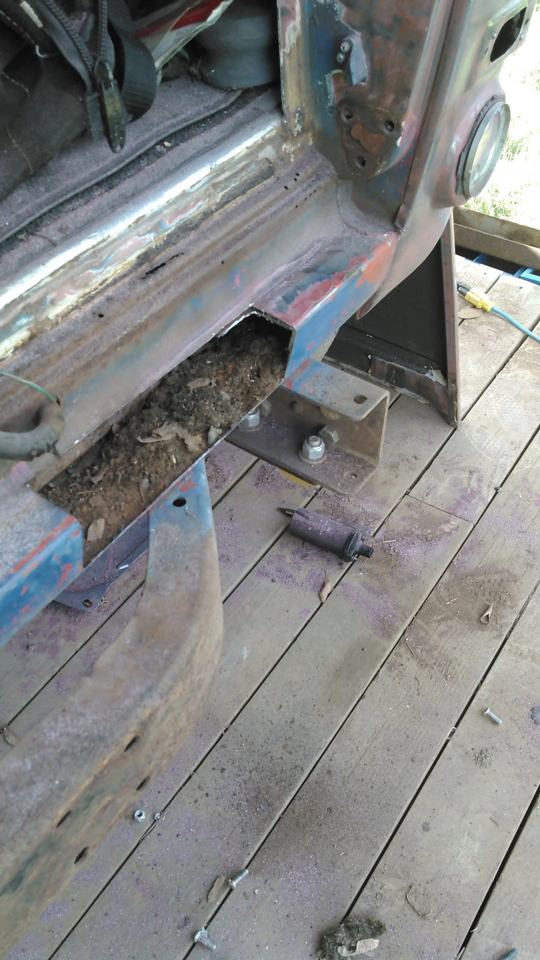

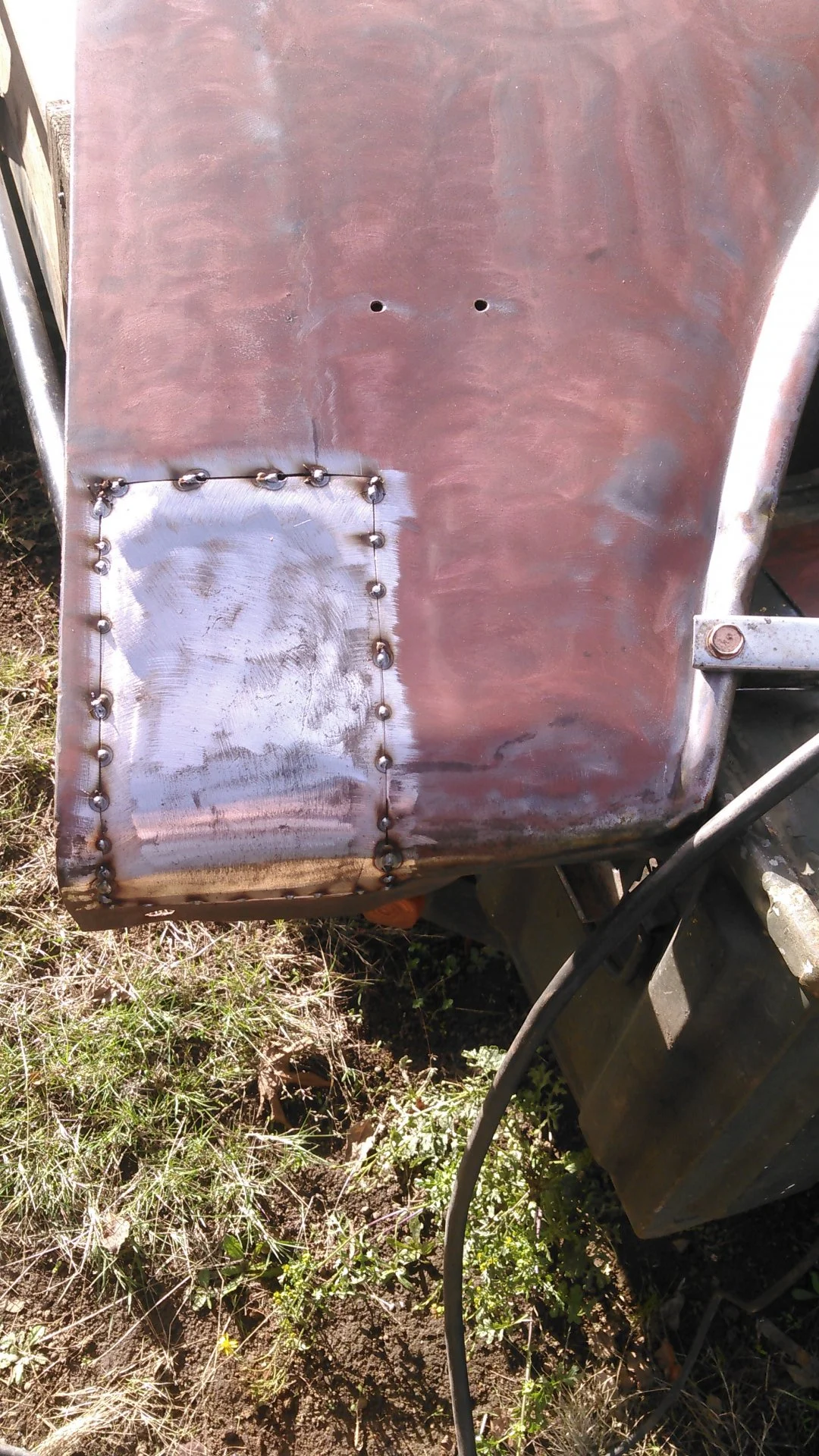

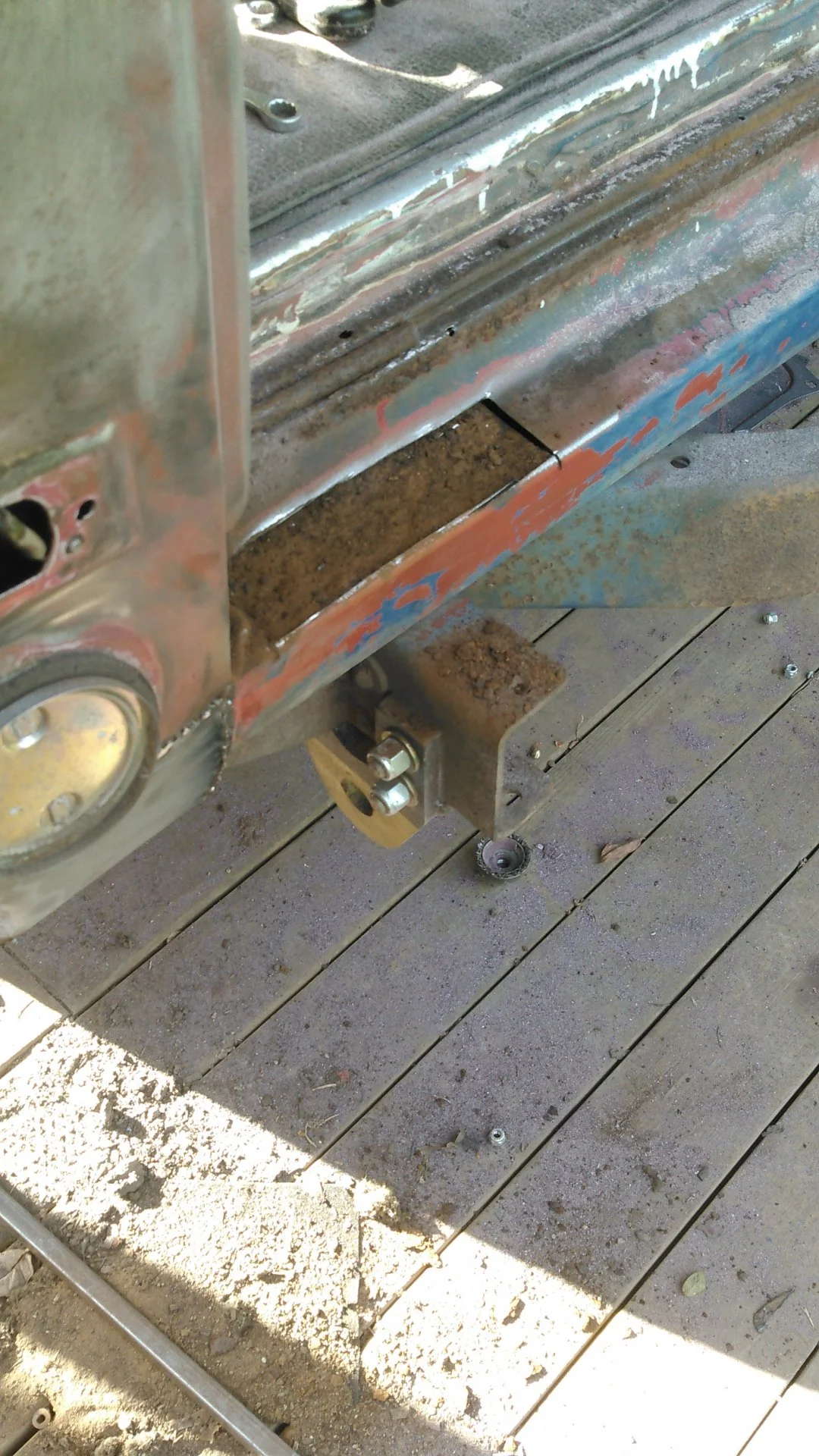

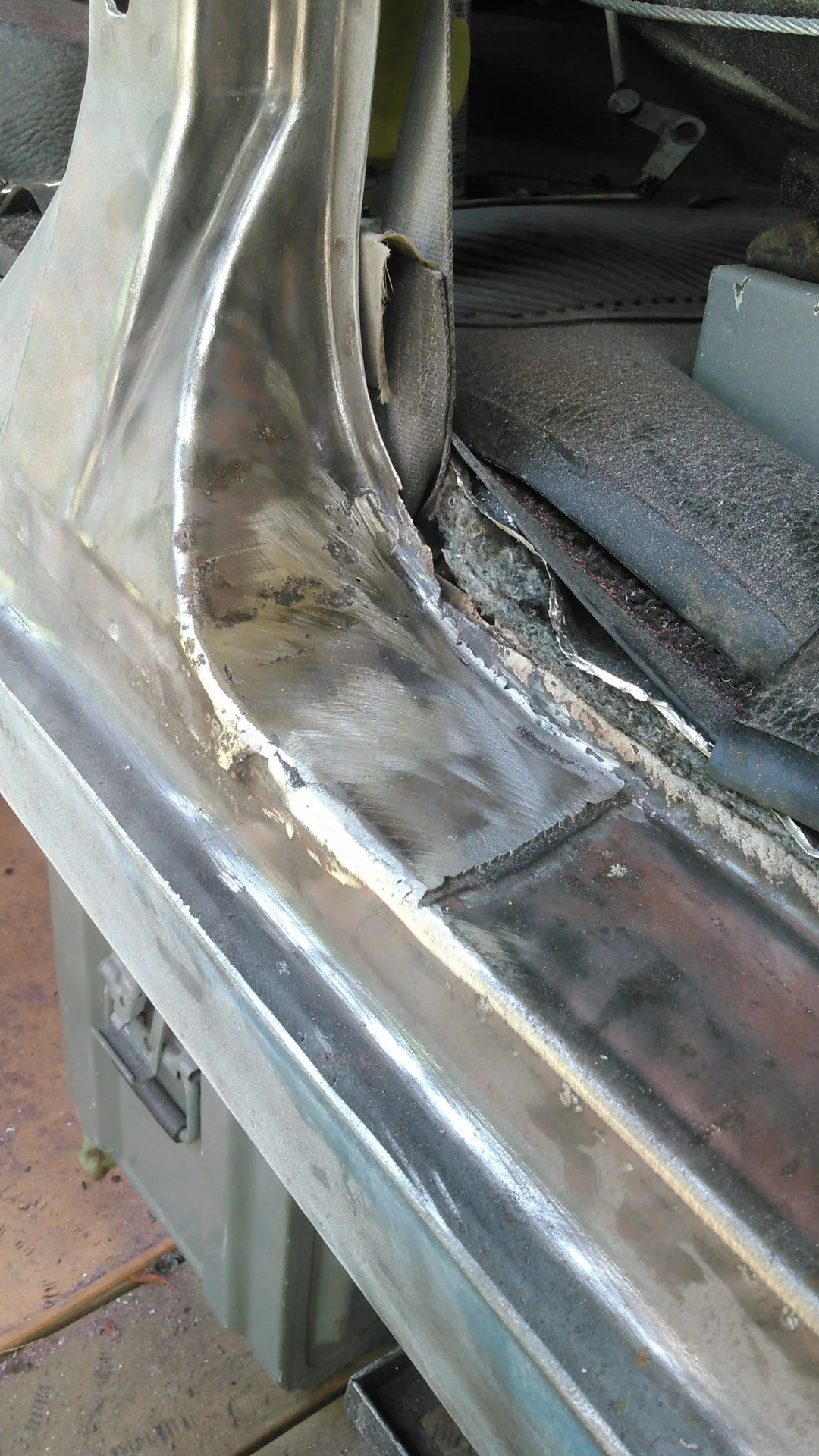

I've been getting rid of the rust and treating the body cavities as I go. Hopefully I'll have this thing ready for paint by next weekend. Once painted I am going to completely go through and treat the body cavities with a product called Waxoyl Power Shield.

yeah, I've been treating areas as I find and expose with POR-15. But after I paint the vehicle I do plan to thoroughly go through the cavities (the areas that i cant reach or expose) and hit them with Waxoyl to stop any hidden surface rust that I can't access.
My plan to use Waxoyl after paint is to eliminate and over spray that may contaminate any surface that is soon to be painted. Essentially less cleanup and eliminate any potential future paint failure.
I'm not sure if this is the most professional approach but it makes sense to me. Does anyone know of a better way? This is my go at a project of this caliber. Thanks

I think you should treat the rusty areas with a rust converter first. POR-15's Metal Prep that they say to use before applying the POR-15 is a rust converter so if you are using that then that's probably good enough. Just my 2 cents.
Yes, I agree 100%. I believe that a lot of folks do just apply POR-15 directly over rust and call it good. I've been using POR-15 metal prep or Naval Jelly. Both contain the acid required to convert rust.
