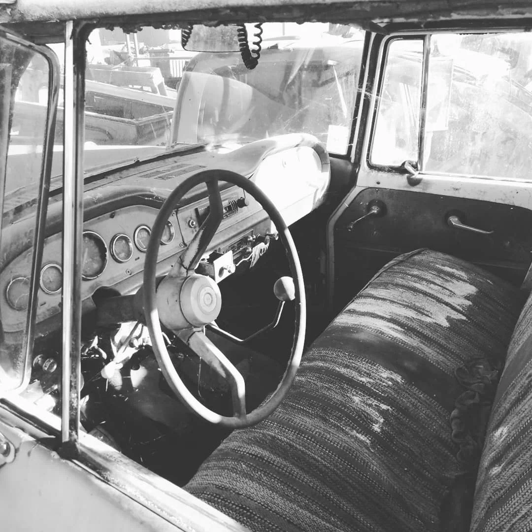

I've always liked going to the wrecking yard. Even if it's just to see what's been laying around.

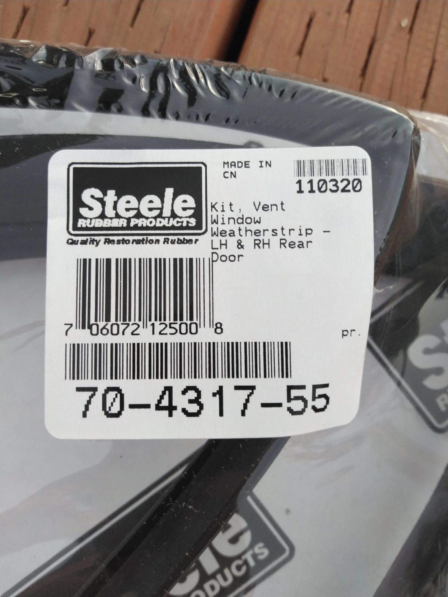

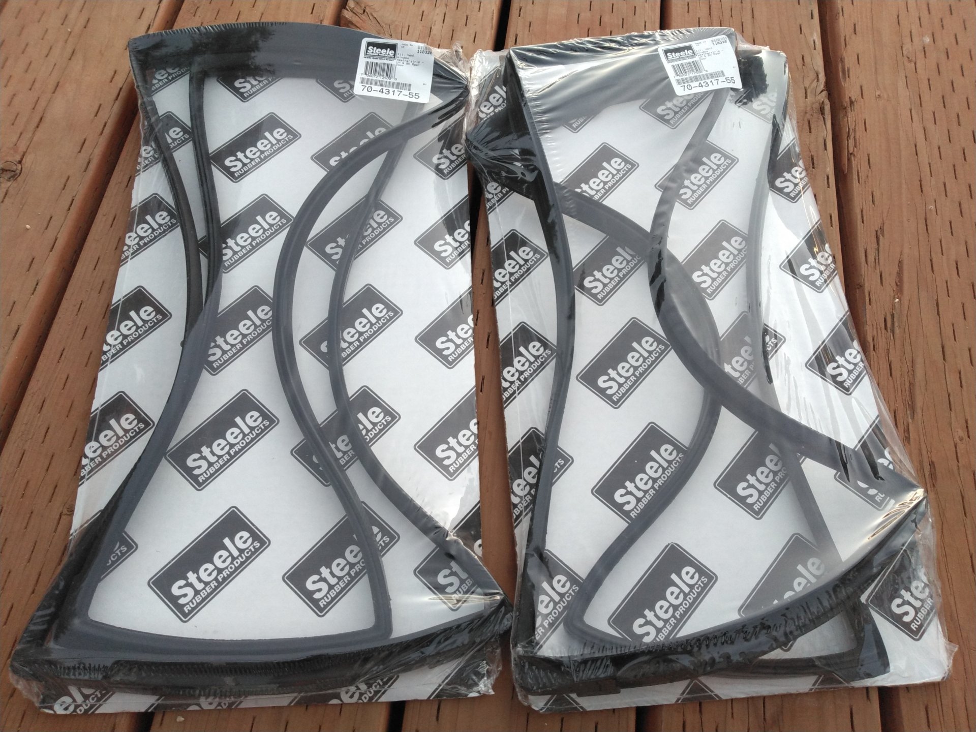

That said, I did end up purchasing two pairs from Steele Rubber and will be piecing them together when they arrive.
Steele Rubber Products - 1981-1990 Toyota J60 Land Cruiser Rear Door Vent Window Weatherstrips | Steele Rubber Products
Received my rear door fixed window seals today. Picking up some 3M adhesive tomorrow.
A little bit of work, sure. But delivery was fast and I saved myself $150 by going this route.
View attachment 2785748View attachment 2785749
Well, I decided to return my seals from Steele Rubber and spend the extra cash for the correct fitting seals from Slocruiser. Nothing wrong with piecing together the seals from Steele Rubber it's just that I got a lot going on with this project at the moment and figured I'd rather just put the proper seals in.
John contacted me the other day and informed me that he had a pair back in stock so I went for it! even though proper fitting seals comes at a price, I'm happy that I received them today!

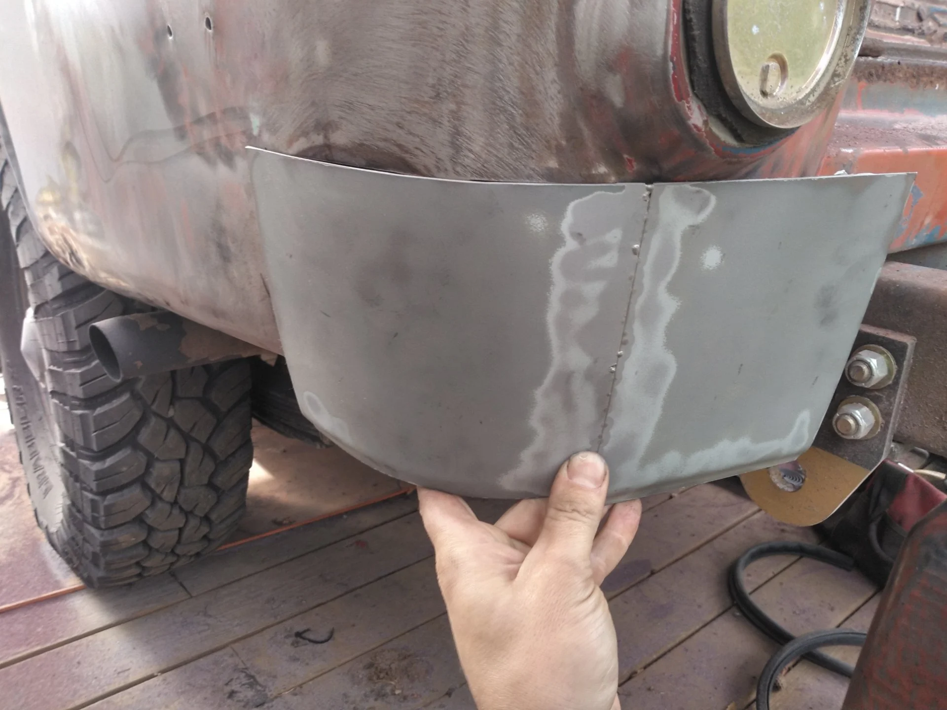

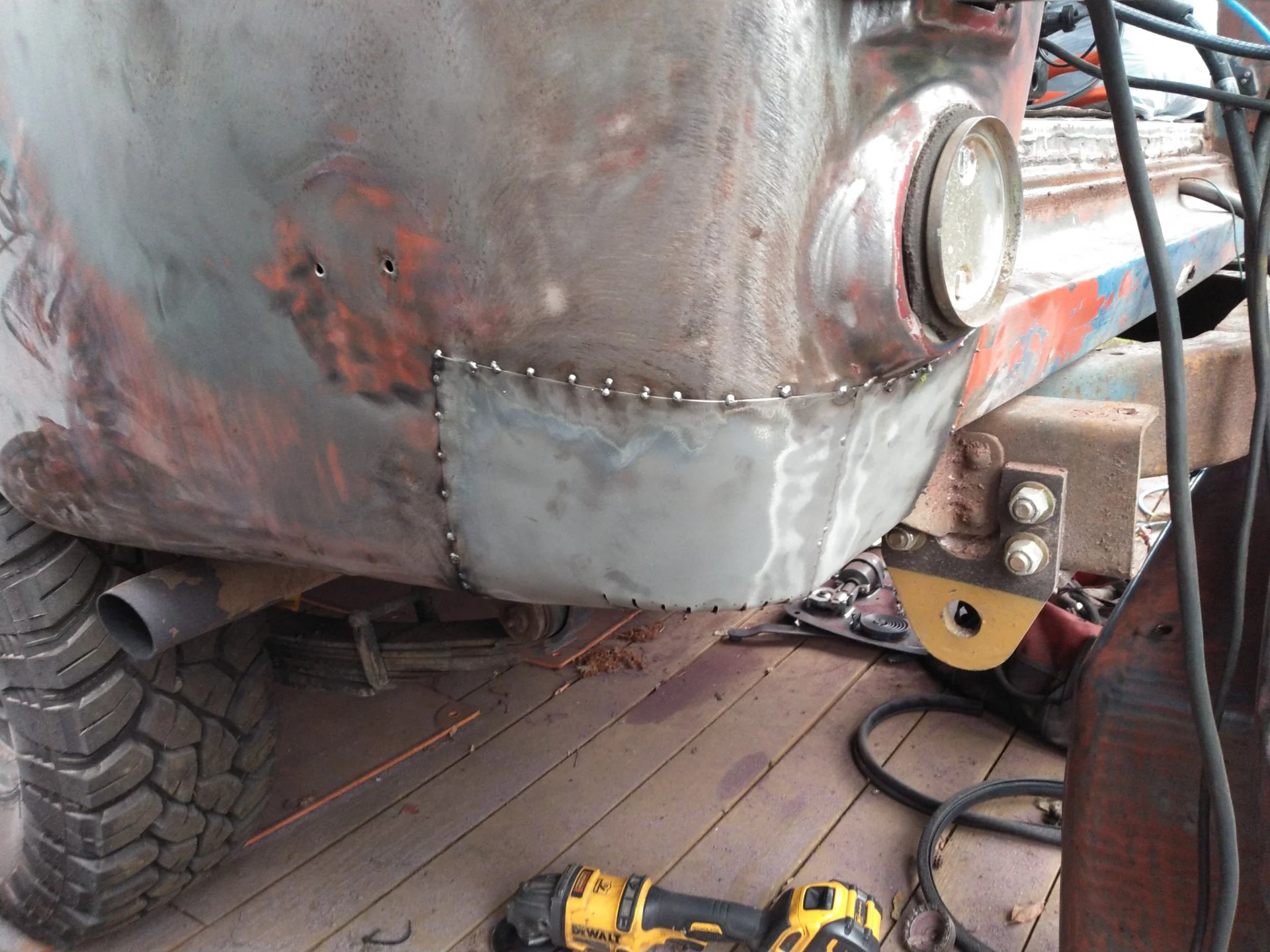

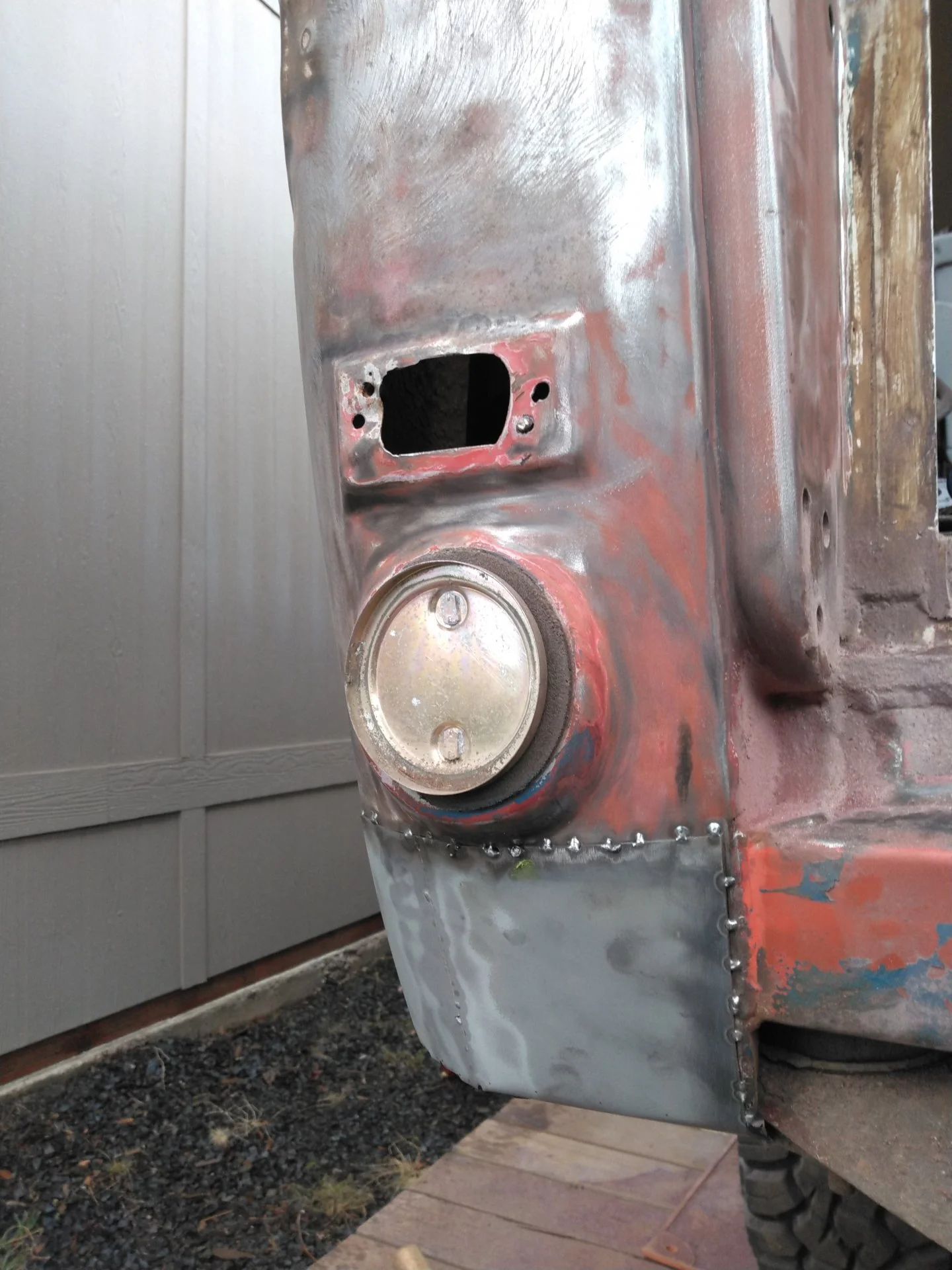

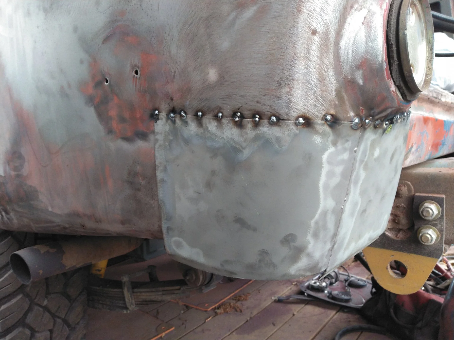

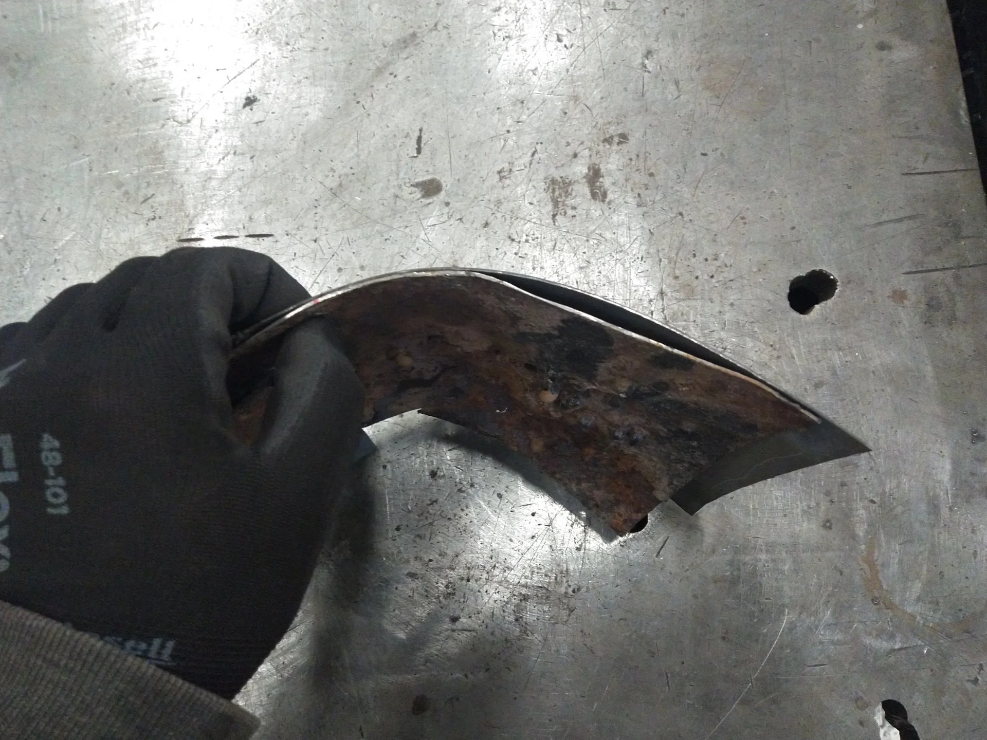

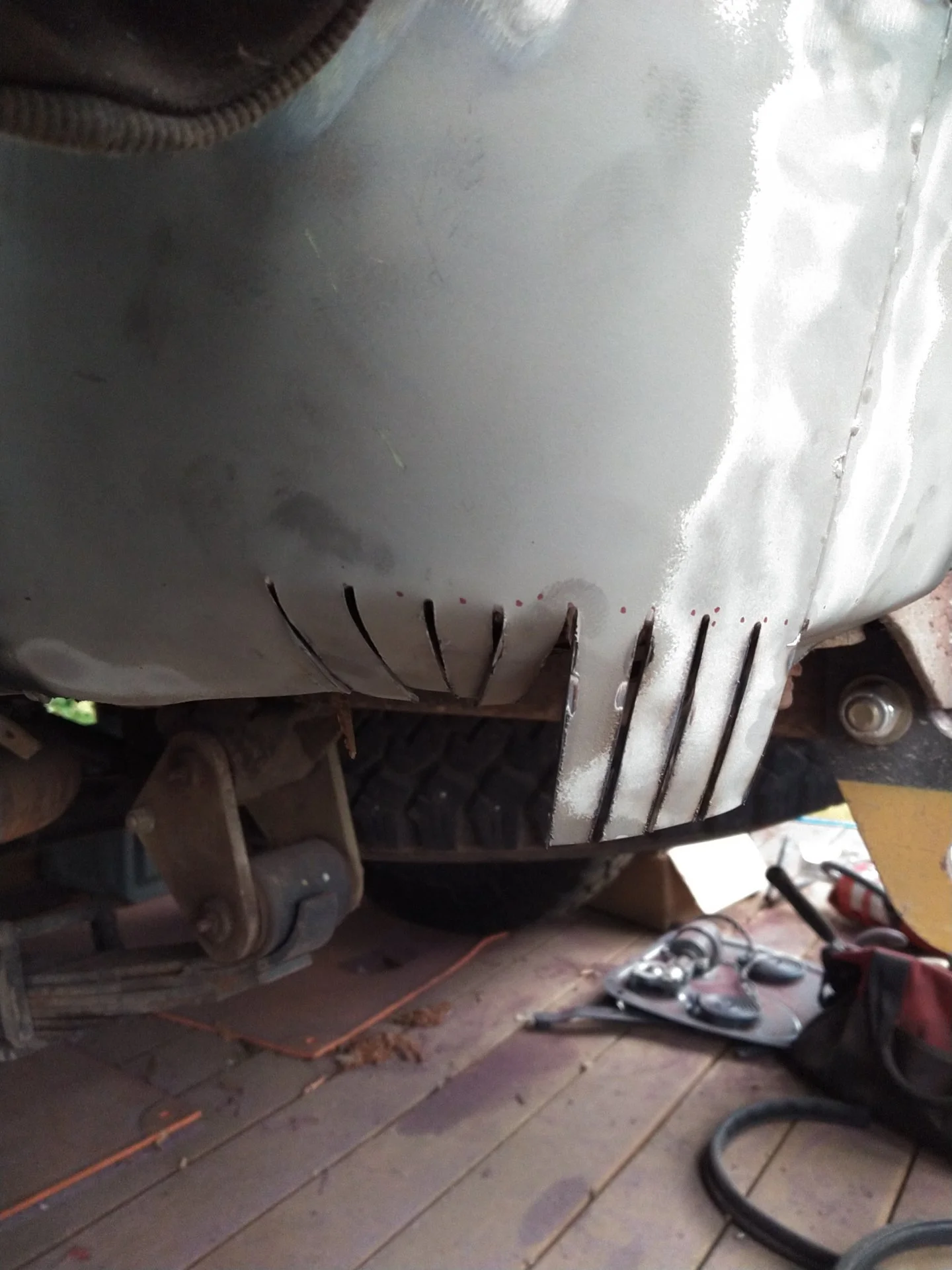

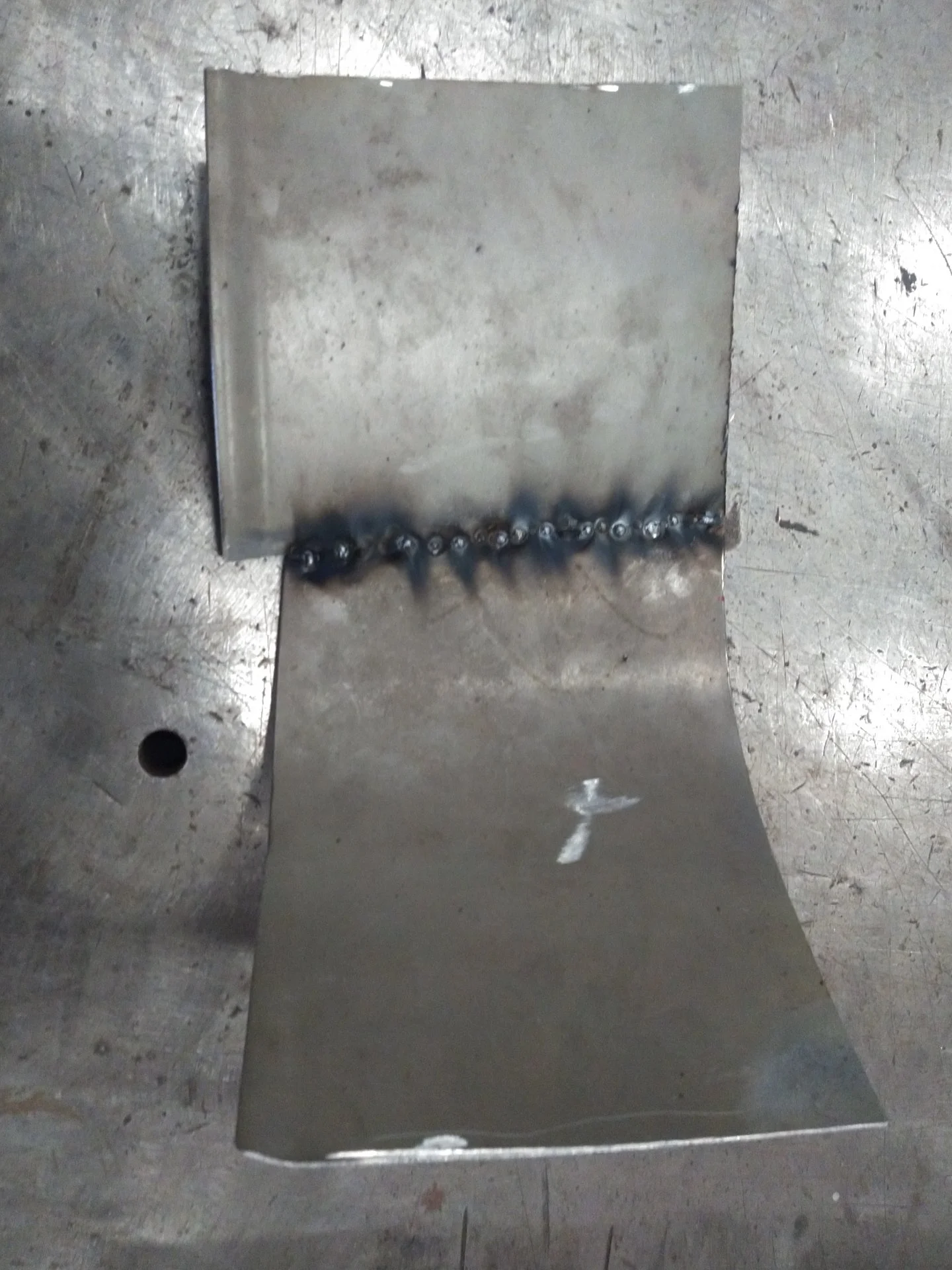

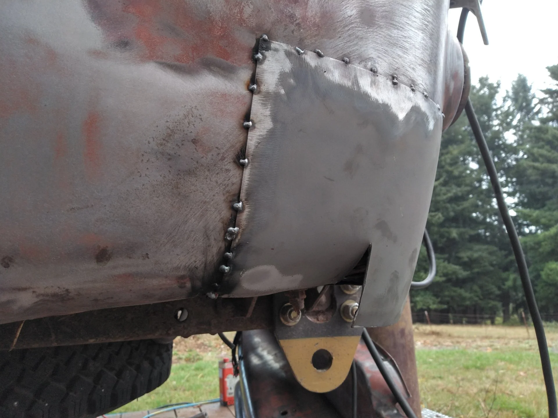

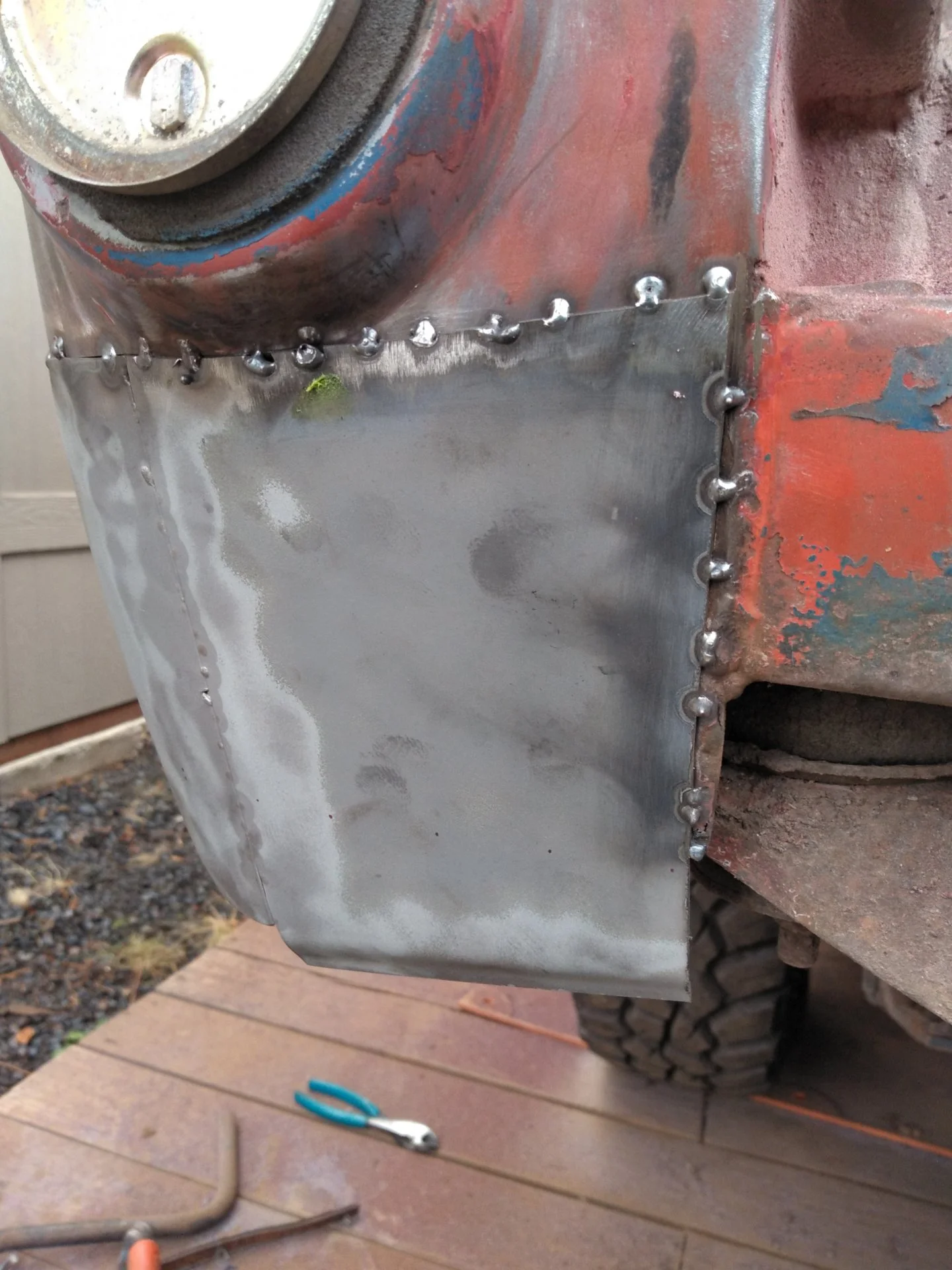

I will finish welding it out and sanding smooth another day. That whole panel was pretty banged up and had previously been worked with a fair amount of body filler. I never noticed it before, other than the rotten corner had flaky body filler. I will be adding plenty of filler in that corner as well prior to paint. But all in all, for what it is, I can say I'm happy with the results so far.

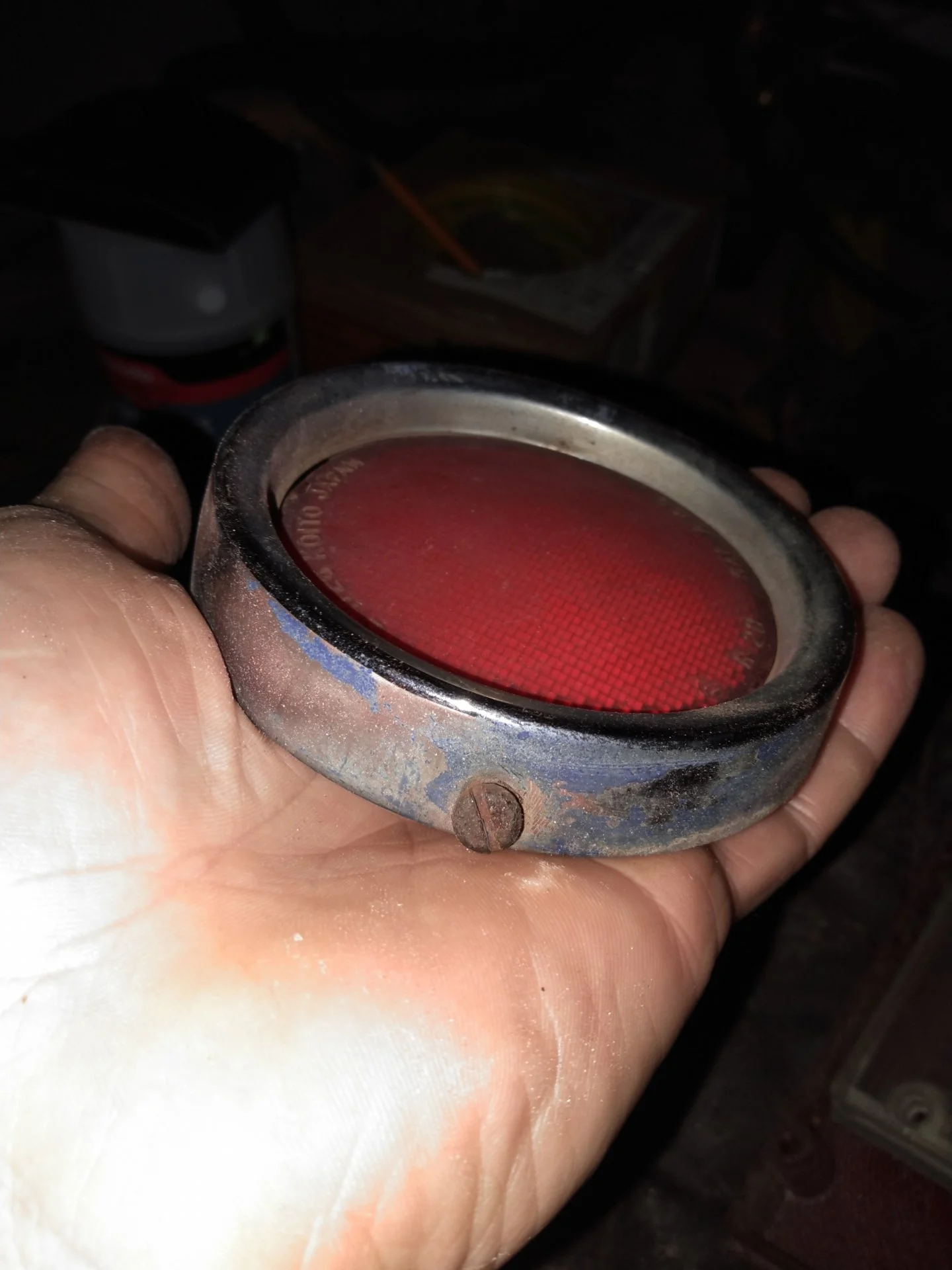

On your rear reflector, were you not able to undo the bolts from inside the rear quarter panel? On my ‘69 that was the case so I removed just the outer piece. Now I am concerned after a test fit that they will most likely shake off on the trail.

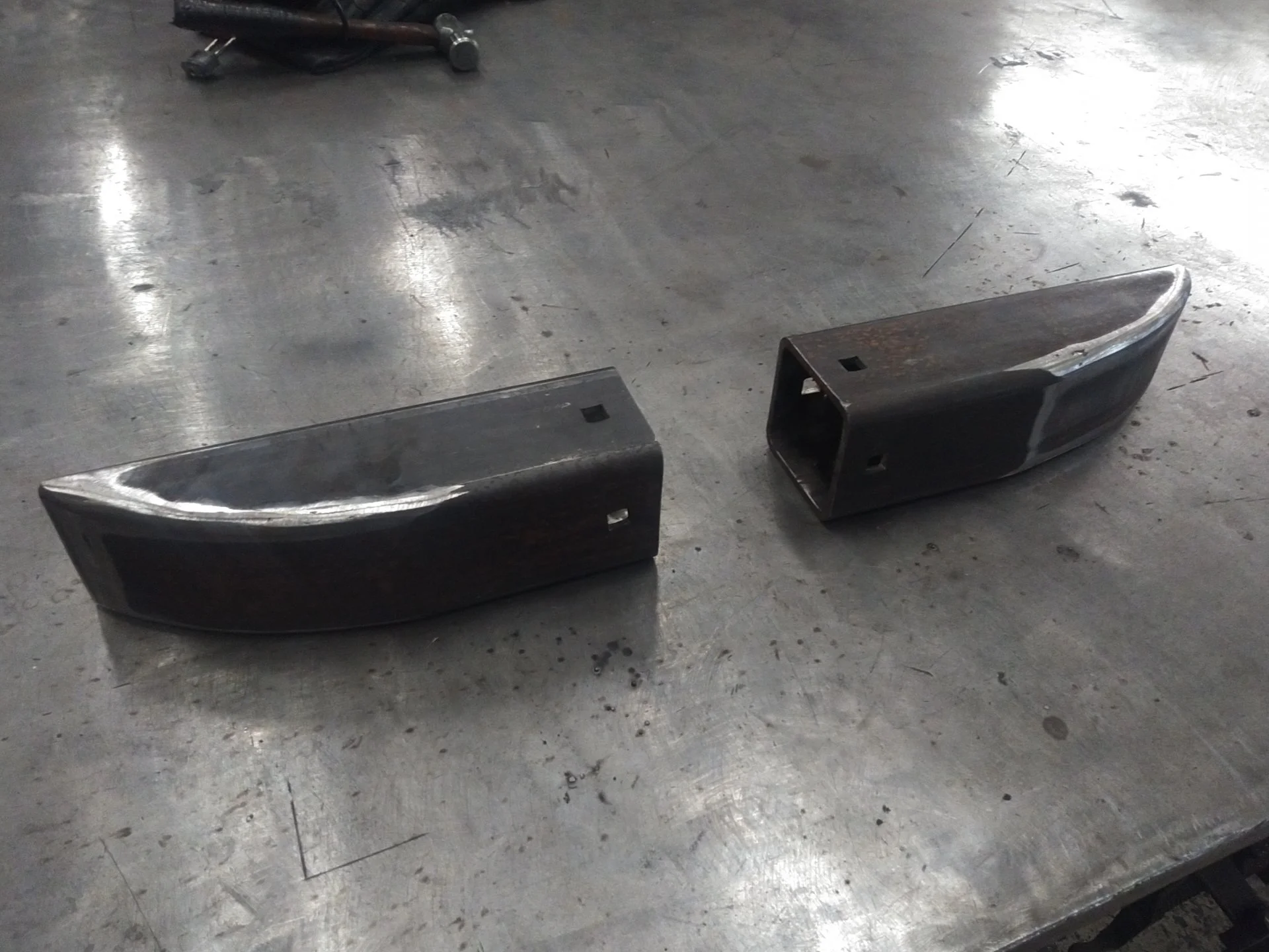

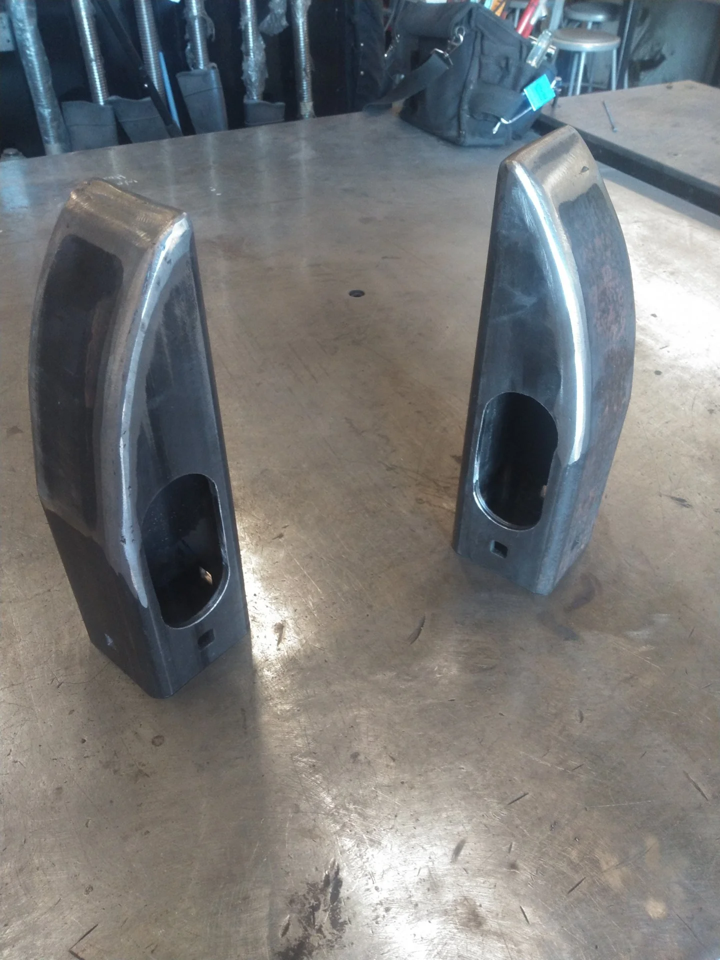

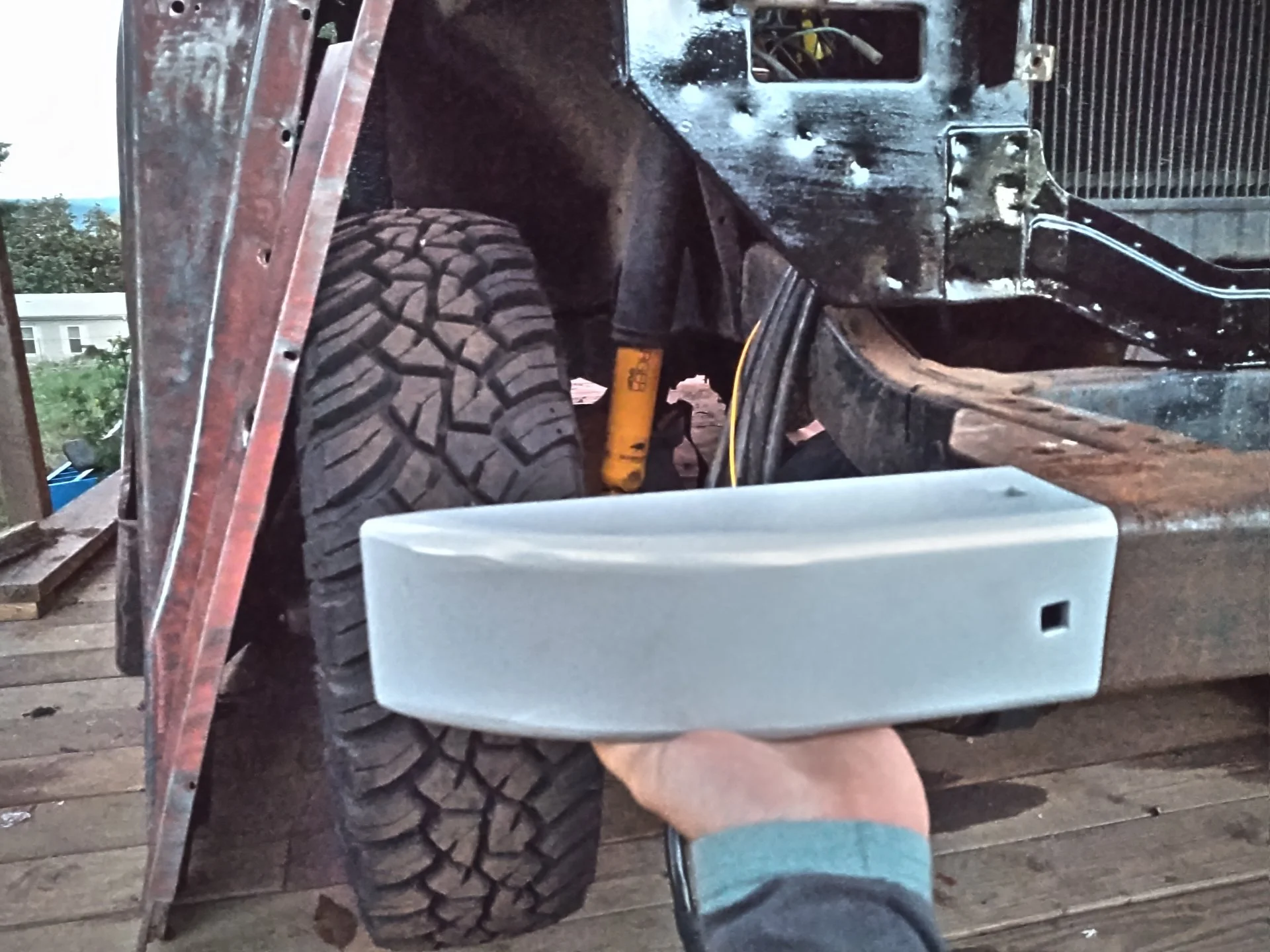

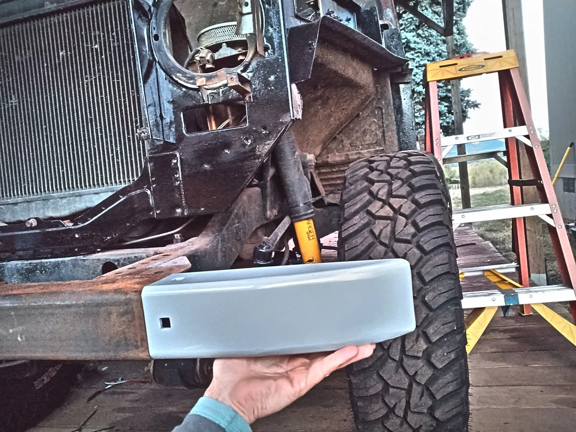

Those front bumper ends will be ROCK solid unlike the front and rear ends from the factory!! Awesome!

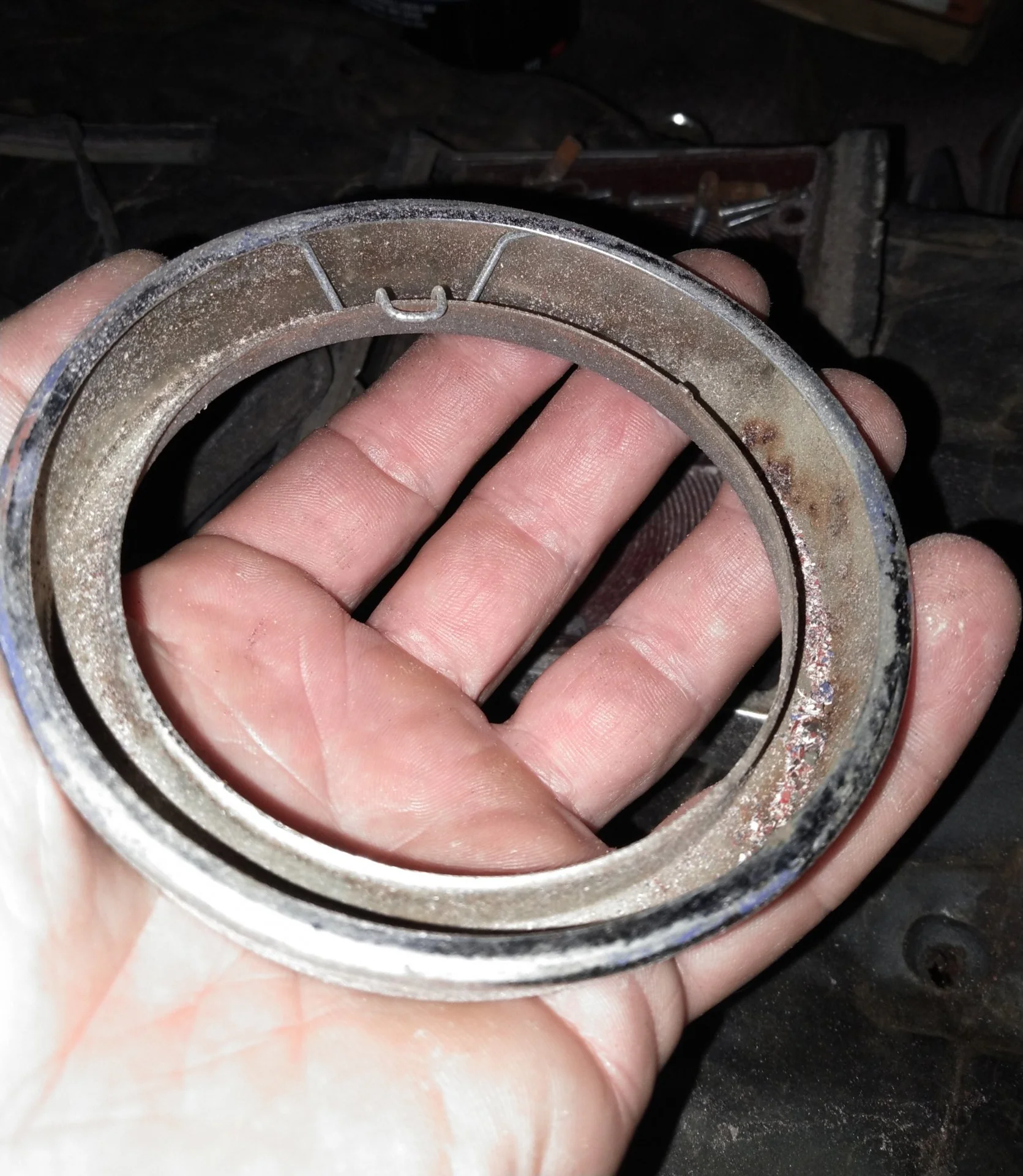

Yeah, same here. I'm not sure what to do about it yet. My reflector on the passenger side had been held in by a screw through the chrome ring. Something the previous owner had done. Kinda janky. And The driver side refector had only two of the three retaining clips for the chrome ring. It seemed to be holding on pretty good dispite missing one of the clips.
I'm considering cutting the reflector plates off or drilling out where I think the threads are to be and replacing them with some fancy reflectors from Slocruiser. But I'm not sure just yet.
The other retainer clip fell out...😳 So as of this moment I only have one clip between the two reflectors 🙄
Oh man…I will have to look again in my box of parts to be put on…not sure I have any retaining clips! That might explain it! Ha!
