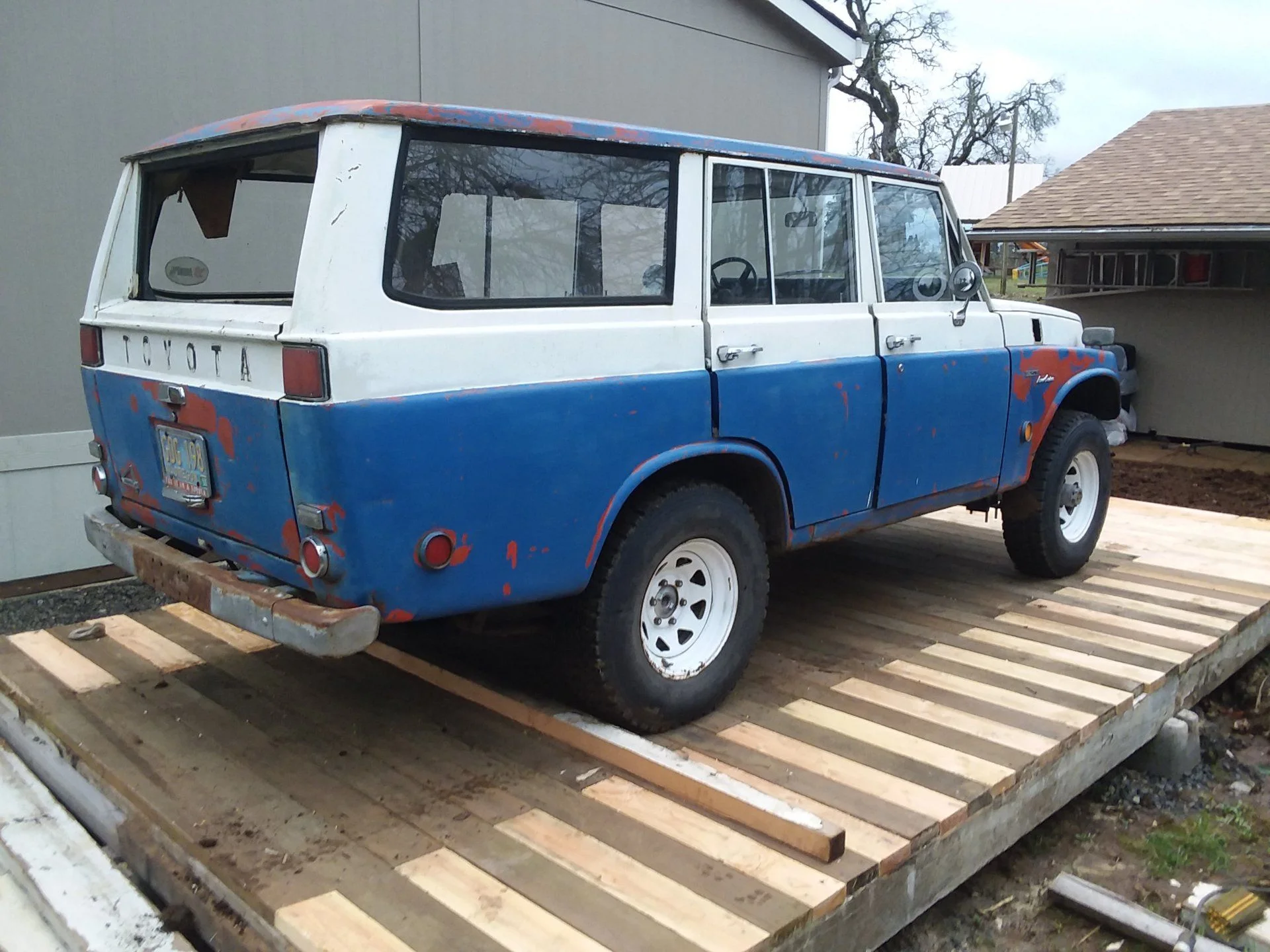

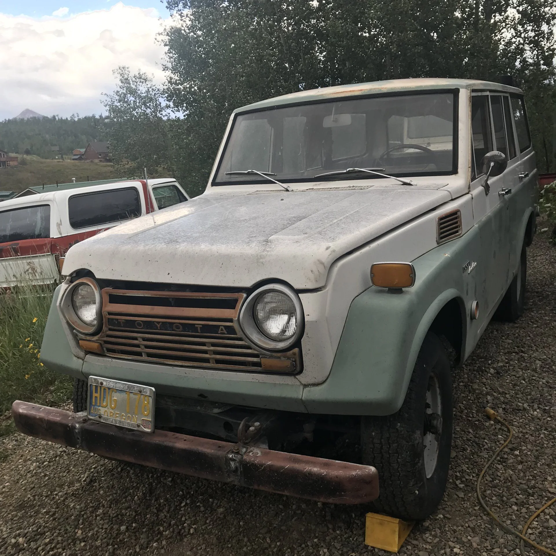

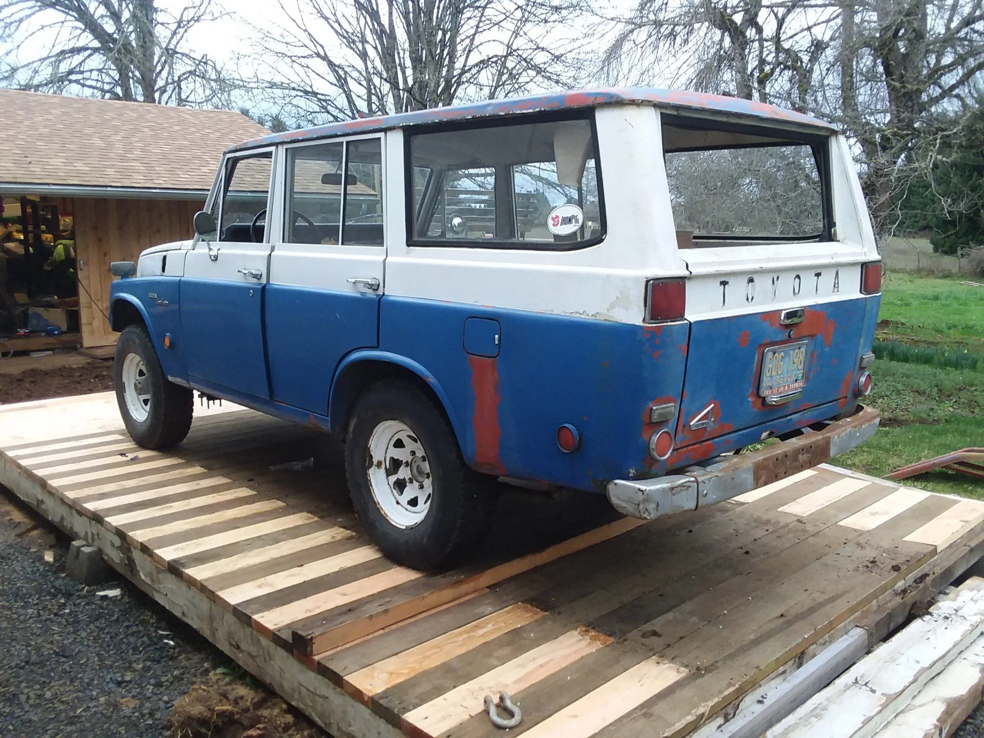

Hello all, I want you to meet my 69' 55. I purchased it in April 2019 after going on a leisurely drive with my 2 year old son. The Landcruiser(s) just barely caught my eye as I drove past. A 69' fj55 paired with a 72' fj55 together sitting in a guys front lawn. They were set back away from the road a ways, about 100' or so. It was just for a split second that I could even see them let alone catching a glimpse of the droopy sun bleached for-sale sign in the rear window of the 72'. I looked in my rearview, saw my 2 year old sitting there and I said "hey bud, wanna see some rusty trucks?" He of course was just as stoked as I was so i whipped a U-turn and pulled up to check out the partly hidden spectacles. As we checked out the two trucks my excitment grew by bringing back memories of when I was a child. You see My folks had a 73' fj55 and my mom drove it as a daily driver. Taking us six kids on errand runs to the grocery store, to school and to the river in summertime. That was and still is some of my fondest childhood memories. It hit me that I wanted to create similar memories with my children as well so I began thinking of ways to make this work, Financially speaking. I dialed the number on the faded sign and did not get an answer, or a returned call... I tried again a week later and still nothing. But I kept trying and eventually my persistent dialing paid off, I finally got an answer. The gentleman told me that they didn't run and hadn't for several years. And if I wanted to purchase one I would need to take the other as well. So, long story short. Tax returns came in the nick of time! Along with some really disgusting and sappy pleadings with wife just to convince her why exactly it was a such a good idea to by not only buy one but two non-running vehicles and move them from some "stranger guy's" front lawn to our own front lawn. It was no easy task but my wife is a really great lady and had agreed to let me go for it. I'm so glad we did.
Here it is the day we met in April 2019. The 69' was in pretty good shape really for having been sitting for so long in Oregon's rainy weather. There is a little rust here and there but nothing that I'm afraid of. The rocker panels need some love and there is a small Bondo fill job on the rear driver corner where the bumper got in a little too deep. But it's all good I can clean it up when that time comes. mechanical first body later...

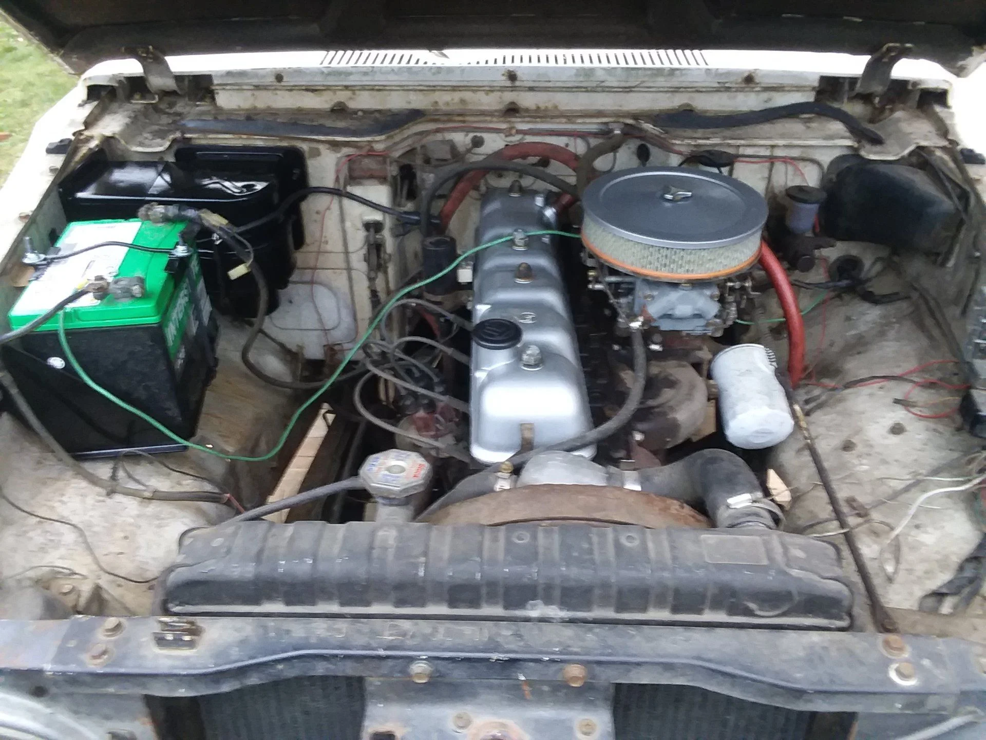

I have already done several things to the 69' but unfortunately they were not well documented at the time of those improvements.
Such as:
- Front wheel bearings.
- The birfield joints.
- Tie rod ends.
- Drag links.
- Front axle disassembled, inspected, reassembled, new oil.
- Steering box cleaned and greased.
- New u-joints in the front drive line (Matsuba joints from Cruiser Outfitters).
- OME steering damper.

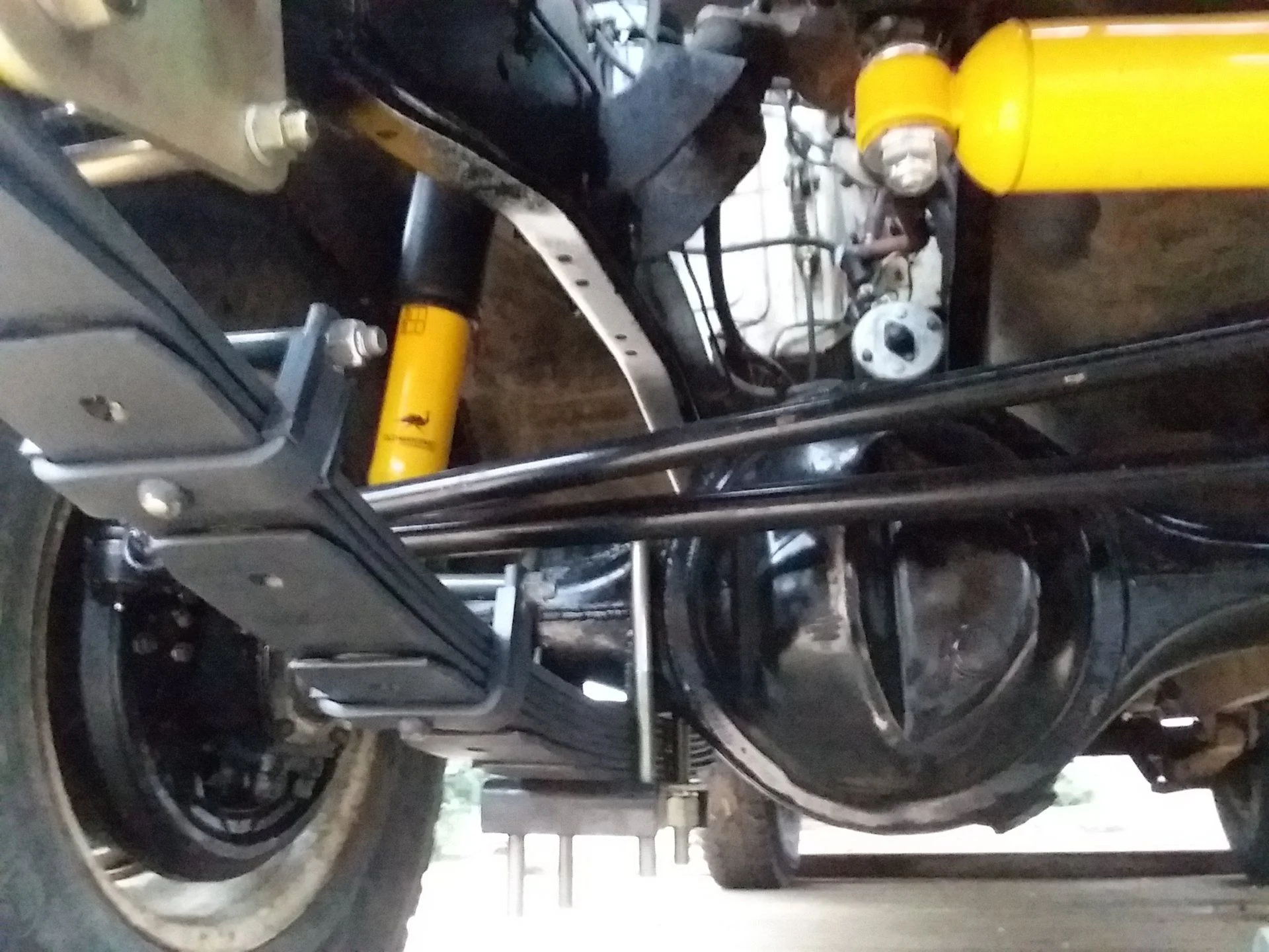

- OME suspension in the front (the rear is coming soon).

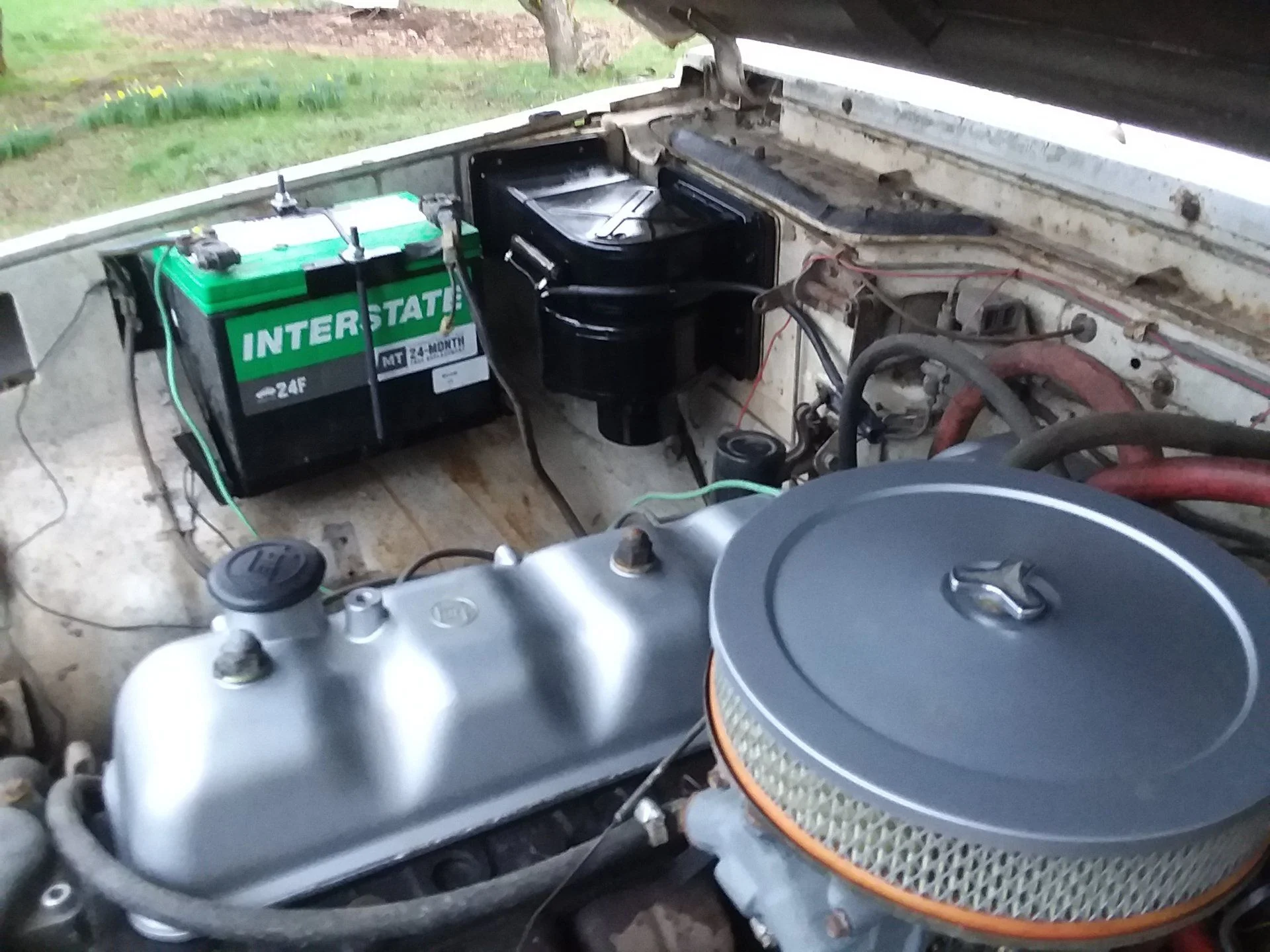

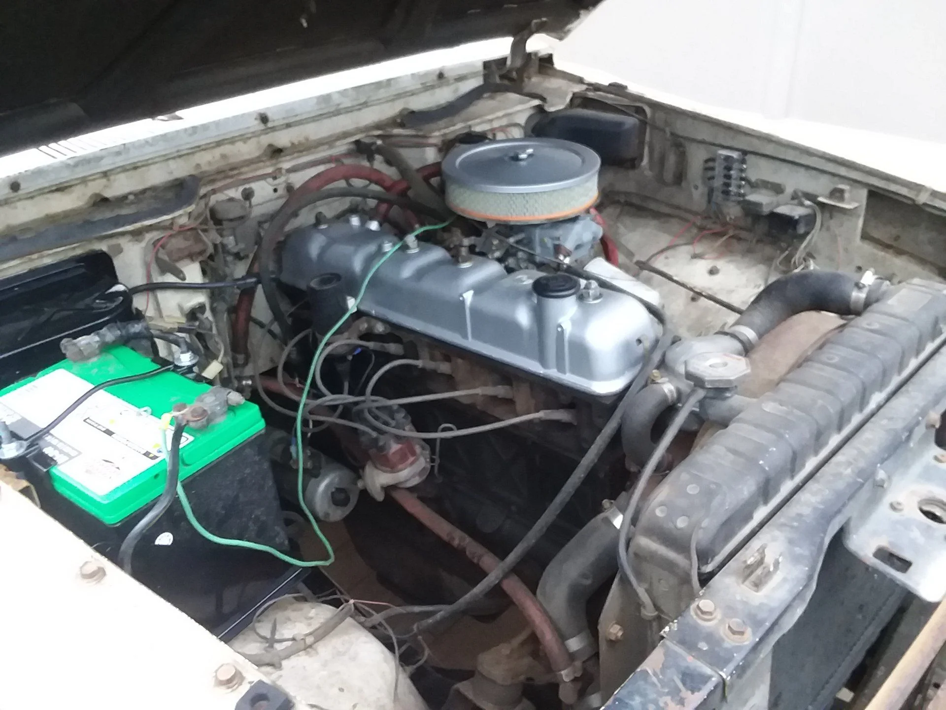

- Rebuilt the Holley carburetor, which, dispite conflicting reviews I am actually really happy with.
- 2F valve cover from Mark's Offroad.
- Refurbished the heater blower motor.
- Fixed the fuel sending unit.
- Replaced the Speedometer cable.
- Rear window register disassembled and regreased.
- Rebuilt all of the wheel cylinders and currently in the process of making new brake lines, replacing the stock master.

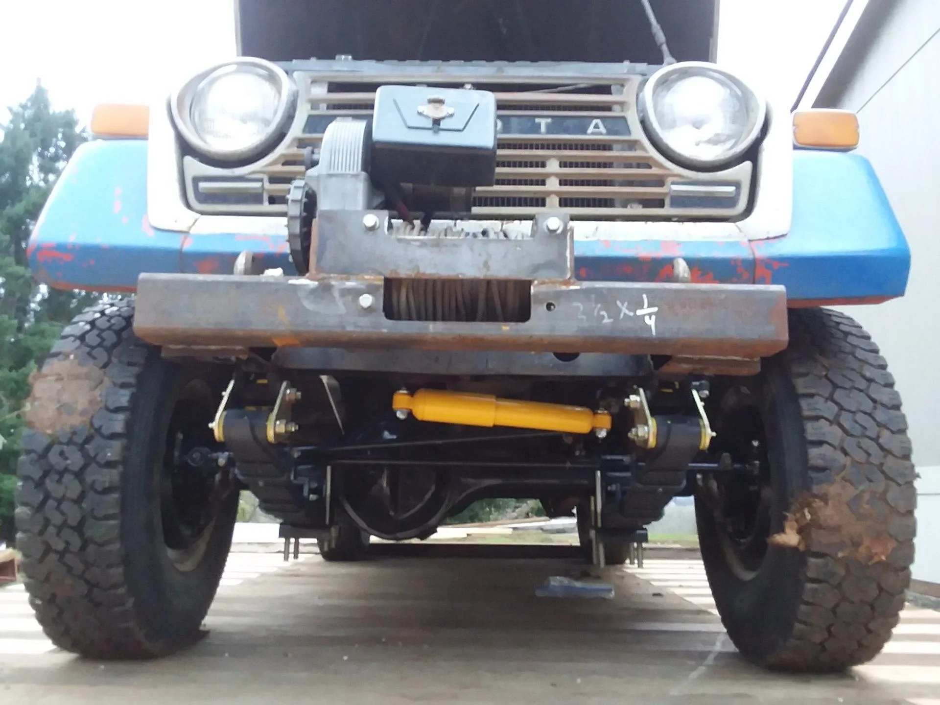

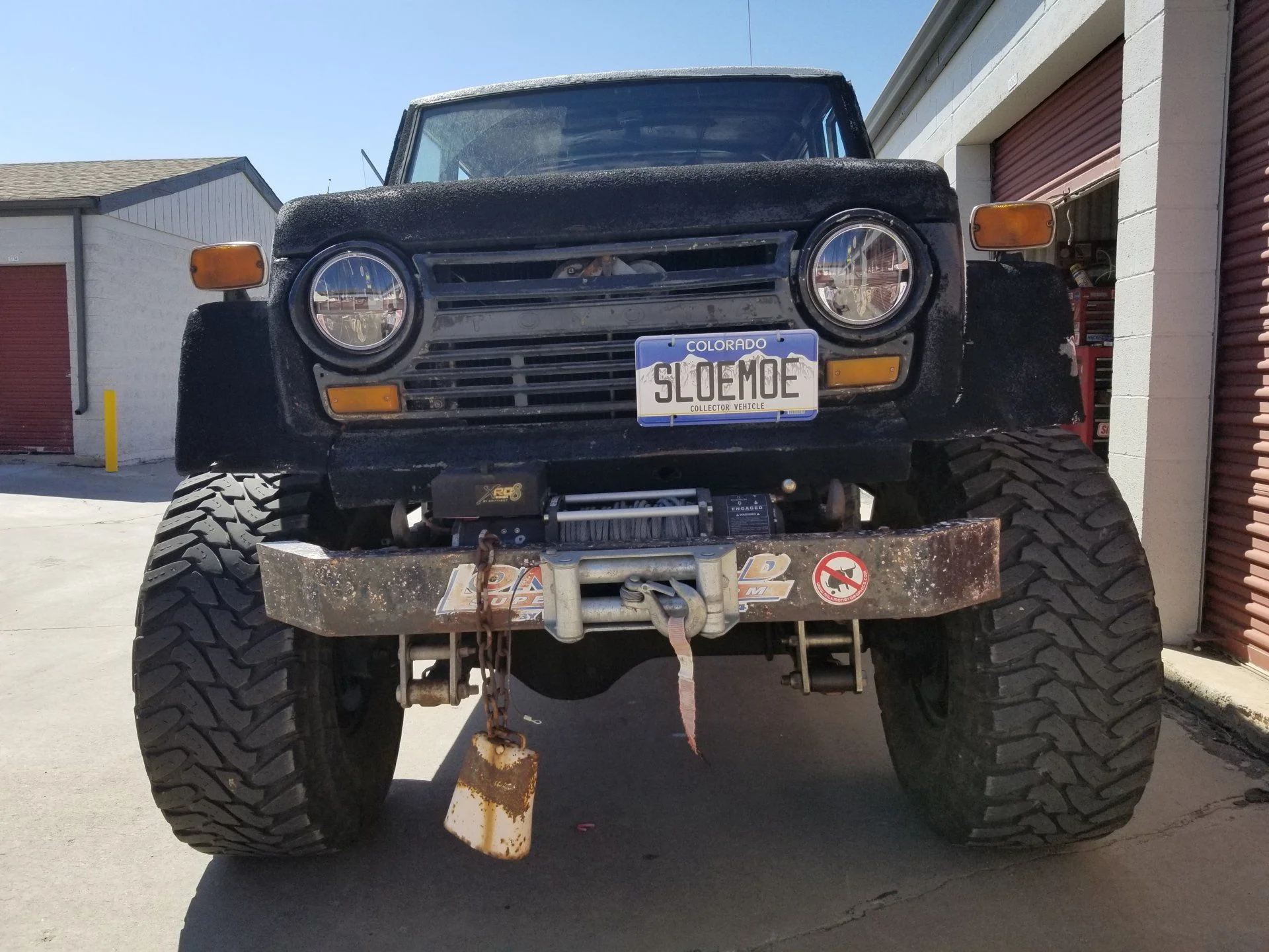

- Refurbished and installed a Warn winch. Had to beef up the front bumper for that install. The factory bumper will be going back on. I have cut a hole in it for the winch cable to travel through.

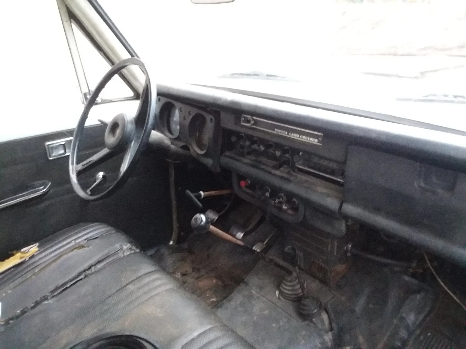

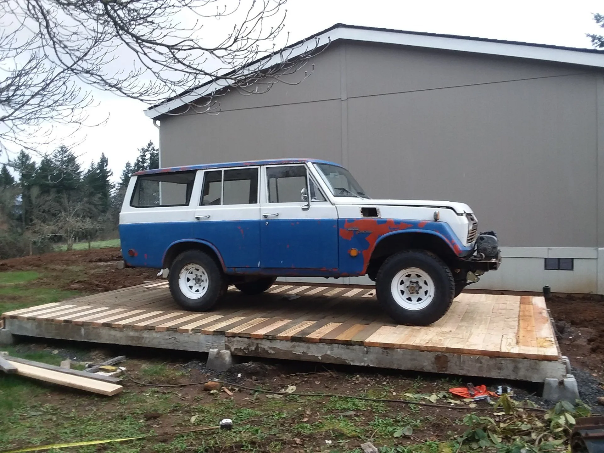

Here are a few photos of it today:
Rear suspension is still stock.

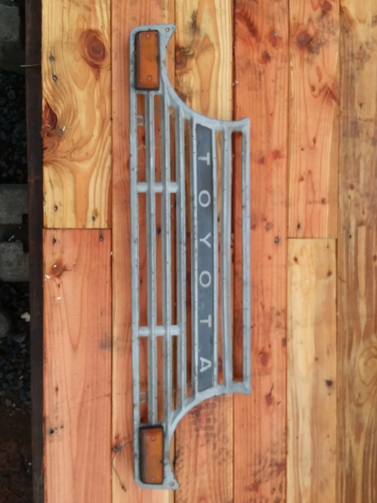

That's a very nice Pig, Congratulations. But, you're gonna need a real '69 grill to put on it...View attachment 2205192
You know what, you got me thinking... I believe it came with another grill. And it had the amber lights. Is that a unique feature to the 69'?
I'm am sure the P.O. made some changes to the rig prior to me getting it. I know that he swapped the f155 engine from the 72' so that's what it has in it now. I will dig around a bit and see if I still have that grill with the lights. Thanks!
Yes. The 55 grill with the amber lights is only found on the 1969 model. So, rare, desirable and correct.
Uh oh, I may have let the 69's steering wheel get away :frown: it was installed in the 72' when I sold it. I had no idea. I am still in contact with the guy i sold it to so I will try to make an offer for getting it back. I am pretty sure that i do still have the original grill though. I will post a photo of it later today.

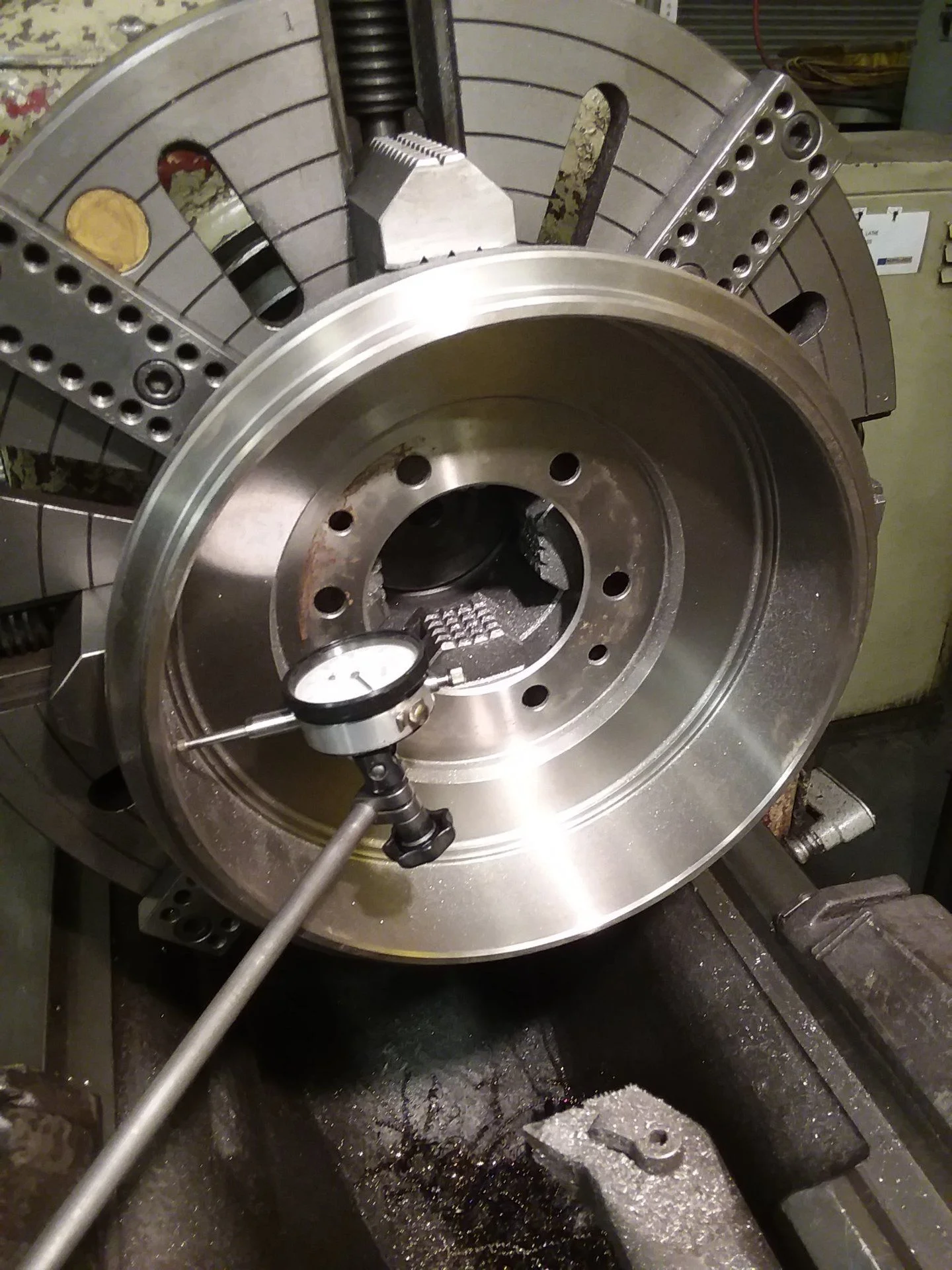

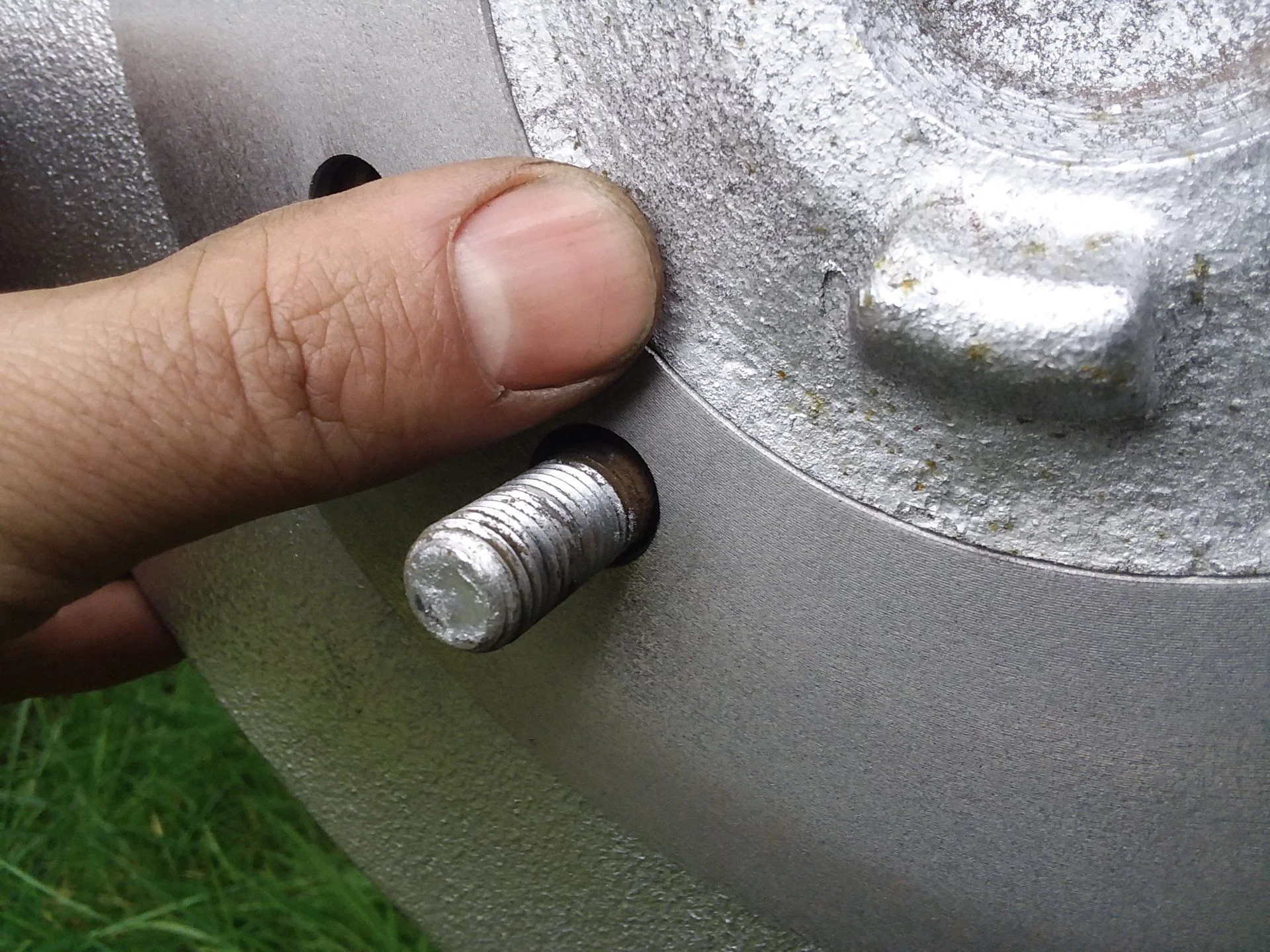

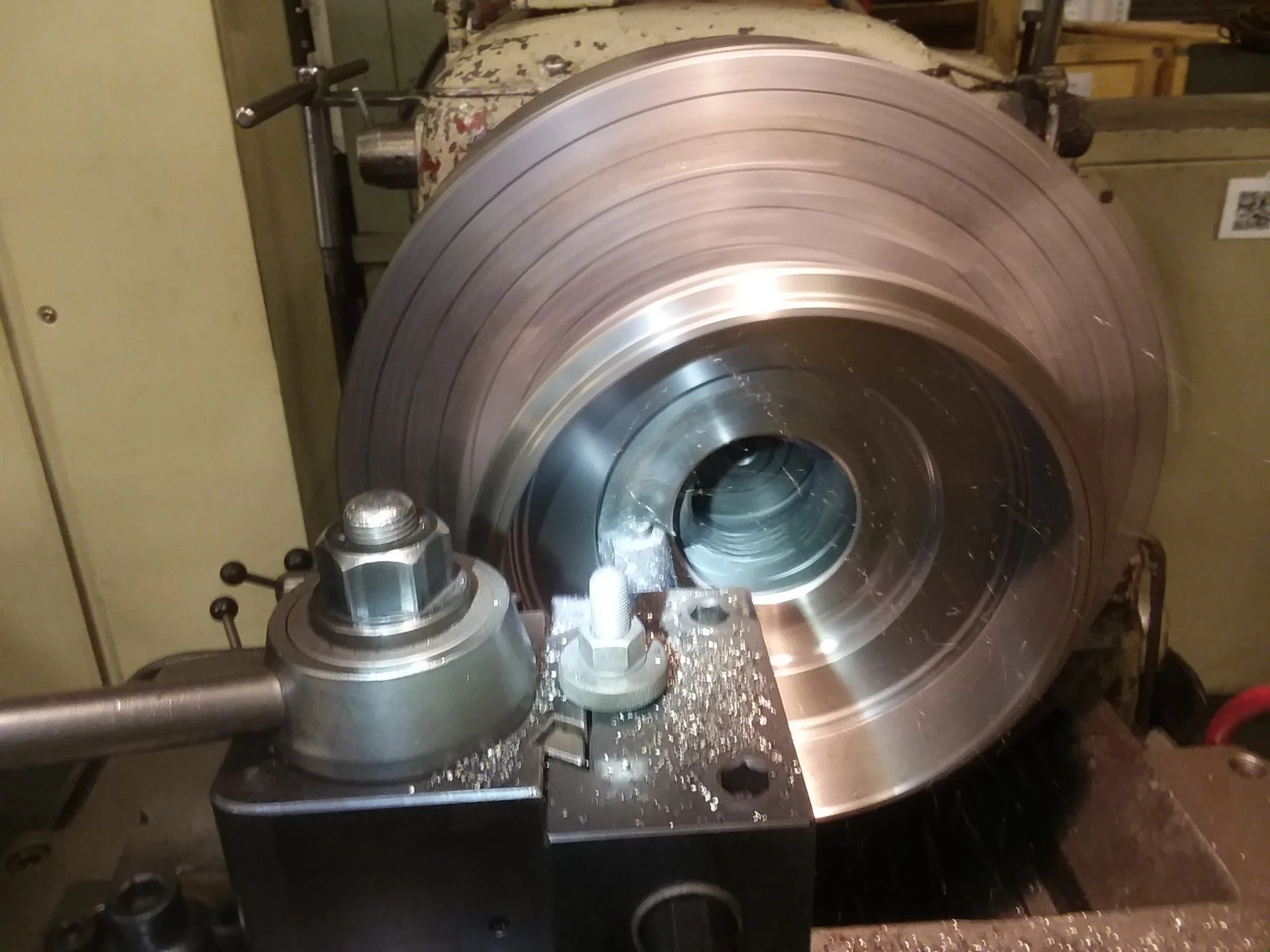

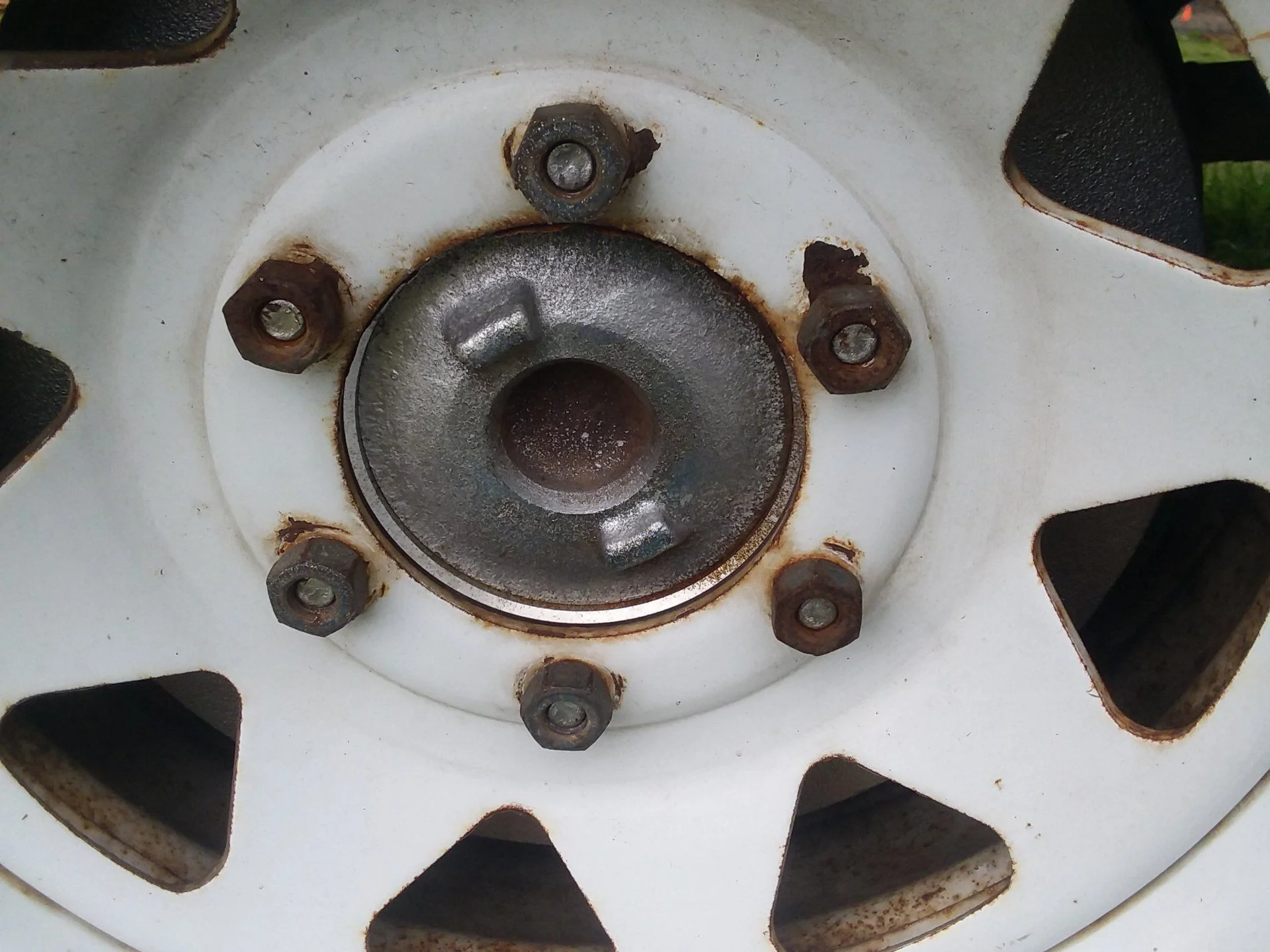

When I purchased the cylinder rebuild kids I also bought four new drums from FJParts.com. but before making my purchase I called to discuss the differences between the OEM drums and the Aftermarket drums. Their response was: Apart from the differences in cost the only other real difference was the thickness on the aftermarket was a bit thicker. He mentioned that is one case a customer had to turn the face of the drum down to reduce its thickness so the lug nuts would fully seat and fully thread onto the wheel studs and that this was most likely a result of having nonstock wheels on the truck. I am glad that I called because I too have nonstock wheels. This was still not a concern of mine. He was totally honest with me and I figured if I were to run into any problems then I too could just turn them down. Which is exactly what I had to do. When i mounted the drum and the wheel the threads on the lugs came up short. Most likely because I'm running some janky-ass wheels.
I referred to my coworker who has nearly 40 years experience running a manual lathe. We measured the thickness of the new drums and mimicked the OEM dimensions from the old drums I was running. by taking the new drum from .320" down to .130". We removed .190" of material from the face of each of the drums. We weren't done there, we also noticed that the inner clearance had conflicting dimensions. We measured the inner flange and determined that we needed to remove .190" from there as well which brought it from 7.475" and opened it up to 7.700" to be able to clear the axle hubs. He begain by centering each one with a dial indicator as he tightened the jaws on the chuck.
And then began cutting out the unwanted material.
Please disregard these two photos. The first is a duplicate and the other is not an accurate reading. I tried to delete them but they are not going away... thanks

By making these cuts I was able to gain the desired threads back on my studs. I will definitely be ditching the janky-ass wheels that I have now for a set of factory wheels in the future. I popped the new aftermarket drums on the truck and the fit like a glove sitting flush to the outside of the axle hub.
These are a good quality (from China) brake drum from FJParts.com. So if you are running aftermarket nonstock wheels, have access to a lathe and want to save a whopping $121. Then I would recommend buying them. But all of this may or may not have been avoided if I only had the factory wheels.

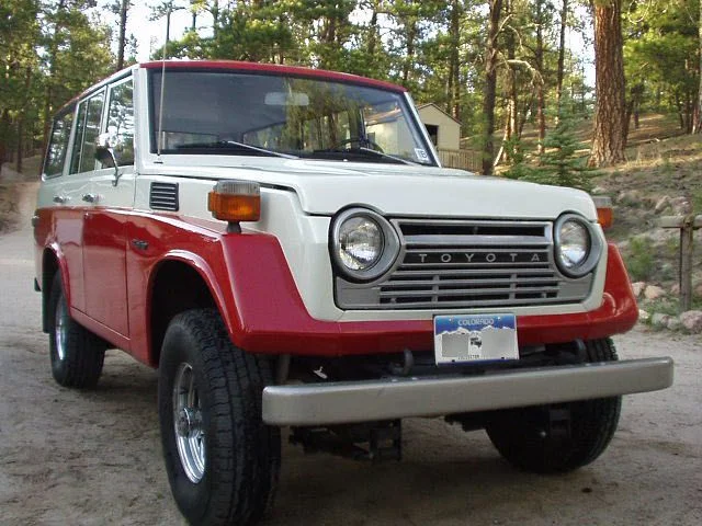

Any pig is a labor of love - thanks for sharing your story. I bought a clean '76, and then bought a '69 out of a junkyard (no axles or drivetrain) for $350. Restored the '76 and parted the '69 - it had the same rare grille.
What a beauty! That red really pops! My 69' was originally red from the factory and will very likely be red again someday.
Is that an original Toyota red on your 76'?
