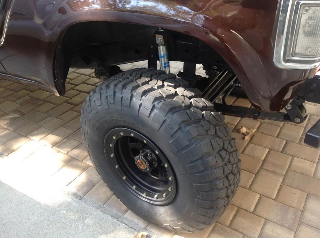

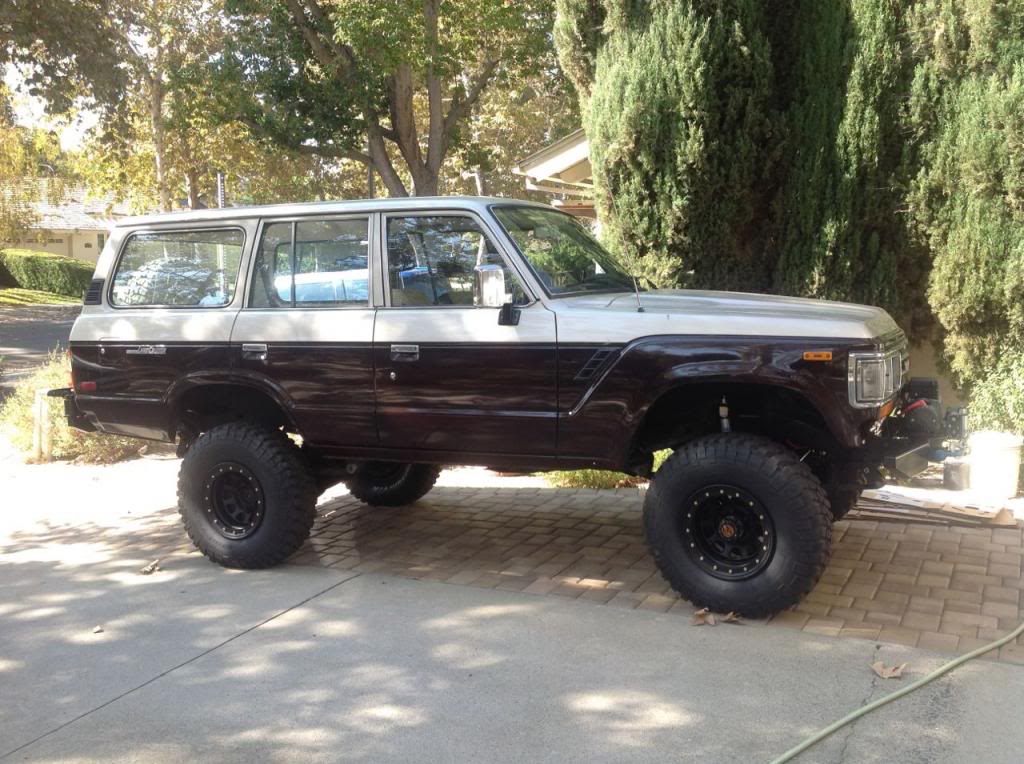

I was pleased when i got it, but however, I quickly realized it was a bit tall for what I wanted to do with the spring over and the huge shackles (5.25 inch center to center). After some conversations with Ron at Custom Cruisers in Gilroy, we decided to install shorter shackles (about 3.5"), and swap out the tires and wheel. They were 35 x 12.5 x 15, and I went with 33 x 10.5 x 15 BFG Mud T/A MK2 . The shackles and tires brought the truck down around 2-3" total. Since we were in there, also replaced the shocks with some Bilsteins, the shocks on it were completely blown, and really almost did nothing.
Fresh off the delivery truck, no mods -
New tires, wheels, shocks -

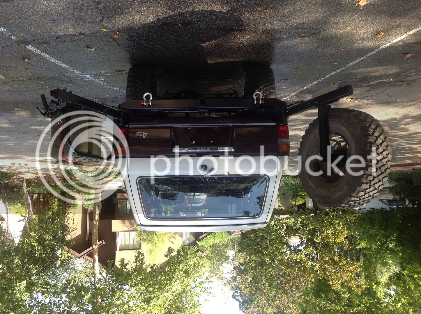

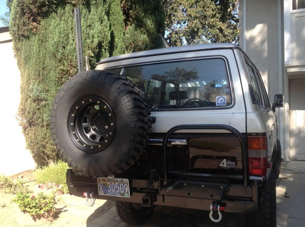

The rear bumper was basically a big ol' piece of U-channel with some shackle mounts welded on, and attached to the frame, this was removed, and again, Ron at CCFJ built me an awesome twin swing out rear bumper/tire carrier/Hi-Lift mount-
Before the Hi-Lift mount was added -

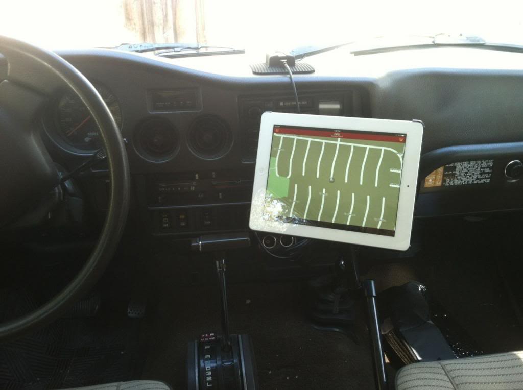

Next, since I am planning some trips, a good GPS system, something massively adaptable, and I didnt want to break the bank, so after a lot of window shopping, and LOTS of reading, I chose to go with a Garmin GLO GPS receiver, that uses not only our GPS sats, but also the Glonast (Russian) sats. This is connected via bluetooth to my Ipad mounted to a "Joy Factory" carbon fiber mount. The GLO receiver sits on a no-slip pad mount on the dash.-
When its not being used, the mount folds away nicely-
I am running 2 different GPS apps, on is the Garmin Navigon app that stores all the data in the memory of the Ipad (as apposed to wierlessly updating), and when i am off the beatem path, I also run Motion X , which will just plot and save my course, so in the event I get lost, I can just backwards navigate home.
