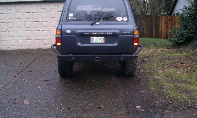

It's clear that it's time to develop some serious quarter panel protection. I have a dilemma, and need some input.
Should I come up with a plate style quarter panel system like @jcardona1 and @actionjackson 's 80s, or should I do a tube style quarter protection like @VCCruzr?

I think I'm leaning towards the plate style. What say you mud?
Plate with some bead-work in it will give some stiffness and slipperyness you're after - although a direct shot will fold it. Tubes are gonna snag on stuff and leave spots unprotected. What about a little of both? Skin the tube work and get the best of both.
What park was fall crawl at? I see the video says the cove but the cove I’m familiar with is in Tennessee.
Plate with internal reinforcement. Replace the sheet metal quarters completely. Tie into the frame like a roll cage.
Which ever you end up deciding on (I like tube work myself) make sure it will slide on stuff and not have sharp points like the first 80 pictured where those stick outs could get caught up on stuff. I have used my rear tube protection probably the most since we've got real estate back there.
The action jackson style is more visually appealing to me, but the 60 lower quarter panel sticks out more.
How about this. Plated/reinforced on the inside down to the 60 lower body line, then tubing from the (soon to come) rear bumper up to protect the lowest portion of the quarter:

I have knocked the quarters off my pig more times than I care to mention so after the last time I just built a trail pig. I bobbed and in-boarded the quarters on the trail pig and so far they are staying reasonably dent free.
My input would be
A) Build a trail Moonshine
B) BOB those long rear quarters to get them out of harms way.
C) Stop caring and embrace the trail damage like every Cherokee you see on the trail

I like the plate style for asthetics, and also the tube coming from the bumper. On my first 80 series, I had the tube style to protect the rear quarter and it worked great. One thing I would suggest, which I had on that first truck, was a bit of a kick out
to the tube work. Mine was minor, but it really helped to kick the rear away from trees and rocks when I needed it most.

I just can't bring myself to build a trail moonshine yet. This truck works too well. The damage doesn't bother me, but I'd like to keep the quarters away from hitting the hatch :lol:
Some day I will build a buggy.
