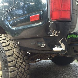

I'd like input and potential vendors for some rear quarter panel armor. I have managed to drag my 80's a$$ on the Golden Crack in Moab (right side) and the Holy Cross gatekeeper (left side), and nearly took out my taillight on the left side. Photos of my current damage:

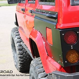

I'm starting to think about some rear quarter panel armor and like the look of this: (from an XJ J33p):
Obviously the lines are different and the 80 is rounder, but I think I like the look. I am guessing this would have to be custom fabbed, but I'm posting this up in case someone sees it and knows of a vendor with something like that for our 80s.

The '80 has much more curve than the Cherocar, forming the compound curves would make them expensive.

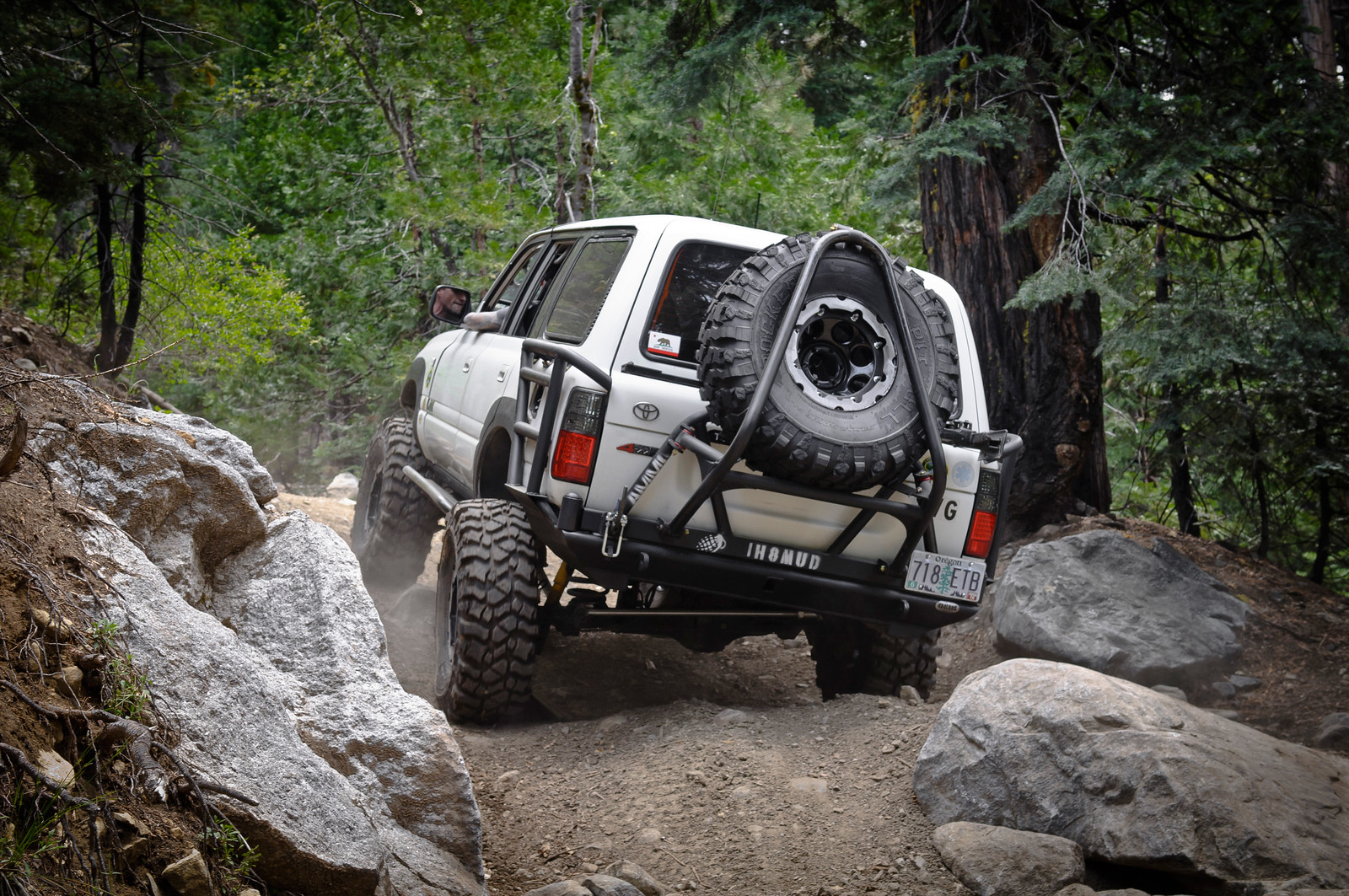

This is what @AMMO did
And Shawn Jackson

Bob the rear end if you intend to seriously use it as a rock crawler. Or bust out the sawzall, cut off the lower corrners, and build a tube bumper with proper quarter panel protection that ties back into the slider for a rear cage.
